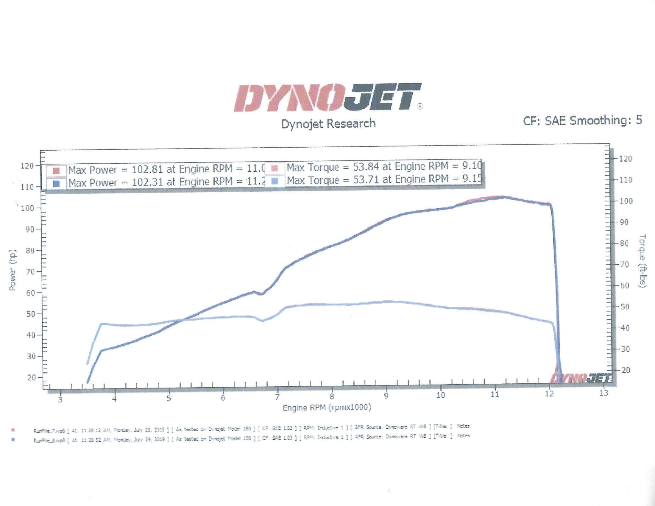

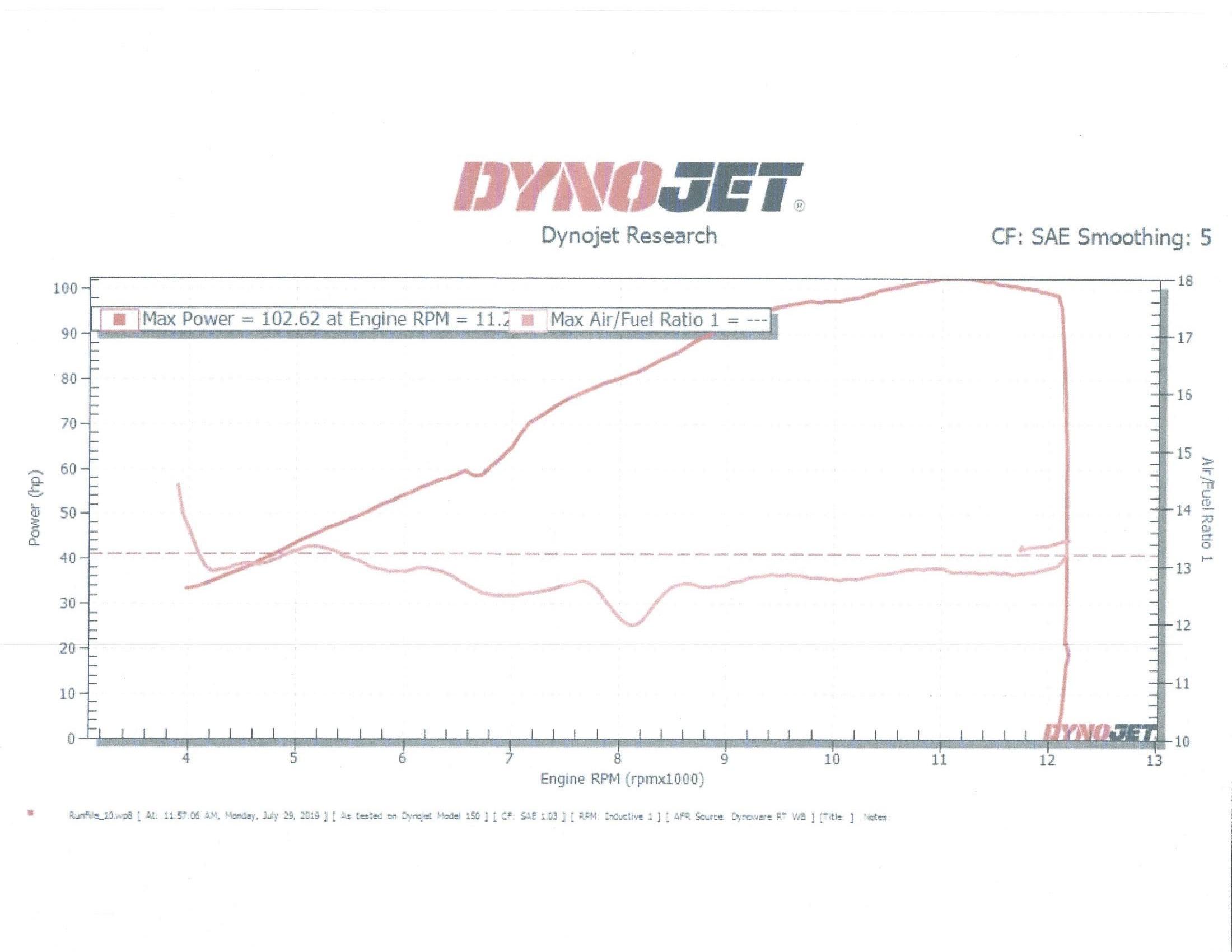

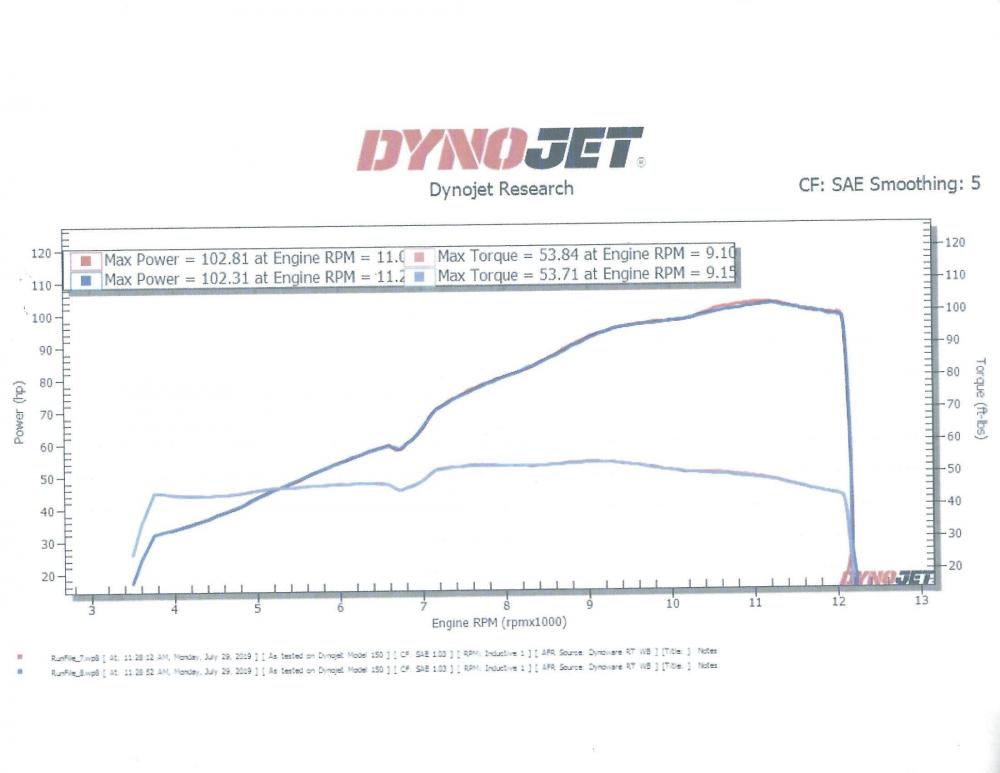

VFR750F3 Posted July 29, 2019 Posted July 29, 2019 Dyno run done today 2002 vfr800 with a Tinyminds map, four short velocity stack, pipercross, new header and a Austin racing muffler. Need to sort out fueling I assume. Quote

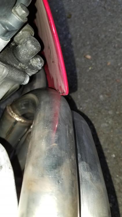

Member Contributer interceptor69 Posted August 4, 2019 Member Contributer Posted August 4, 2019 Finally got around to installing the new headers on my 5th generation yesterday. My nephew helped me and it was still a pain in the ass. Is anyone else experiencing this pipe melting into the fairing? Also, knowing others had trouble aligning the fronts to the bolts my nephew just stretched those apart using brute force- they then lined up fairly well. Quote

Member Contributer interceptor69 Posted August 7, 2019 Member Contributer Posted August 7, 2019 I had that talk with sfdownhill and we are going to bring this and a few other little quirks up with Wade. My guess is any issues we had will be resolved if/when we can get the next minimum order fulfilled. One other issue I experienced was the right fairing melting onto one of the pipes due to how far to the right one of the header pipe protrudes. Sent from my SM-G955U using Tapatalk Quote
