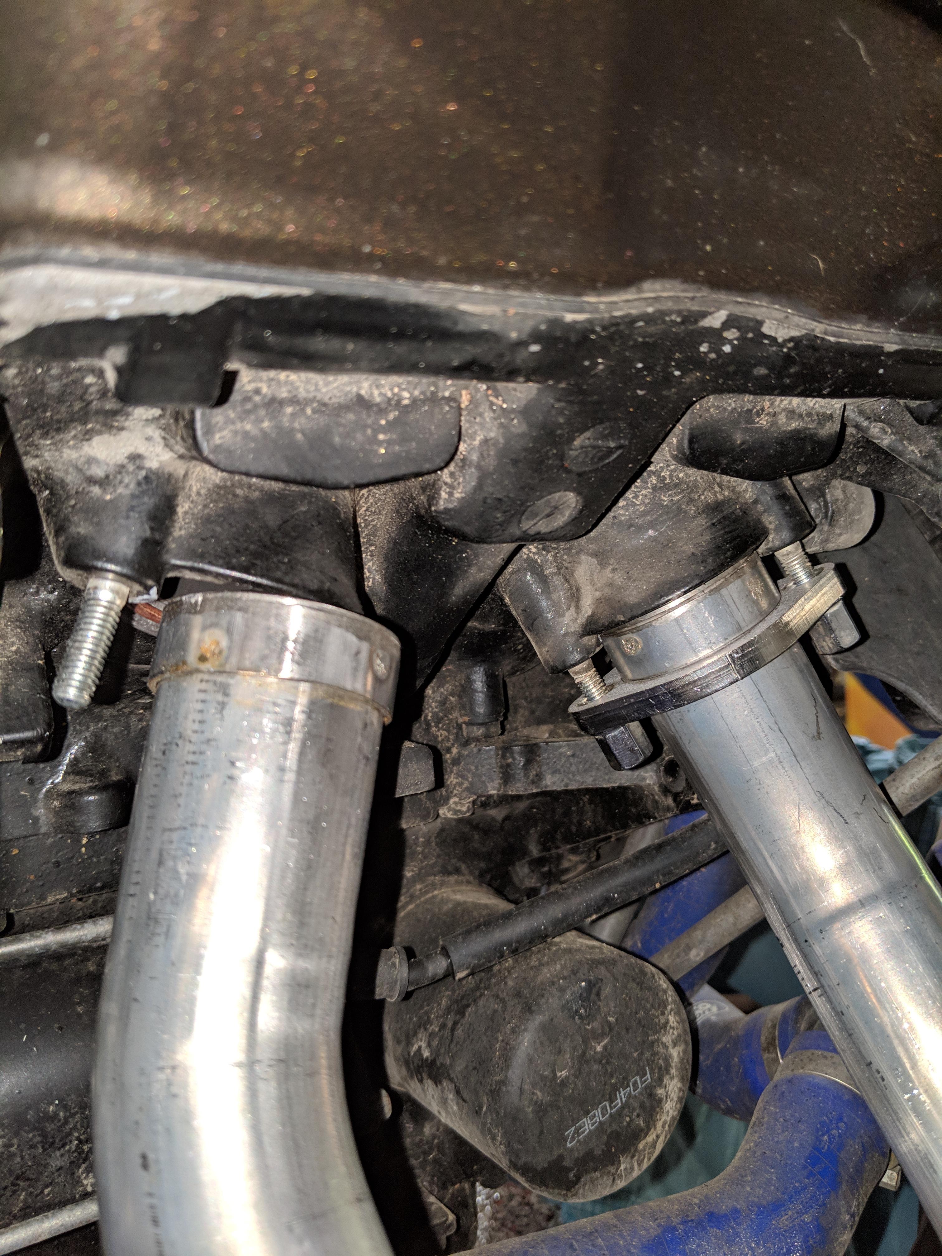

Member Contributer MooseMoose Posted May 5, 2019 Member Contributer Posted May 5, 2019 1 hour ago, MiniCarver said: Finally got around to installing the pipe. The front was pretty far off and misaligned. CornerCarver had to lay on the ground and push the front right with his foot while I worked it into place. That's exactly the way the original Two Brothers pipes they were patterned off of fit. Everyone should expect this. 3 Quote
Neo2122 Posted May 5, 2019 Posted May 5, 2019 Mine were like that, it wasn't a problem at all tho just put one pipe in and pulled the other into placeSent from my XT1710-02 using Tapatalk 2 Quote
MiniCarver Posted May 6, 2019 Posted May 6, 2019 16 hours ago, MooseMoose said: That's exactly the way the original Two Brothers pipes they were patterned off of fit. Everyone should expect this. I knew it wasn't be an exact perfect fit. Just letting everyone know what I had to do to get it in place. If you're trying to install this by yourself be prepared to become a novice contortionist. 2 Quote
SEBSPEED Posted May 6, 2019 Posted May 6, 2019 36 minutes ago, MiniCarver said: I knew it wasn't be an exact perfect fit. Just letting everyone know what I had to do to get it in place. If you're trying to install this by yourself be prepared to become a novice contortionist. To be fair, I've seen your watch band size and IIRC your header could also wear your watch... 2 1 Quote
