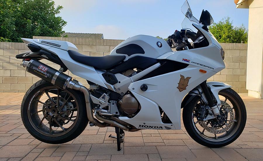

Member Contributer interceptor69 Posted August 22, 2019 Member Contributer Posted August 22, 2019 I got my bike back yesterday. Hoping to take it out tomorrow or Friday. Just wanted to say MUCHAS GRACIAS!! to SFDownhill and also to Duc2V4 for all their hard work, dedication, patience, and attention to detail. It was a pleasure meeting and working through the process with SF and I'm looking forward to meeting up with him and Duc for a ride someday! Crappy cell phone pic below, better pictures to follow... Those headers look great on your white VFR. Sure wish I had some of those cool wheels on my '98.Sent from my SM-G955U using Tapatalk Quote

Member Contributer interceptor69 Posted August 27, 2019 Member Contributer Posted August 27, 2019 I think i need to replace the muffler gasket. When installing the new headers the old one came off relatively intact but not completely so I believe replacing it is a good idea. I searched on Partzilla but there were 2 or 3 different gaskets listed. Does anyone know the correct one to order?Sent from my SM-G955U using Tapatalk Quote

Member Contributer KevCarver Posted August 28, 2019 Member Contributer Posted August 28, 2019 I think he’s asking about the muffler gasket not exhaust port gaskets. Usually when I see multiple #s the bottom one is the only one that is orderable. My Staintune doesn’t need one, so I haven’t bothered with it for a while now. I just looked at Ron Ayers fiche and only see one listed; #7. Doesn’t the new header have a larger diameter outlet? I thought people were saying the Staintune would have to be stretched. 1 Quote
Member Contributer interceptor69 Posted August 29, 2019 Member Contributer Posted August 29, 2019 I'm fairly certain the new header outlet diameter is larger but the Vance & Hines pipe fit well, even with the remains of the old, original gasket wrapped around the outlet. My only concern is if the new header outlet is significantly larger the original Honda gasket will not fit. Weren't these headers based on the Two Brothers headers? If so are there gaskets still available from them?Sent from my SM-G955U using Tapatalk Quote

Member Contributer interceptor69 Posted August 31, 2019 Member Contributer Posted August 31, 2019 The Two Brothers header didn't use a gasket. Slip fit joint. Just noticed the pipe diameter was a bit larger than the header outlet- bike is noticeably louder when at high rpms-a lot louder. Thought it may be leakage. Sent from my SM-G955U using Tapatalk Quote
