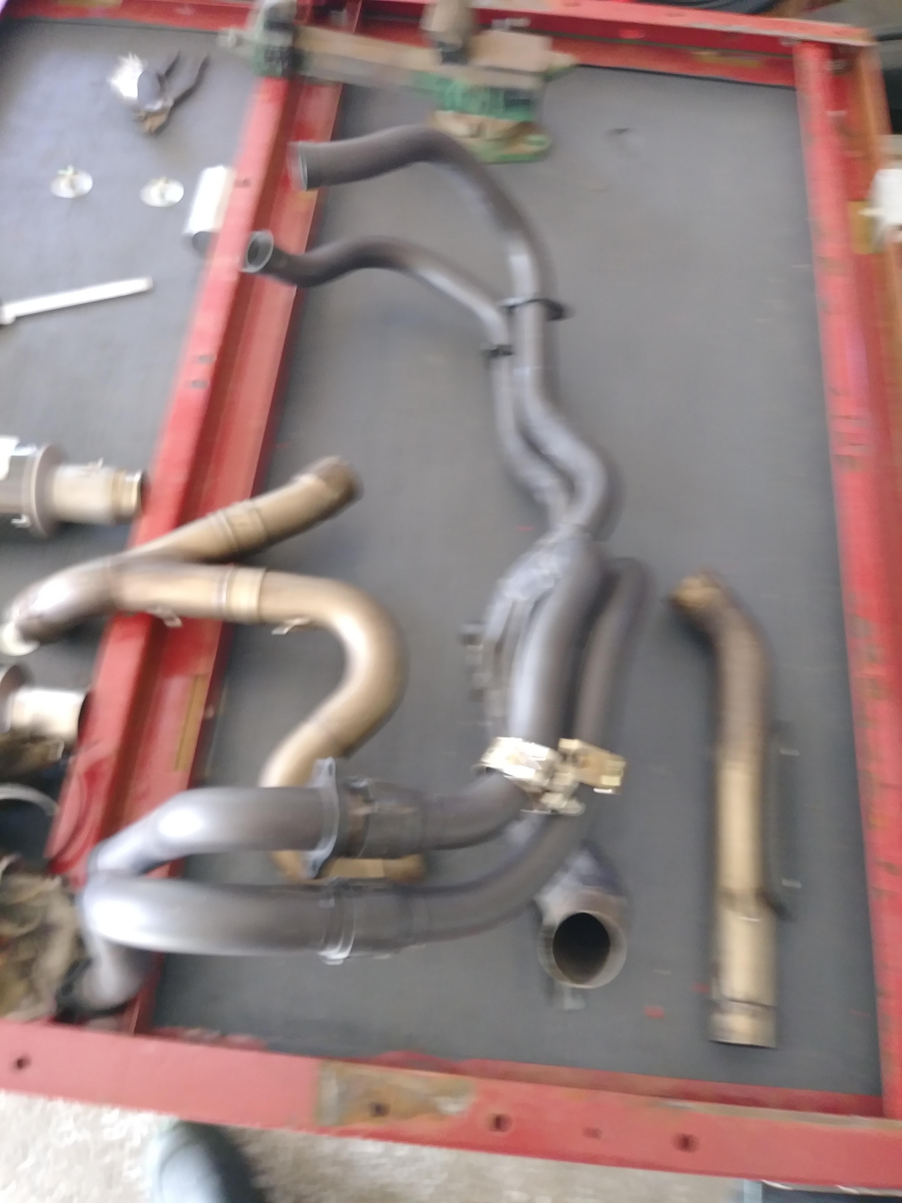

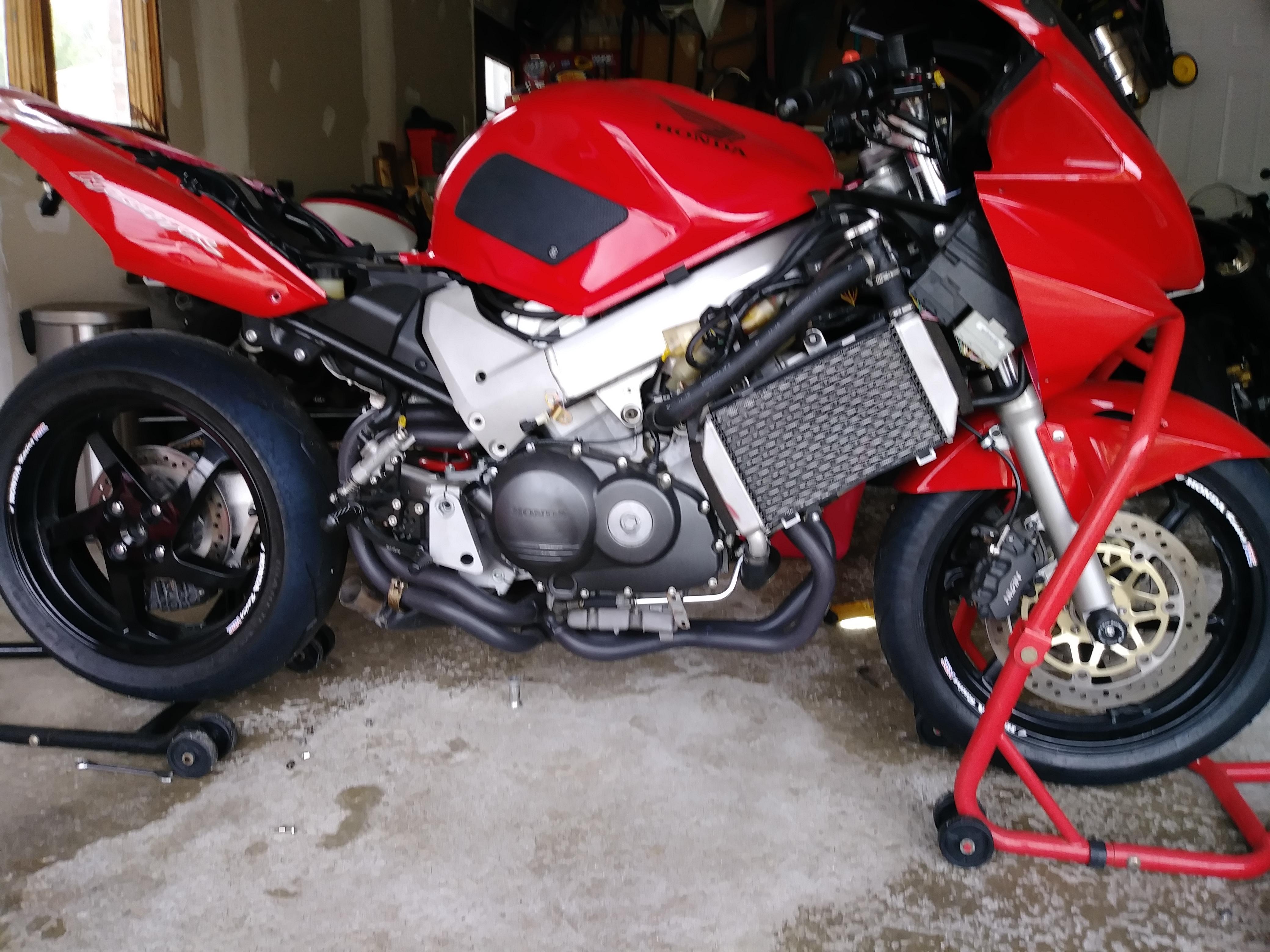

GreginDenver Posted May 10, 2019 Posted May 10, 2019 5 hours ago, JZH said: I wish you'd taken some "after" pics! Ciao, JZH Depending on what you mean by "after" I might be able to show you something. So what do you mean? Quote
Member Contributer interceptor69 Posted May 11, 2019 Member Contributer Posted May 11, 2019 Greg, looks like we have the same slip on. Did the pipe diameter match without any problem?Sent from my SM-G955U using Tapatalk Quote
GreginDenver Posted May 11, 2019 Posted May 11, 2019 7 minutes ago, interceptor69 said: Greg, looks like we have the same slip on. Did the pipe diameter match without any problem? Sent from my SM-G955U using Tapatalk Not sure what you mean by "match." I can tell you that I noted a very slight difference in the diameter of the New Header mid-pipe exit. The New Header exit is just a tiny bit larger than the original 5th Gen exit. When I had my Vance&HinesS4 mounted on the original 5th Gen exhaust I was able to slip it onto the exit using the standard Honda OEM carbon+mesh gasket. When I installed the new header I discovered that due to the New Exhaust's ever-so-slightly-larger exit there was no way to use the Honda OEM carbon+mesh gasket, there just wasn't enough room (the carbon+mesh gasket is pretty delicate so you can't force it into a space that's too small without destroying it). So I ended up using a do-it-yourself custom sized wrap of high-temp aluminum tape (stuff that's good to about 700 degrees F). I don't know if I'll stick with this solution, I had the aluminum tape available at the moment and I wanted to take the bike out on a ride to hear what the New Exhaust + Vance&HinesS4 combo sounded like. Let me know how your install goes, and if you can think up something that's a better substitute for the Honda OEM carbon+mesh gasket. 1 Quote
Member Contributer interceptor69 Posted May 11, 2019 Member Contributer Posted May 11, 2019 Not sure what you mean by "match." I can tell you that I noted a very slight difference in the diameter of the New Header mid-pipe exit. The New Header exit is just a tiny bit larger than the original 5th Gen exit. When I had my Vance&HinesS4 mounted on the original 5th Gen exhaust I was able to slip it onto the exit using the standard Honda OEM carbon+mesh gasket. When I installed the new header I discovered that due to the New Exhaust's ever-so-slightly-larger exit there was no way to use the Honda OEM carbon+mesh gasket, there just wasn't enough room (the carbon+mesh gasket is pretty delicate so you can't force it into a space that's too small without destroying it). So I ended up using a do-it-yourself custom sized wrap of high-temp aluminum tape (stuff that's good to about 700 degrees F). I don't know if I'll stick with this solution, I had the aluminum tape available at the moment and I wanted to take the bike out on a ride to hear what the New Exhaust + Vance&HinesS4 combo sounded like. Let me know how your install goes, and if you can think up something that's a better substitute for the Honda OEM carbon+mesh gasket. Thanks Greg. Sent from my SM-G955U using Tapatalk Quote
Member Contributer JZH Posted May 11, 2019 Member Contributer Posted May 11, 2019 12 hours ago, GreginDenver said: Depending on what you mean by "after" I might be able to show you something. So what do you mean? Unfortunately, I meant pics of the crushed 41mm copper gaskets, to show how they had expanded... Ciao, JZH Quote
GreginDenver Posted May 11, 2019 Posted May 11, 2019 6 hours ago, JZH said: Unfortunately, I meant pics of the crushed 41mm copper gaskets, to show how they had expanded... Ciao, JZH Yeah, sorry, you know how it goes, when you've decided on the solution you're going to use it puts the finish line in sight and you start looking forward to test-riding the bike. I definitely preferred the results I got with the 41mm copper gaskets over what happened when I tested the 42mm copper gaskets. This is still very much a situation that's "in play", it may turn out that another New Header purchase forum member will come up with the discovery of a completely different gasket solution that would be better than the 41mm copper gaskets from Delkevic. But at this point I firmly believe in the 41mm as the best solution I had available. I was very impressed by how neat and easy it was to install my New Header. I used a "spreader" type clamp to ease the header around the center stand crossbar (which is slightly smaller than the center stand leg), this worked great. My New Header matched up to the exhaust ports just as others have described, so I used a couple of Thule Rack cargo straps to put some pull force on where I needed it, like having an extra pair of hands. 1 Quote

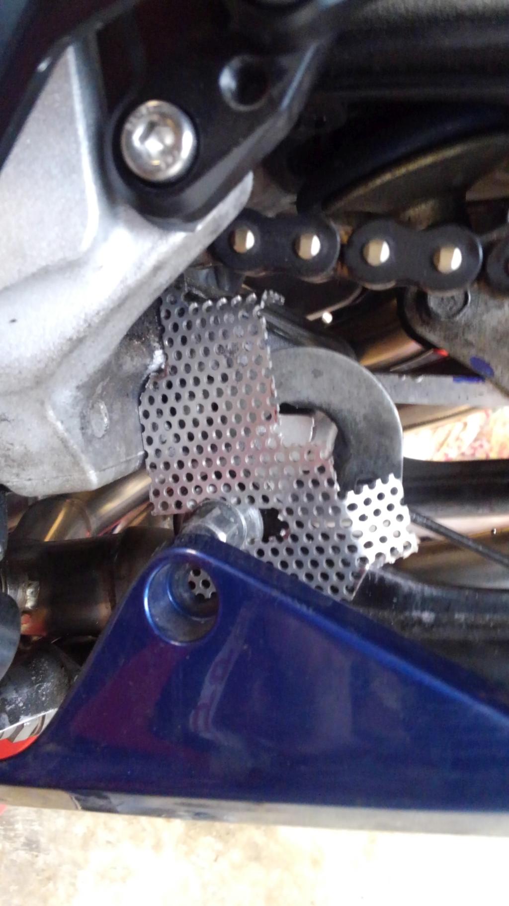

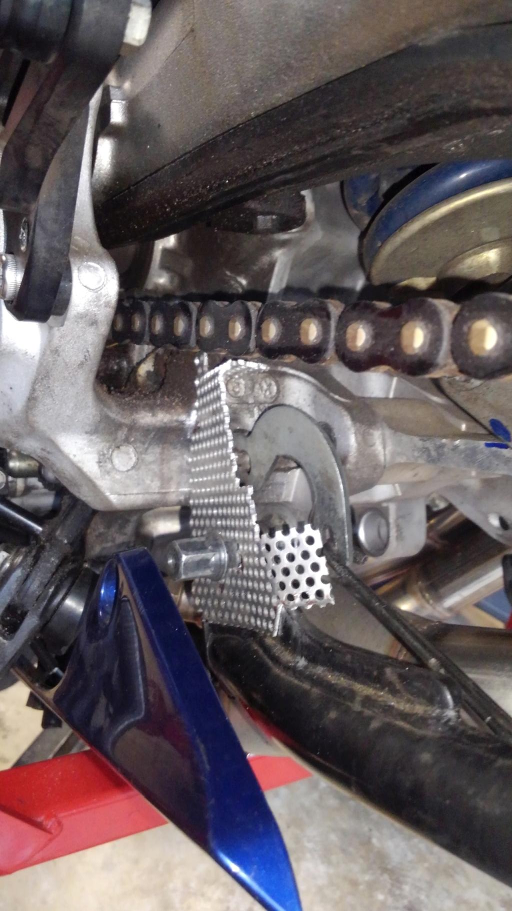

Member Contributer carlgustav Posted May 12, 2019 Member Contributer Posted May 12, 2019 After spending the afternoon looking at ideas for a center stand stop (here and my own), and realizing they weren't suitable for me, I took inspiration from pics that Duc2V4 posted earlier. Made a mockup out of some perforated aluminum that's easy to bend/cut. This is working and holding the center stand where I want it. Now I need to use this template to cut/bend some thicker aluminum I have that's a somewhat bendable alloy. Or I may just get some sheet steel from the local hardware store, might be easier to work with. In no way will this look as good as the stuff many folks on this forum are capable of producing, but once finished and painted matte black, the piece should fade into the background and not be very noticeable. I may also put a piece of rubber on the end where the stand makes contact, we'll see. I need to make sure I put the hole for the bolt in the right spot to eliminate, or at least minimize, pivot movement. Even with the slot, it's pretty solid now, but over time a slot wouldn't work. One could get carried away and add an additional bend, drill a hole for the spring post, giving the piece another spot to jam up against. For me, that's more work than I want to do, and my fabrication skills are minimal. Maybe this helps, maybe it amuses, either way I felt the urge to post 😄. ACE 2 Quote

Member Contributer sfdownhill Posted May 13, 2019 Author Member Contributer Posted May 13, 2019 On 5/11/2019 at 5:33 PM, carlgustav said: Made a mockup out of some perforated aluminum that's easy to bend/cut. Man, the folks on this forum come up with some of the coolest ideas! carlgustav, that perf metal is brilliant for prototyping - bends as easy as cardboard, but stays bent. Quote

Member Contributer carlgustav Posted May 13, 2019 Member Contributer Posted May 13, 2019 14 hours ago, sfdownhill said: Man, the folks on this forum come up with some of the coolest ideas! carlgustav, that perf metal is brilliant for prototyping - bends as easy as cardboard, but stays bent. Thx. I got the stuff to make a front brake res. mount for my R6, and to experiment with. The mount doesn't look great but it works, and track bikes occasionally fall down reducing good looks anyway. A caveat, for tight bends like 90, you get about one bend, as flexing this stuff will soon tear it. Random thoughts. Whatever material I end up using on this side needs to be strong enough to handle repeated bashing by the center stand, I don't think 1/16" sheet alum, or even mild steel, will work. Stronger material, looking at 1/8", is thicker, so the bolt sits out farther than designed. I wonder if strength is reduced too much with respect to the strain this bolt normally 'sees'? The stand curves outward, so a slight dual bend in the piece to compensate is indicated, but is not easy to create. Without fab shop tools and skills, this is a tedious process for something so minor. ACE Quote

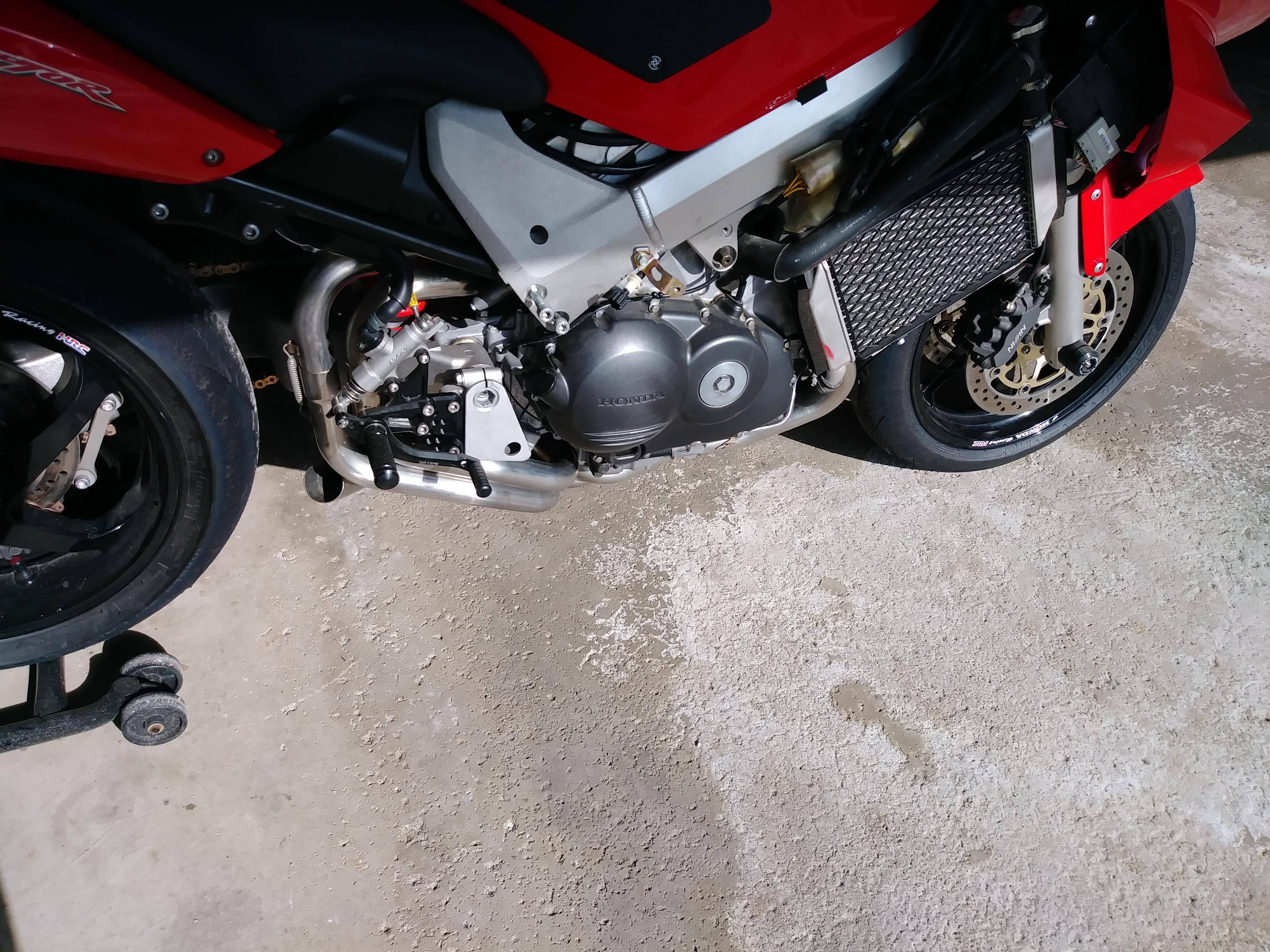

VFR750F3 Posted May 20, 2019 Posted May 20, 2019 Finally put on exhaust on easy peasy the weight diffference is 3 pounds lighter than my delkevic. The delkevic header is powder coated the two brother exhaust is also for sale one dummy can. I might sell a leo vince beautiful bends no mufflers. I will weigh the stock header its in the attic thats for sale and so is a plethora of Vfr750f parts ie whole bike 86 some 93 also 8 spoke sold. 20190520_155555.mp4 1 Quote
