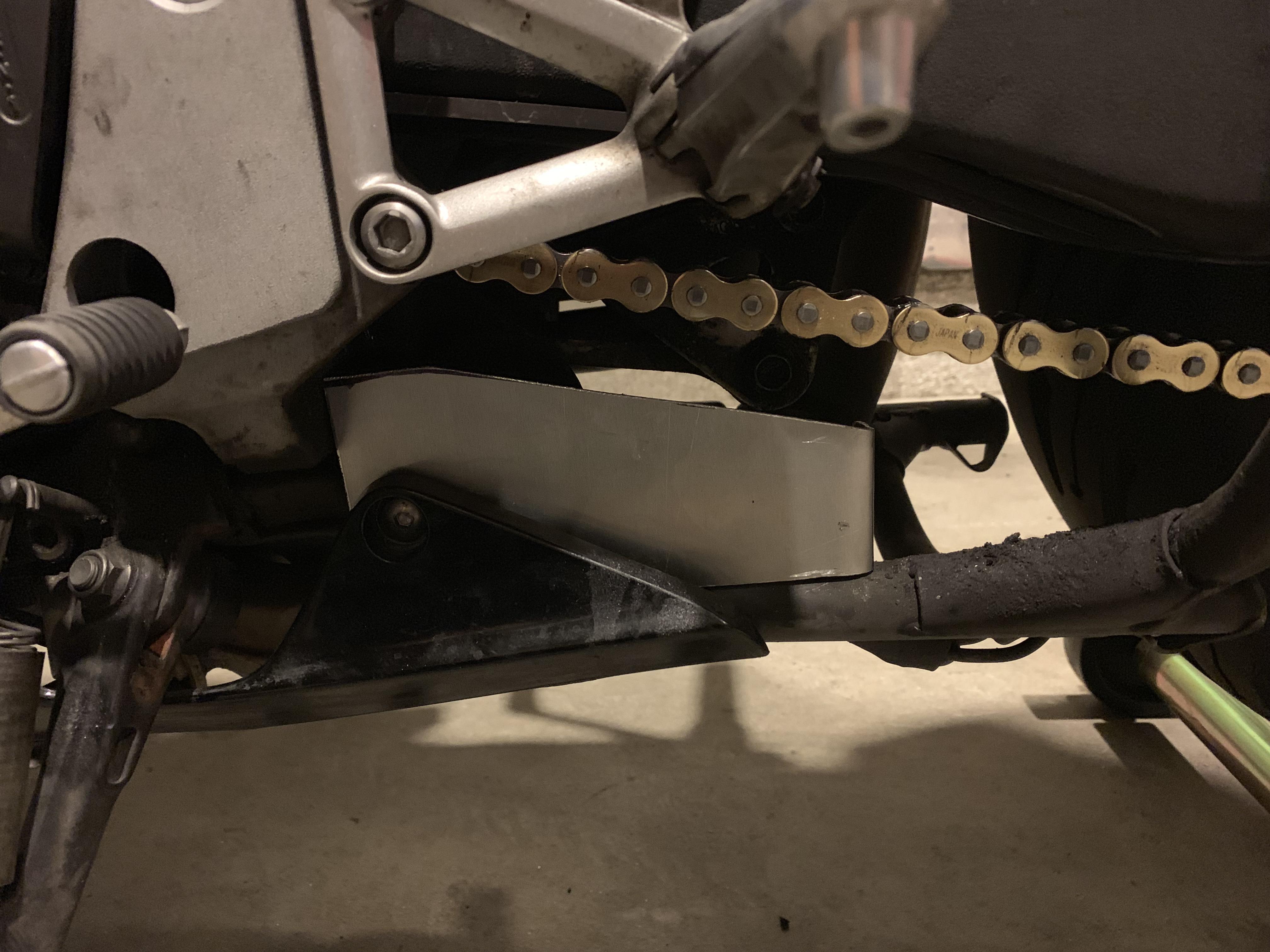

Neo2122 Posted May 1, 2019 Posted May 1, 2019 Here's a simple solution for the center stand stopper guys. All I did is I took one of the old header clamps (2nd pic), flattened it out and removed the threaded end of the clamp. I then dropped out the hole in the one end slightly bigger so I could place the OEM rubber stopper in the factory headers into the hole, then I simply just secured it to the center stand with hose clamps!Sent from my XT1710-02 using Tapatalk 1 Quote

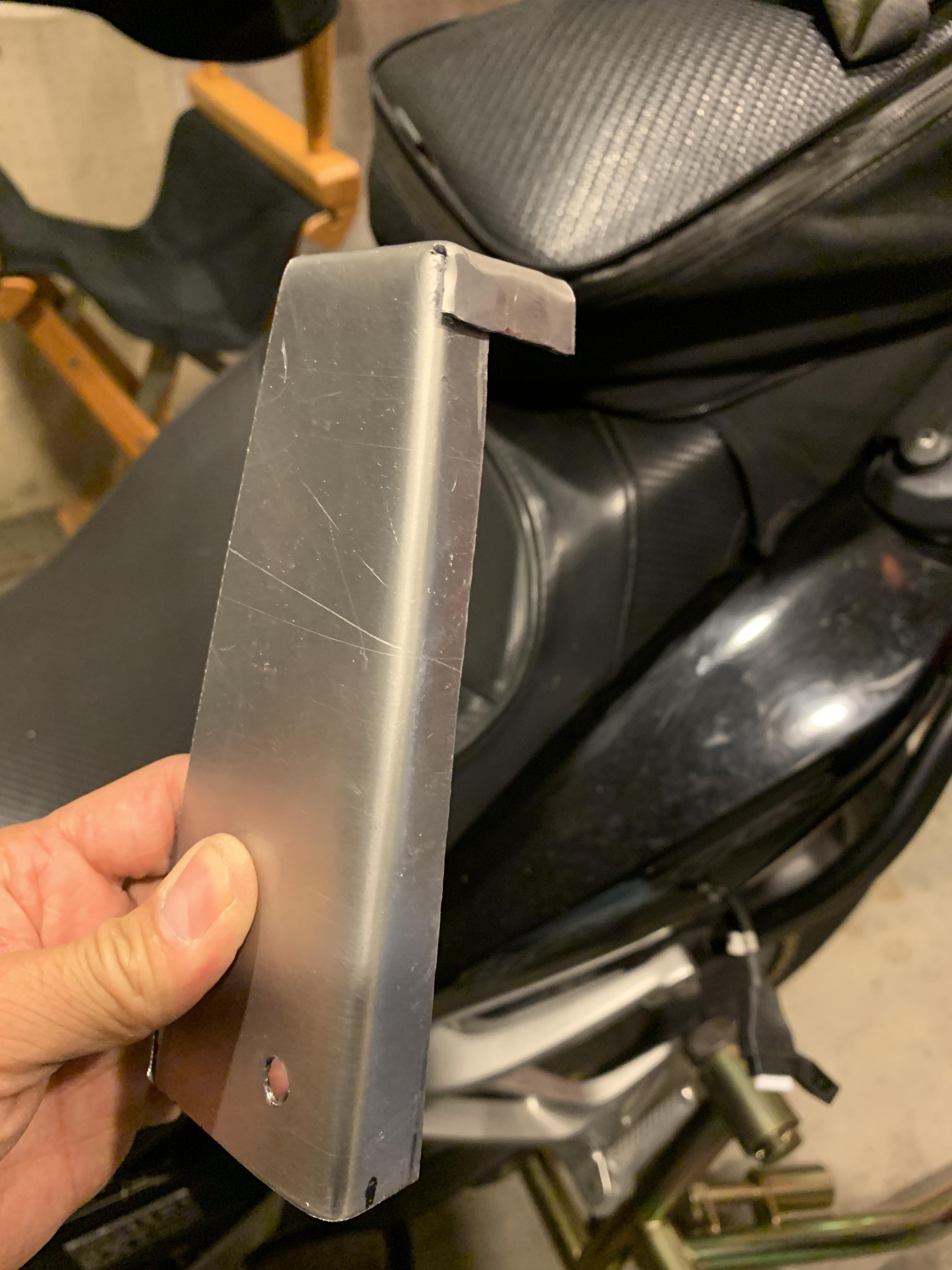

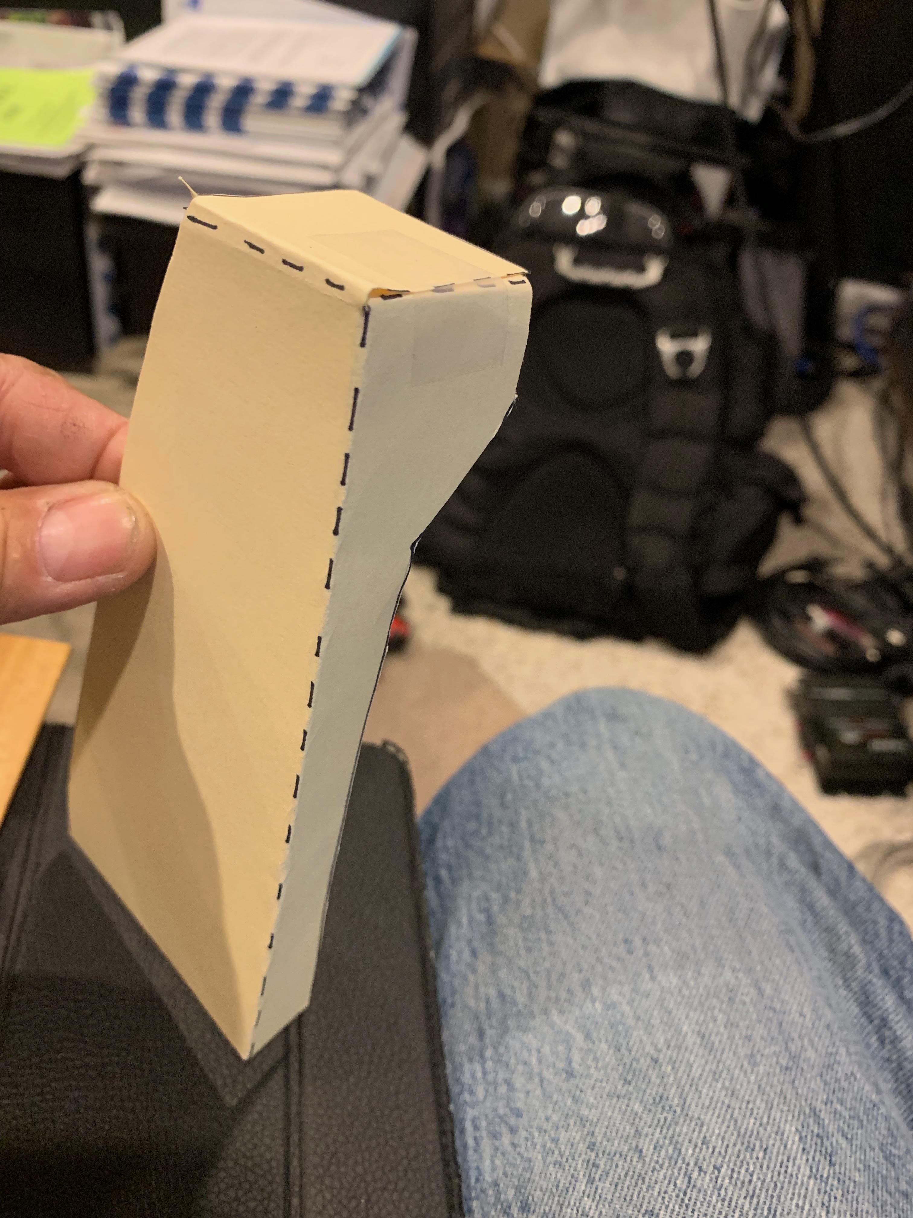

Member Contributer Duc2V4 Posted May 1, 2019 Member Contributer Posted May 1, 2019 BTW, here is what I did last night and is what I had forwarded to Seb (via pictures). Hopefully I am on the right track but I'm sure Seb's talent could easily surpass mine! I added a little twist to the V&N solution and put a little bend in the vertical section to give it a little more strength. Pay no mind to the looks, I did this with simple hand tools and a small vice. For my template, I added a bigger section on the bottom so a hole could be added to use the OEM rubber stop. Let's see if Seb finds this viable or if he can improve on it or come up with something even better. 4 Quote
Member Contributer MooseMoose Posted May 1, 2019 Member Contributer Posted May 1, 2019 1 hour ago, Duc2V4 said: BTW, here is what I did last night and is what I had forwarded to Seb (via pictures). Hopefully I am on the right track but I'm sure Seb's talent could easily surpass mine! Does that push against the frame? So it has a nice hard stop? This might be a great solution. One more bend for rigidity, a bump stop, and it'd be pretty elegant. Paint it black and I bet it just sort of disappears into the frame, visually. Nobody would pay attention who wasn't specifically looking for it. This is a nice proof of concept/hand tool prototype. I love clever little things like this. 1 Quote

Member Contributer Duc2V4 Posted May 1, 2019 Member Contributer Posted May 1, 2019 2 hours ago, MooseMoose said: Does that push against the frame? So it has a nice hard stop? This might be a great solution. One more bend for rigidity, a bump stop, and it'd be pretty elegant. Paint it black and I bet it just sort of disappears into the frame, visually. Nobody would pay attention who wasn't specifically looking for it. This is a nice proof of concept/hand tool prototype. I love clever little things like this. It pushes up against the cush or engine, I'd have to take a closer look but yes, adding a bend and/or use thicker metal would provide more rigidity. Quote

Member Contributer MooseMoose Posted May 2, 2019 Member Contributer Posted May 2, 2019 3 hours ago, Duc2V4 said: It pushes up against the cush or engine, I'd have to take a closer look but yes, adding a bend and/or use thicker metal would provide more rigidity. I'm not picking on your prototype. I do my fair share of brakeless sheet metal bending as well, and there's only so much you can do with a vice and a hammer. That one's a perfect proof of concept. I was just sort of thinking as I typed. Since it buts up against he case there it is going to have no problem rotating with just one mounting bolt is what I was thinking about. I don't know what Seb's shop has for brakes, though, but he's good enough at solving problems I'm confident he will come up with something that he can produce out of this. 1 Quote
Member Contributer Duc2V4 Posted May 2, 2019 Member Contributer Posted May 2, 2019 1 hour ago, MooseMoose said: I'm not picking on your prototype. I do my fair share of brakeless sheet metal bending as well, and there's only so much you can do with a vice and a hammer. That one's a perfect proof of concept. I was just sort of thinking as I typed. Since it buts up against he case there it is going to have no problem rotating with just one mounting bolt is what I was thinking about. I don't know what Seb's shop has for brakes, though, but he's good enough at solving problems I'm confident he will come up with something that he can produce out of this. Good question, based on the Vance and Hines sample I saw, it just uses one bolt as well. When the stand is in the up position, it causes the stop to push into the engine case and when using the stand, tension on the bolt seems to keep it in place. Quote

Member Contributer MooseMoose Posted May 2, 2019 Member Contributer Posted May 2, 2019 Guys, don't stress over this. I'm not challenging it at all. I just wanted to know how it worked. Engineering wise, you can't put something on one mounting point and expect it to not rotate. You have to have two points, preferably with some spacing, to create the leverage necessary, and that one creates it by butting up against the case as the second point of contact. That's all the question was. Idle curiosity about a different design that solves this problem in an innovative way. Quote
