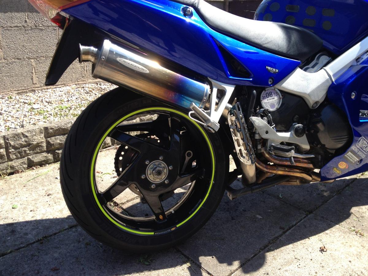

Member Contributer Mohawk Posted April 28, 2019 Member Contributer Posted April 28, 2019 When I added my custom High mount pipe, I forgot to spec a stand stop. So I bought some 4mm wall silicone hose cut a 2” length then slit it along one side. Slid it on to the right leg of the centre stand, whilst the bike was on the side stand, adjusted it in place to centre on the contact with the exhaust & cut a little away to fit around the stand cross bar. Once all adjusted, I cable tied it in place. Worked a treat ! 4 Quote

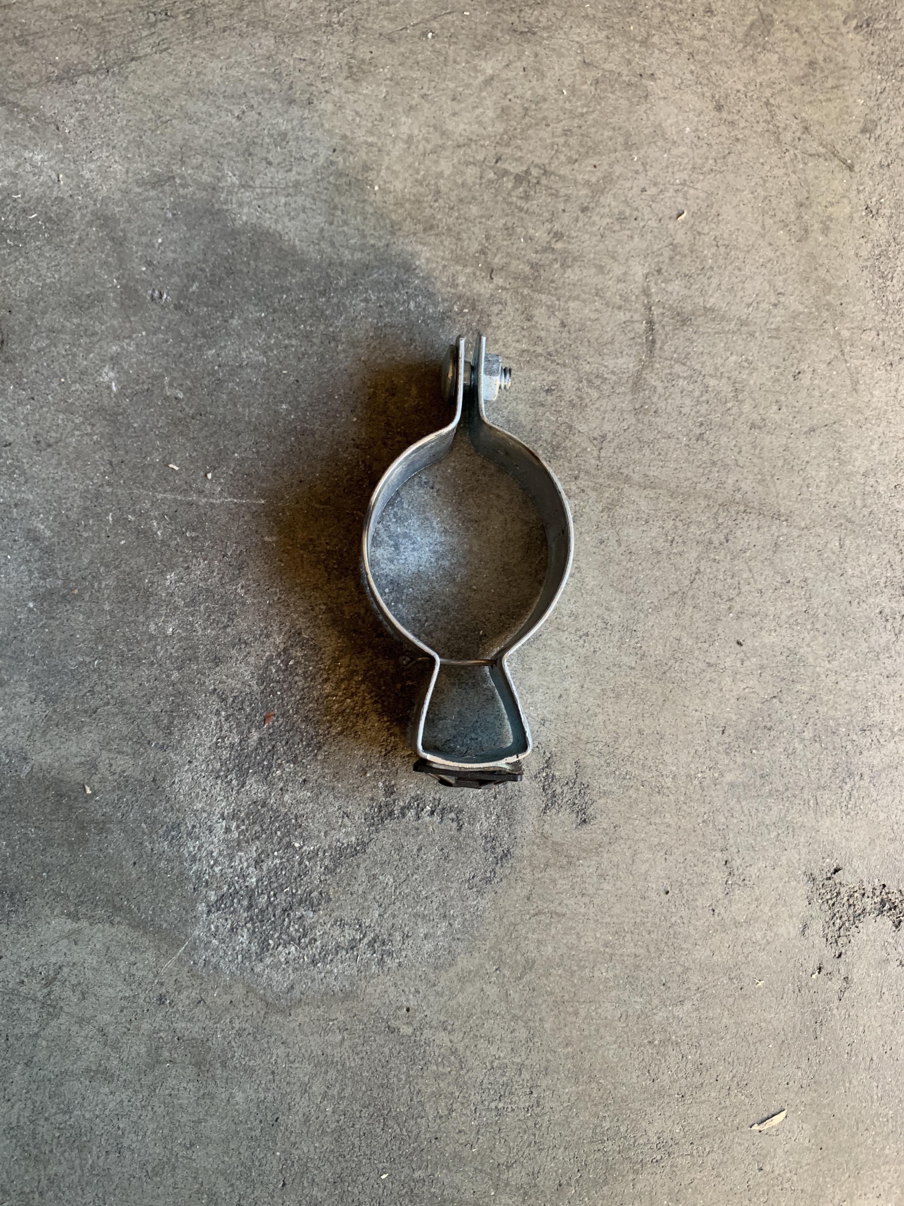

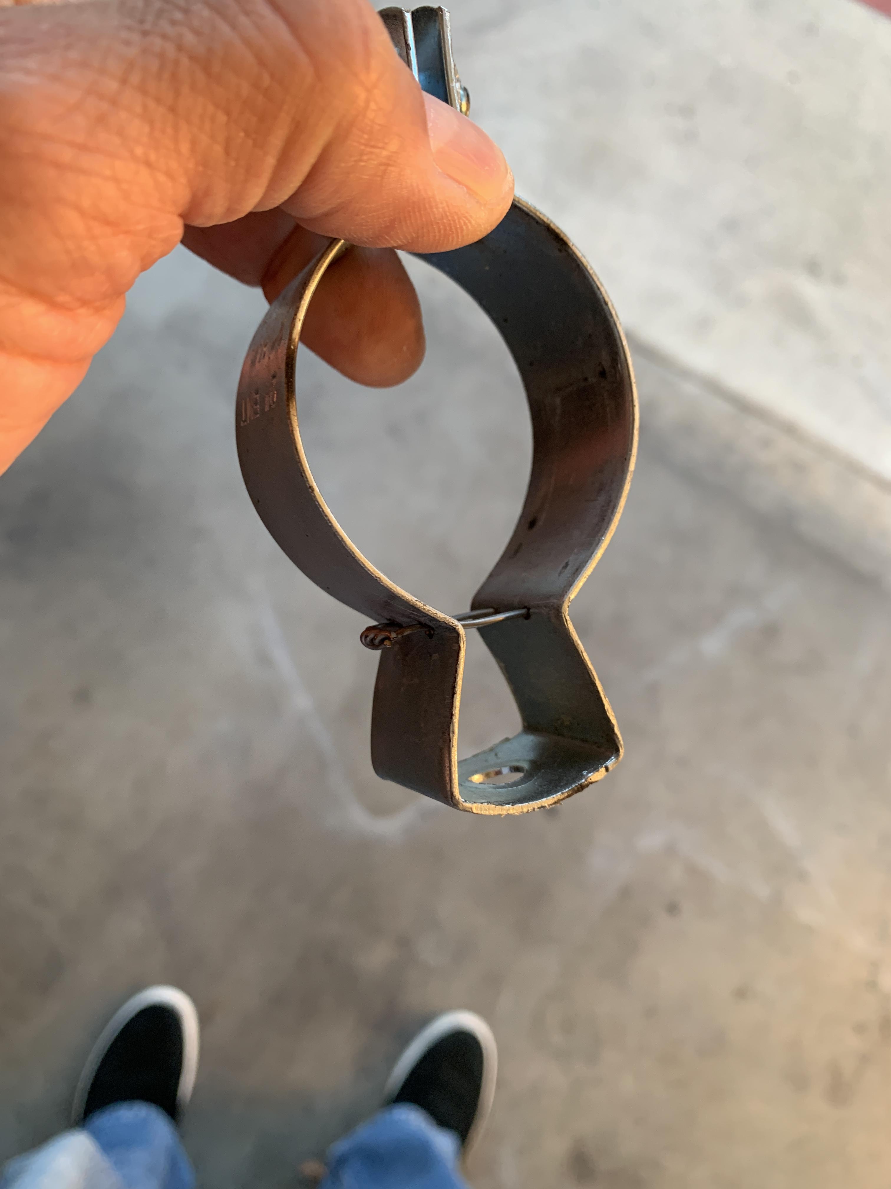

Member Contributer Duc2V4 Posted April 28, 2019 Member Contributer Posted April 28, 2019 Although I am going to put my set on m y 5 Gen, sans center stand, I am on the waiting list for Center Stand Stop for my 6 Gen. When I put a set of 98-99 cat-less headers on my 6 Gen, I had to come up with a solution. I came up with a temporary one. I went to Home Depot and bought a conduit hanger and did a little adjustment to it. In order to keep the tension of the clamp, I drilled 4 holes in the bend and looped some safety wire through it. Instead of a rubber bumper, I ended up putting a zip tie mount on the bottom. It worked great but wanted something a little more elegant, hence being on the waiting list for a new one. 2 Quote

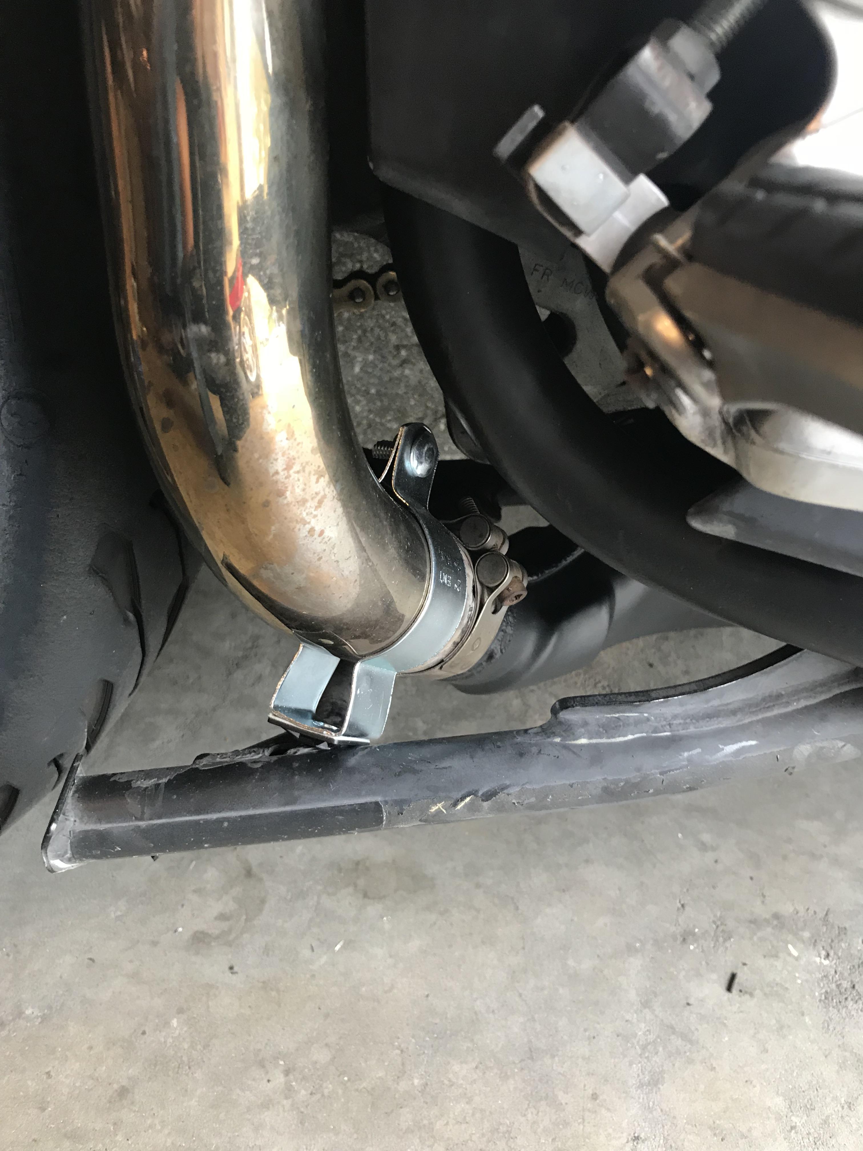

Member Contributer interceptor69 Posted April 28, 2019 Member Contributer Posted April 28, 2019 When i bought the Vance & Hines titanium pipe it came with a piece that works as a centerstand stop. It wouldn't be difficult to fabricate. Here's a photo or two. U can see why I ordered new headers!Sent from my SM-G955U using Tapatalk 2 Quote

Member Contributer Duc2V4 Posted April 28, 2019 Member Contributer Posted April 28, 2019 38 minutes ago, interceptor69 said: When i bought the Vance & Hines titanium pipe it came with a piece that works as a centerstand stop. It wouldn't be difficult to fabricate. Here's a photo or two. U can see why I ordered new headers! Sent from my SM-G955U using Tapatalk Exactly, this is what I saw yesterday on the friends 5 Gen I was working on. I sent a picture to SF and we think this is a possible solution. I was going to mock up something later today and see if I can fit it to my 6 Gen. Or at least try, since I was in the garage all day yesterday the wife is asking for her time time! 🙂 1 Quote

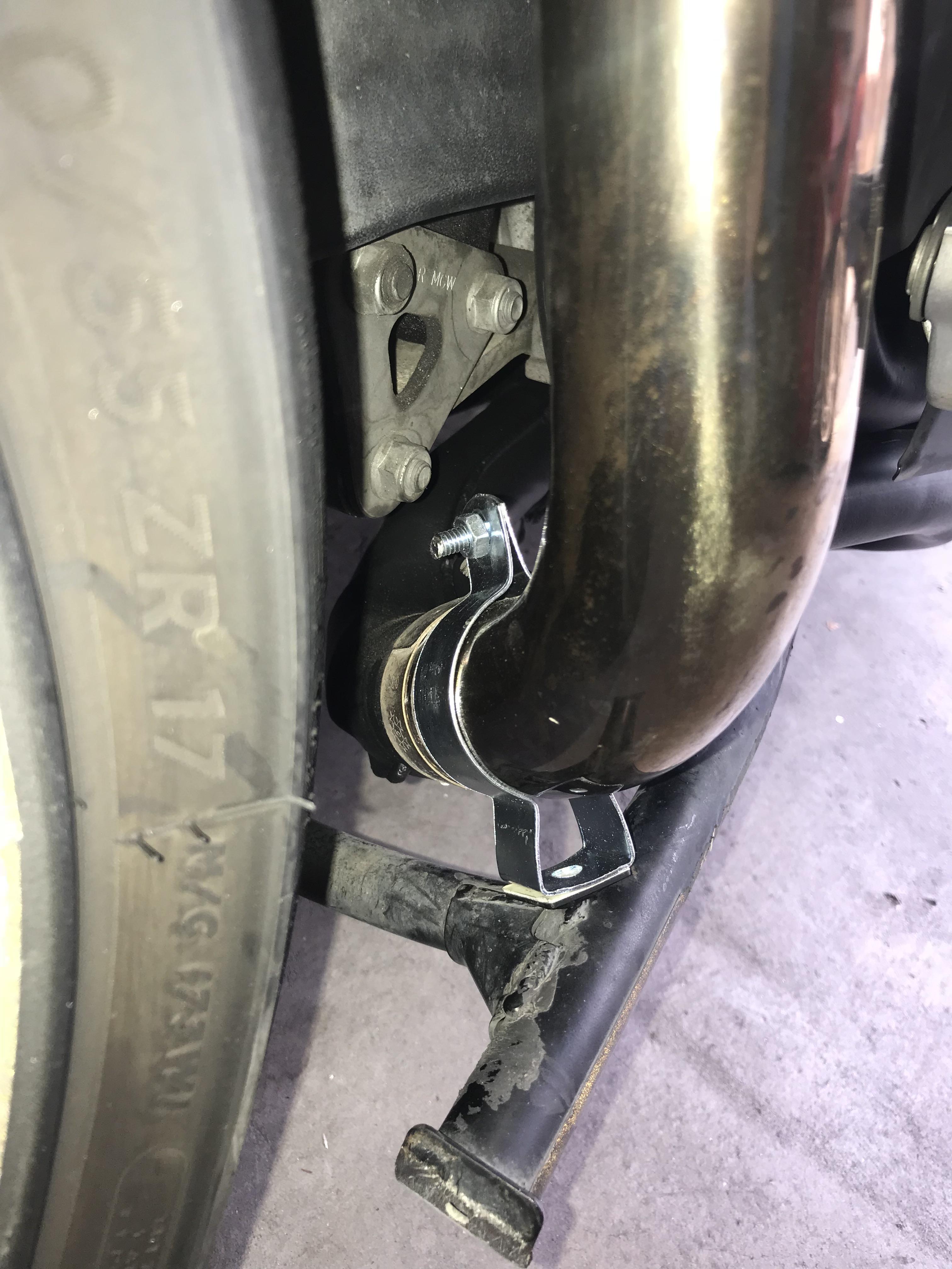

Member Contributer Mohawk Posted April 28, 2019 Member Contributer Posted April 28, 2019 Hard to see in this pic but best I have unfortunately. 2 Quote
