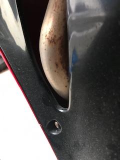

Just finished bike for road america front right header melted plastic.  Incorrectly bent.  Disappointed
Mine also just barely touched the plastic shield there, I just trimmed a 1/4" section near the pipe and have had zero problems
 Yeah, you're probably right; those headers are rubbish. I'll give you five bucks for them.
Not completely rubbish i can pop clutchless wheelies now.
You sure I can't tempt you? I mean, it melted your little plastic doofer and everything. Five bucks and a packet of Cheetos, that's my final offer.
^^^ What he said. They are performance headers NOT OEM replacements, there may be minor clearance issues.

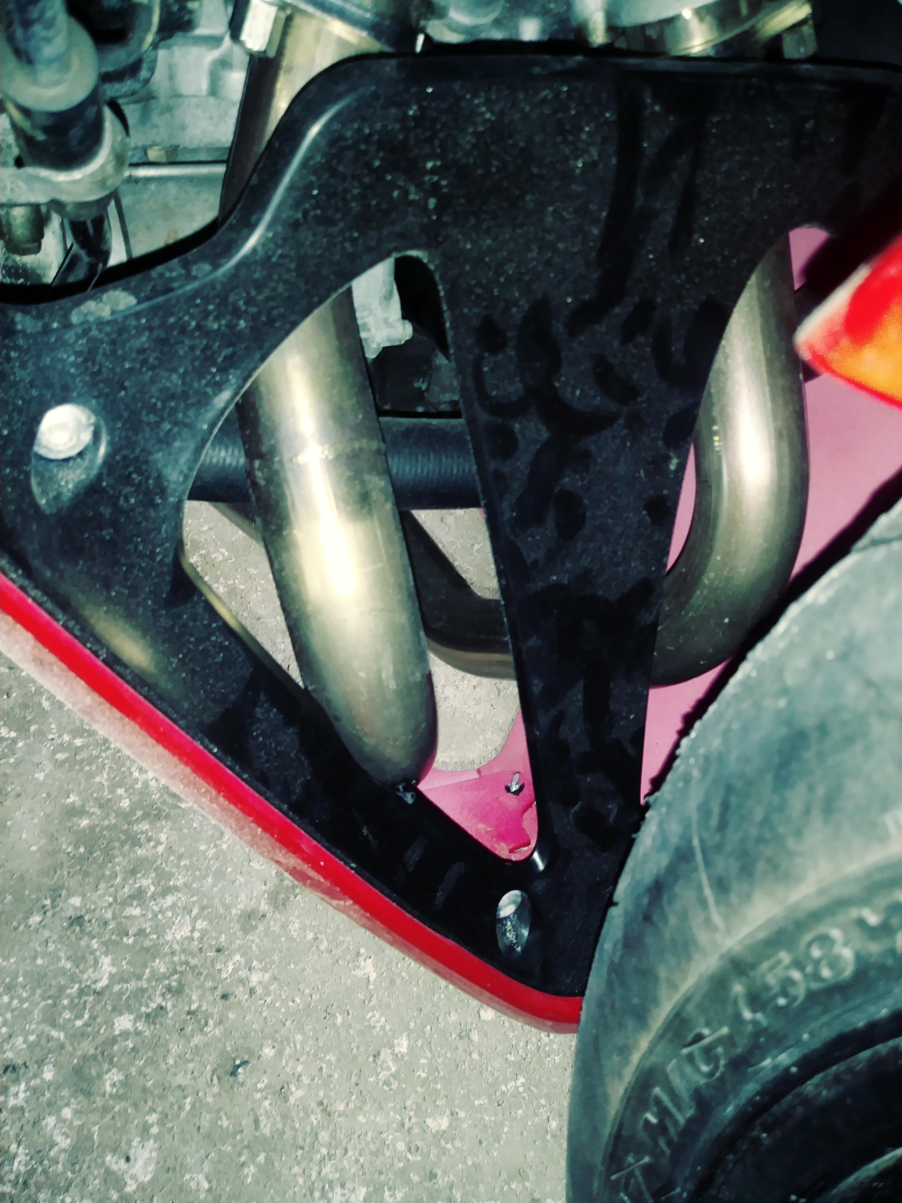

I’ve never looked closely at an 8th gen fairing lower V, but I’m stunned by your picture & how big those holes are, Honda must have no faith in their own exhaust manufacturing now, if you compare those with the pipe cooling holes on 5/6th gens !
What’s a little melted plastic when you get such benefits !?
YCMV. ( your clearance may vary !)
Pretty sure he's got a 5/6 - 8th has radiator down there and therefore larger holes in the vee, to allow air flow

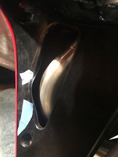

As others have already said, I like the "new header" enough that I'm willing to live with a little inconvenience.  Here are pictures of my work to provide clearance for the header from the #4 cylinder.
I imitated sfdownhill's solution to the problem, I used a heat gun to soften up the plastic so it could be re-formed with an outward bend that gives the #4 cylinder's header about the same amount of clearance as the #2 cylinder's header pipe.
Installed on the bike you can see that I've managed to achieve the same amount of fairing-to-header pipe clearance on both the #4 and #2 headers.
I happened to have some high temperature heat reflecting tape on hand so I added it to the work I did.  I figured why not, regardless of whether the situation really needed this amount of protection
Maybe I got a little carried away with the heat reflective taping...
