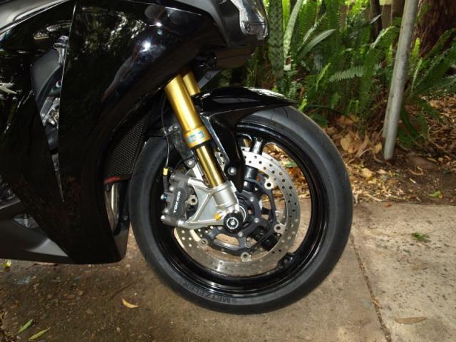

Member Contributer karhawk Posted June 16, 2012 Member Contributer Posted June 16, 2012 Mine was worth it for the bling factor the 6 piston calipers and 320mm rotors don't hurt. Quote
Member Contributer lancando Posted November 13, 2013 Member Contributer Posted November 13, 2013 Mine was worth it for the bling factor the 6 piston calipers and 320mm rotors don't hurt. what forks are those. year etc Quote
