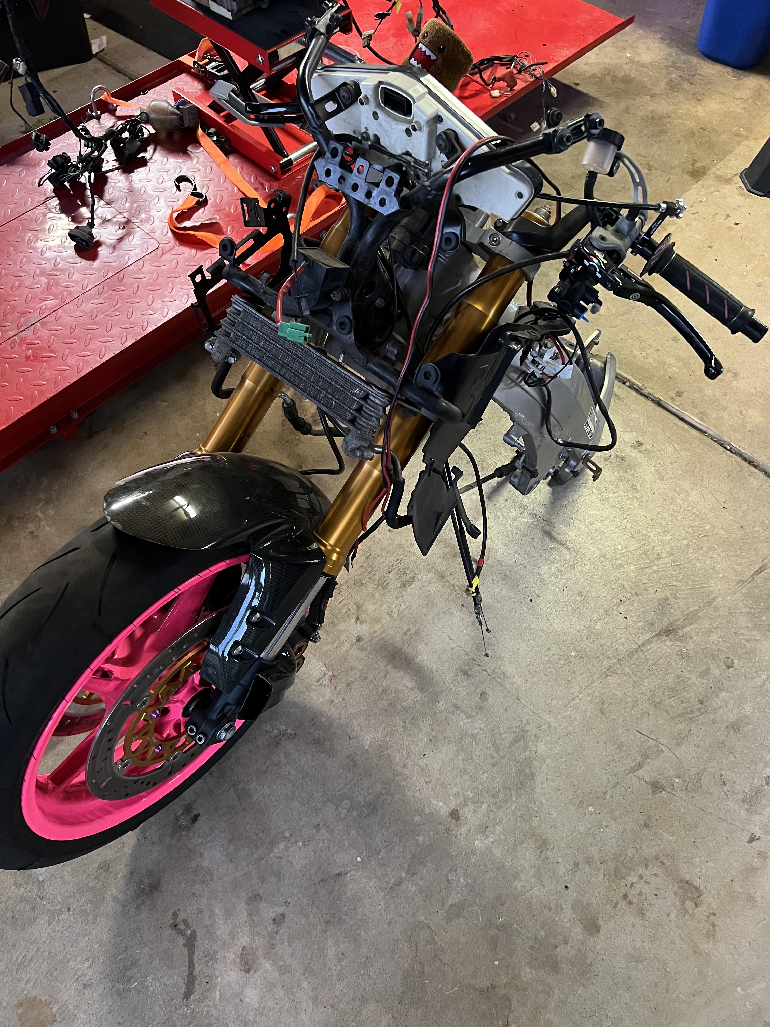

I was searching something and came across this thread. Realized I never finished my build thread.
to answer the question Absofuckinglutely!
2002 with 77k on the clock
08 engine and ECU with just under 7500 miles
2006 LE YZF-R1 complete front end
Sebspeed custom triple trees
forks built by Jamie at DMr
There is an absolute ton more done to this bike but that’s the front end setup and here’s a few pics.
