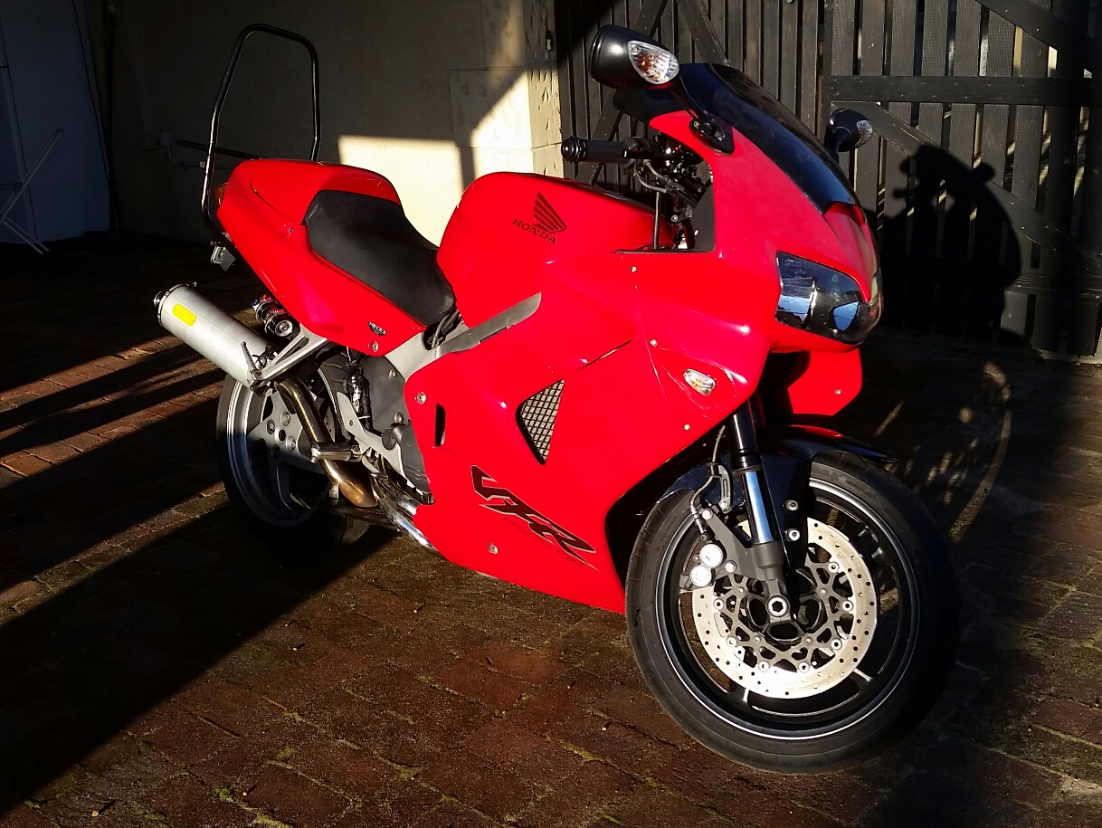

Member Contributer shaynus Posted January 16, 2018 Member Contributer Posted January 16, 2018 While not exactly entirely R1, the front end on my 5th gen is a combination of R1 yokes, FZ1 forks / brakes /wheel and 50mm fork extensions to enable me to use VFR1200 clip ons. I'm happy with the result! :-) Quote
CandyRedRC46 Posted February 7, 2018 Posted February 7, 2018 On 1/16/2018 at 10:07 AM, shaynus said: While not exactly entirely R1, the front end on my 5th gen is a combination of R1 yokes, FZ1 forks / brakes /wheel and 50mm fork extensions to enable me to use VFR1200 clip ons. I'm happy with the result! :-) Thats pretty cool! Quote
Member Contributer shaynus Posted February 7, 2018 Member Contributer Posted February 7, 2018 9 hours ago, CandyRedRC46 said: Thats pretty cool! Thank you! (I think so too!) :-) 1 Quote
