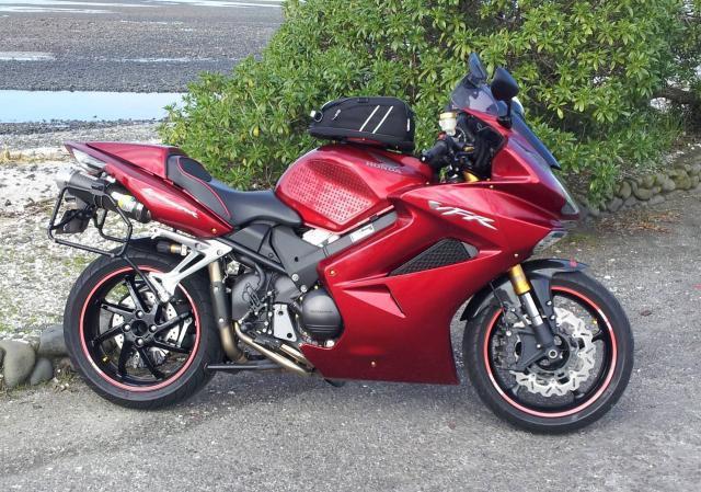

Member Contributer HighSideNZ Posted July 4, 2014 Member Contributer Posted July 4, 2014 Thought I'd add my R1 conversion to the mix. Details are here: http://www.vfrdiscussion.com/forum/index.php/topic/77541-another-r1-front-end-conversion/ As I outlined in the post specifically about the conversion, I'm in complete agreement with the major change to the bikes handling. It has built greater confidence and as someone else on this post has stated, with greater confidence comes better safety margins. Must add that I've got an Ohlins on the rear as well. I would do it again in a flash. Well worth it. Here's a pic of the finished product. Cheers Phil 1 Quote

CandyRedRC46 Posted July 4, 2014 Posted July 4, 2014 Thought I'd add my R1 conversion to the mix. Details are here: http://www.vfrdiscussion.com/forum/index.php/topic/77541-another-r1-front-end-conversion/ As I outlined in the post specifically about the conversion, I'm in complete agreement with the major change to the bikes handling. It has built greater confidence and as someone else on this post has stated, with greater confidence comes better safety margins. Must add that I've got an Ohlins on the rear as well. I would do it again in a flash. Well worth it. Here's a pic of the finished product. Cheers Phil 20140629_131238-sml.jpg Damn Phil you got me beat! lol that's the 07 plus R1 front end huh? Sent from my iPhone using Tapatalk Quote
Member Contributer HighSideNZ Posted July 5, 2014 Member Contributer Posted July 5, 2014 It's a 2010 model with the R1 front end. We were lucky enough in NZ to still have them available new up until last year. There are some dealers still with Gen 6 new stock on there floors. R1 front end make a huge difference. Phil 1 Quote
