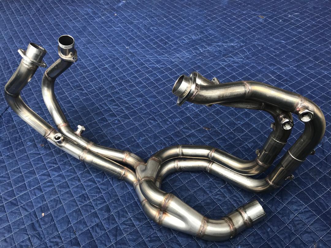

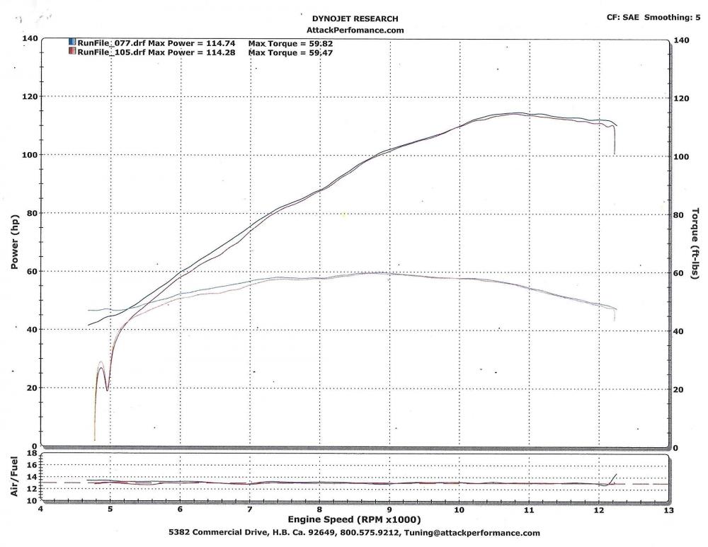

We finished up a second phase of R&D Thursday - dyno testing of the header - prototype #2 - in the photos below at Attack Performance. All this means is that one well researched attempt to improve on header #1 only proved #1 to be better. Production continues w header #1 the original TBR replica as scheduled.
I am driving out to Wade’s shop Tuesday to go over proper alignment of the collector exit, taking along 98/99 headers, TBR headers, a center stand, and maybe the fitment bike.

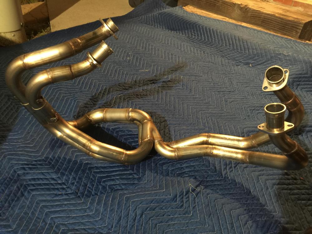

Here is header #2:
055BD752-6FF1-4960-A6B1-9720B92079E4.thumb.jpeg.9d5c259282925912a631e9bab7ef2d26.jpegAE1DBC45-A8EB-4979-9CD8-50EE0DBE0BED.thumb.jpeg.72fc957cf5a566ce37abc1b0ba21e6de.jpegFF08B3FB-CA53-4100-B24E-1610EE1AEBB8.thumb.jpeg.591897120da923fd351bcd7239b0199e.jpeg

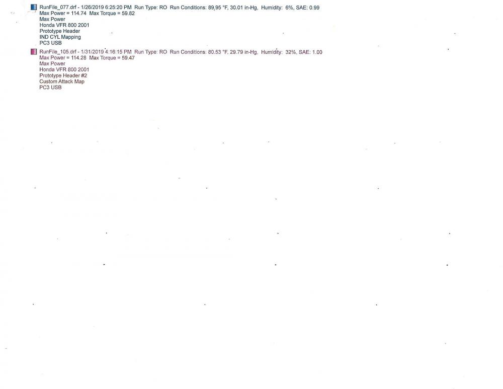

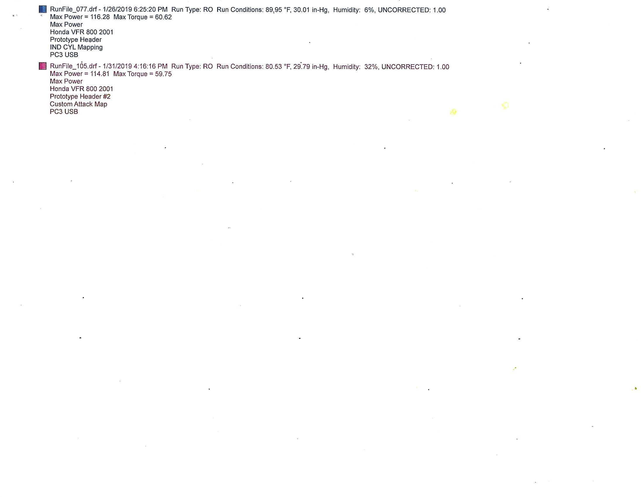

Based on (1) exhaust theory of keeping gas velocity high through the port by maintaining a slightly smaller diameter in the first few inches of the primaries, (2) Wade’s success with this concept on his dwarf car and Razr headers (3) Black Widow and Lextek’s use of this concept,
we had Wade build a second prototype with smaller 35mm od for the first 3.5 inches starting at the exhaust port.

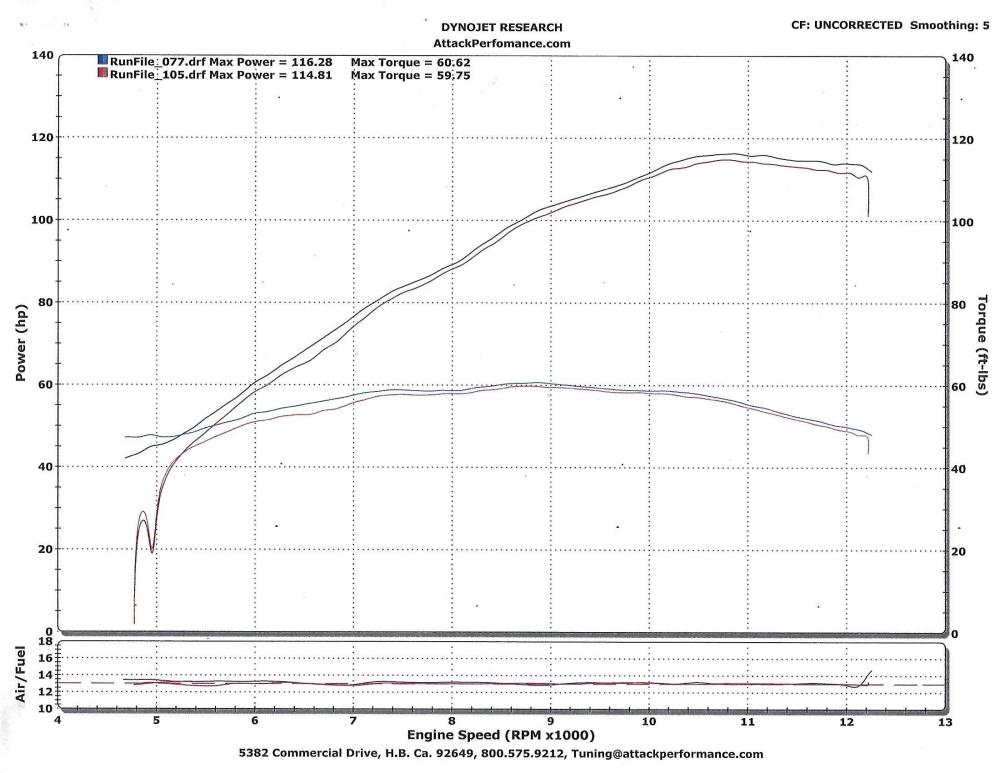

The results are clear - header #1 we tested on Saturday Jan 26 is definitely better. This chart shows header #2 down a couple hp and ft/lbs across the entire range, especially in midrange264F88FC-F6E3-4B8F-95D6-466DA36A2A6C.thumb.jpeg.7219097ff09fdb865d8c7f59d6c9d362.jpegA3001160-E6E2-4363-9716-7DAC20C2FCFD.thumb.jpeg.7182a2e5ba47e08ba7d20759d1db9c6e.jpeg
Note: Dynojet dynos/software correct temperature, humidity, and altitude to a standard density altitude. This means the software corrects to a standard the same way aviation performance calculations are made, ie “Can this aircraft generate enough power and lift to take off from this runway at this weight, altitude, temperature, and humidity?”
Dynojet’s correction calcs are not perfect, and neither is my spelling, but they are better than nothing. Here is an uncorrected  comparison of last Saturday’s run of header #1 against Thursday’s run of header #2:

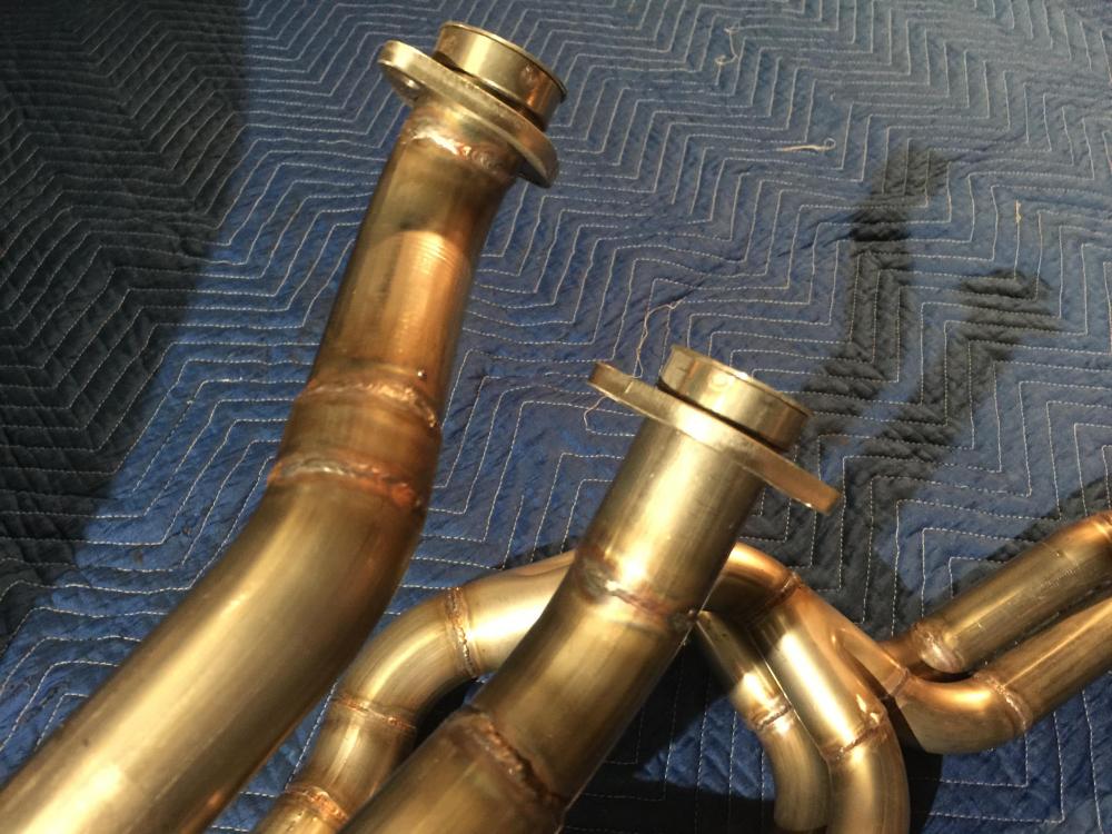

Just out of curiosity, are the welds/joints in the taper regions smooth inside?  A discontinuous change in diameter (step up or down) will lead to turbulence that disrupts the speed of the central laminar flow region.  Of course exhaust gasses flow in pulses, which contrasts with the relatively steady pressure of HVAC air handling fans, so there may be factors I'm not aware of.

MadScientist, your expertise goes right to the crux...at the welds inside the primaries of header #2 there are bits of weld material just barely protruding into the gas path around the internal circumference. I tried to reach in with the Dremel extension and hone down the intrusive weld material, but those bits are tough! They laughed at the high speed grinding tip. Yes, something in header #2 disrupted the combination of factors that make the TBR design so effective.

Update - there’s not a lot to update. Wednesday I dropped off Prototype #1 at the metal finsher’s to be passivated (acid dipped). They’ll do this first set of headers for $110, and batches of 5 headers for $95 each. I’ll post photos of the treated headers later this week.
Production headers are underway, but Wade was sick last week and bowed out of our Tuesday meeting. He’s feeling better (racing motocross sidecars in CA this weekend!) and I’m heading to his shop tomorrow. Objectives for this meeting are:
(1) refine our approach to collector exit matching OEM angle/position - relates to having had only TBR and OEM 6th gen headers on hand when making the jig for the prototype. The cat on the 6th gen headers didn’t allow an accurate measurement of the OEM exit angle/position, so I’m taking 98/99 headers to Wade to confirm production units match OEM angle/position (98/99 tubing and merges allow measurement & duplication).
(2) examine clearance required between the collector exit pipe and the bottom curve of cylinder #1 primary as relates to the header fitting over the diameter of the right side center stand leg during installation. Clearance at this point on Prototype #2 is enough to just squeeze over the right center stand leg, so the center  stand doesn’t have to be removed to install or remove the headers. Clearance at this point on Prototype #1 isn’t enough to allow the header to pass around the center stand during installation - we had to remove the center stand, thread it through the headers, then mount the center stand with the headers dangling down at the base of the stand like pants around one’s ankles, then mount the headers.

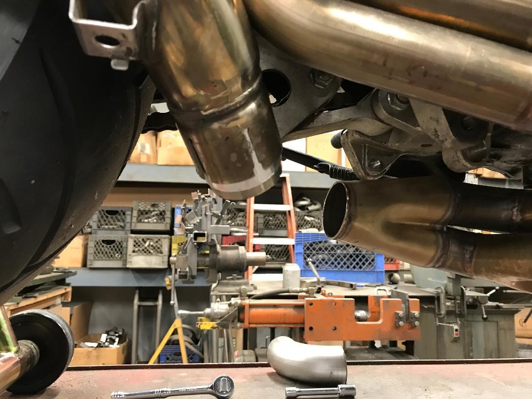

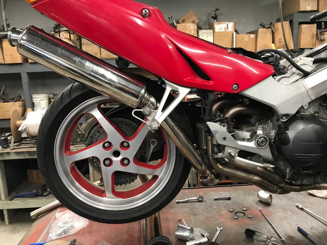

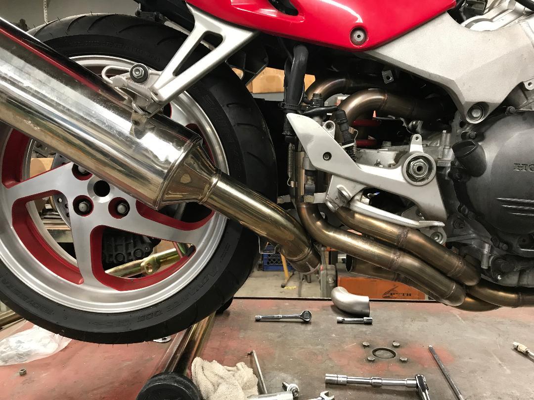

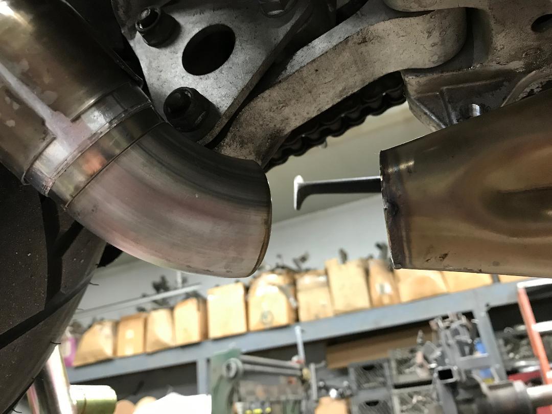

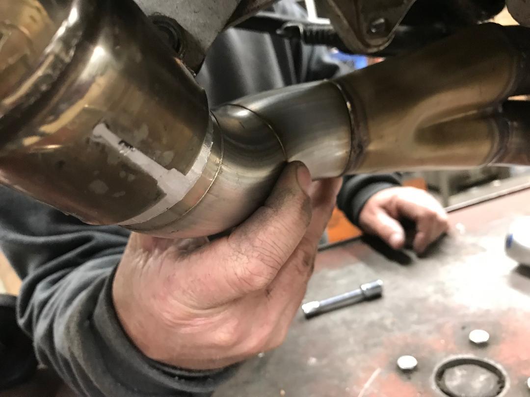

I met with Wade Tuesday and yesterday. The second trip [yesterday] was entirely my fault - I hadn't gotten the picture on what his game plan was to reset  the collector exit angle/position, and I didn't bring the prototypes with me Tuesday. Recall that the miscue on the prototype was that the jig was built from the TBR headers stem to stern - no adjustment was made to obtain OEM exit position/angle. Here's Wade's simple four-step plan to reset the collector exit position/angle to OEM:
Step 1 - cut the offending collector exits off of both prototypes
Step 2 - install OEM 5th gen muffler and trimmed prototype 1 sans collector exit on 5th gen fitment bike
Step 3 - fabricate a collector exit pipe that joins the prototype header to the OEM muffler with smoooooth flowing bends
[Rinse and repeat with Staintune slipon and prototype 2 - total of four fitment exercises]
Step 4 - cut apart the collector exit portion of the header jig and rebuild it to fit the prototypes with their shiny new, fully armed and operational OEM-like collector exits.
All production headers will have collector exits that are mandrel bent from a single piece of tubing. The segmented collector exit pipe seen in the photos below was welded in sections only for the prototypes.

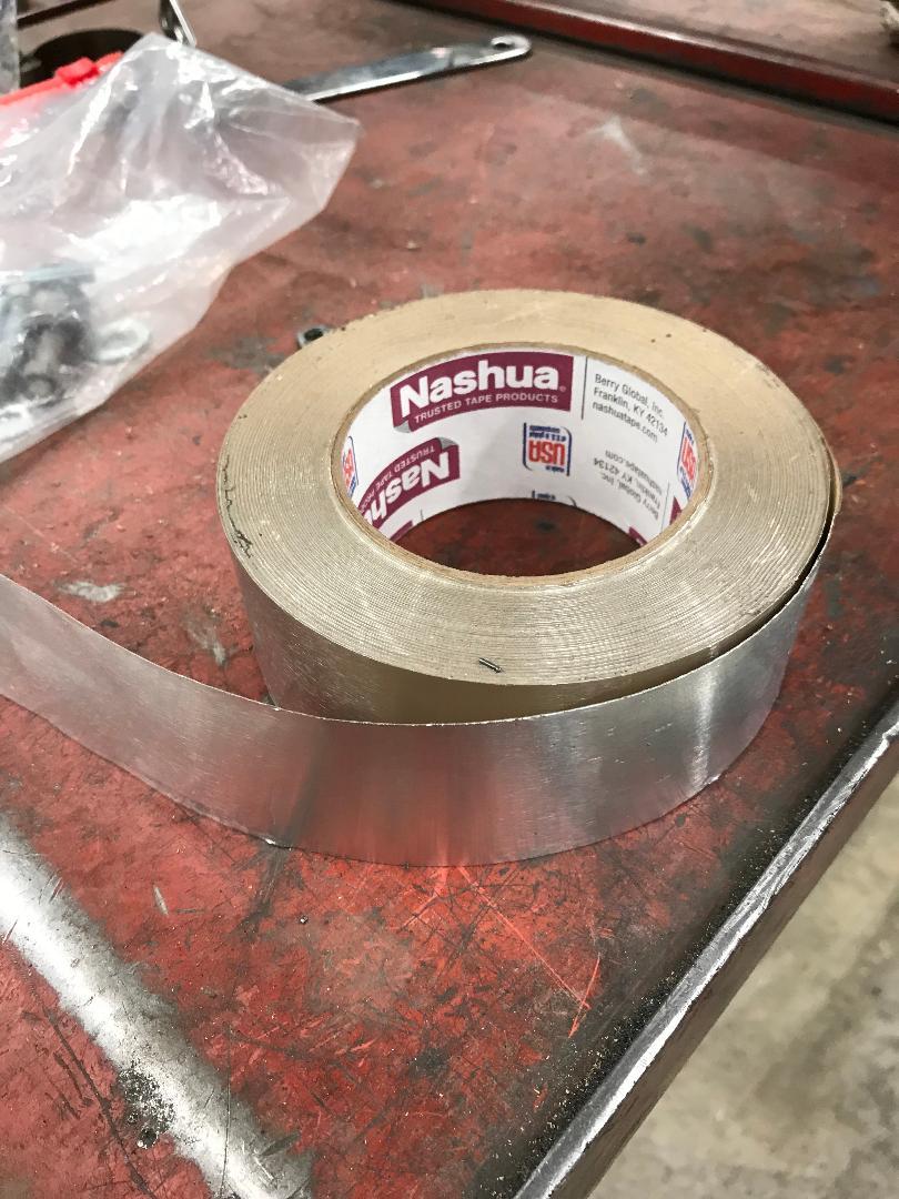

Sebspeed, thanks for suggesting Nashua aluminum tape as material for making a custom donut gasket to fit between OEM-style slipons and larger-than-OEM exit pipes. The aluminum tape worked great, but you have to be sure to get the tape made of actual aluminum sheet with adhesive backing because Nashua makes a bunch of different tapes, many of which are called 'foil' but are not aluminum, just clear flexible plastic-ish sheet with a metallic sheen. Stay away from any tapes advertising flexibility. Ask me how I know this [Thank you Home Depot for making returns so easy]. I think the correct tape is called 'Extreme Weather' but I can't be sure because the roll I bought was the last one of its kind on the shelf, had no wrapper, no barcode, and I couldn't find a price or skew on the shelf that matched its 1.88" width and aluminum sheet construction:
It's easy to relate the photos below to the process described above. Note - the OEM muffler's midpipe at 2 3/8" od is the fattest of the fat midpipes [as far as any of us can recall] so it does get pretty dang close to the #1 cylinder primary, but there is a whisker of space there. The Staintune's midpipe uses more standard 2" od tubing and clears the primary with room to spare. For fitment, Wade volunteered my Staintune over the other two aftermarket slipons we had on hand because its canister and midpipe are built in one solid piece and its mounting points are fixed threaded brackets [Not bands looped around the canister] so it provides more precise alignment. I had been stubbornly waiting until some time way in the future to expand the front end of my Staintune's midpipe to fit the new headers, cuz there's no going back [Just ask RVFR]. I know members Tirso, wholepailofwater, and one other I can't locate in my memory were worried about permanently modifying their 5th gen Staintunes...it doesn't hurt a bit, and I'm glad I did it!
It is possible to slip a stack of as many as two sheets of paper between the OEM midpipe and the cylinder #1 rear primary:
545006582_RefitOEM1.thumb.jpg.ec7dbdb1ebb65ae1270a9c009b2040f2.jpg803151479_RefitOEM2.thumb.jpg.a2754b4afd88cc44234a8ea86c1e4d42.jpg671505485_RefitStaintune4.thumb.jpg.5b50a8d7ad8ef1f2644c00f96f7ffe73.jpg987892918_RefitStaintune2.thumb.jpg.378b7db9f9c0db7b86c1389fe9bacab5.jpg1846243470_RefitStaintune3.thumb.jpg.92725e312a94cdf12ae9948512aeea8f.jpg
The Staintune's spacious fit:

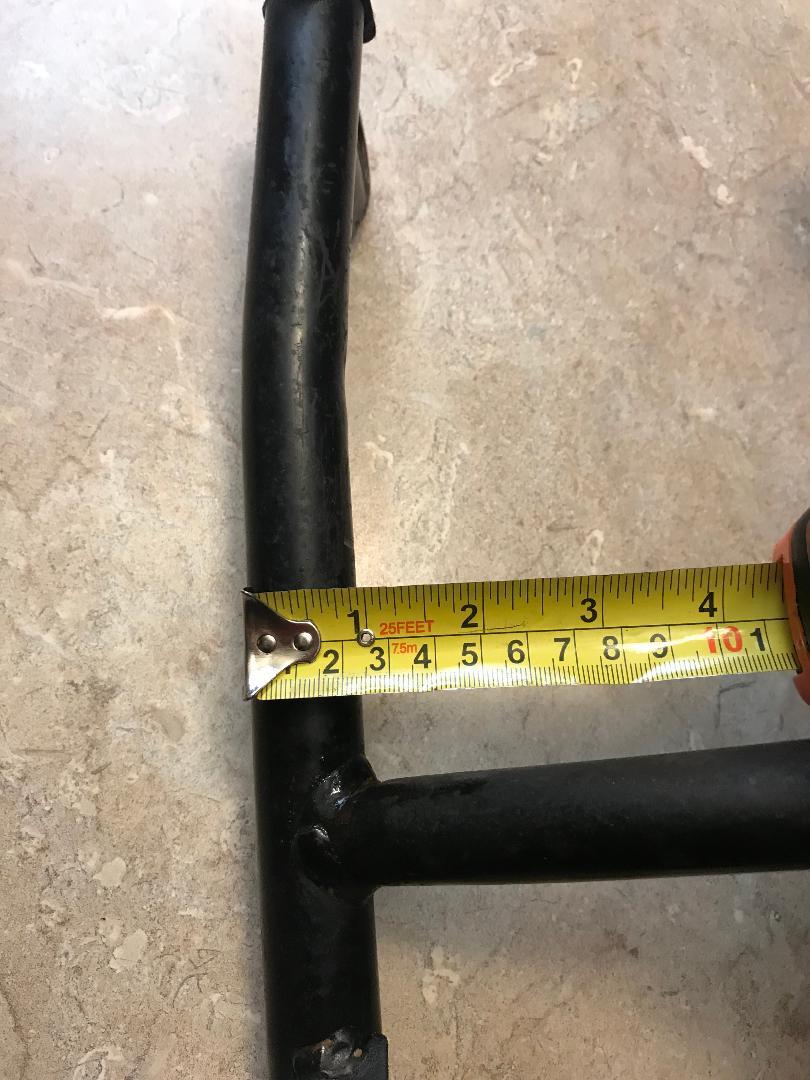

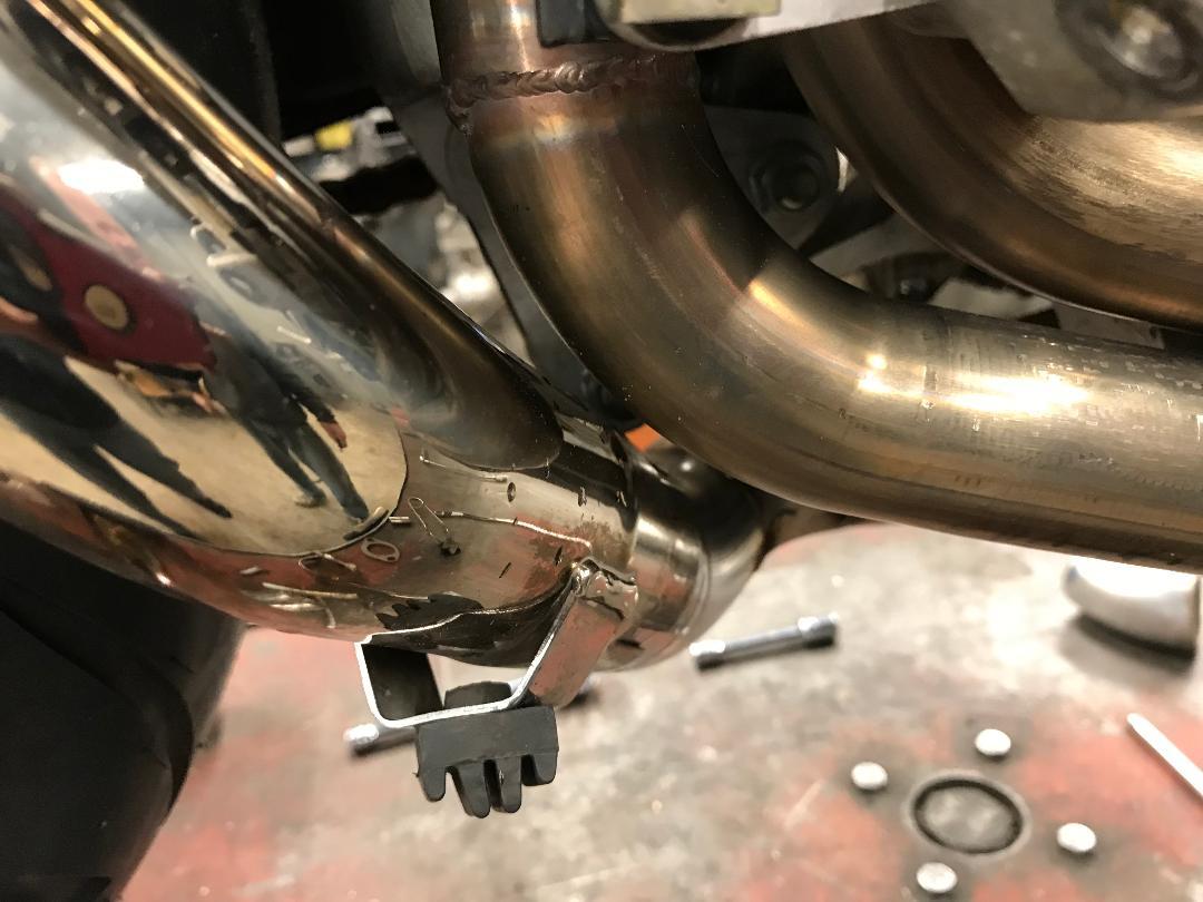

Center stand findings:

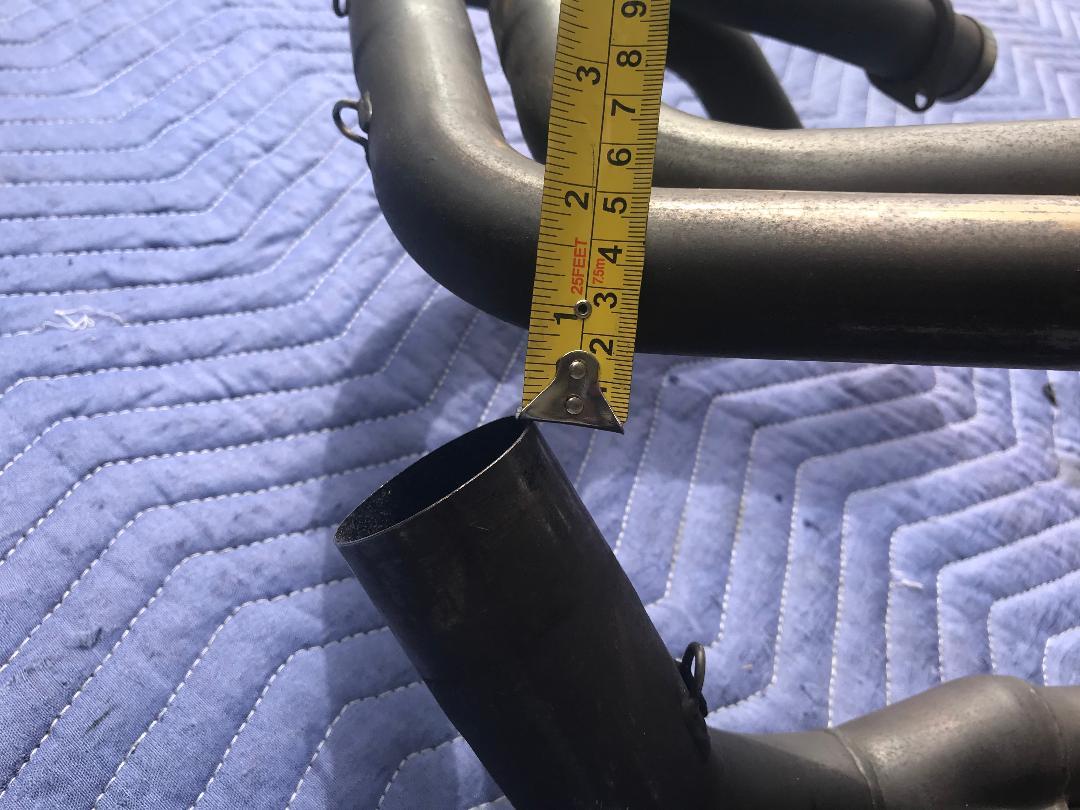

Here is CornerCarver's original TBR header with strategically placed measuring tape to show the size of the gap between collector exit and cylinder #1 primary:
Here is the right leg of a 5th gen center stand:
TBR headers and replicas of them have a space between their collector exit pipe and the #1 primary that is too small for the headers to be installed over the VFR's center stand while the center stand is still installed. Once the headers are installed, the center stand fits and functions normally. Deconstructing the #1 primary and rebuilding the jig carries the risk of decreasing the header's performance because the primaries' shape and length are a critical components of a header's function. Making these changes would also incur a considerable expense. The production replicas will have the same spacing and interaction between their tubing and center stand that the original TBR has.

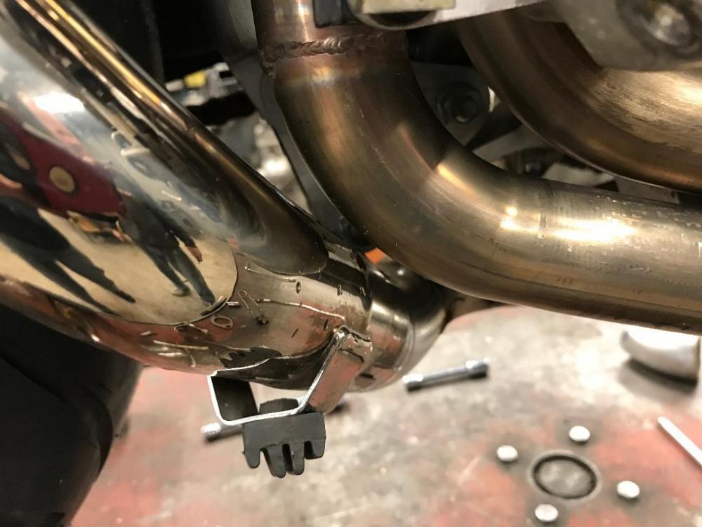

Here is how we've successfully installed these headers [And sometimes OEM 98/99 headers] with center stands:
[1] Put the bike [With headers removed] on a sturdy rear stand.
[2] Remove the center stand. Keep the stand's left and right side spacers, washers, and bolts in their correct stacking order and located on their respective sides of the bike.
[3] Place the right leg of the center stand through the loop made by the headers' rear primaries and collector exit pipe.
[4] Leave the headers hanging around the stand and move the loosely connected headers and stand into position under the bike.
[5] Bolt the stand into place.
[6] Install the headers.
[7] Connect the center stand's springs.
A method we discourage requires bending the header collector exit pipe's trailing edge inward enough to allow the center stand's right leg to pass between the exit pipe and the #1 primary. After placing the bent section of the exit pipe over the still-installed stand, install the headers, then straighten the exit pipe's trailing edge. This method risks permanently deforming the collector exit pipe.

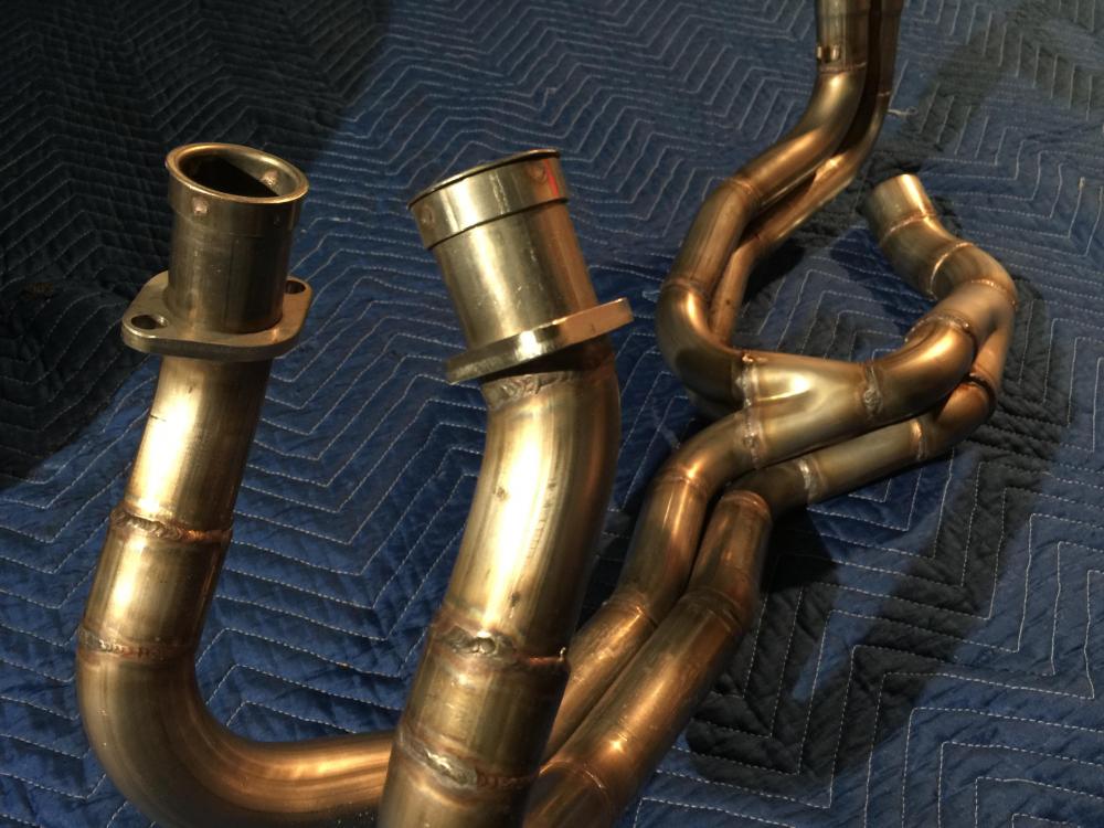

On to passivating, which as discussed earlier in this thread, is dipping in acid to remove ferrous welding contaminants. The process also etches, which removes heat damage to the surface layer. Here is prototype 1 after passivating:
That's looking pretty darn good right there!
Agreed, very tasty.......
