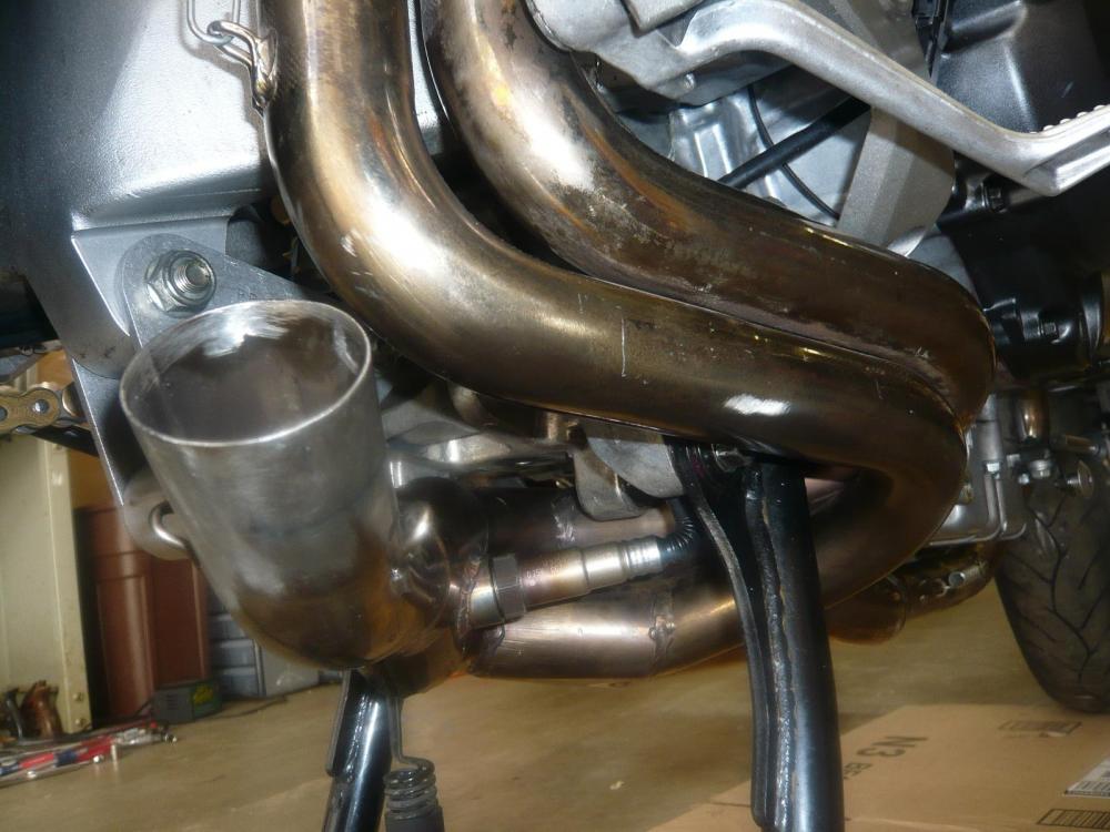

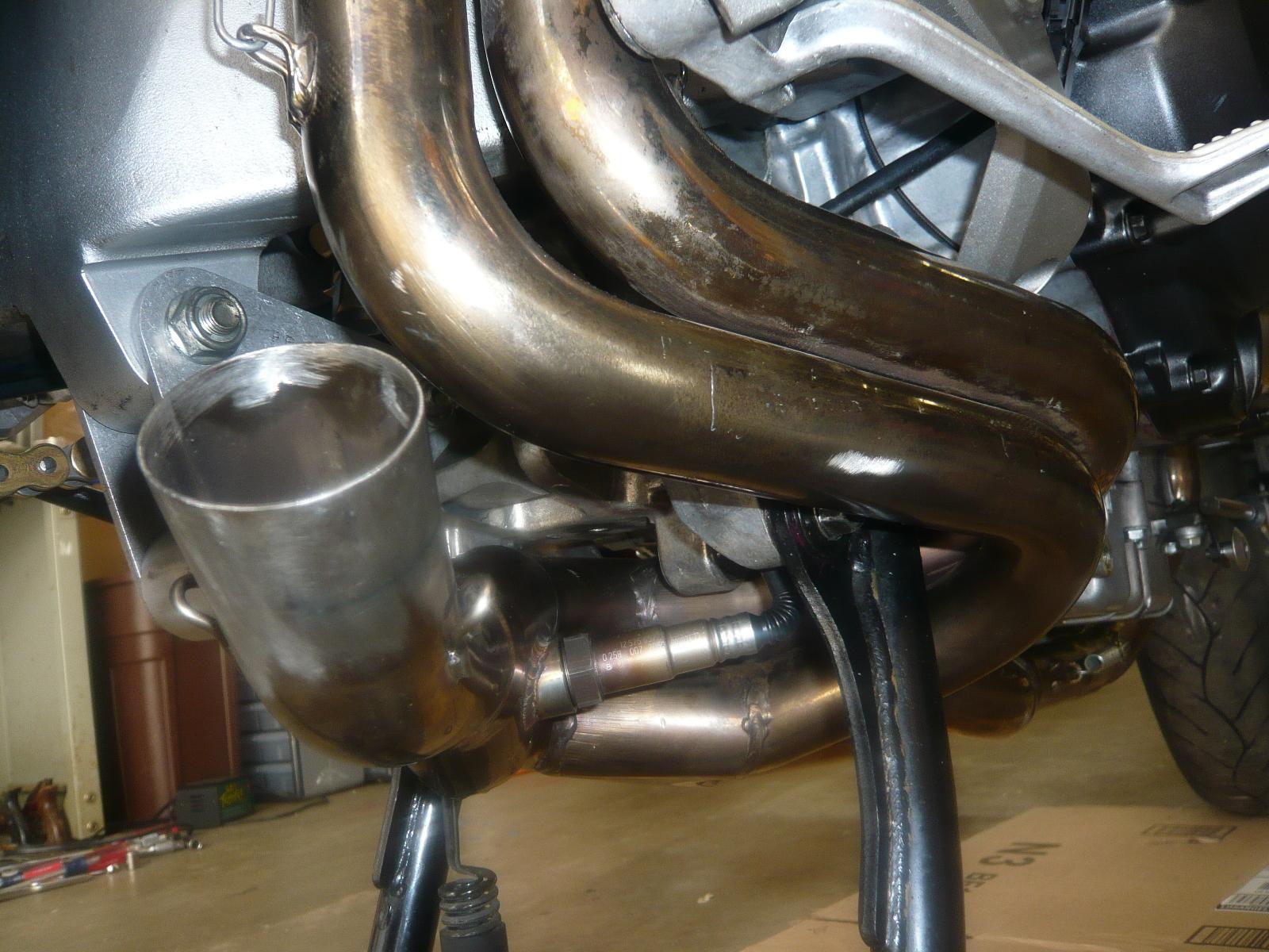

Member Contributer JZH Posted February 17, 2019 Member Contributer Posted February 17, 2019 23 hours ago, sfdownhill said: Request - I would appreciate feedback from those 5/6 gen owners who use a single sensor in the collector: where and at what angle is it located? Don't put it where mine is! It barely fits in that location. (This is an Erion, btw.) Ciao, JZH 1 Quote
Member Contributer sfdownhill Posted February 18, 2019 Author Member Contributer Posted February 18, 2019 Thanks JZH - not putting it there gives us a lot of leeway. That Erion is a good-looking assembly - is that your 2000? Quote

Member Contributer JZH Posted February 18, 2019 Member Contributer Posted February 18, 2019 16 hours ago, sfdownhill said: Thanks JZH - not putting it there gives us a lot of leeway. That Erion is a good-looking assembly - is that your 2000? Yes, and I should mention that the outlet was cut down slightly to match the TBR's length, and to keep the link pipe from sticking out too much. I'm hoping to get in on the second 5th/6th gen production run, assuming my finances then allow! Ciao, JZH 1 Quote

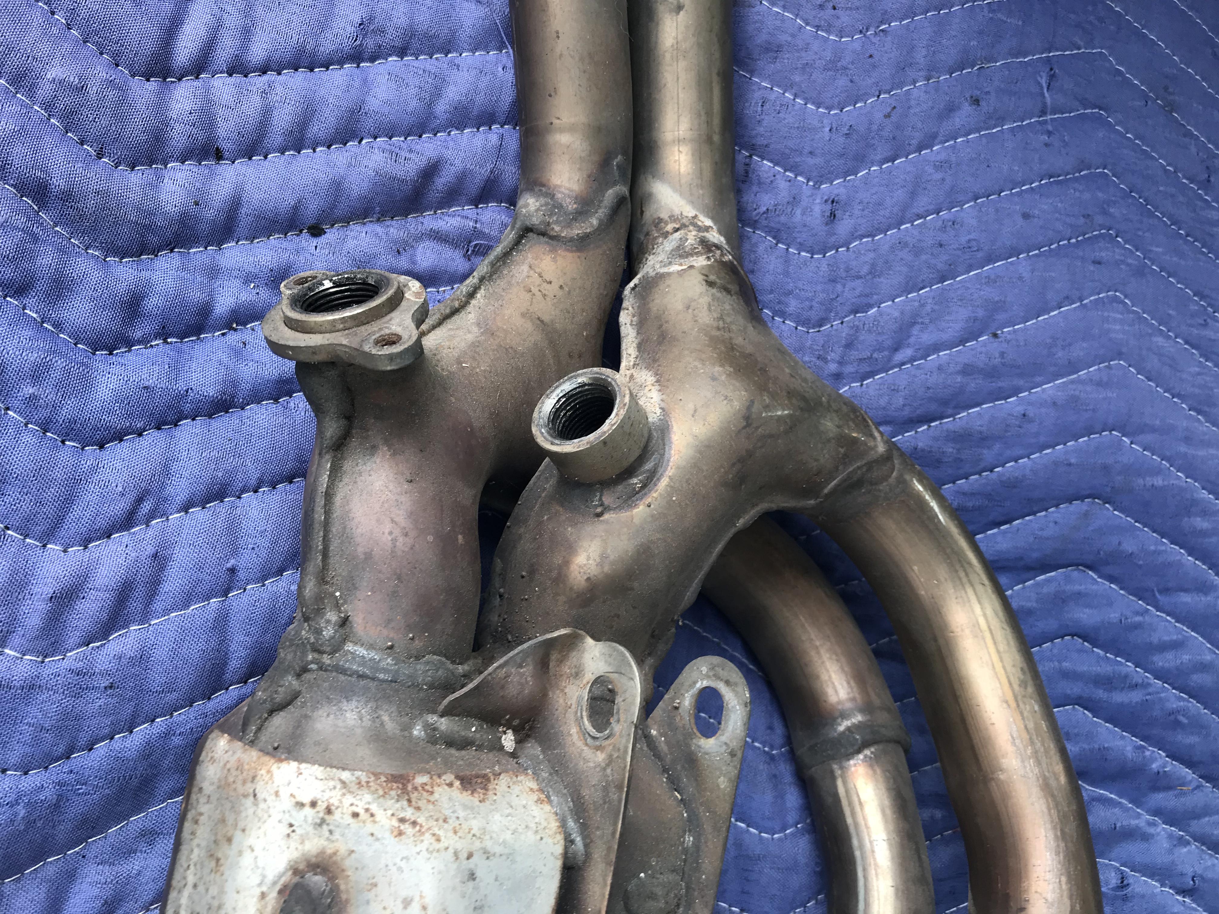

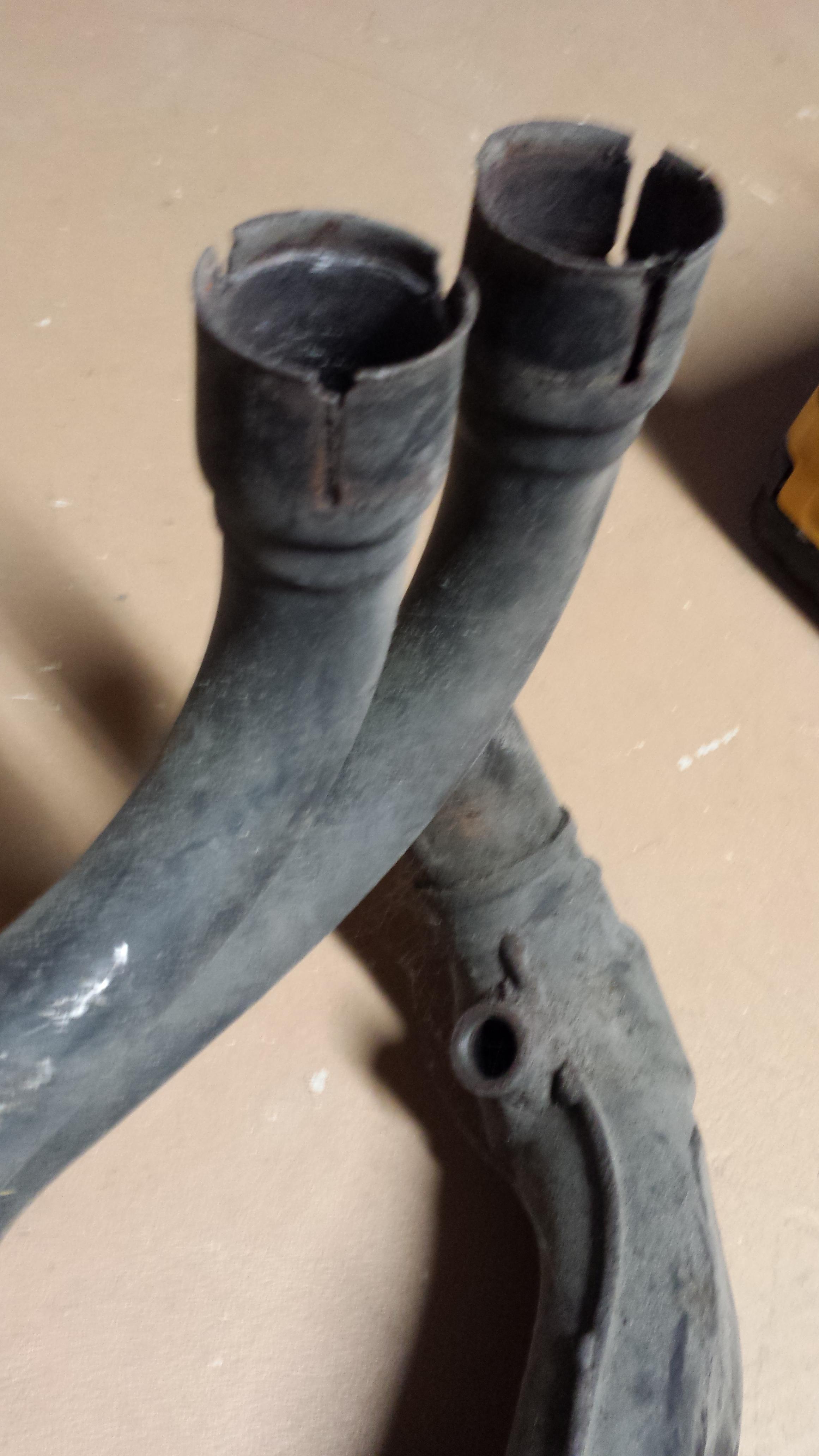

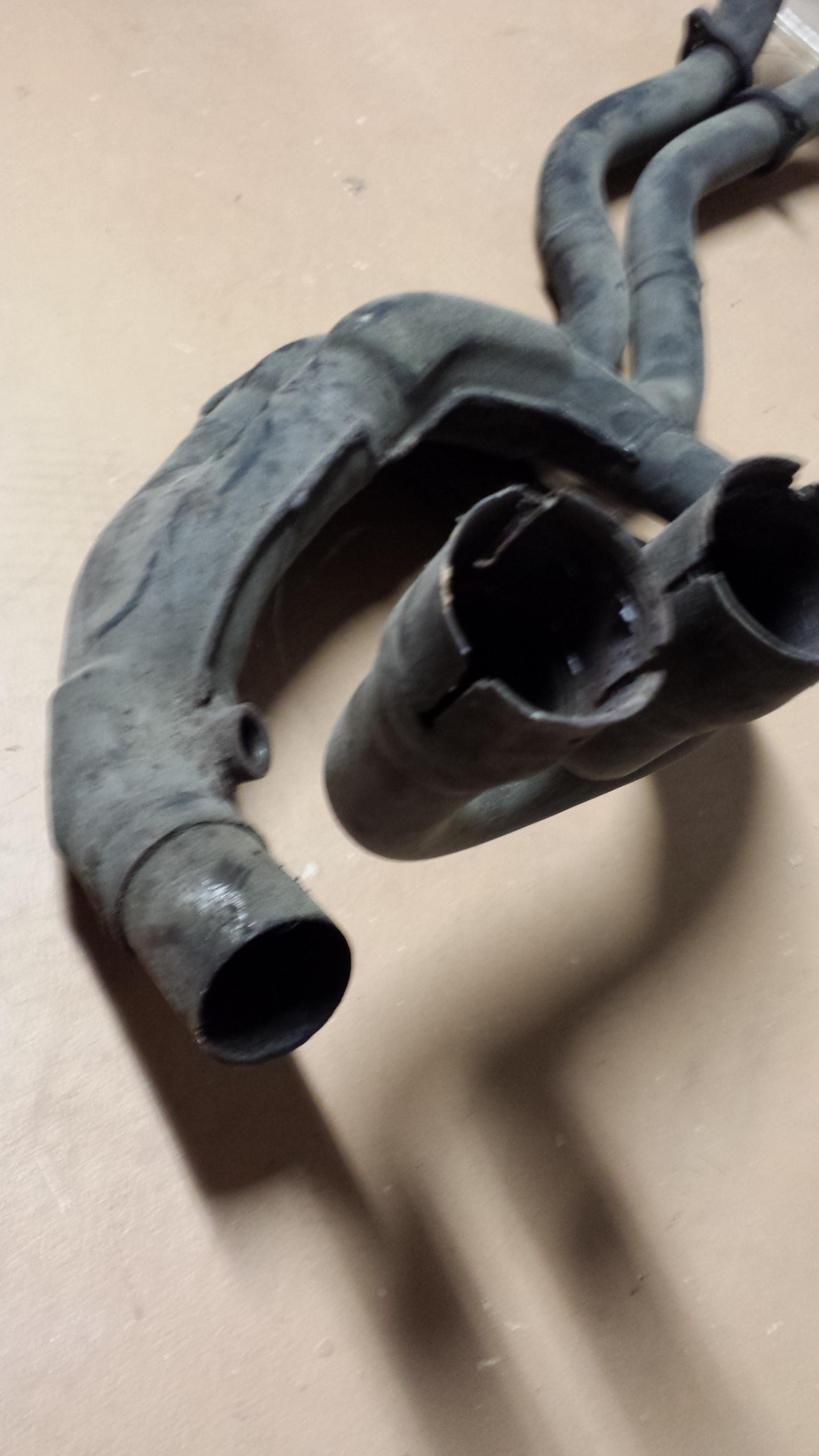

Member Contributer MadScientist Posted February 18, 2019 Member Contributer Posted February 18, 2019 Sorry it is not on the bike, but the landmarks on the old header will give a good idea. 1 Quote
