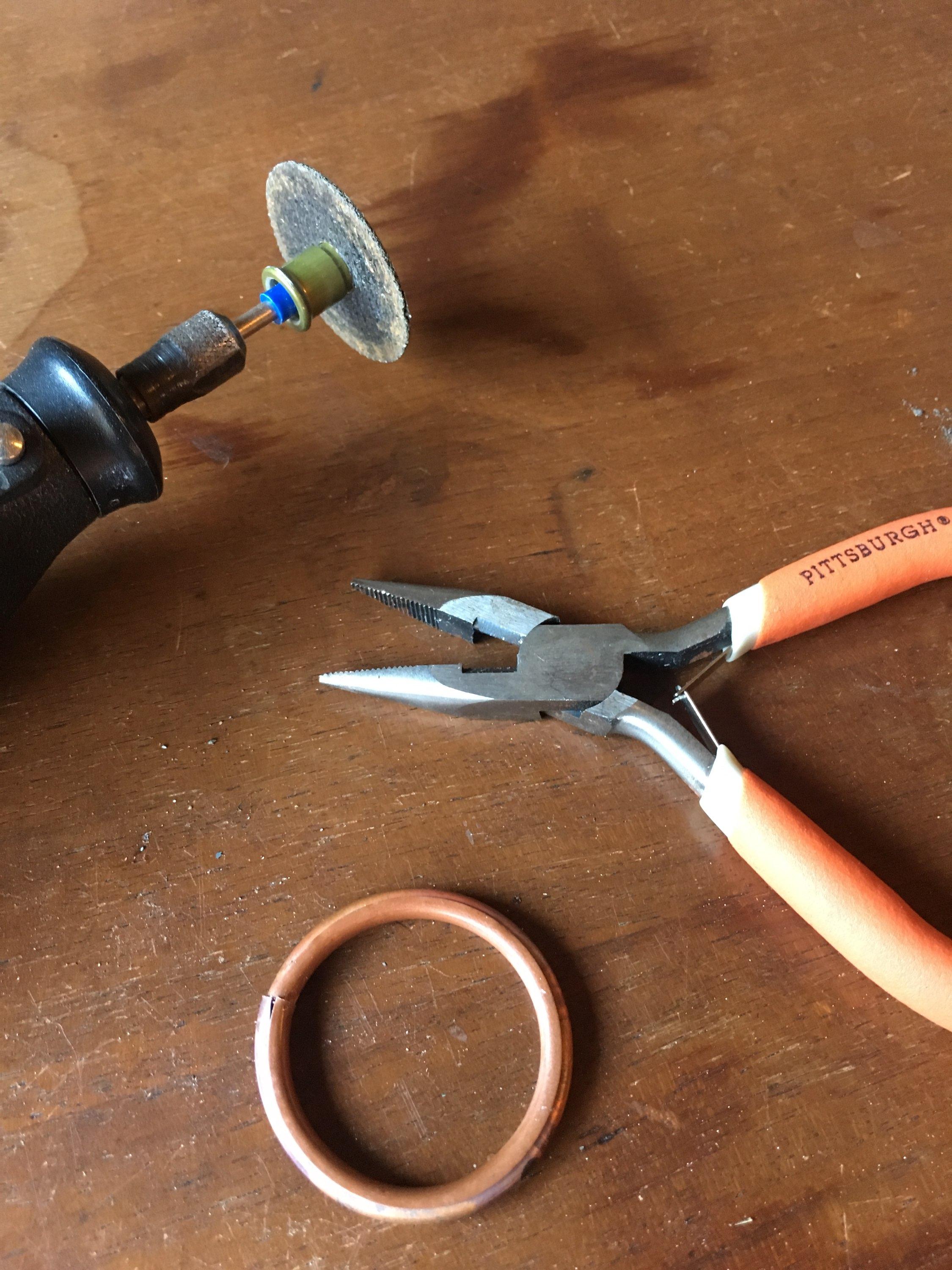

Member Contributer gig Posted January 10, 2019 Member Contributer Posted January 10, 2019 5 hours ago, sfdownhill said: I messaged Delkevic too, but I made the mistake of telling them I had a VFR800 - their response was “use the 41mm gaskets” I cut a 43mm with dremel cutting wheel slightly opened and closed ends to get a 42mm or maximum width of exhaust port. May be an option 2 Quote

Member Contributer sfdownhill Posted January 13, 2019 Author Member Contributer Posted January 13, 2019 On 1/10/2019 at 12:55 PM, gig said: I cut a 43mm with dremel cutting wheel slightly opened and closed ends to get a 42mm or maximum width of exhaust port. May be an option Gig, I like your approach - did a couple circumference calcs and it makes sense. When you say you slightly opened and closed the ends, did that allow you to insert one end into the other, thereby eliminating any gap and possible leak point? Quote

Member Contributer gig Posted January 14, 2019 Member Contributer Posted January 14, 2019 8 hours ago, sfdownhill said: Gig, I like your approach - did a couple circumference calcs and it makes sense. When you say you slightly opened and closed the ends, did that allow you to insert one end into the other, thereby eliminating any gap and possible leak point? Correct 1 Quote

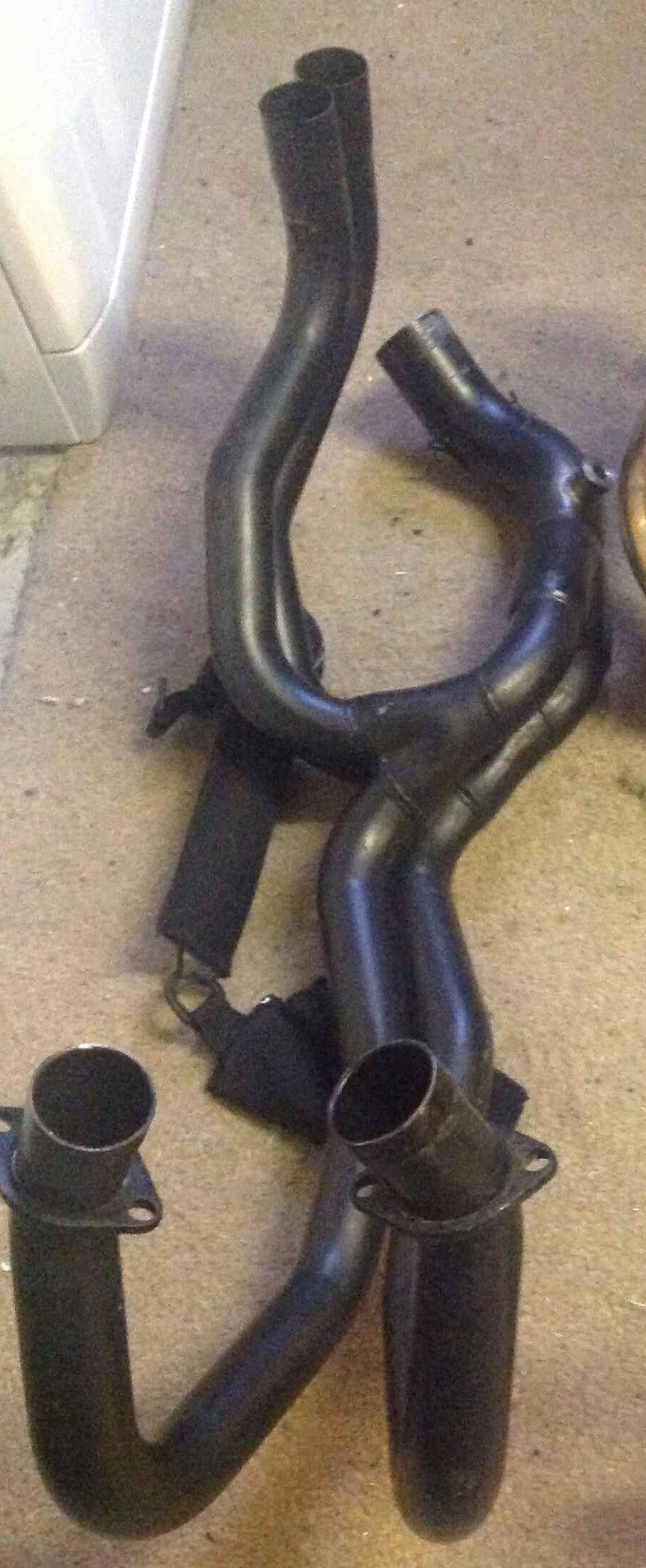

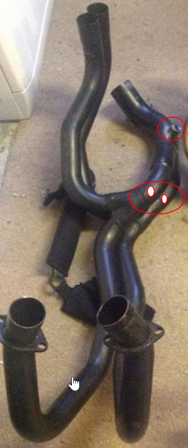

Member Contributer HighSideNZ Posted January 16, 2019 Member Contributer Posted January 16, 2019 I'd get 3 bungs put in the pipe myself. Like this. A single one past the last collector and one each just past the other collectors. Then you can tune each set individually if you want. Just my thoughts on the matter. 1 Quote
