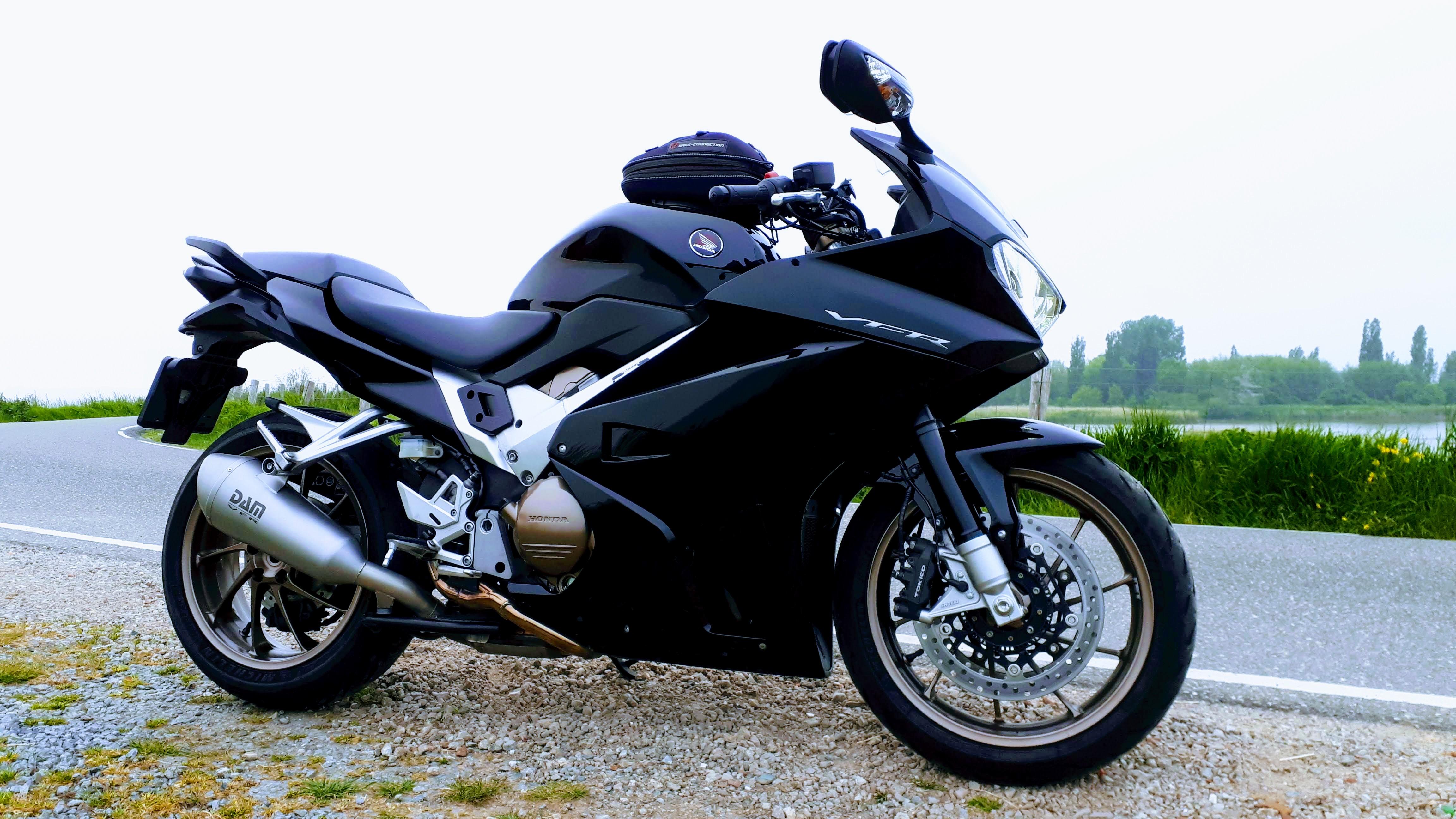

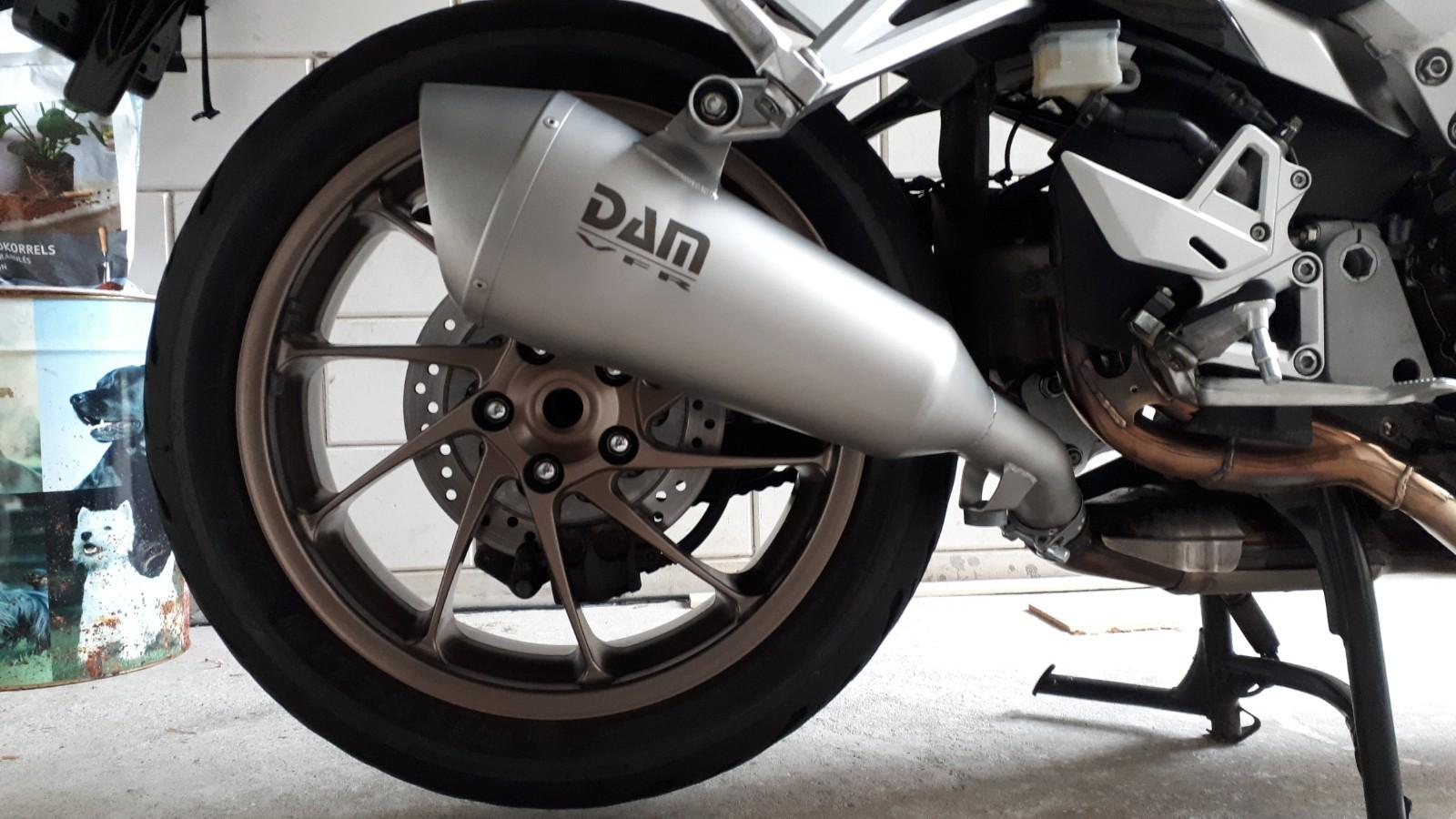

VFRLondon Posted May 20, 2019 Posted May 20, 2019 4 minutes ago, Greytec said: Installed my new DAM-exhaust! Gorgeous looking exhaust! How does it sound? Quote
Greytec Posted May 20, 2019 Posted May 20, 2019 I think it sounds great, haven't tried it without the DB-killer yet. And it definitely looks much better than the original exhaust. Quote
sudolea Posted May 20, 2019 Posted May 20, 2019 54 minutes ago, Greytec said: And it definitely looks much better than the original exhaust. De gustibus et de coloribus ... Quote
Samuelx Posted May 21, 2019 Posted May 21, 2019 Hail Caesar! Is 'semper ubi sub ubi' part of ATGATT? ;) 1 Quote
sudolea Posted May 21, 2019 Posted May 21, 2019 1 hour ago, Samuelx said: Hail Caesar! Is 'semper ubi sub ubi' part of ATGATT? 😉 Initially not understanding this (or should I say "understanding this only as Latin words without any coherent meaning"), I did some Googling (I admit). This learned me that this isn't exactly Latin, but Englatin, a not so much spoken variant of it ☺️ But then again, for those who speak it : YES (it's part of ATGATT) 😎 This being said, I prefer the standard exhaust. But then again : de gustibus et de coloribus ... 😉 1 Quote

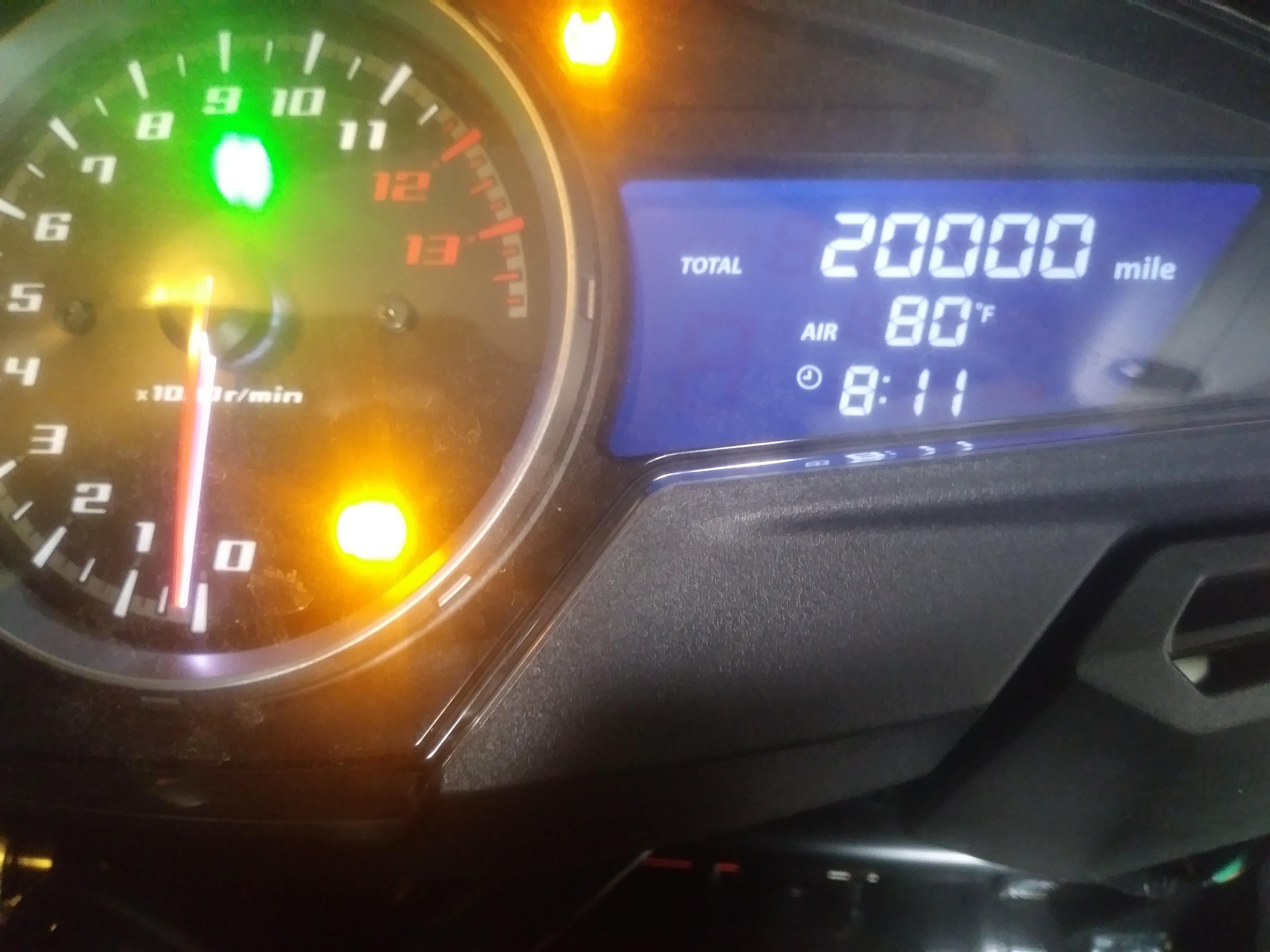

Sparkie Posted May 28, 2019 Posted May 28, 2019 I hit 20,000 miles. Bought brand new in April 2017. 4 1 Quote

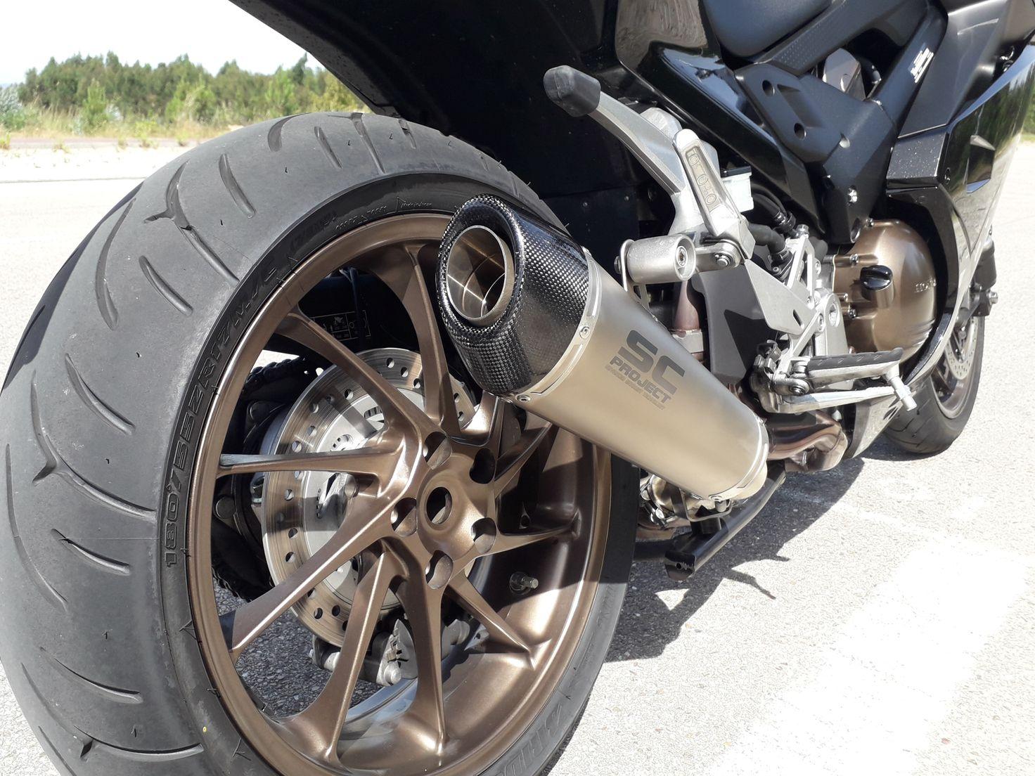

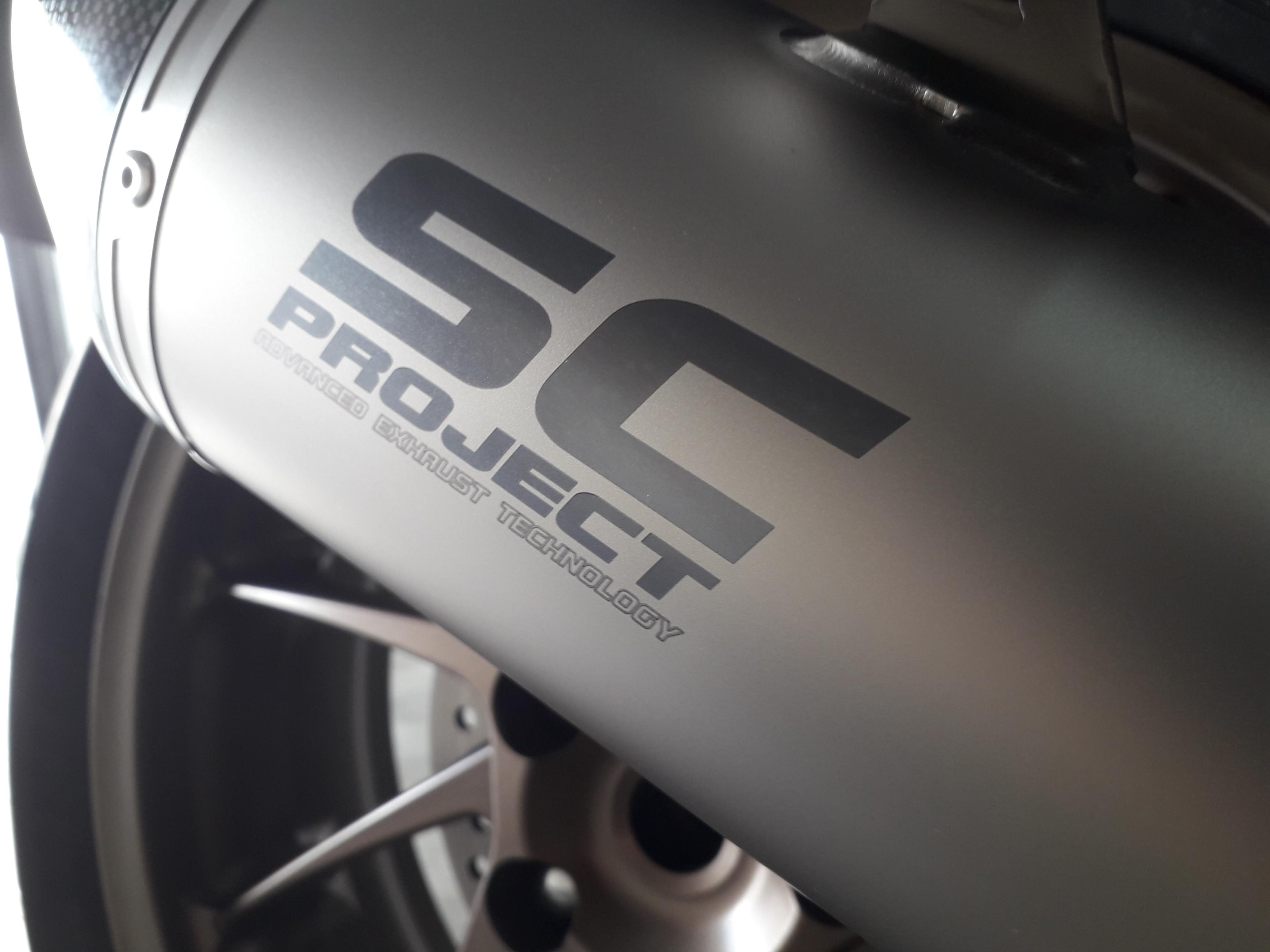

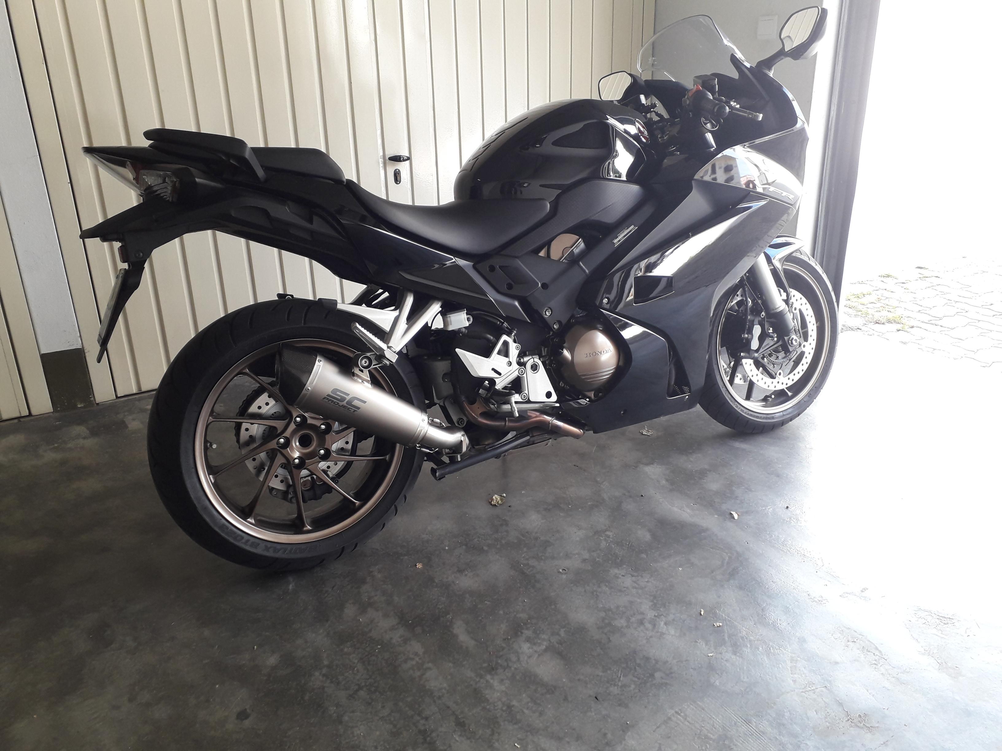

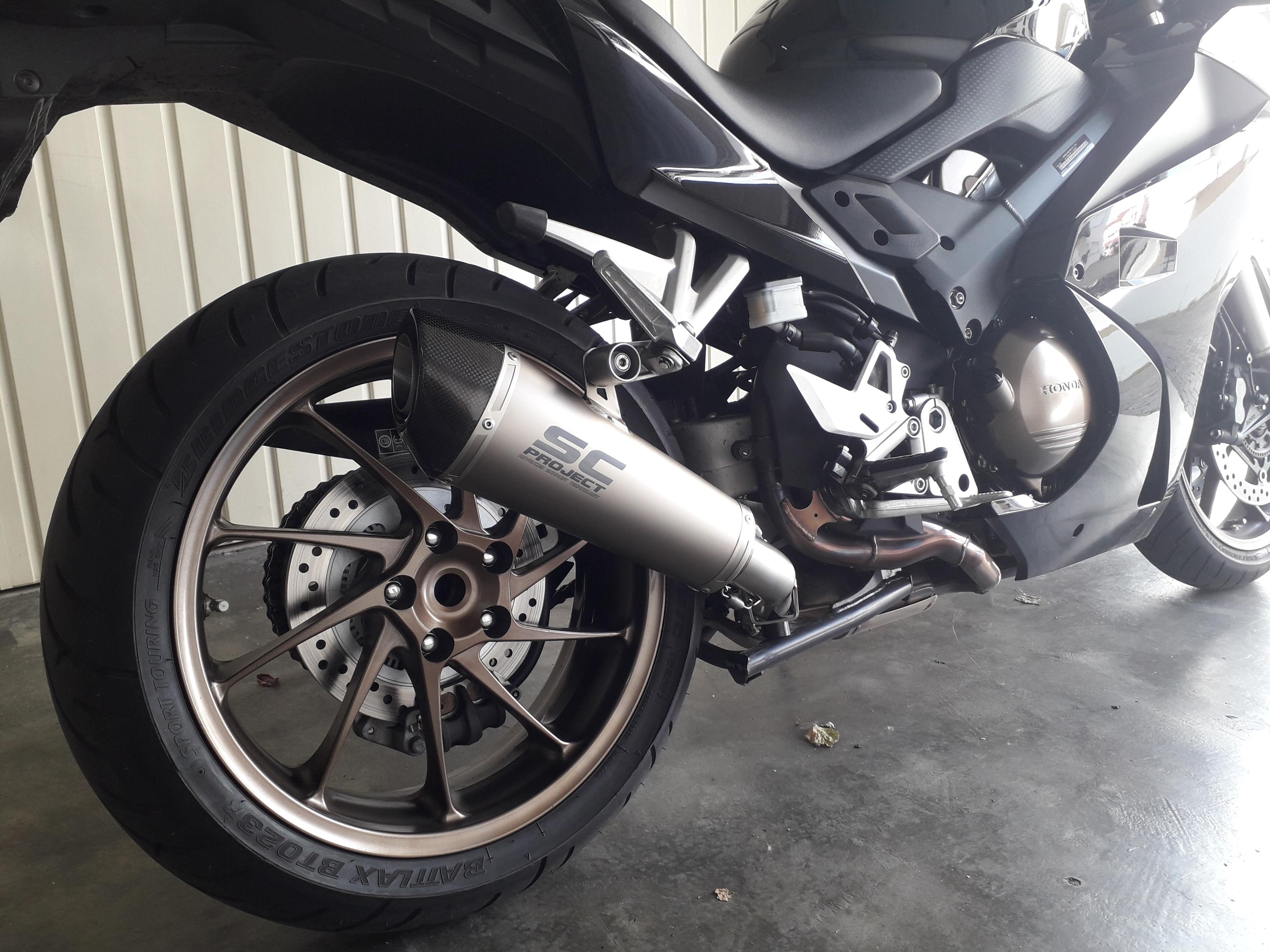

V4Rid3r Posted May 29, 2019 Posted May 29, 2019 New exhaust fitted 😁 SC Project conic titanium 3 1 Quote
sudolea Posted May 29, 2019 Posted May 29, 2019 Saw this on your channel, indeed. Money is round, let it roll ☺️ Quote

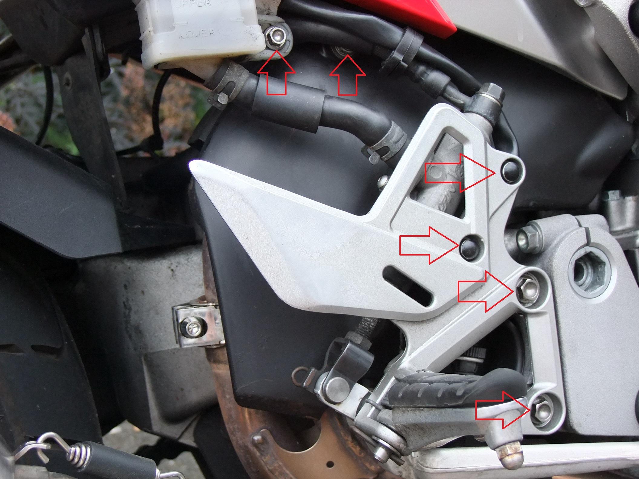

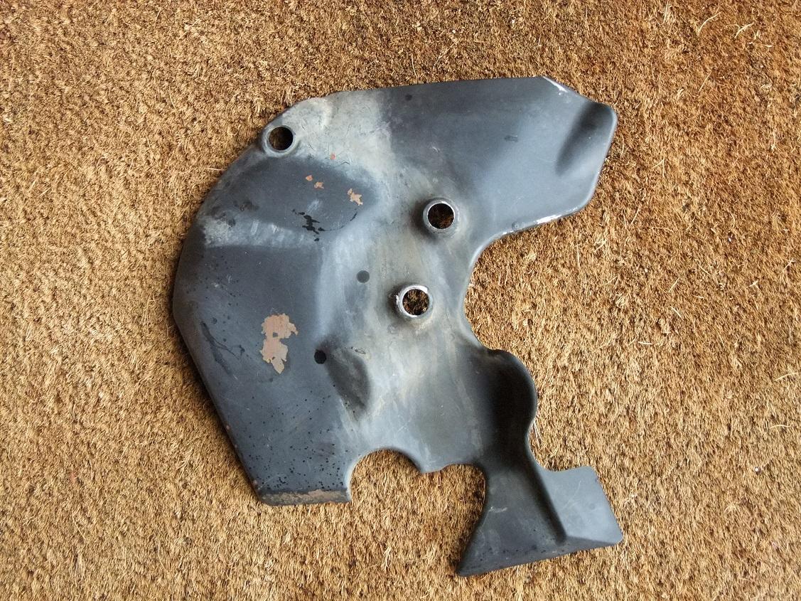

fatshoutybloke Posted May 30, 2019 Posted May 30, 2019 Had this off. Not too bad considering it's been through four salty British winters and the inside face is no worse. I've seen others which are much worse but I did cover it in ACF50 when it was new. I'll get it cleaned up and resprayed before it goes back. Quote
Member Contributer Thumbs Posted May 31, 2019 Member Contributer Posted May 31, 2019 That’s the step isn’t it? Much involved in getting it off? I’ve been looking at mine and thinking I might take it off and either get it plated or make a carbon fibre one as I’ll have it to make the mould from Quote

fatshoutybloke Posted June 3, 2019 Posted June 3, 2019 On 5/31/2019 at 5:18 PM, Thumbs said: That’s the step isn’t it? Much involved in getting it off? I’ve been looking at mine and thinking I might take it off and either get it plated or make a carbon fibre one as I’ll have it to make the mould from It's the rear headers heat shield from the right hand side. Not too bad to remove, first you need to undo one bolt at the top, the bolt holding the rear brake fluid reservoir and the two footrest hanger bolts. That enables you to swing everything out far enough to get a spanner onto the nuts on the ends of the two bolts that go though the upper footrest hanger holding the rear brake cylinder to release the shield. These... 1 Quote

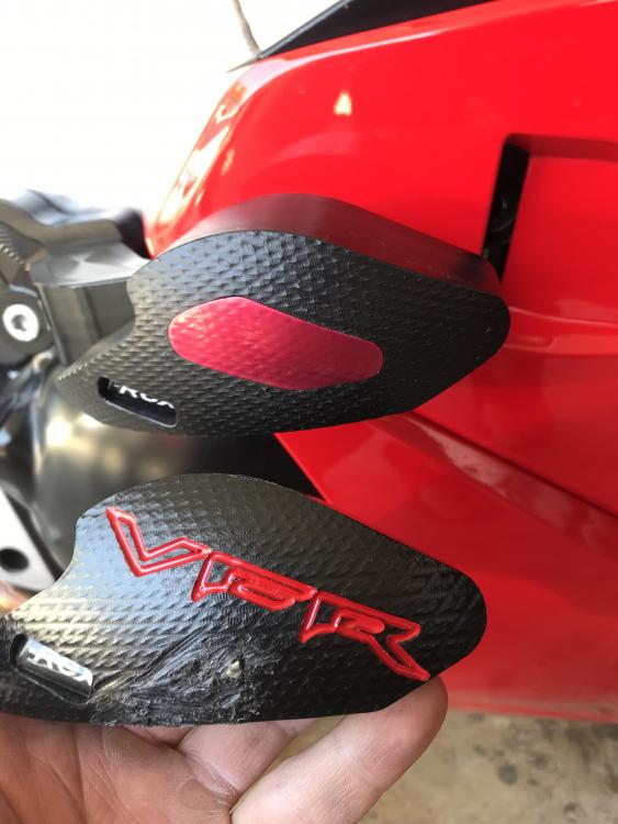

Bigdan Posted June 6, 2019 Posted June 6, 2019 swapped my RH TREX puck with new style due to damage during low speed practice. You won’t find the old style where the VFR is etched into the puck due to copyright. The old part by far looks superior... the new red color does not match the paint and it looks like more of a fuchsia color in person. There us also a silver color available. If you’re wondering, the puck did its job no issues with the bolts other than some oxidation on one side and a little bit of rust which I scraped and added removable during installation. Quote
Member Contributer Philois1984 Posted June 6, 2019 Member Contributer Posted June 6, 2019 Sometimes copyright law is ridiculous!! I am glad I have already have these fitted. You should be able to find a small tin of paint to match Victory Red much more closely if it annoys you too much. Quote
Member Contributer VifferJ Posted June 7, 2019 Member Contributer Posted June 7, 2019 Is the red just a sticker with black plastic underneath? Quote
Bigdan Posted June 7, 2019 Posted June 7, 2019 No, it appears the color is imbedded in the rubber composite material. Quote
