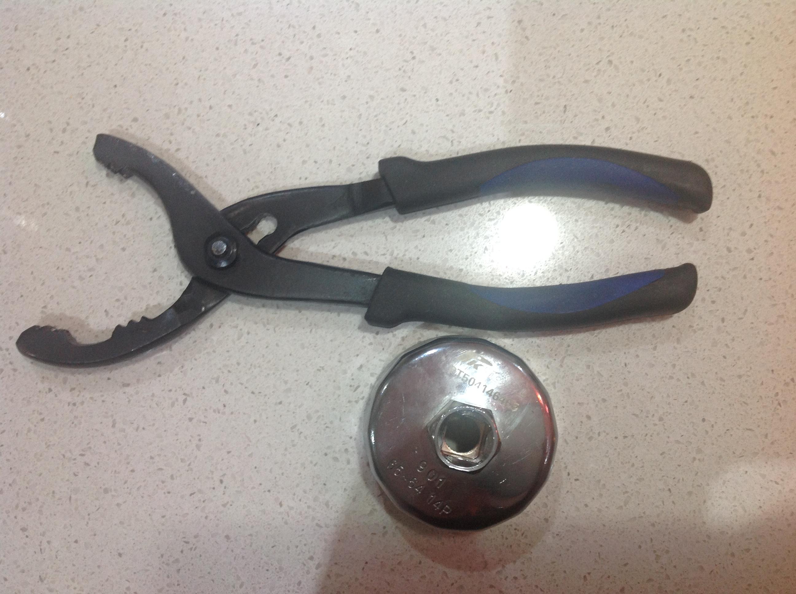

Member Contributer raYzerman Posted June 16, 2020 Member Contributer Posted June 16, 2020 If you lube the gasket with engine oil or even grease, standard thing is to install until gasket contacts base, then 1/2 - 3/4 turn more. Should be no leaks and it will be easier to remove next time. I have a filter wrench that looks like a curved jaw channel-lock kind of thing, can usually get them off without much effort. Quote
