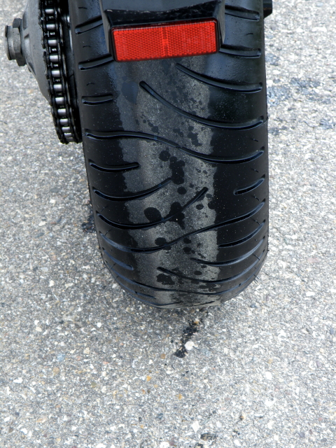

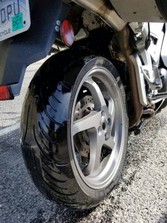

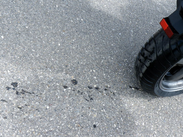

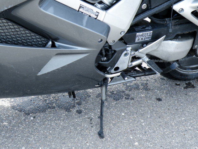

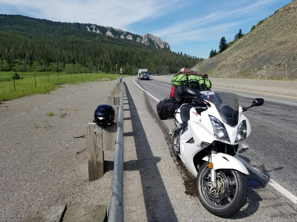

Member Contributer Terry Posted June 17, 2016 Member Contributer Posted June 17, 2016 Apparently, a picture is worth a thousand words... Â Â Quote
Member Contributer Ultimatevfr Posted June 17, 2016 Member Contributer Posted June 17, 2016 Well that worked for me! Quote
Member Contributer JZH Posted June 17, 2016 Member Contributer Posted June 17, 2016 3 hours ago, Terry said: Apparently, a picture is worth a thousand words... Â Â Â I've saved this pic in my archives... Â Ciao, Quote
fatshoutybloke Posted June 17, 2016 Posted June 17, 2016 6 hours ago, Terry said: Apparently, a picture is worth a thousand words... Â Â Â Â Â Jeez. How much of that trail is from the filter, and how much from the pilot's trousers? Quote

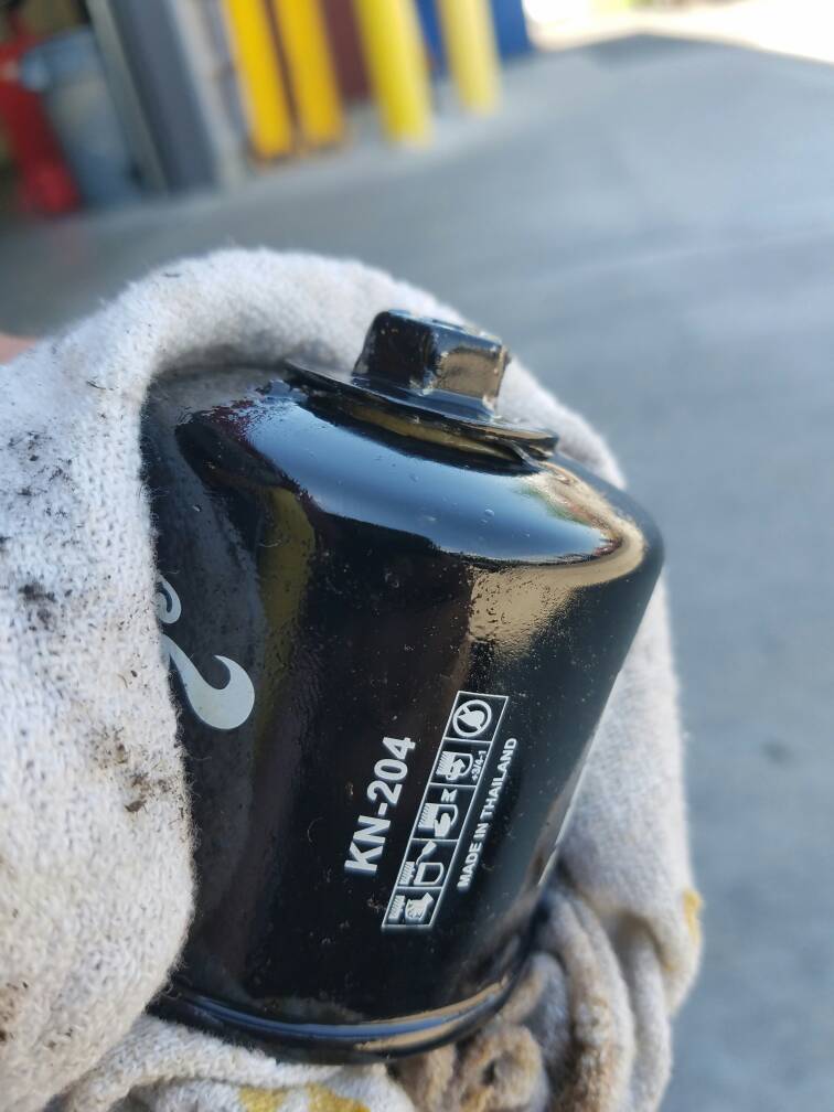

V4 Rosso Posted June 17, 2016 Posted June 17, 2016 On the K&N website it does mention that the nut can be used for both installation and removal. Â http://www.knfilters.com/search/product.aspx?Prod=KN-204 Quote K&N powersports oil filters contain a modern synthetic filter media, designed for ultimate flow with less pressure drop, yet engineered for outstanding filtration. K&N powersports 'spin-on' oil filters feature a heavy-duty metal can. Most of these have a 17 mm nut affixed onto the end that allows for easy installation and removal. The 17 mm nut is crossed-drilled so racers can safety wire the filter to their bike. Quote

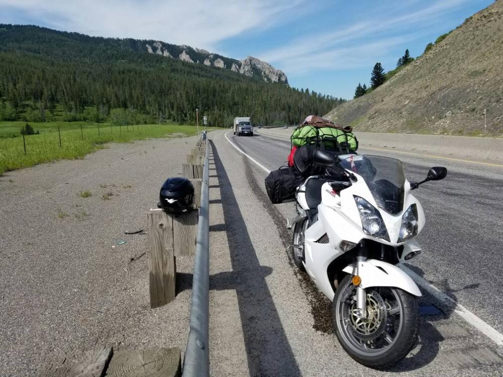

Member Contributer Cogswell Posted June 17, 2016 Member Contributer Posted June 17, 2016 Similar photos from Olive's experience with a K&N filter in 2011 . . . Â Thread is here http://www.vfrdiscussion.com/index.php?/topic/66717-six-weeks-a-tent-and-a-vfr-updated-november-12th-traffic-with-a-capitol-t-hollywood-and-the-score-wind-1-olive-0-day-4148/&do=findComment&comment=781447 Â Â Â Â Â Â Â Â Quote

Member Contributer lazyeye Posted June 18, 2016 Author Member Contributer Posted June 18, 2016 Gratuitous oily tire photo: Quote
