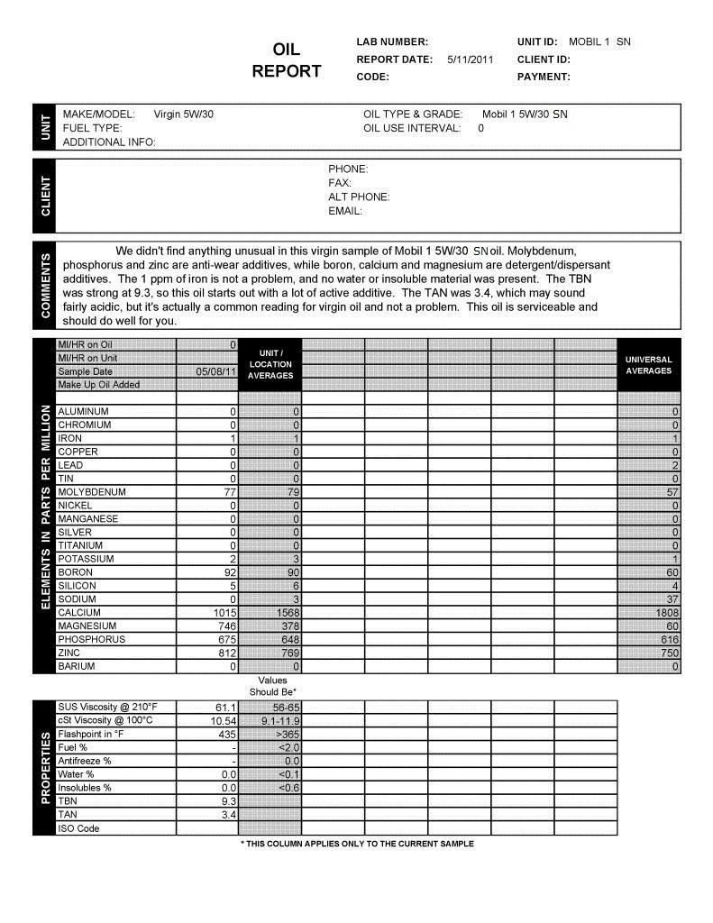

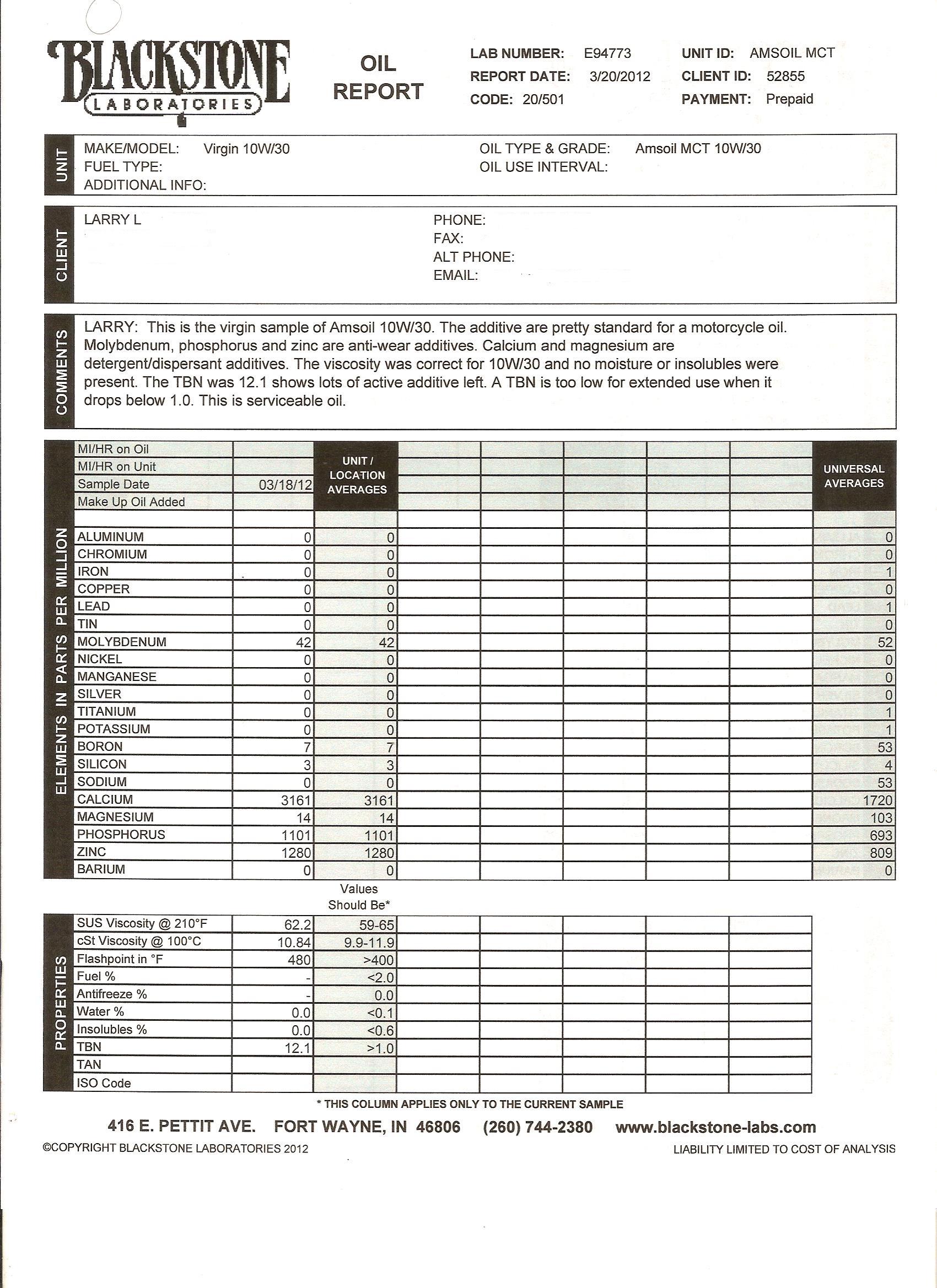

Here are virgin oil samples of $12.95 a quart Amsoil motorcycle specific
10W30 and $4.89 a quart Mobil 1 Auto Oil 5W30... listed in parts per million are
minor differences in the additive package you're paying for...

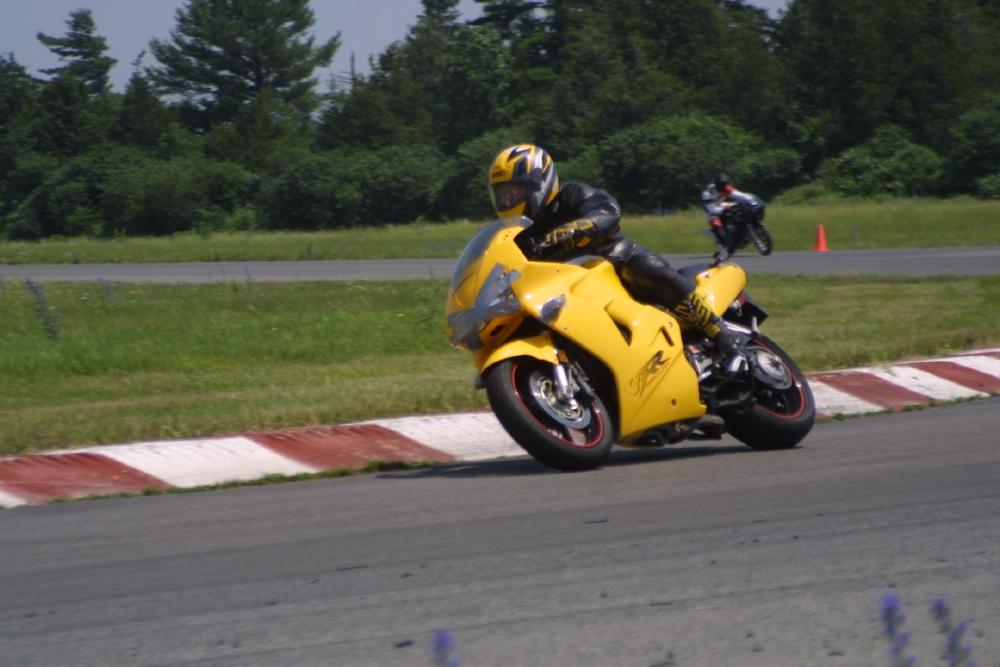

My Irene (1999 Yellow VFR) just turned 154,000.
Did a 5000km break in using Honda GN4, then switched to synthetic. Ran on Canadian Tire Formula One 10-W40 for most of it's life (Same formula as Mobil 1).
Tried Motul ester based, My clutch didn't like it.
Over the past few years, I'm using Shell Rotella T6 5W40. changed twice per year.
I don't spare the bike: I still take her out to the track at least twice per year.
Incredible motor: at 140k, I performed a compression and Leak down tests. All values are still well within range. And I still haven't had to change a valve shim.FJMVFRTrackday3.jpg.e5bd739e01fec822248a5ee9715b234d.jpg
Irene is semi retired now, as I share my time on my 2016 Africa twin and my 1986 VF500.

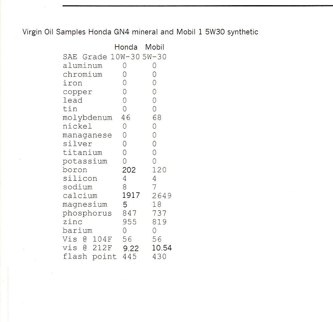

Compare virgin samples...
