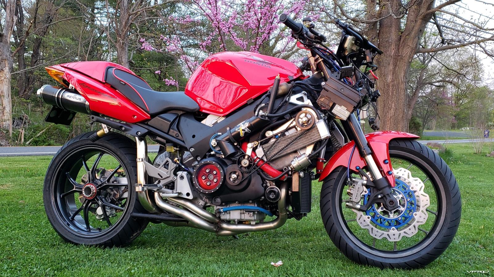

SEBSPEED Posted May 22, 2023 Posted May 22, 2023 Some eye candy encouragement for potential buyers... 8th gen set on my supercharged 6th gen... 2 Quote

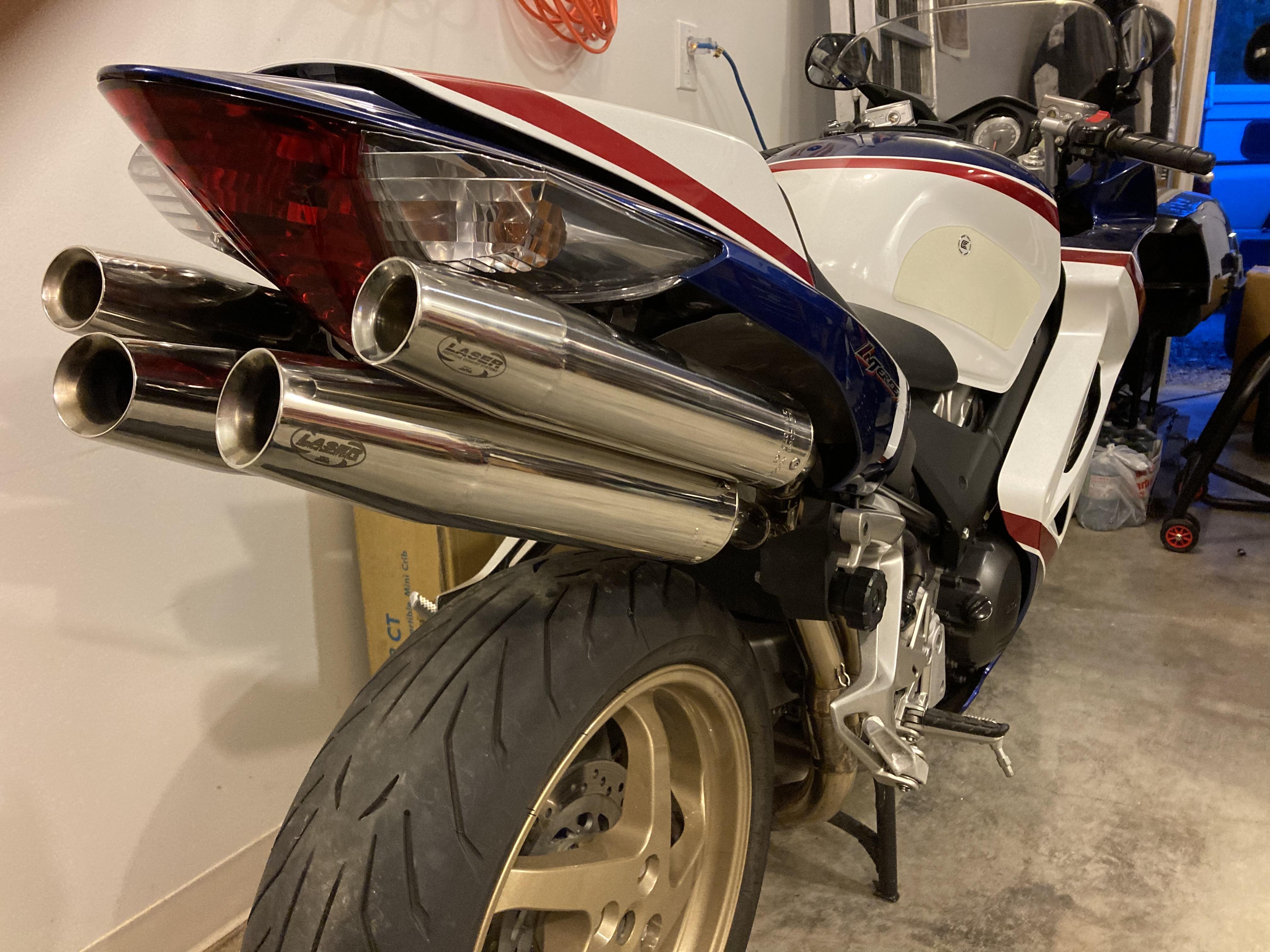

Tyjamo Posted June 15, 2023 Posted June 15, 2023 Hey all, I stumbled upon this thread while searching for Power Commander information. Obviously these $1k headers are worth it to a dozen or so of you die hards, but what is it exactly that you're getting by installing these? What are the tangible gains? I finally got my dream slip ons, the Lasers. Would these headers, and a PC make a worthwhile improvement in performance? What will the headers do to the sound? OEM headers and Lasers sound dreamy to me, throaty and quiet, I don't want it much louder. How many more buyers do you need? How important is a dyno tune with header and PC? Dynos are seemingly nonexistent in remote MT. Thanks in advance! Quote

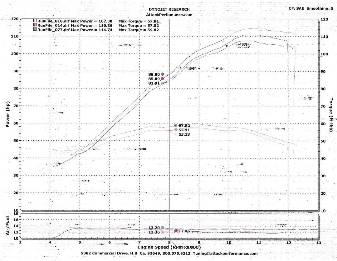

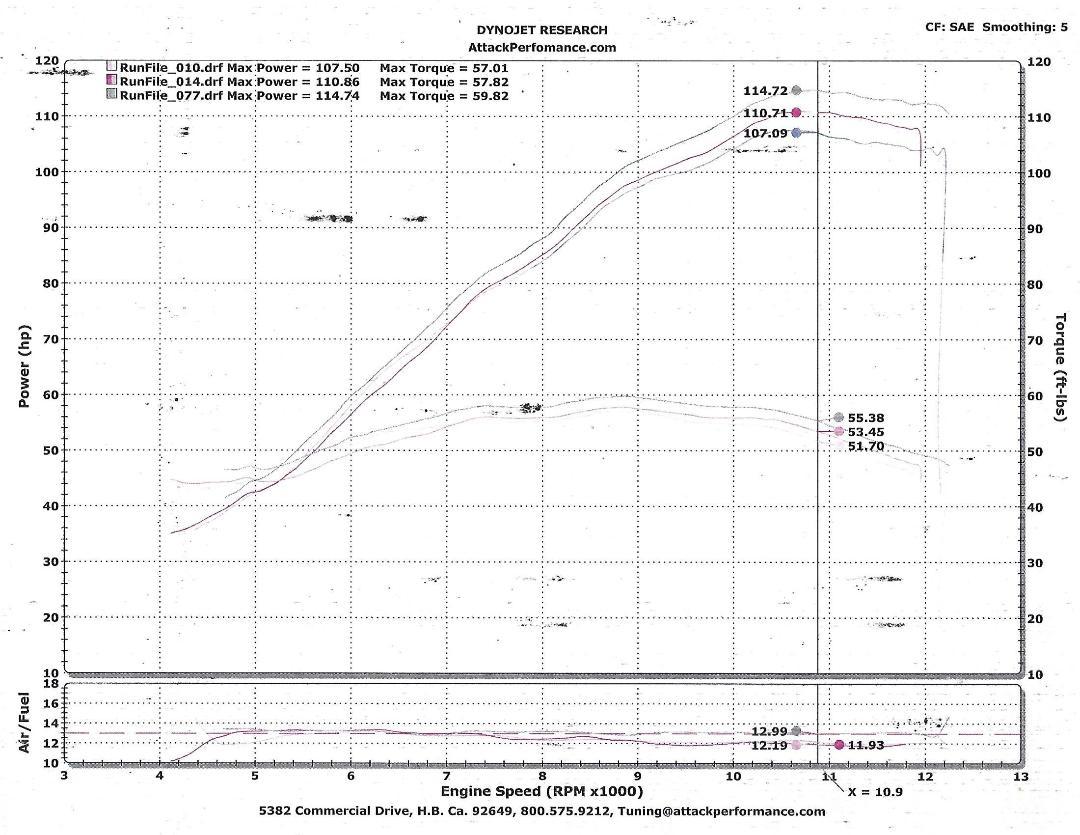

timmoer Posted June 16, 2023 Posted June 16, 2023 So many pages! Didn't see it in the first post and apologies if I missed it - I'd be very curious to see a dyno of a 98-99 5th gen: 1) Stock, or with a slip-on 2) As above (for A-B comparison) with this header and a tune Quote
Member Contributer Duc2V4 Posted June 16, 2023 Member Contributer Posted June 16, 2023 25 minutes ago, timmoer said: So many pages! Didn't see it in the first post and apologies if I missed it - I'd be very curious to see a dyno of a 98-99 5th gen: 1) Stock, or with a slip-on 2) As above (for A-B comparison) with this header and a tune If I recall these came from some Dyno runs done by sfdownhill with his 5 Gen and a friends 6 Gen, and a fellow member who loaned his 8 Gen for some test runs. Unfortunately I don't think there are before/after, but I'd have to check with SF, as these were done right after the first production run. These are from 2019. The images I have say "comparison" but I don't remember the details, it was a while ago and before my brain surgery, so I do question my memory sometimes now. This is the 5 Gen run. 2 Quote
