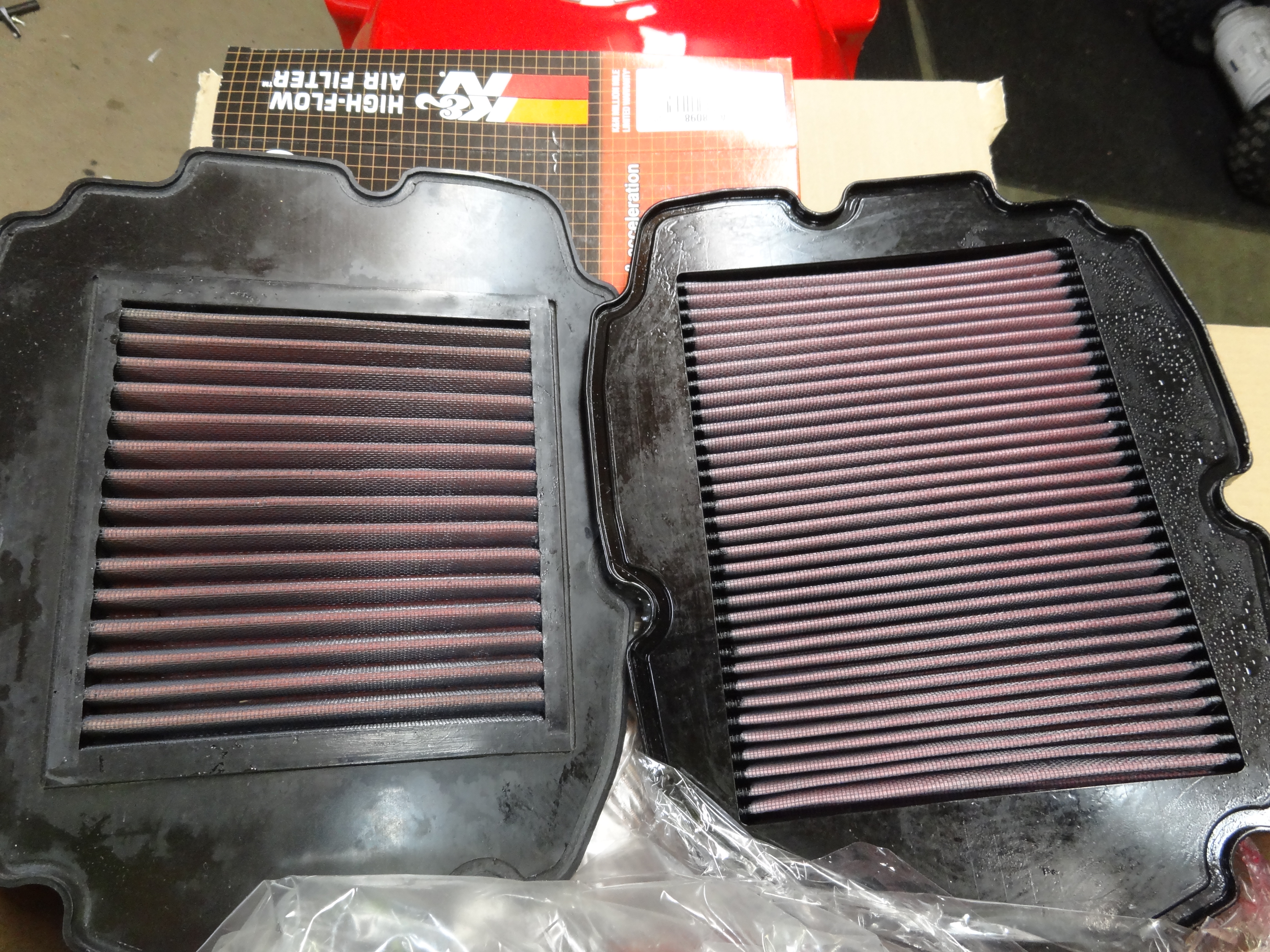

Member Contributer ducnut Posted April 22, 2020 Member Contributer Posted April 22, 2020 1 hour ago, Duc2V4 said: Oh yeah, in regards to the K&N air filter recommendation, it was selected as the one used for the Dyno tuned bike, so we have a known working sample. No other airbox or intake mods were done on any of the bikes as far as I recall. Note however that K&N has two models of the air filter BUT both have the same part number (Go figure?!). One of them however has a much larger square inch coverage with the filter material. Not sure how to order and get the latter one other than possibly call K&N directly. IIRC, if you order direct from K&N, you’ll get the larger filter element. I speculate the smaller element is an older-style filter that some distributors may have had leftover. 1 1 Quote
eyrwbvfr Posted April 22, 2020 Posted April 22, 2020 I ordered one from a supplier and it indeed was the "big mouth" version. The K&N that came with the bike was the older one with less area. Still good but I wanted max air flow. So, I just ended up selling. I'm thinking any supplier should have the updated version unless by chance they still have old stock (NOS). So, get one from one of the bigger places, assuming they are moving inventory more than the smaller distributors. Just my 2 cents. 1 Quote

Member Contributer interceptor69 Posted April 23, 2020 Member Contributer Posted April 23, 2020 Can someone tell me the size of the filter area of the larger one? I bought one way back in 1998. I don't know if I have the larger or the smaller. Sent from my SM-G975U using Tapatalk Quote
Member Contributer ducnut Posted April 23, 2020 Member Contributer Posted April 23, 2020 29 minutes ago, interceptor69 said: Can someone tell me the size of the filter area of the larger one? I bought one way back in 1998. I don't know if I have the larger or the smaller. Sent from my SM-G975U using Tapatalk 2 Quote

Member Contributer interceptor69 Posted April 24, 2020 Member Contributer Posted April 24, 2020 Thanks. I think I have the smaller one. Bummer...Sent from my SM-G975U using Tapatalk Quote

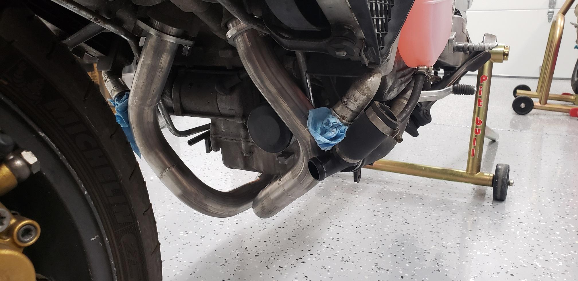

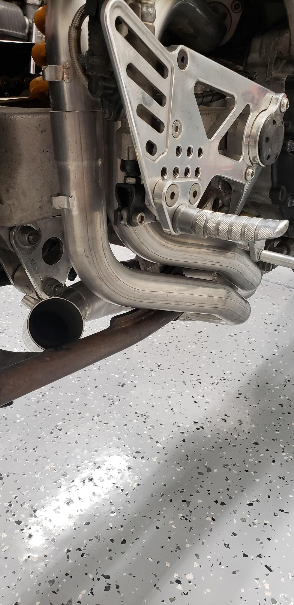

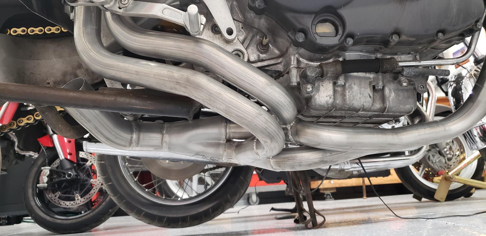

Member Contributer vfrcapn Posted May 6, 2020 Member Contributer Posted May 6, 2020 Nice job guys all around. Test fit the 8th gen header to my 5th gen and it seems to line up well. The water and oil plumbing are going to need to be re-done with new rads but I expected that. The Wolf pipe looked lined up too. Quote
