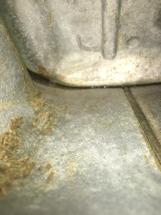

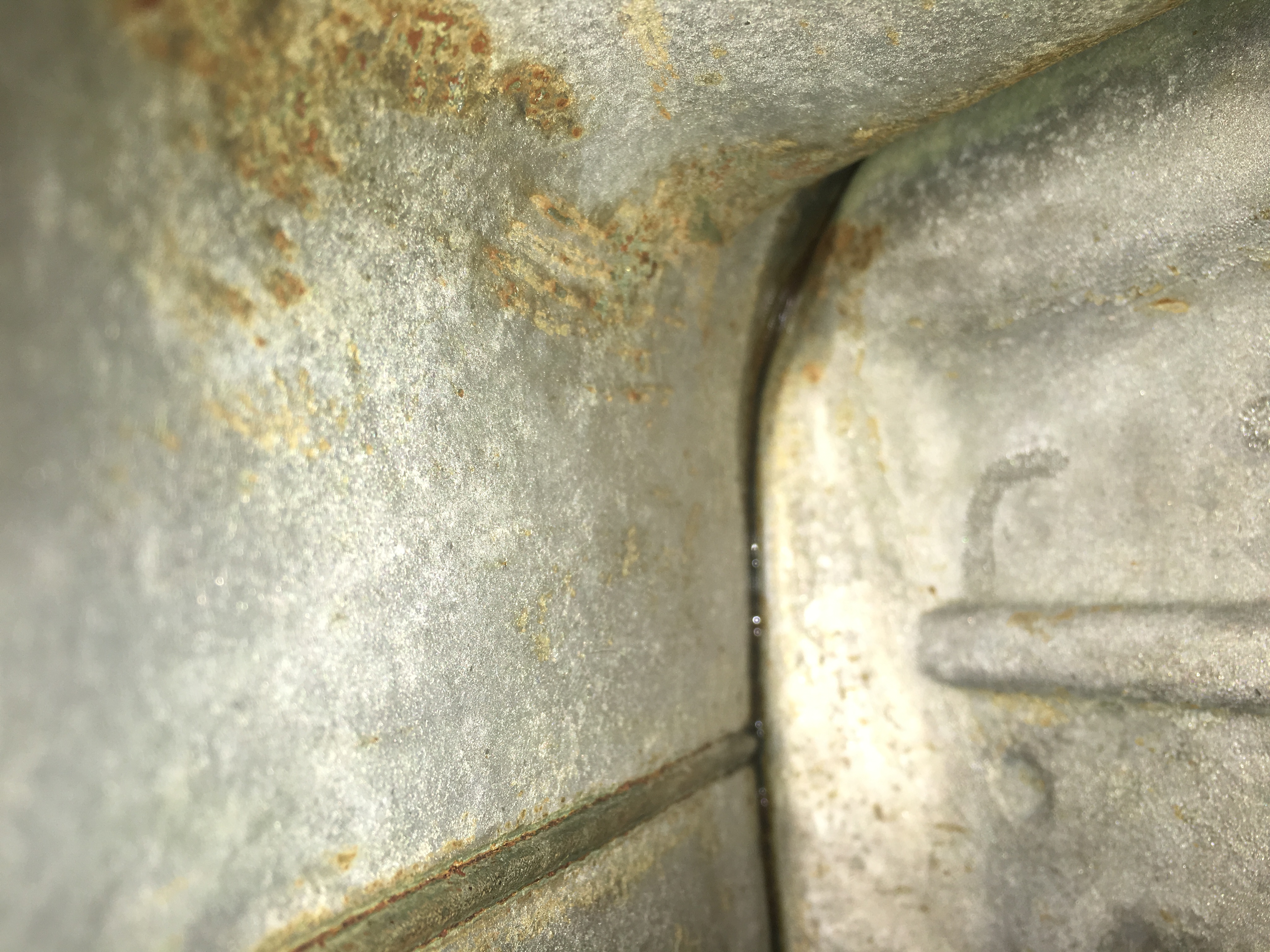

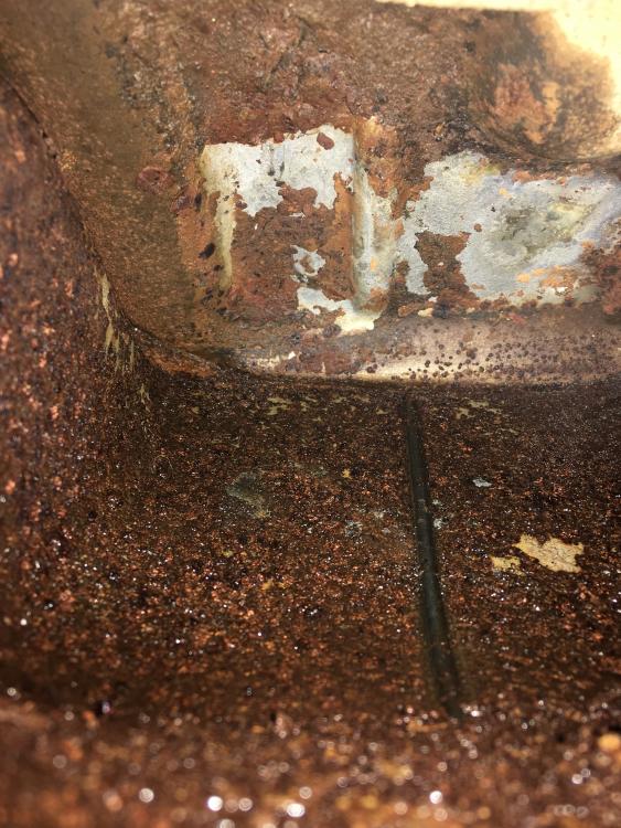

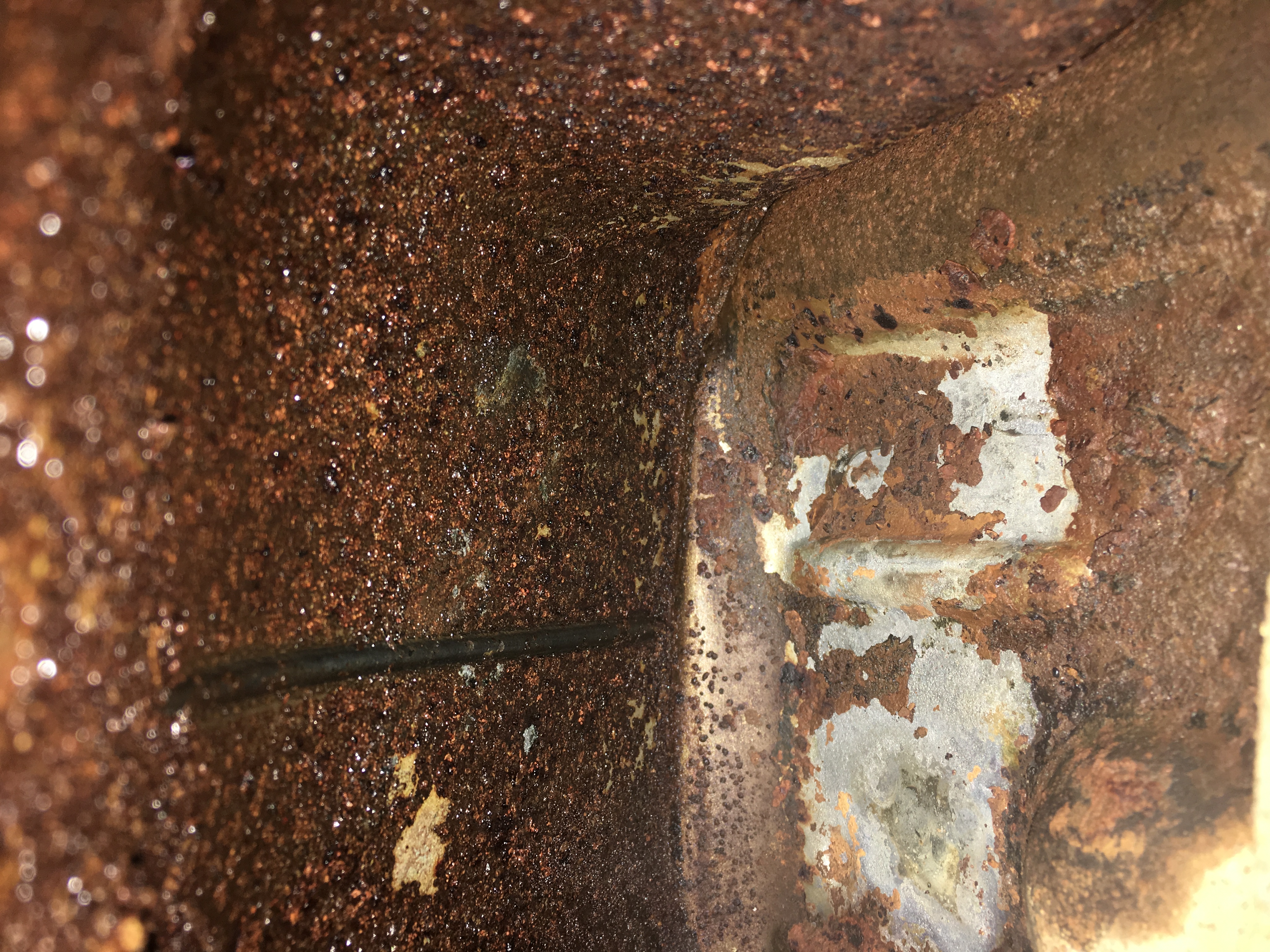

Veefer800Canuck Posted March 21, 2018 Author Posted March 21, 2018 A week’s worth of vinegar, a handful of loose nuts and bolts and shake shake shake. Next step is the 3-part tank cleaning/etching/sealant kit which will enable me to eBay the used tank and offset the cost of the brand new one I’m getting from partzilla. Quote
Veefer800Canuck Posted March 22, 2018 Author Posted March 22, 2018 7 hours ago, Auspanglish said: Holy Guano Batman!! Yep, it was a huge mess. Quote

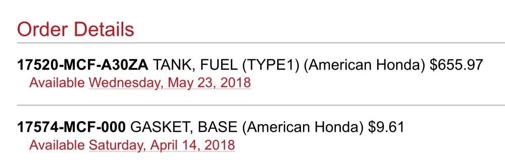

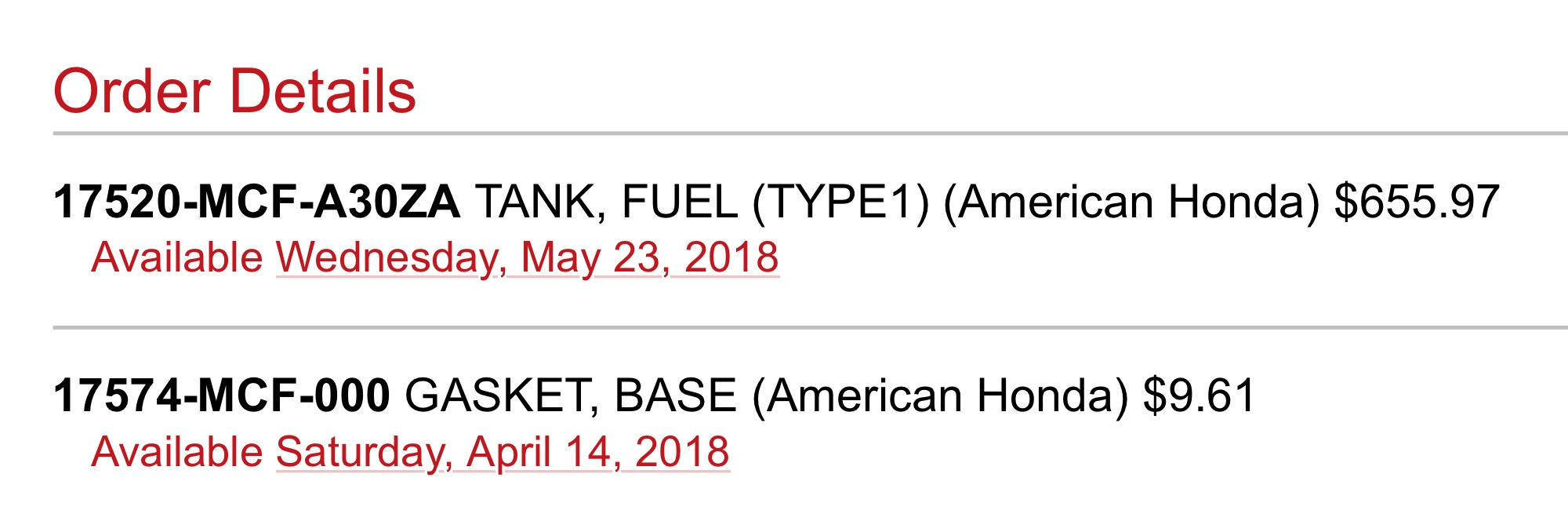

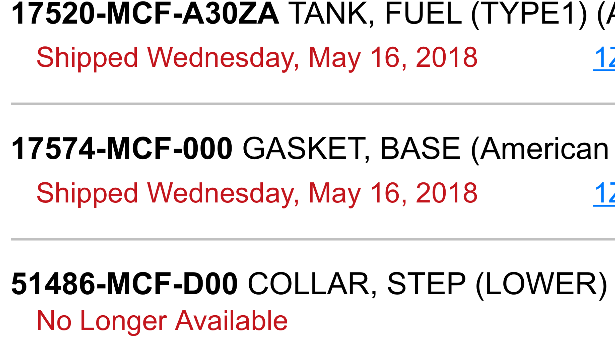

Veefer800Canuck Posted April 6, 2018 Author Posted April 6, 2018 Dammit, my new fuel tank won’t be here until mid May. Ordered dec 27th Hope it’s sooner!!! Quote

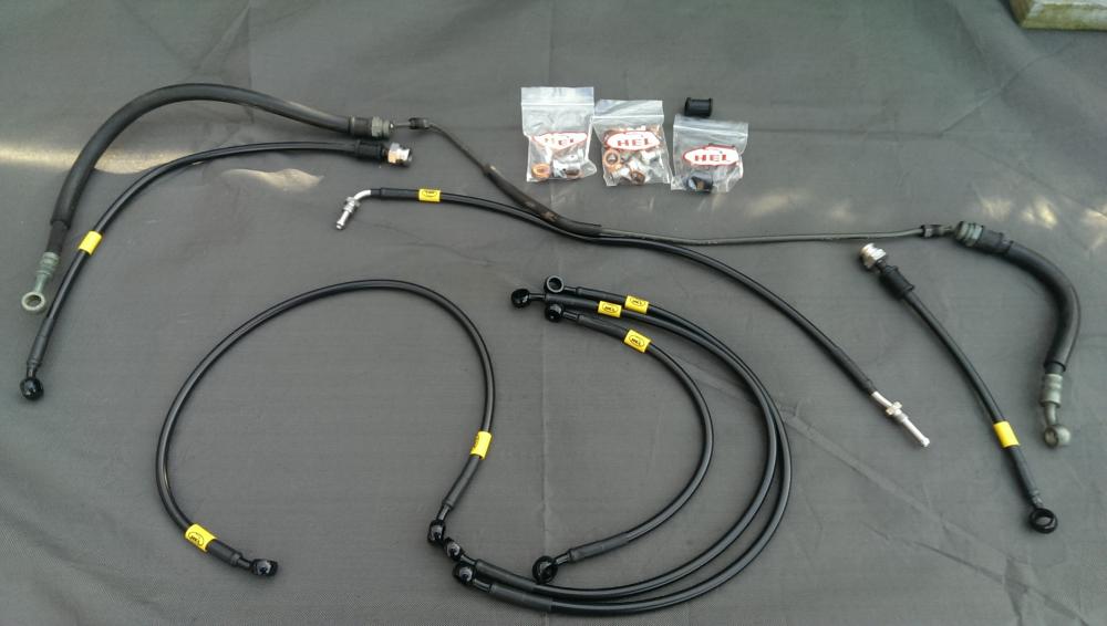

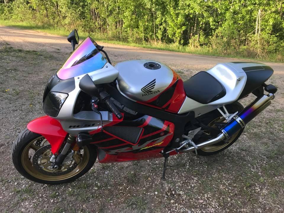

Veefer800Canuck Posted April 7, 2018 Author Posted April 7, 2018 How to make 17 year old brake lines disappear. I got carbon look/black banjos Front/rear and clutch lines Quote
Member Contributer Dutchy Posted April 7, 2018 Member Contributer Posted April 7, 2018 "Back in black" Quote
Veefer800Canuck Posted April 7, 2018 Author Posted April 7, 2018 4 hours ago, Dutchy said: "Back in black" Niceeeeeeee!!!! Quote
SEBSPEED Posted April 7, 2018 Posted April 7, 2018 Core Moto is good stuff, use them for all my custom projects. Love the dished head banjos they supply. They are fast too. Quote
Veefer800Canuck Posted April 8, 2018 Author Posted April 8, 2018 13 hours ago, SEBSPEED said: Core Moto is good stuff, use them for all my custom projects. Love the dished head banjos they supply. They are fast too. Yeah I figured the old rubber lines deserved a vacation. 1 Quote
Member Contributer 2thdr Posted April 9, 2018 Member Contributer Posted April 9, 2018 Rob how difficult do you find it to install all new lines and get the system filled and bled completely of all air? Do you use a motorized vacuum?Sent from my XT1254 using Tapatalk Quote
Veefer800Canuck Posted April 12, 2018 Author Posted April 12, 2018 On 2018-04-09 at 3:02 PM, 2thdr said: Rob how difficult do you find it to install all new lines and get the system filled and bled completely of all air? Do you use a motorized vacuum? Sent from my XT1254 using Tapatalk So far I’ve drained and flushed the RC’s brakes twice once as PM and the brakes were still squidgy feeling so I then dismantled and cleaned the whole system and bled them again THEN I decided to do new lines so I get to do it a 3rd time im an idiot!!! Haha actually its really easy, just takes time and care to get all the air out no abs or lbs so it’s much simpler! Quote
Veefer800Canuck Posted April 12, 2018 Author Posted April 12, 2018 May 23 for the new fuel tank shit Quote

Member Contributer Skids Posted April 13, 2018 Member Contributer Posted April 13, 2018 On 09/04/2018 at 10:02 PM, 2thdr said: Rob how difficult do you find it to install all new lines and get the system filled and bled completely of all air? Do you use a motorized vacuum? Sent from my XT1254 using Tapatalk I replaced them on my 6th Gen and I'm no spanner monkey so if I can do it, anyone can. As has been said, take your time and it's logical and doable. I use the 6th Gen bleeding guide from this site to help me. Quote
Member Contributer Dutchy Posted April 13, 2018 Member Contributer Posted April 13, 2018 My VF, like the RC, doesnot have linked brakes. So putting the new lines on was doable, even for a certified internal auditor.... I have Speedbleeders so did the following (on the brake and clutch) as I donot have a vacuum thingie -attach drain tube -open valve 1/8th -pull lever and tie a rubber band around it -only a small amount of fluid comes out, remove the Speedbleeder and put an OEM one in. -Remove the banjo from the caliper/slave and put in a jar -undo the banjo at the top (put a rag around the area). As you still have the lever compressed the reservoir will not drain itself. -The line will empty itself and then you remove it. Carefull not to spill any drops... -Fit the new line with the banjo/o rings supplied -Attach the drain tube and put the end of the tube in a jar with (the old) fluid, open the oem valve -now you pump the lever multiple times till the fluid level starts to drop and you keep topping up. -once you see fresh fluid coming out, you once more compress the lever and affic with a rubber band. -replace the OEM valve with the speedbleeder -the reason for this is that the air in an empty line will not compress the little spring/ball inside a speedbleeder -you now complete the process with the speedbleeders till all air is out -leave the bike overnight with the levers compressed with a rubber band Quote

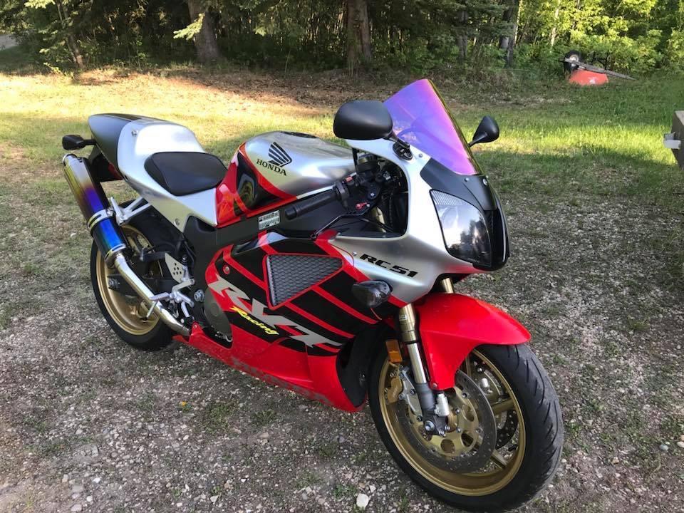

Member Contributer St. Stephen Posted April 14, 2018 Member Contributer Posted April 14, 2018 Really enjoying this thread, sorry about the (extreme) tank delay, was hoping to see your project out on the road soon! I might have missed it, but what about the rear shock? Planning an upgrade? A VFR/RC51 motivational pic: Quote

Veefer800Canuck Posted May 17, 2018 Author Posted May 17, 2018 Woot! New fuel tank finally shipped out after 5 MONTHS!!! Quote
mello dude Posted May 17, 2018 Posted May 17, 2018 ^^^^^ Congrats! Cool! -- You gotta post pics when it shows up.. Quote
Veefer800Canuck Posted May 18, 2018 Author Posted May 18, 2018 23 hours ago, mello dude said: ^^^^^ Congrats! Cool! -- You gotta post pics when it shows up.. Oh yeah! Quote

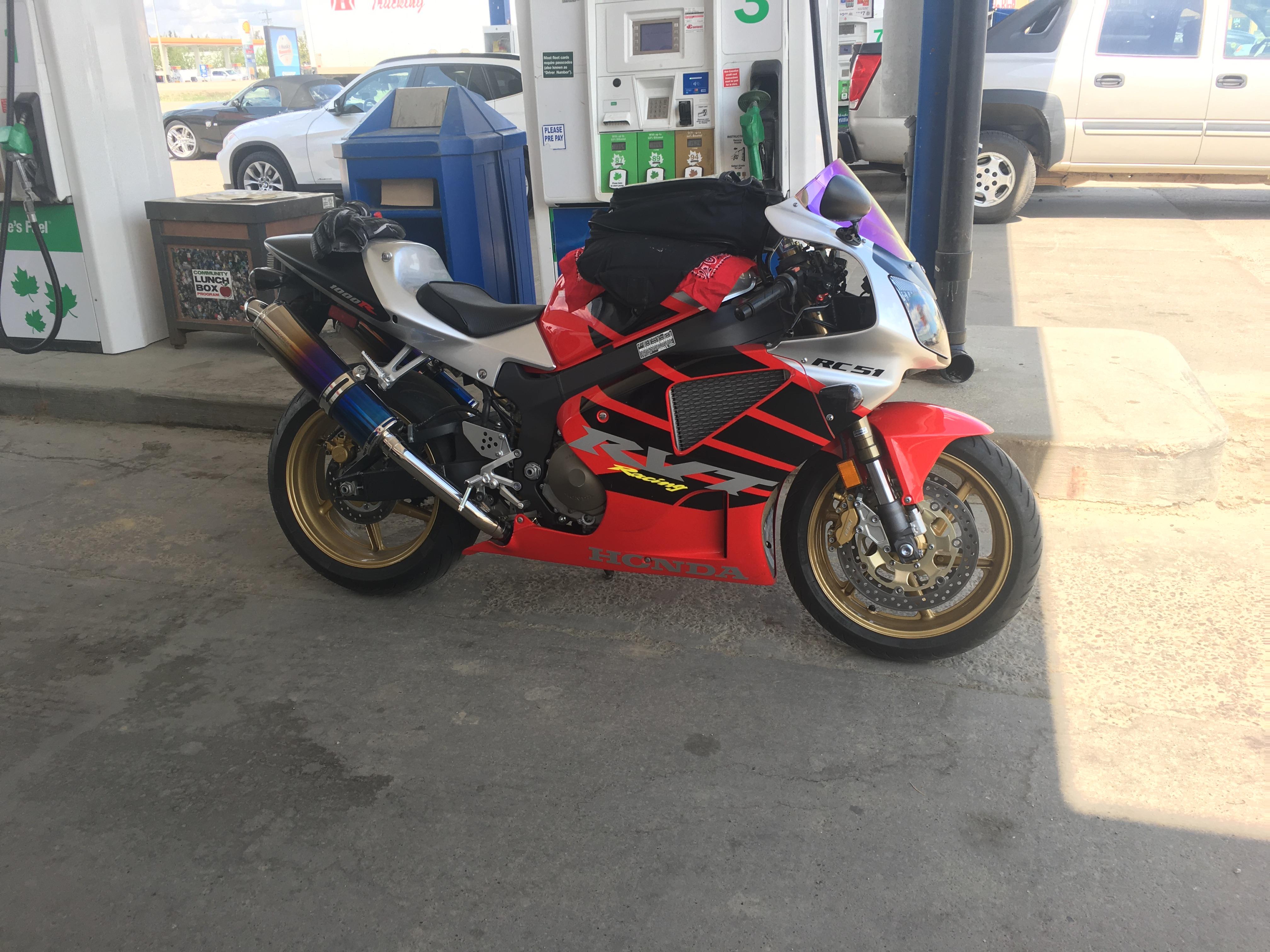

Veefer800Canuck Posted May 26, 2018 Author Posted May 26, 2018 Riding great fellas!!! This thing is a rush! 1 Quote
Member Contributer KevCarver Posted May 26, 2018 Member Contributer Posted May 26, 2018 I used to call mine The Time Machine. It seemed to get me places faster than physics should allow! Ironically it topped out 1 mph slower than my VFR, but it sure got there a whole lot faster! 1 Quote
Member Contributer Cogswell Posted May 26, 2018 Member Contributer Posted May 26, 2018 It's been a year in the making - and worth the wait. Sweet! 1 Quote
