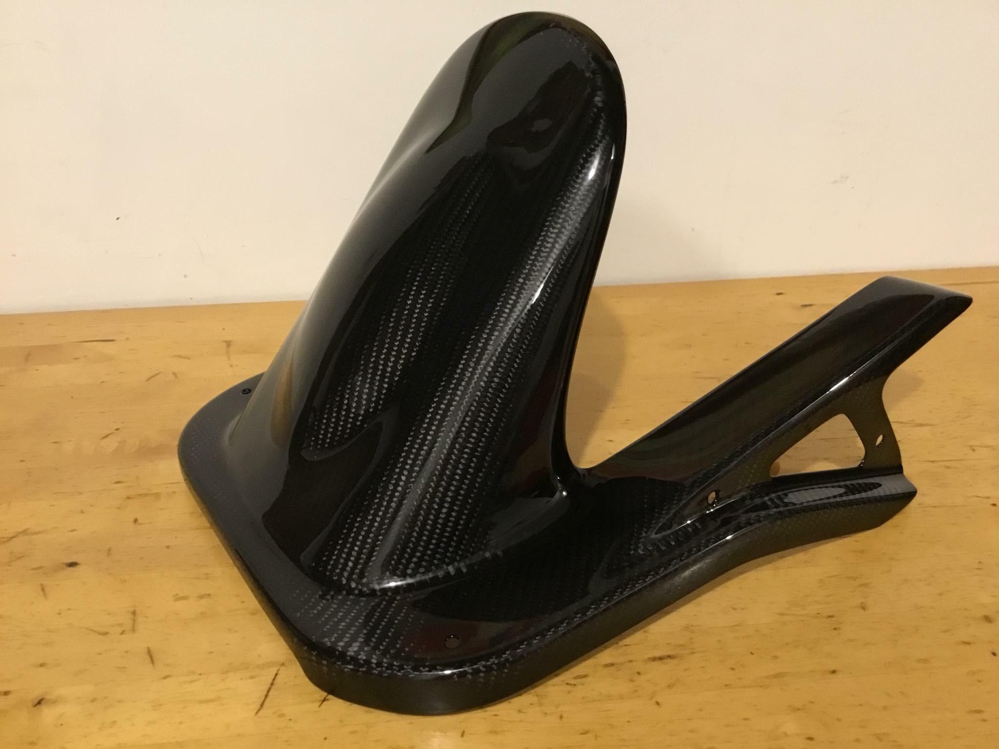

It’s an old used Lockhart Phillips hugger I got for $50, and then I modified it with the bulge for the taller tire.
Matt from Duckhunter Composites saw it and wanted me to ship it to him so he could make a mold of it and begin production in CF.
I got the first one free.

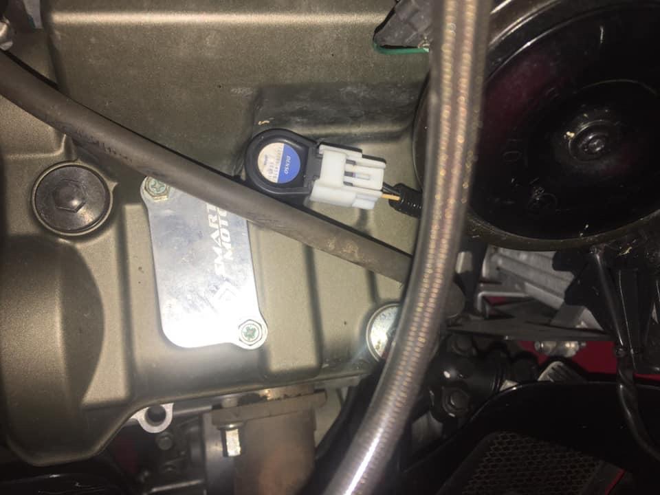

Update: end of last season, the injectors for the rear cylinder shit the bed, despite cleaning the entire fuel system, new tank, and professionally cleaned fuel injectors.
it was down on power, coughing and bucking, popping and farting, running like a bag of shit.
I determined the fault by swapping the rear injectors to the front cylinder, and vice versa.
Exhaust pipe temp on the good cyl was 350’c shortly after cold startup, whereas bad cyl was between 30-40’C
swapping the injectors made the problem reverse itself, so.....
4 brand new OEM injectors cured the problem, at an astronomical cost. Ouch.

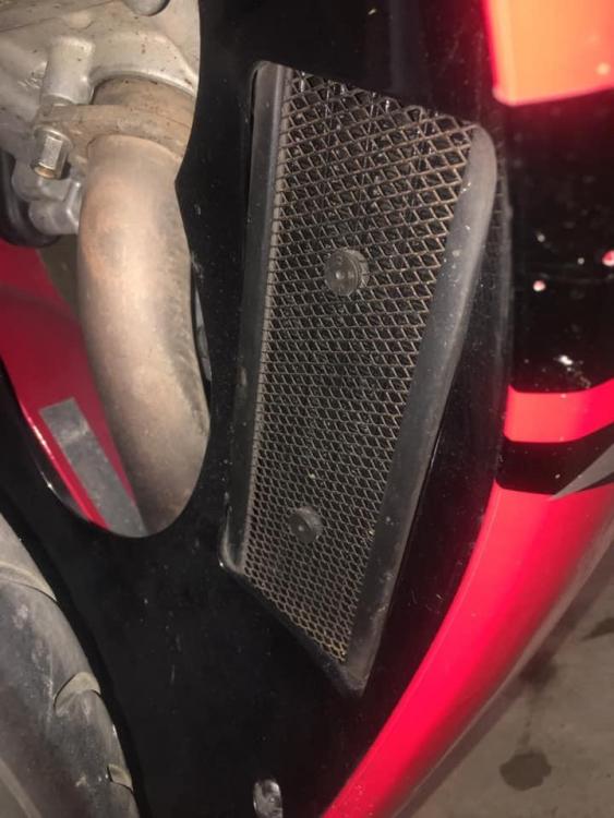

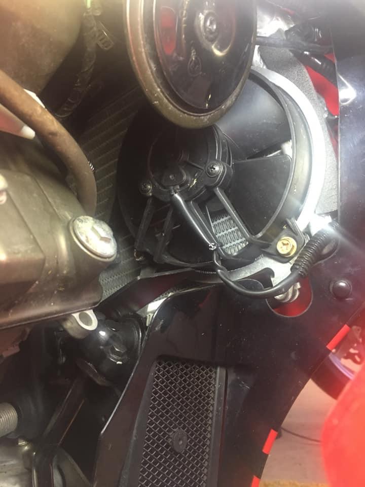

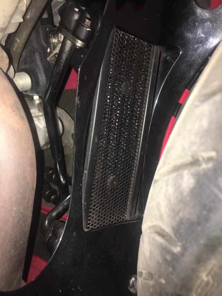

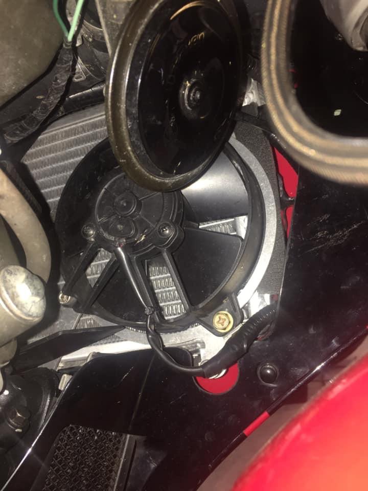

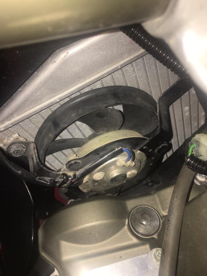

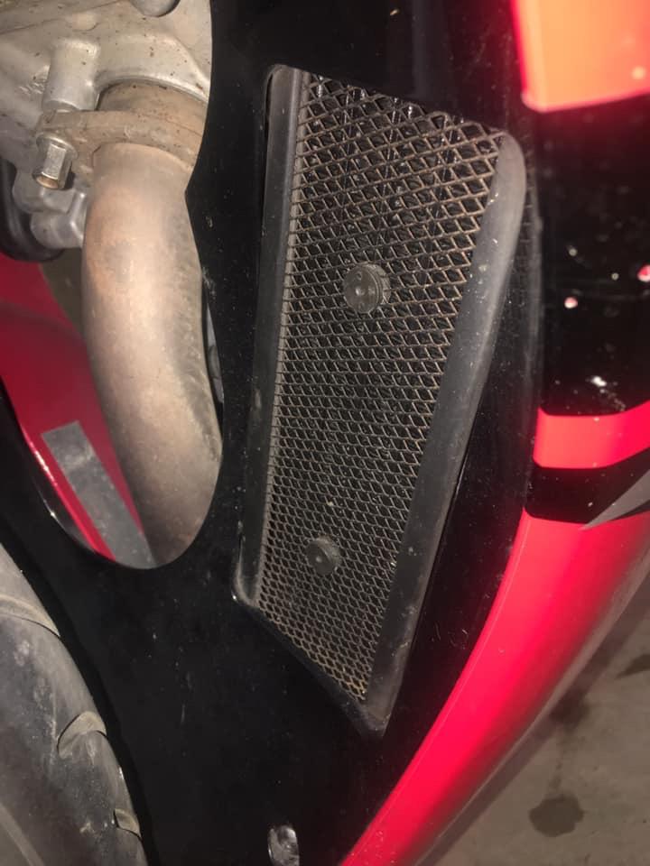

Also, through the winter, I added an SP2 RH radiator with fan (SP1 had only 1 fan), so I have double the cooling capacity when the fans kick in.
However, I also had to get the SP2 oil cooler, lines, and center V-cowl, as it is relocated to allow fitment of the fan on the different rad.
The LH OEM fan had been previously replaced by a SPAL pusher fan, so I now have one pusher fan and one puller fan. Should work OK in traffic and at speed also.

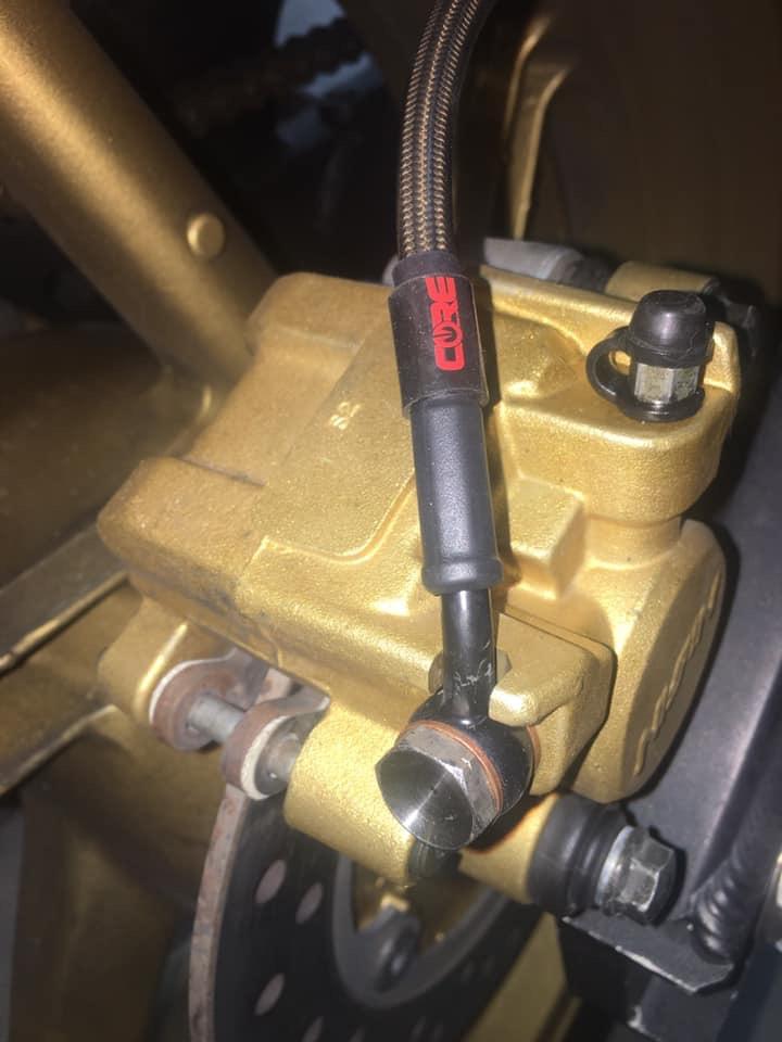

And also put on a full set of Core Moto brake lines, and converted to coil-on-plug ignition using CBR600RR coils and modified CBR OEM coil wiring harness.

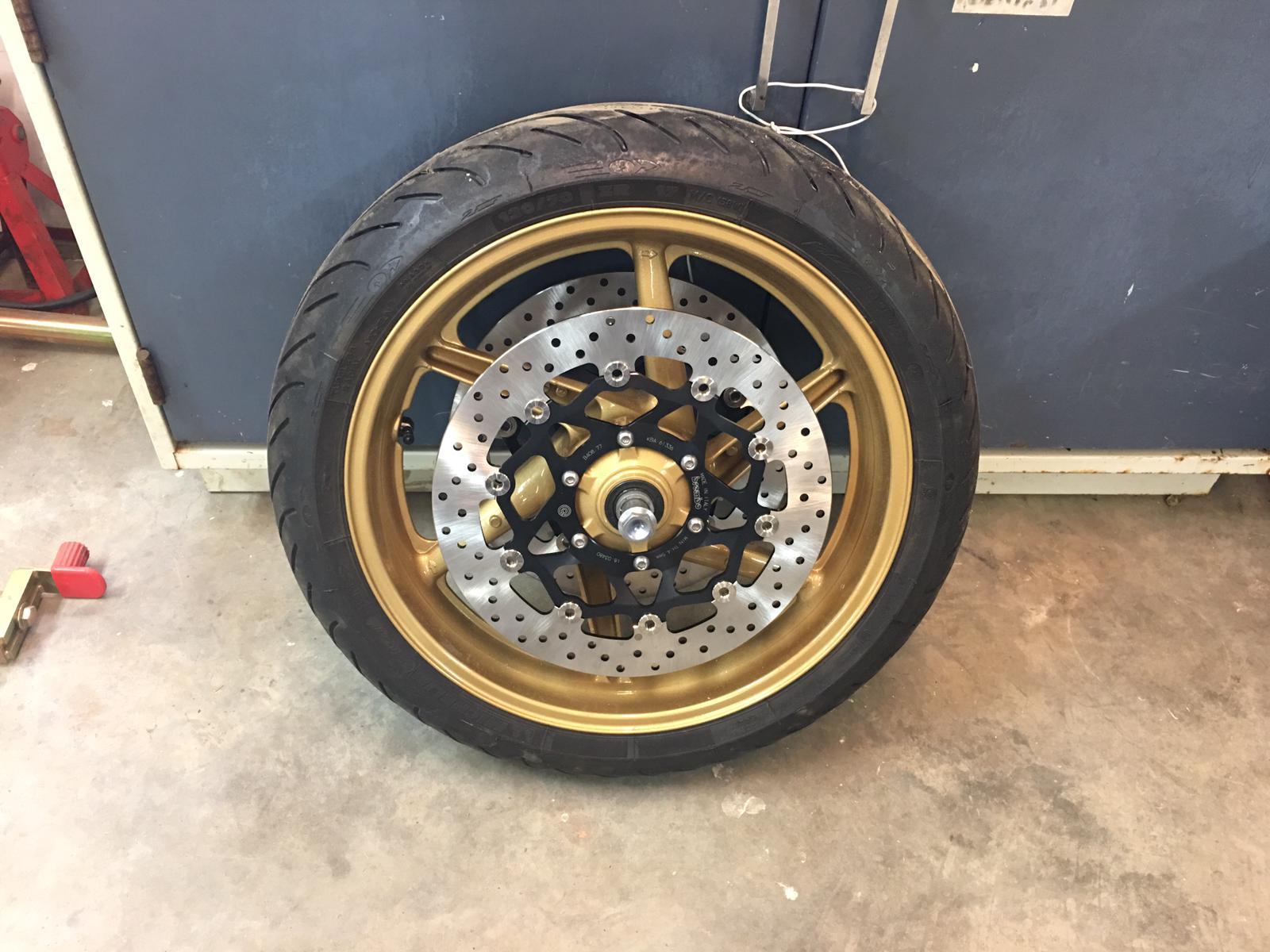

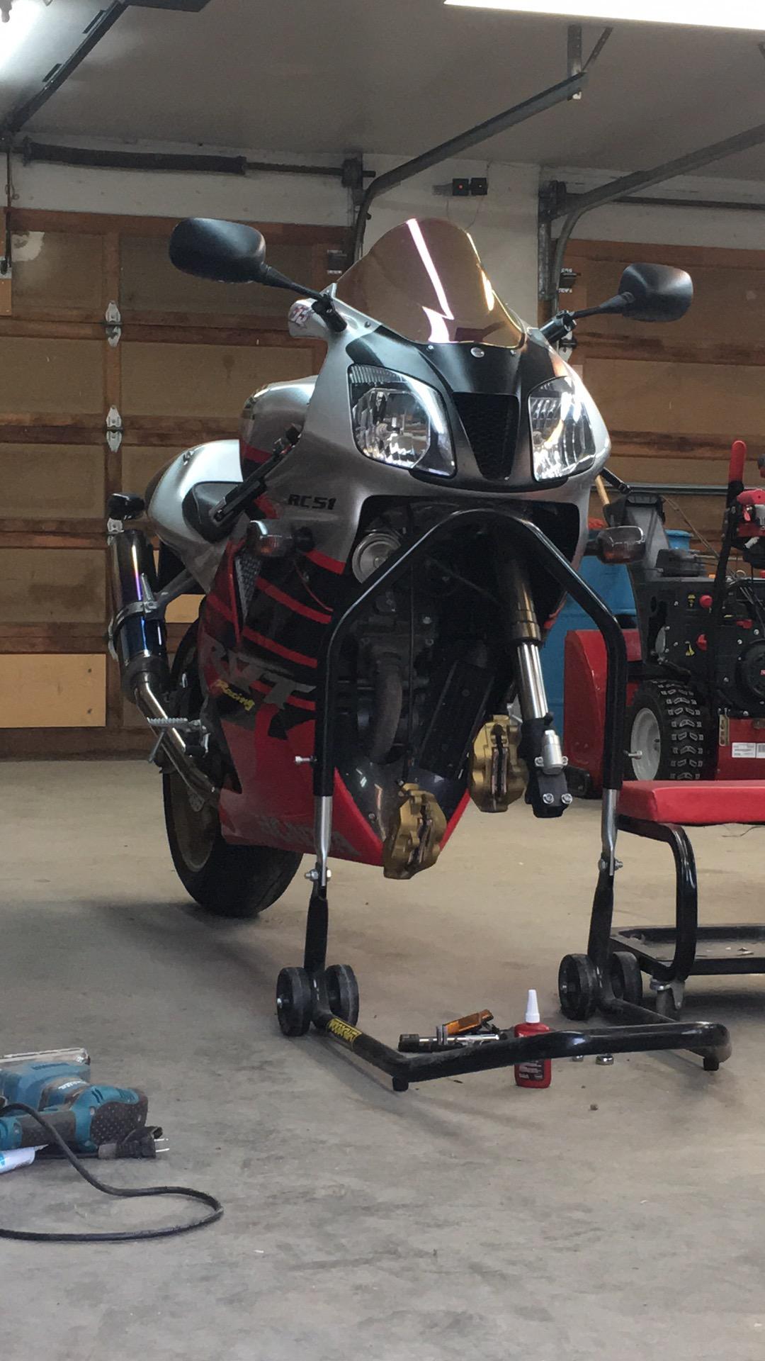

Down for a leaky fork seal. Drat!
BUT, also got new Brembo front discs and some new SBS sintered pads. Happy birthday to me!
Van harte gefeliciteerd!! :beer:
Fork seal is all good now, new Brembo discs are F’n awesome, paired with the new SBS sintered pads.
