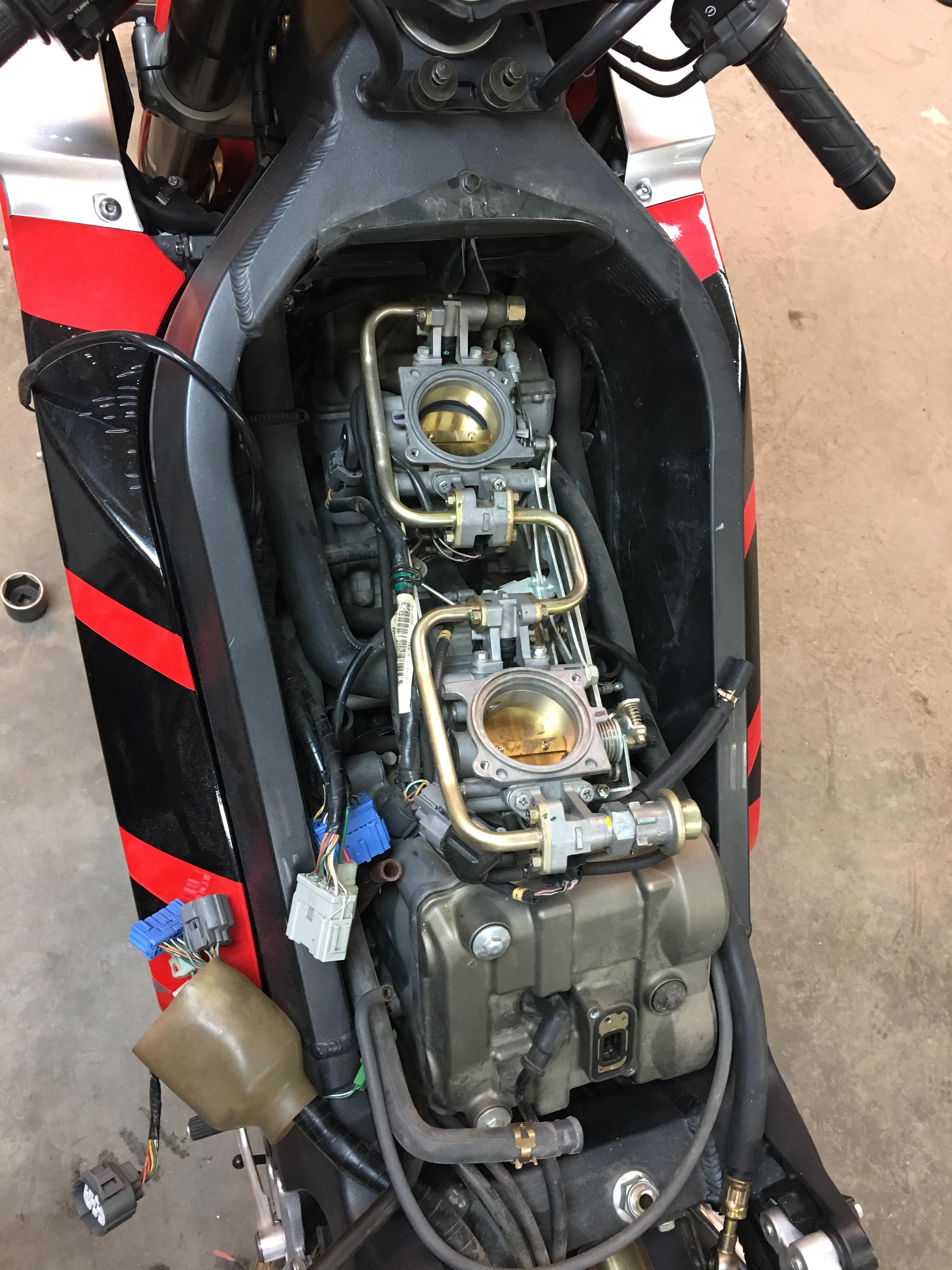

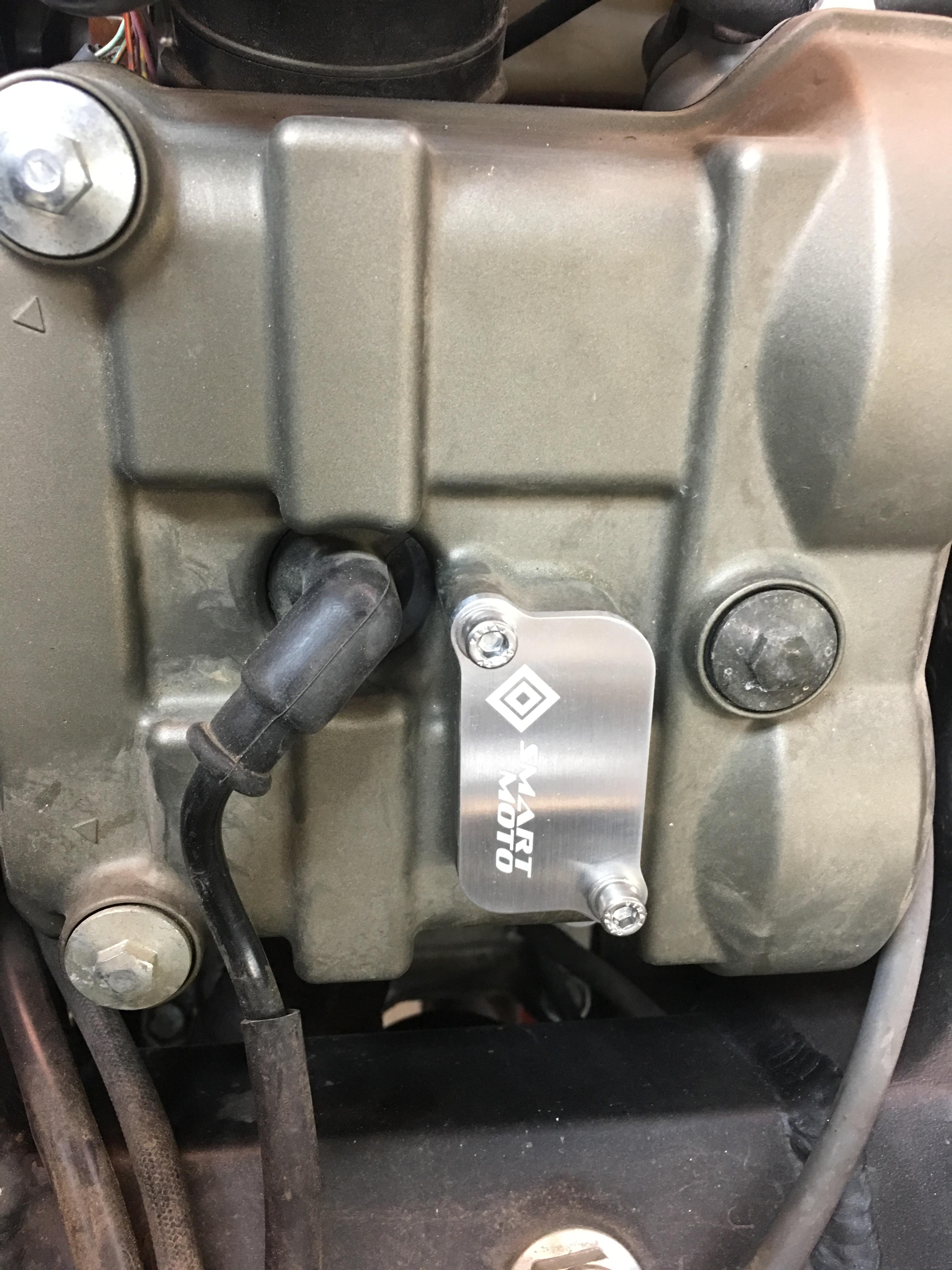

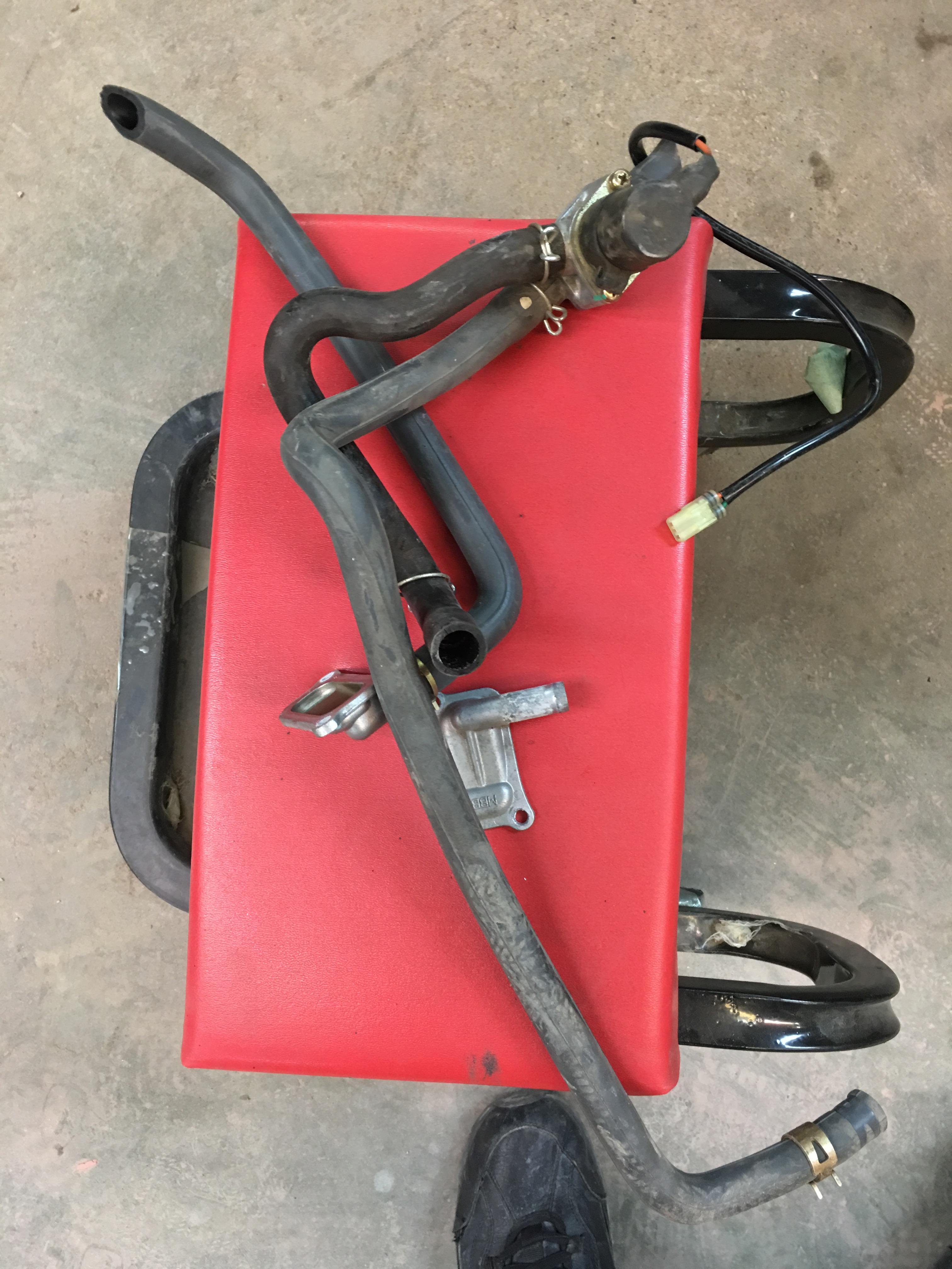

Veefer800Canuck Posted February 17, 2018 Author Posted February 17, 2018 PAIR valve elimination, totally removed all PAIR components, not just plugged off. Quote

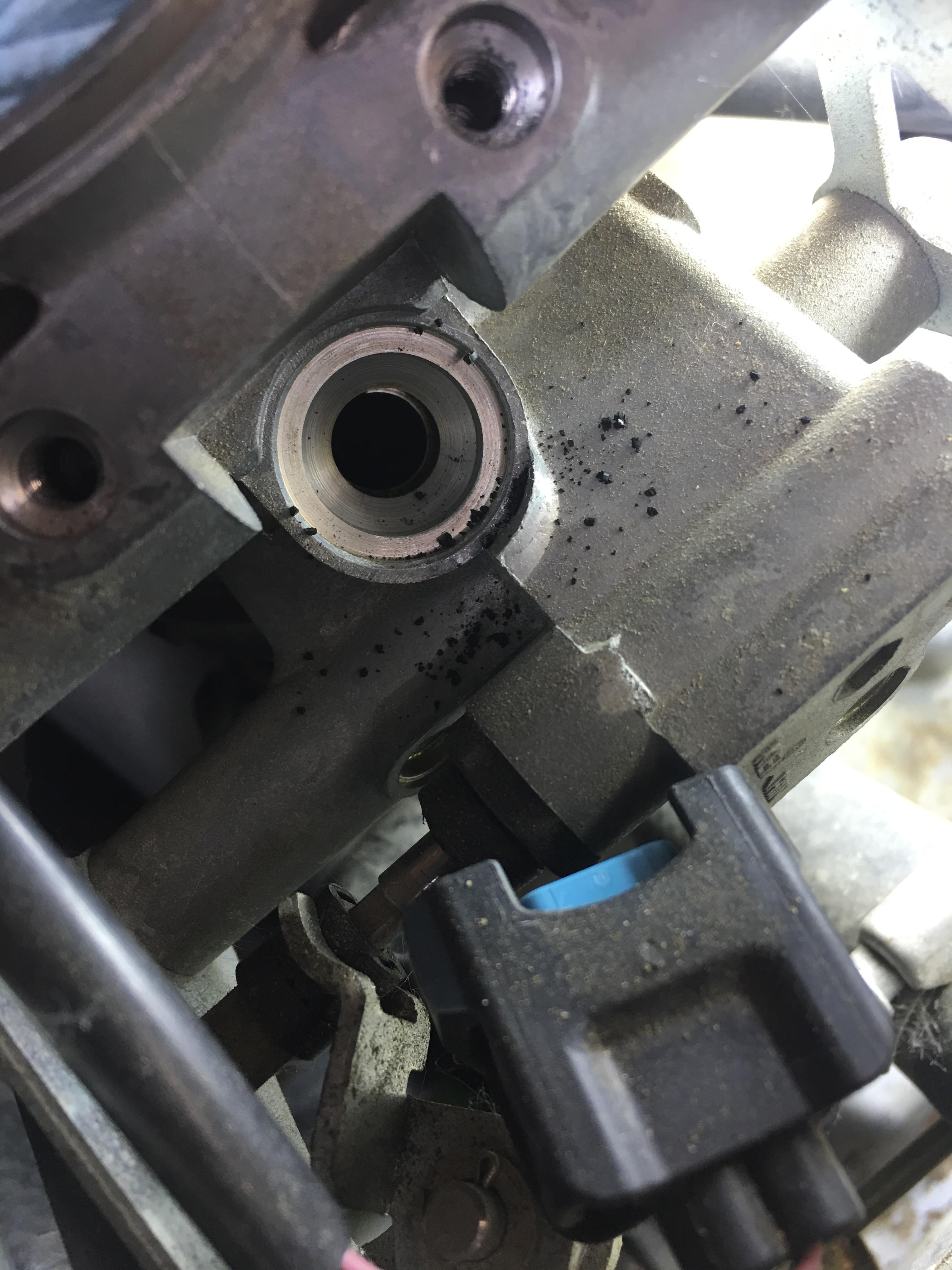

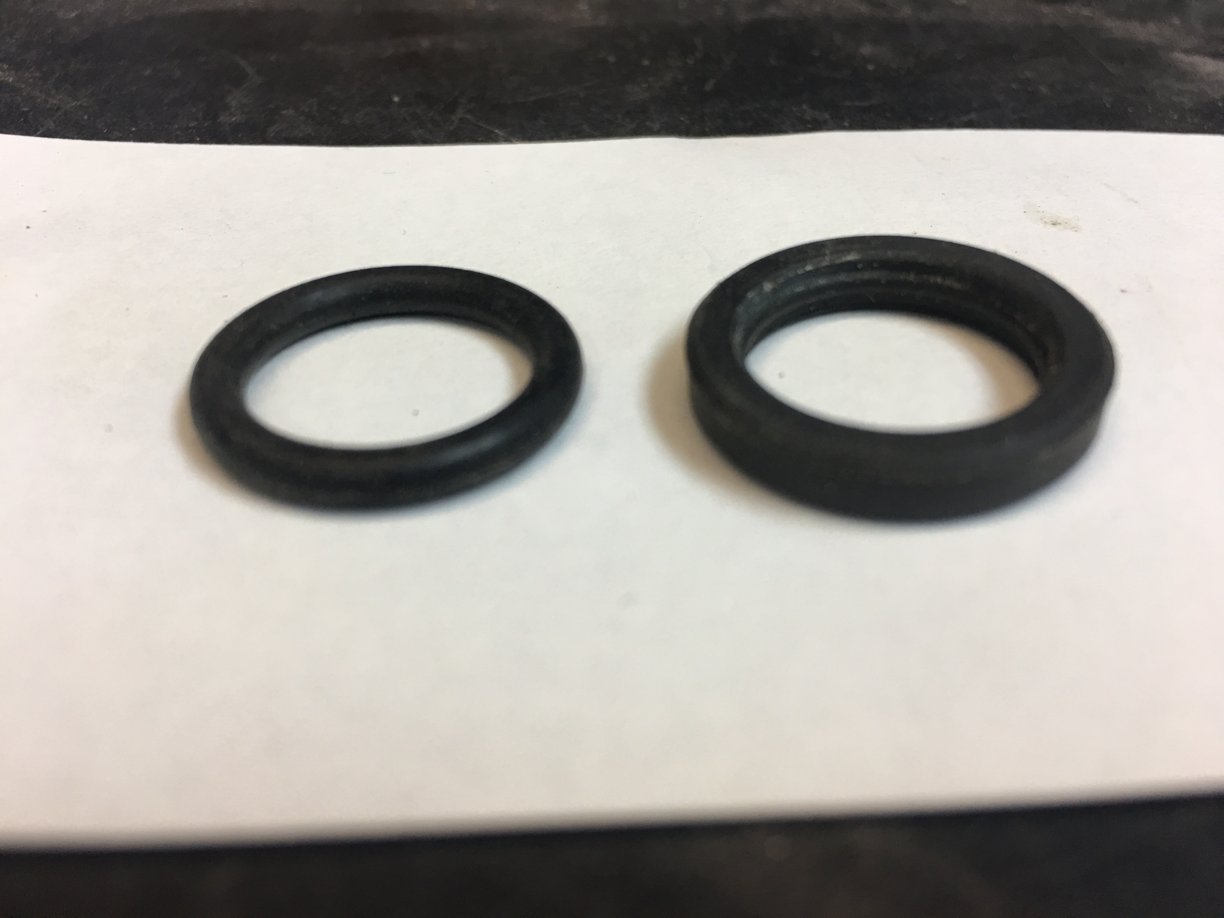

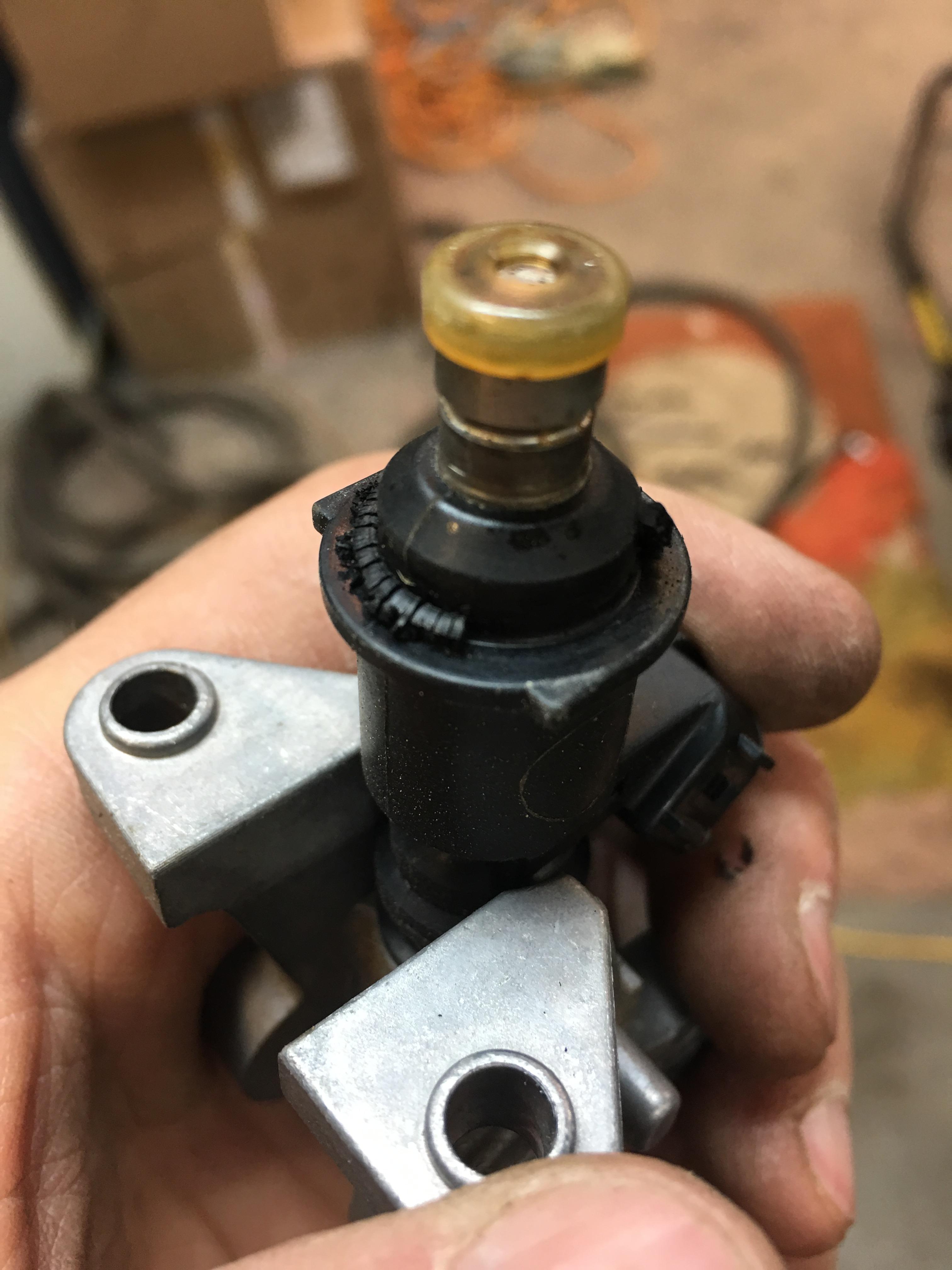

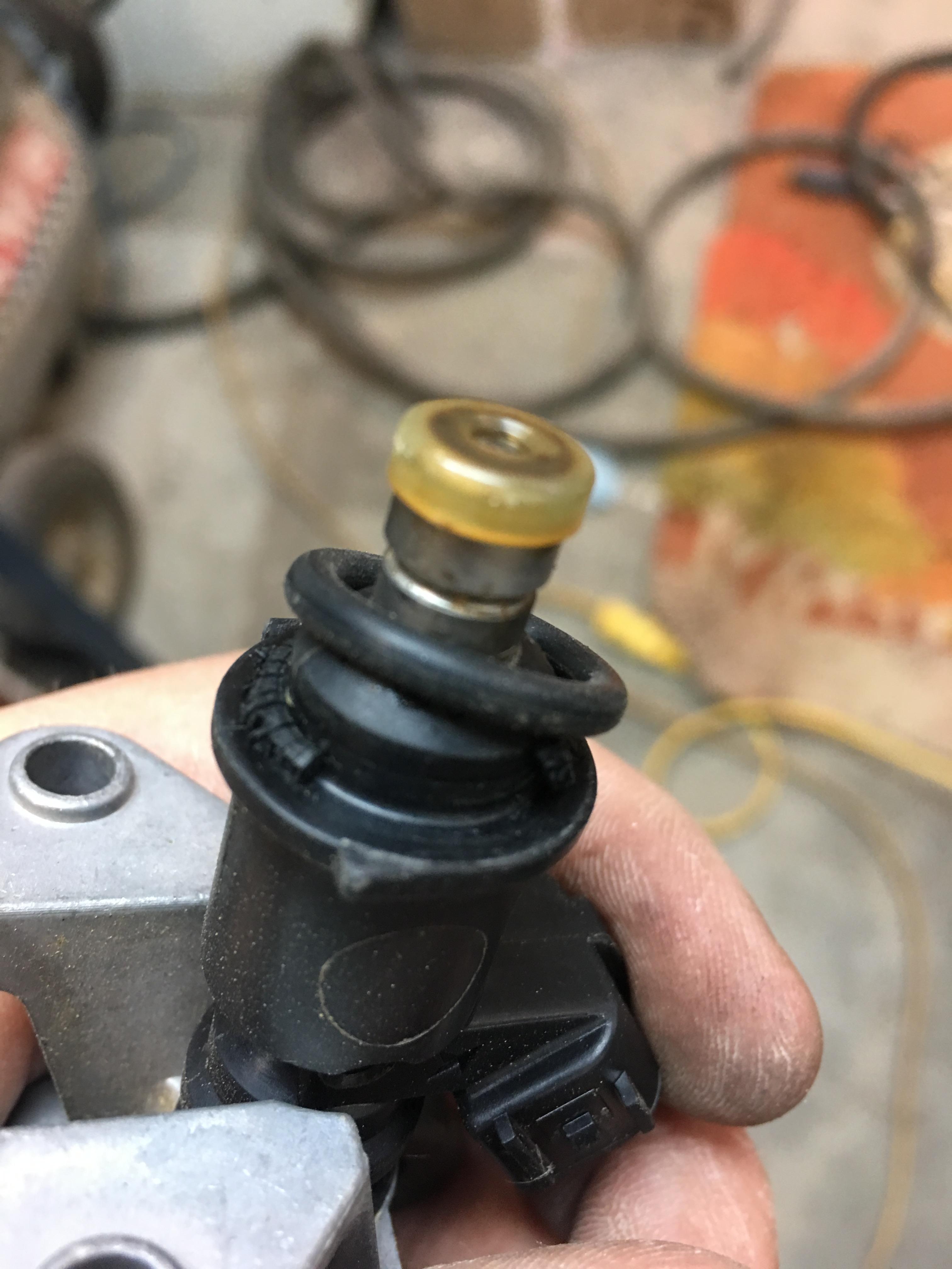

Veefer800Canuck Posted February 17, 2018 Author Posted February 17, 2018 So while I had the airbox off to do the PAIR removal, I thought I’d go the extra mile and pull the injectors, due to the fact that my fuel system was so gacked up from being parked for 10 years by the PO. (BADLY rusted fuel tank) Three injectors came out fine, but the rear injector on the front cylinder left some crumbly black debris on the throttle body when it came off. Looking closely at the injector, what remained of the OEM bottom seal was destroyed, and it looks like someone put a generic O-ring on there which is smaller than the others, also, the remaining 3 appear to be square in profile and not round. Boy am I glad I removed all of this stuff and checked!!! Next stop: professional injector cleaning and new seals. 1 Quote
Veefer800Canuck Posted February 17, 2018 Author Posted February 17, 2018 Flapper valve actuator blanking plate inbound! Quote

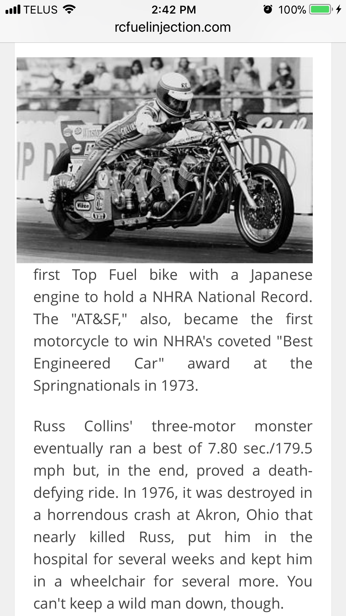

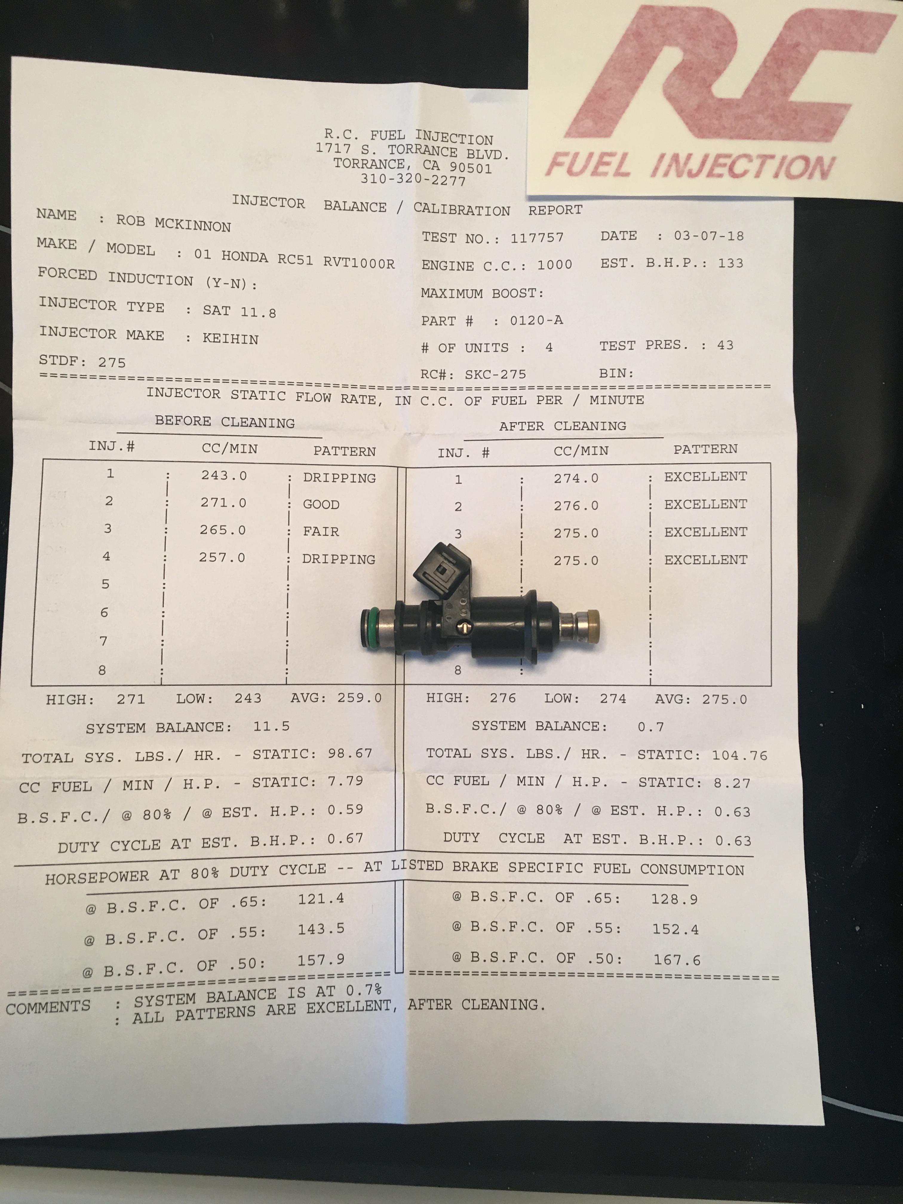

Veefer800Canuck Posted March 10, 2018 Author Posted March 10, 2018 Fuel injectors are being returned from RC fuel injection after being serviced. Some of you who who are old, like me, will remember Russ Collins the drag racer. Well, he’s passed now, but his company lives on. 1 Quote
Member Contributer Cogswell Posted March 10, 2018 Member Contributer Posted March 10, 2018 53 minutes ago, Veefer800Canuck said: Fuel injectors are being returned from RC fuel injection after being serviced. Some of you who who are old, like me, will remember Russ Collins the drag racer. Well, he’s passed now, but his company lives on. Interesting story. It must have been quite a feat of engineering to tie those 3 motors together and run all the power and torque through a gearbox that could take it. RC did a great job for me on both my bikes and cars. I'd definitely use them again. 1 Quote

Veefer800Canuck Posted March 20, 2018 Author Posted March 20, 2018 Got the fuel injectors back and reassembled everything. Waiting on my fuel tank from Japan now, it’s the last thing I need. Been 3 months on backorder. Quote
