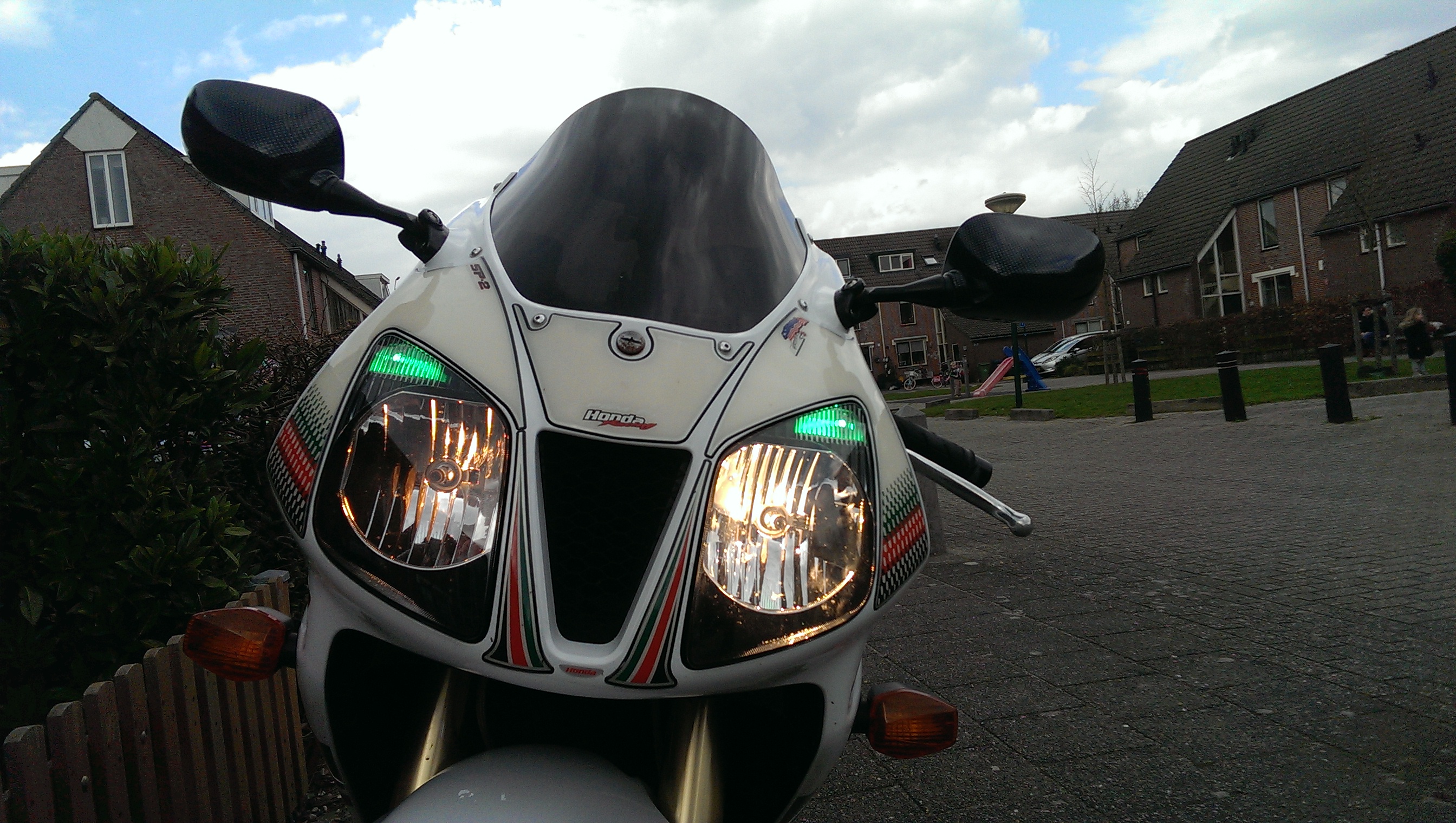

Member Contributer Woodie Posted July 10, 2017 Member Contributer Share Posted July 10, 2017 On 08/07/2017 at 8:02 PM, Veefer800Canuck said: I don't like the flushmounts. We're invisible to cars as-is!!! Fair point. Although I like them as they show up from the sides as well as from the front. Quote Link to comment Share on other sites More sharing options...
Member Contributer Skids Posted July 10, 2017 Member Contributer Share Posted July 10, 2017 On 08/07/2017 at 8:02 PM, Veefer800Canuck said: I don't like the flushmounts. We're invisible to cars as-is!!! The one thing has worked biggest for being seen, for me, has been LED lights, especially the aux LEDs I fitted to the Crossrunner. I know aux lights probably wouldn't work so well on an RC51, but fitting replacement headlight bulbs, whether bi-xenon or LED, would be worth considering imo, if you're not already doing that. Just a thought.....beautiful bike btw. 2 Quote Link to comment Share on other sites More sharing options...
Member Contributer Dutchy Posted July 10, 2017 Member Contributer Share Posted July 10, 2017 Twin yellow headlights, Led dlrl and running lights Dayglo orange helmet and suit One oncoming car turning left despite of all this.... Still ended terminally for redslut... Be CAREFUL out there! (and lucky...) Quote Link to comment Share on other sites More sharing options...

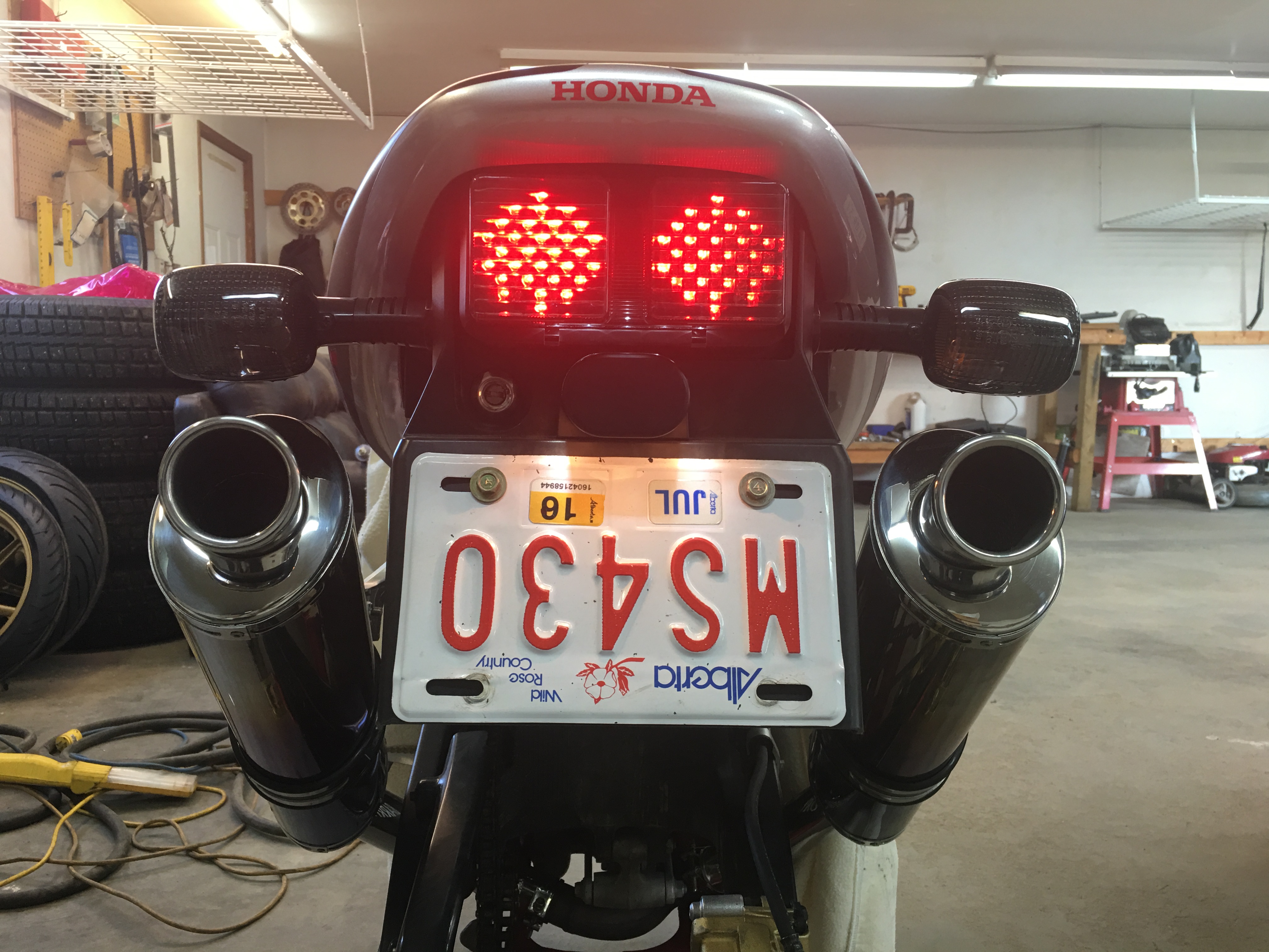

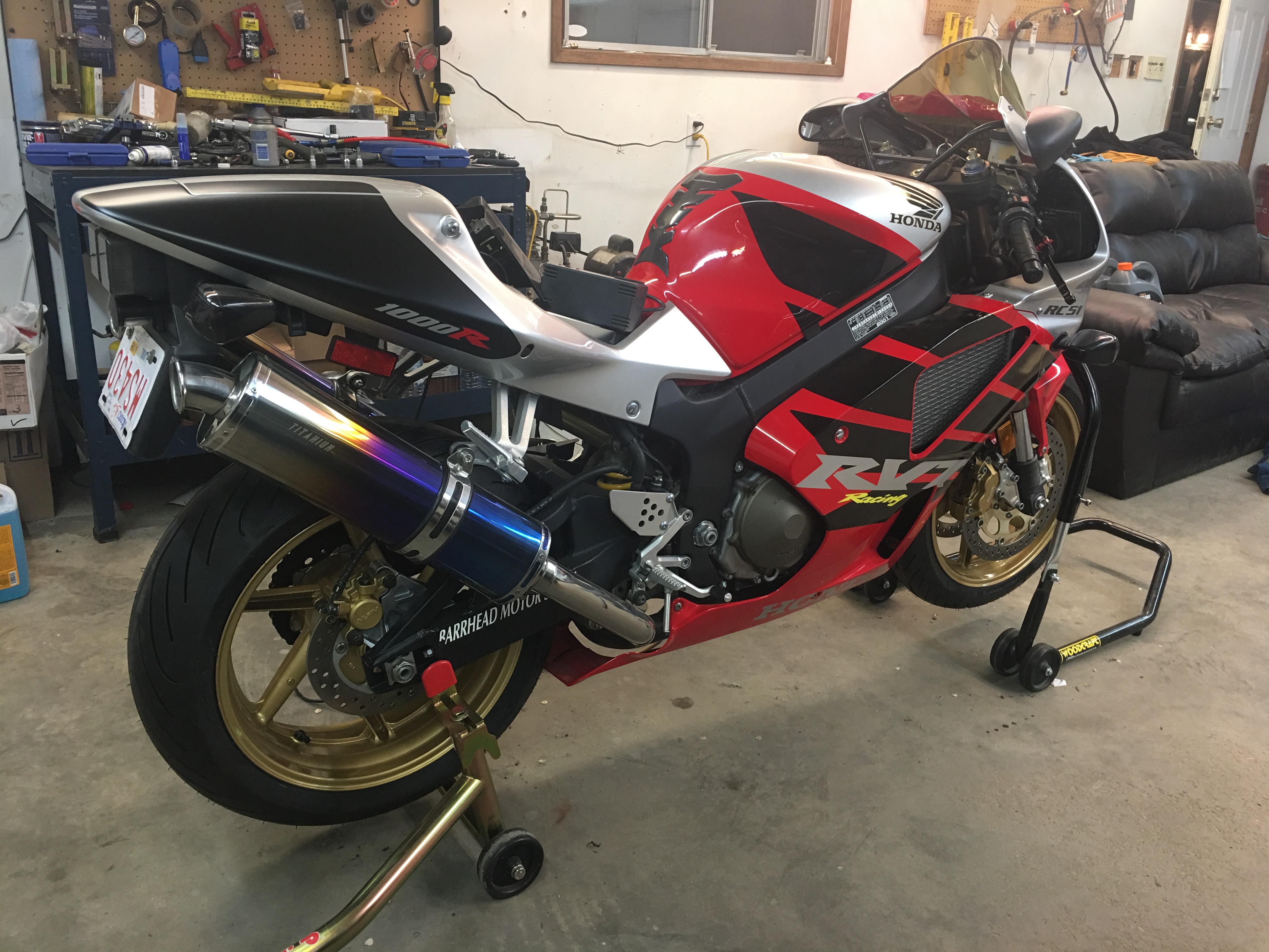

Veefer800Canuck Posted July 15, 2017 Author Share Posted July 15, 2017 Smoked LED taillight 2 Quote Link to comment Share on other sites More sharing options...

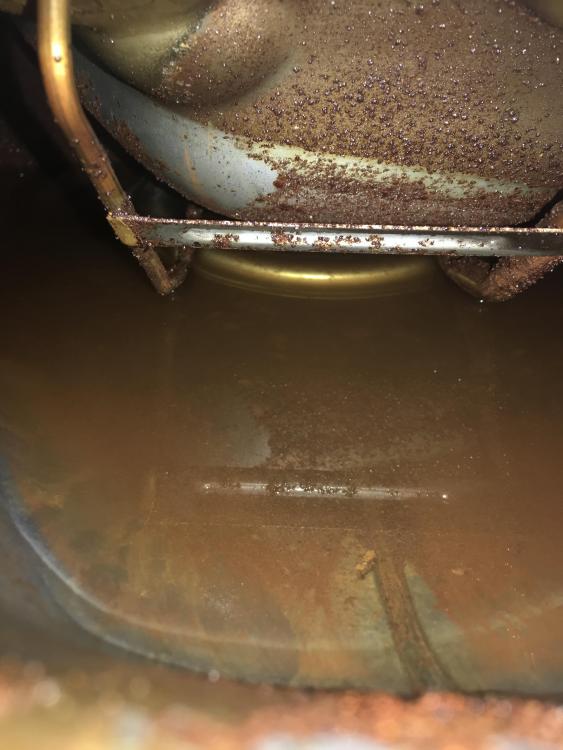

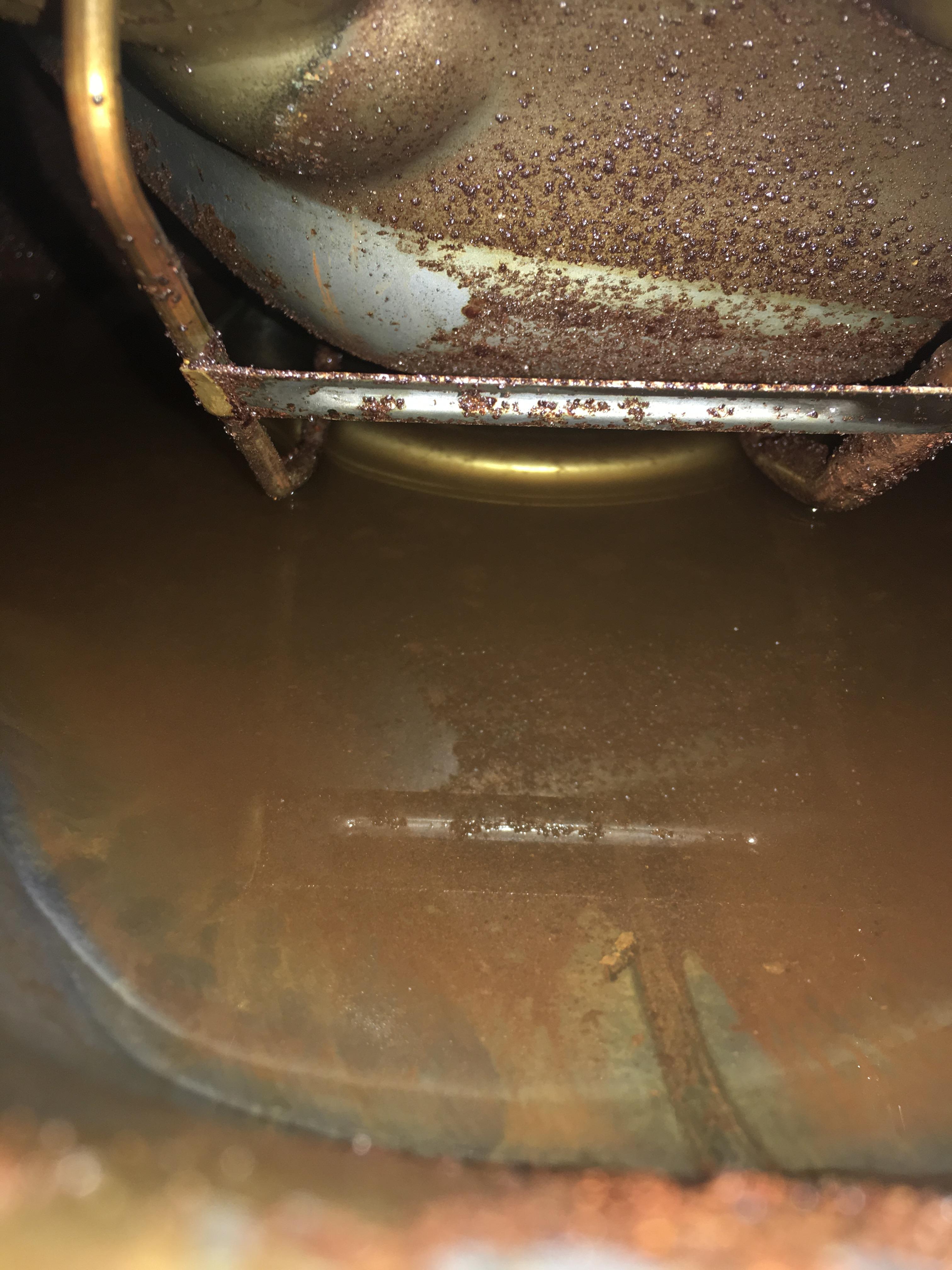

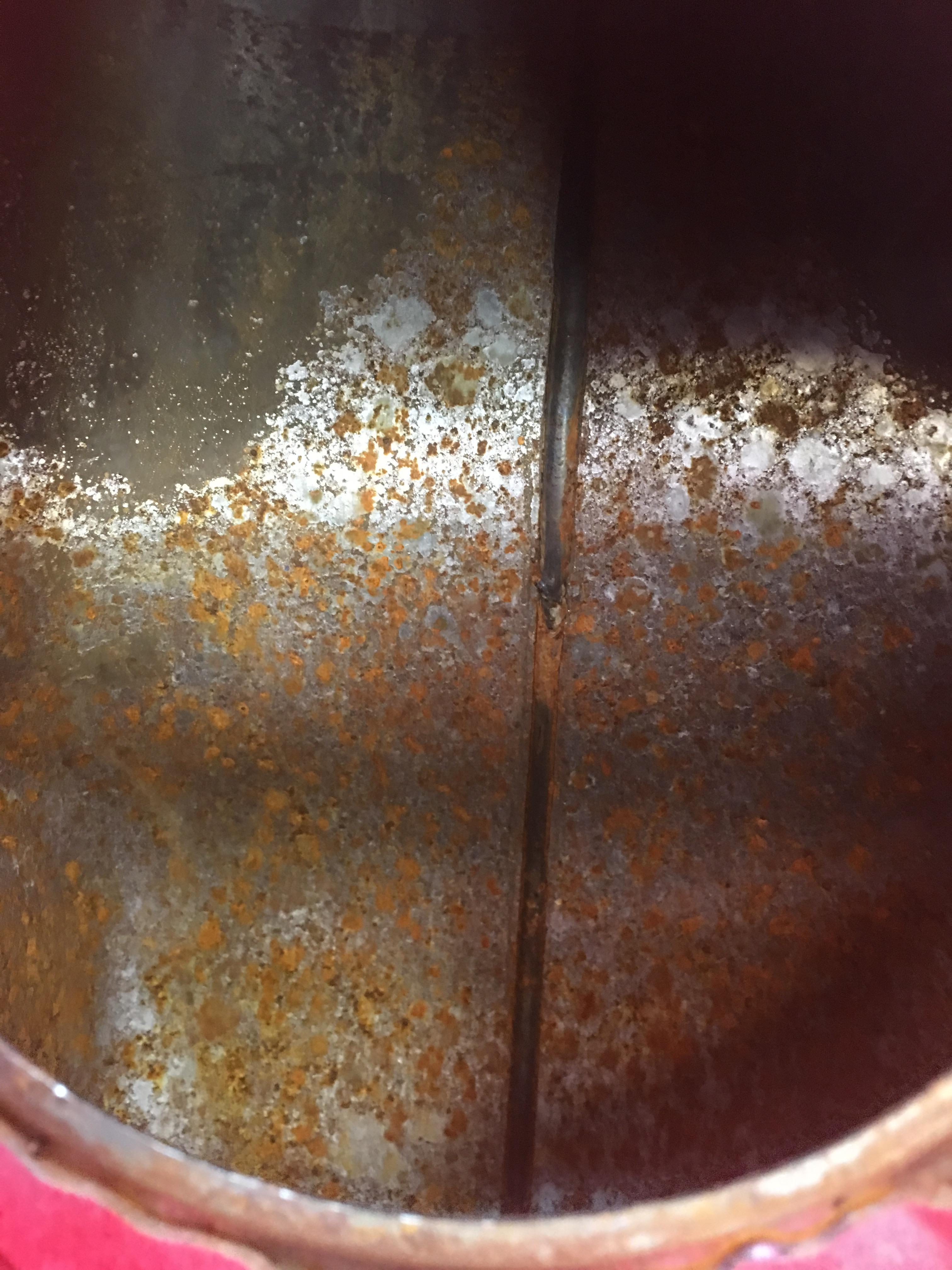

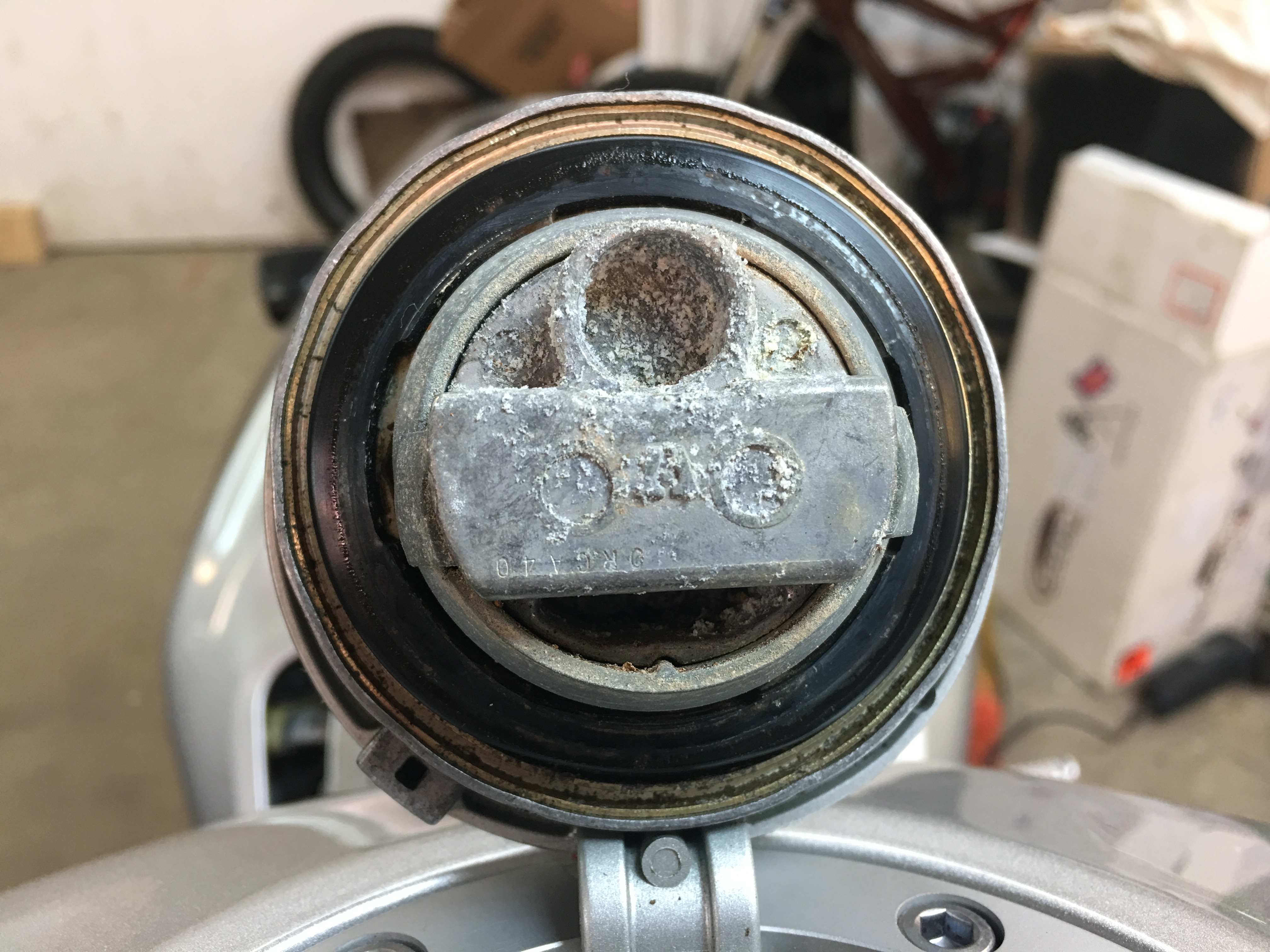

Veefer800Canuck Posted September 6, 2017 Author Share Posted September 6, 2017 Guess what I'm doing now? 1 Quote Link to comment Share on other sites More sharing options...
Member Contributer Lorne Posted September 6, 2017 Member Contributer Share Posted September 6, 2017 Ruh roh, hope everything downstream of the tank is ok - primarily the injectors. Any thoughts n how the tank got in such a state? Quote Link to comment Share on other sites More sharing options...

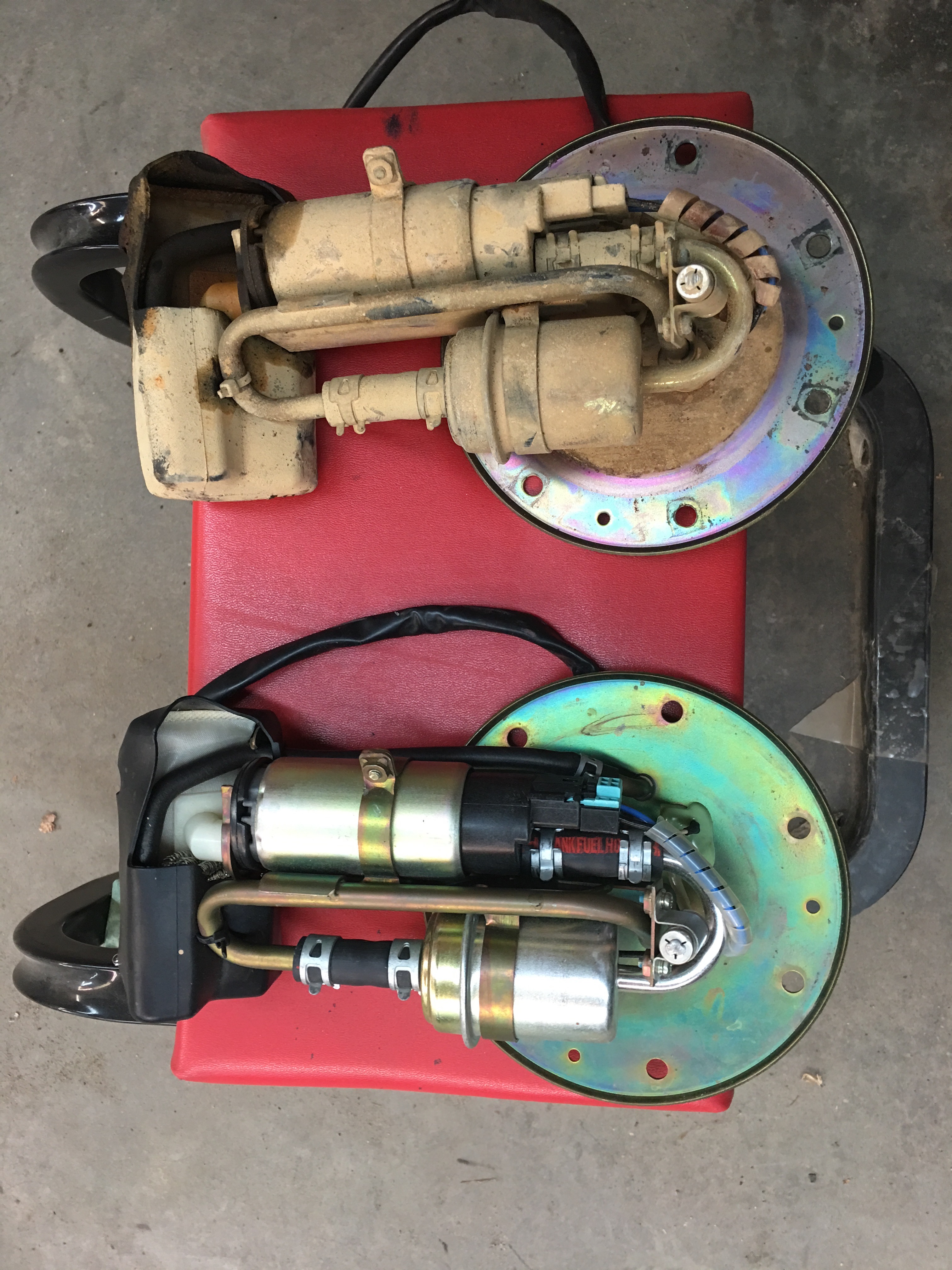

Veefer800Canuck Posted September 7, 2017 Author Share Posted September 7, 2017 20 hours ago, Lorne said: Ruh roh, hope everything downstream of the tank is ok - primarily the injectors. Any thoughts n how the tank got in such a state? 10 years of being parked with ethanol fuel in the tank. The bike ran PERFECTLY before I took the tank off, started immediately, revved perfectly, idles perfectly, etc. I had ridden it home like 10km when I bought it and it pulled like a freight train. I removed rhe FPR and blew out the entire fuel rail and HP supply hose with compressed air. NO RUST came out. None. I also blew the FPR clean, and there was only a speck or two of soft debris in there. OE fuel filter must have worked! Guess which of the two fuel pumps I'm putting back in?? Quote Link to comment Share on other sites More sharing options...

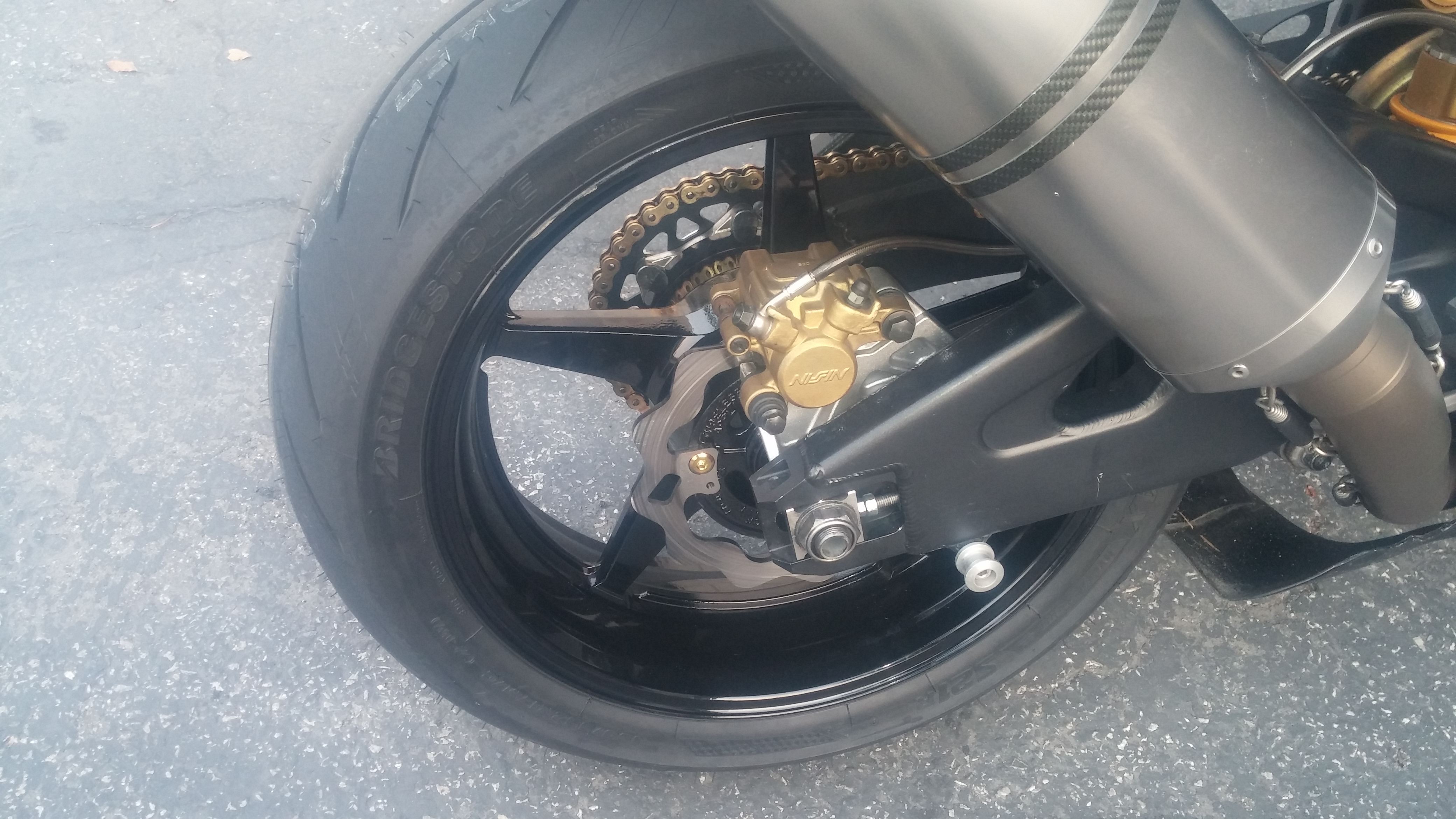

Member Contributer RC1237V Posted September 7, 2017 Member Contributer Share Posted September 7, 2017 It finally happened! I powdercoated the wheels at work, and they came out nice. All new wheel bearings, seals, brake rotors and tires. I know it's not pristine, but it has all the tasty bits I wanted. Having so much fun riding it, I don't know if I will go back to the clip-ons.............just have a few pieces of bodywork, and new headlights to replace the old. the RC Tuono! Quote Link to comment Share on other sites More sharing options...

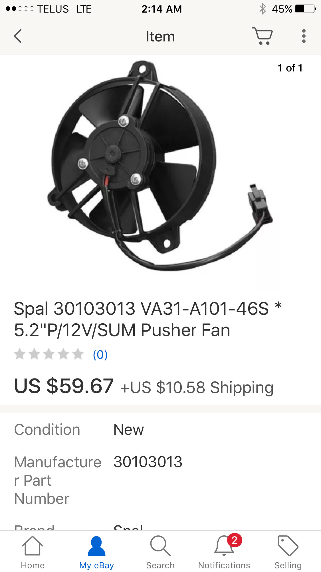

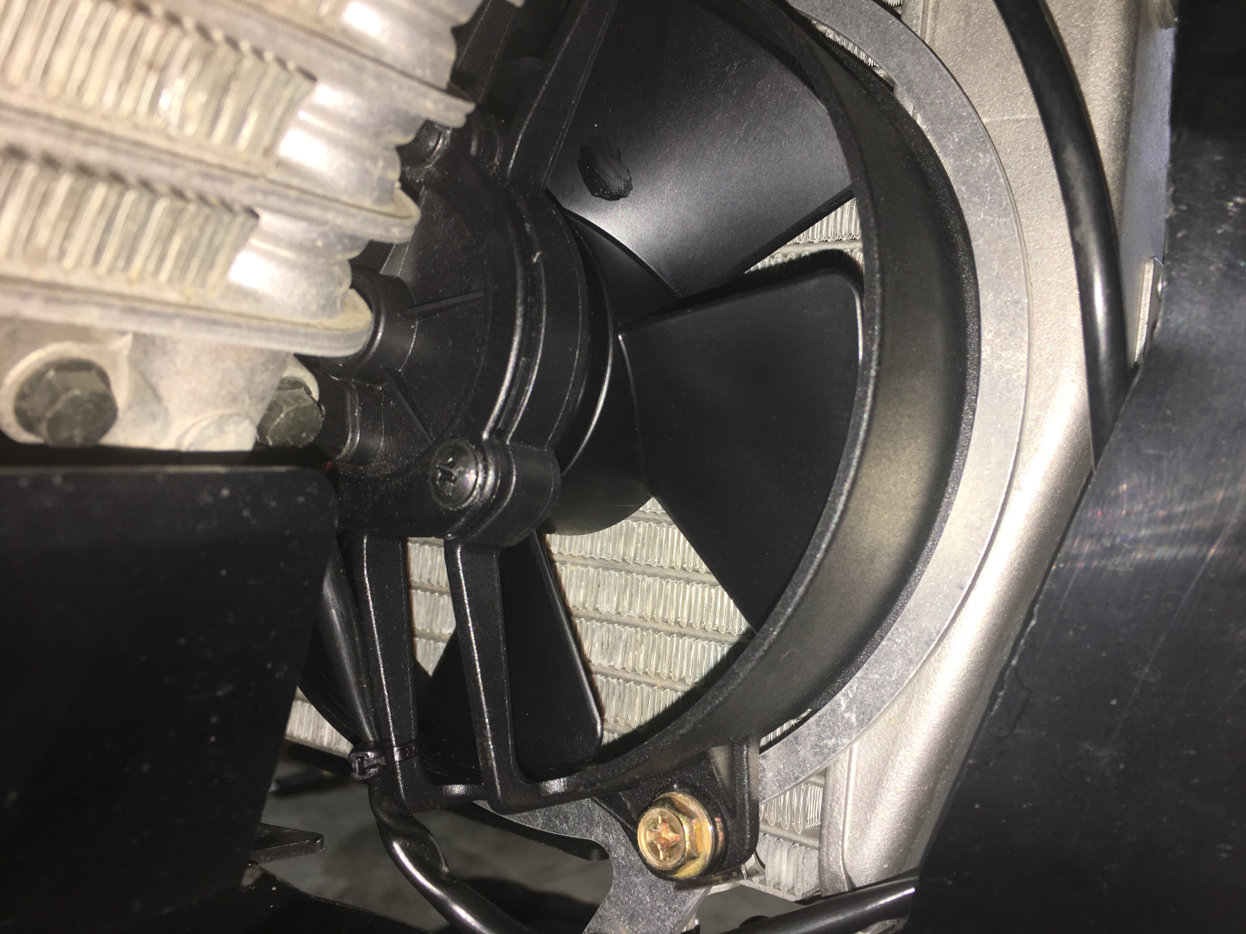

Veefer800Canuck Posted September 15, 2017 Author Share Posted September 15, 2017 SPAL pusher fan mod. Quote Link to comment Share on other sites More sharing options...
Member Contributer Marooncobra Posted September 15, 2017 Member Contributer Share Posted September 15, 2017 Veefer800Canuck What SPAL fan model number did you use and does it cover the same area as the oem fan? I tried to fit a SPAL fan on the right hand radiator but struggled to get it to fit due to the thickness of the fan motor. I can see from the photo that you have made an alumium frame to mount it? Nice work. Quote Link to comment Share on other sites More sharing options...
Veefer800Canuck Posted September 16, 2017 Author Share Posted September 16, 2017 23 hours ago, Marooncobra said: Veefer800Canuck What SPAL fan model number did you use and does it cover the same area as the oem fan? I tried to fit a SPAL fan on the right hand radiator but struggled to get it to fit due to the thickness of the fan motor. I can see from the photo that you have made an alumium frame to mount it? Nice work. The mounting bracket was made by a fellow RC51 owner who did a limited run of them. The fan slightly covers the end tank of the rad, but not much. It had to, to clear the frame spar. Quote Link to comment Share on other sites More sharing options...

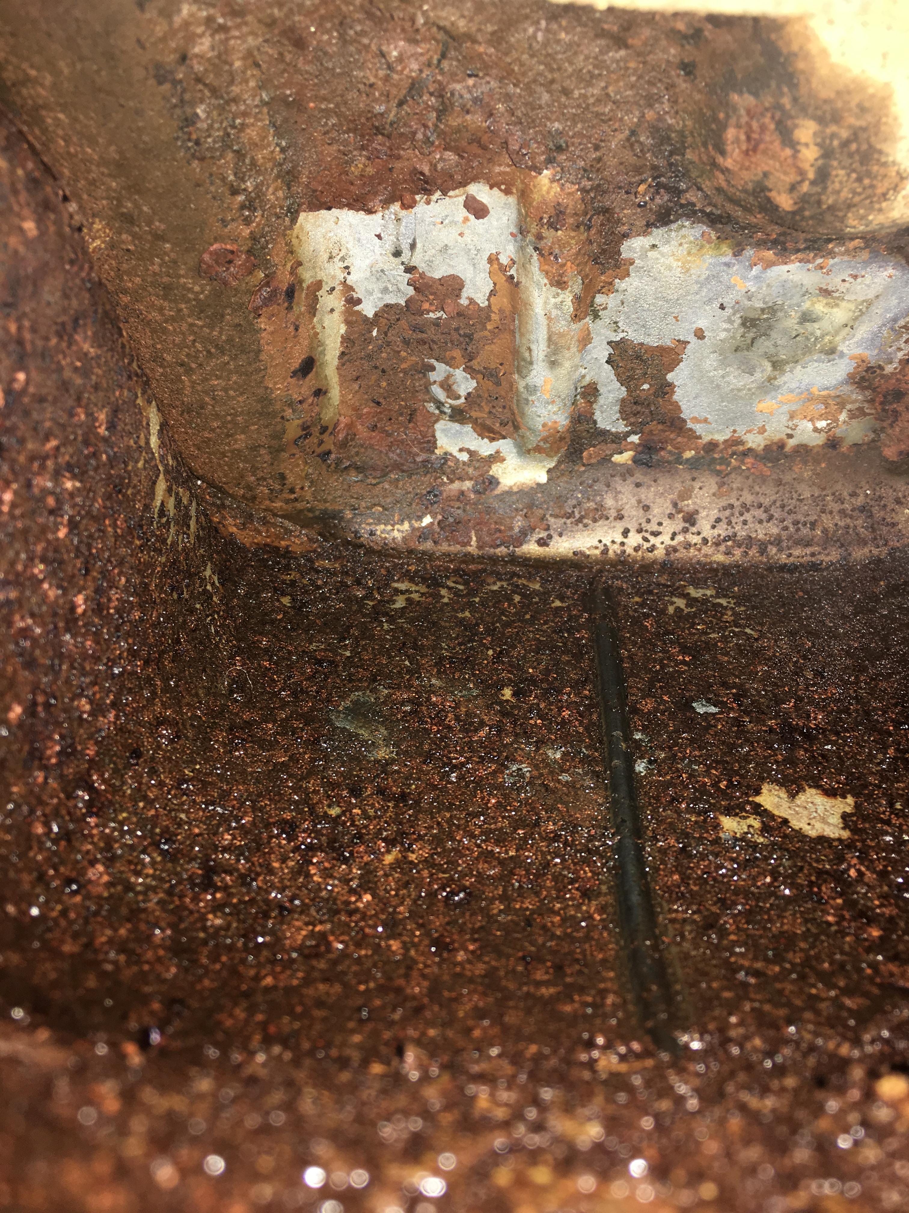

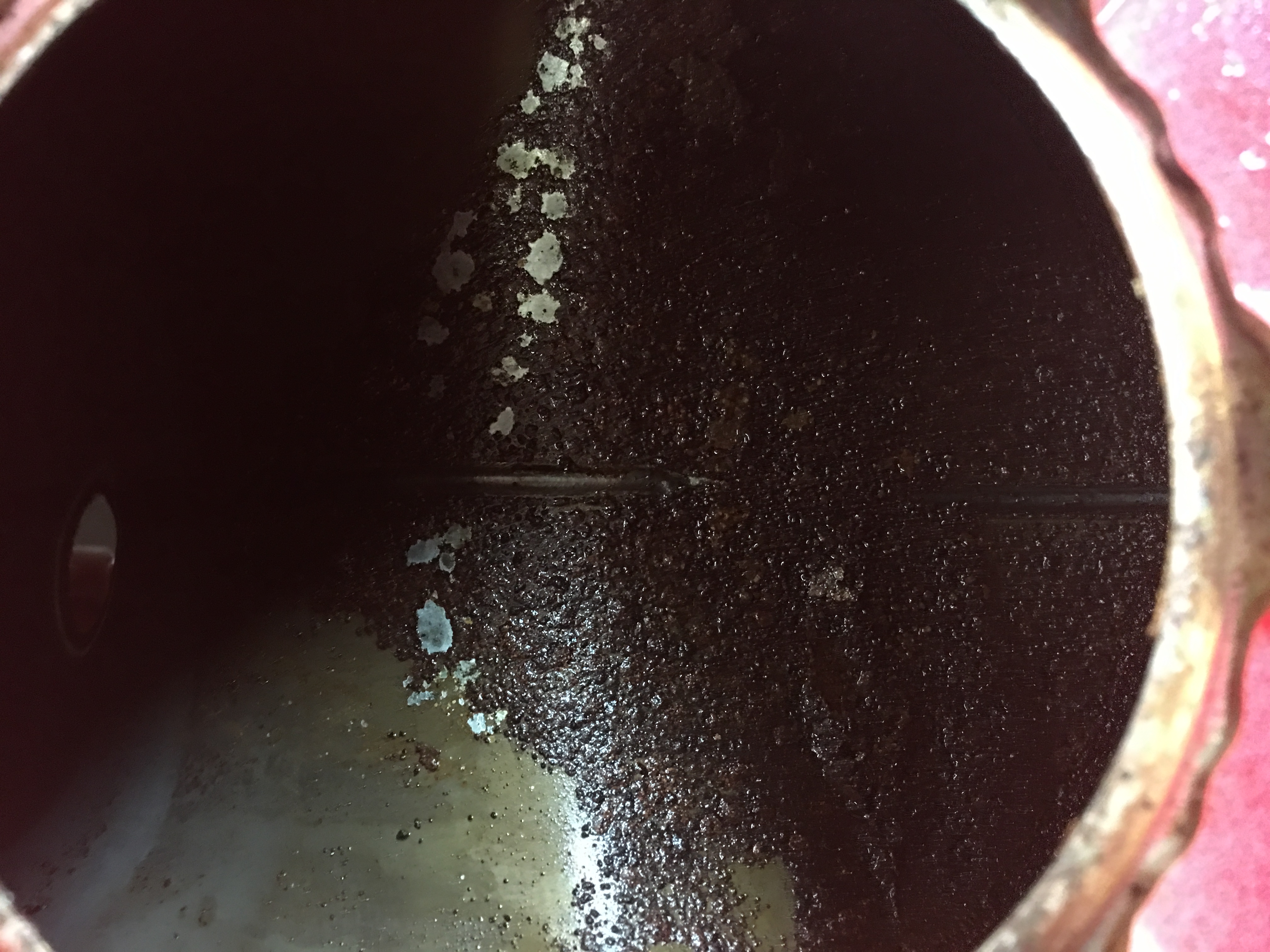

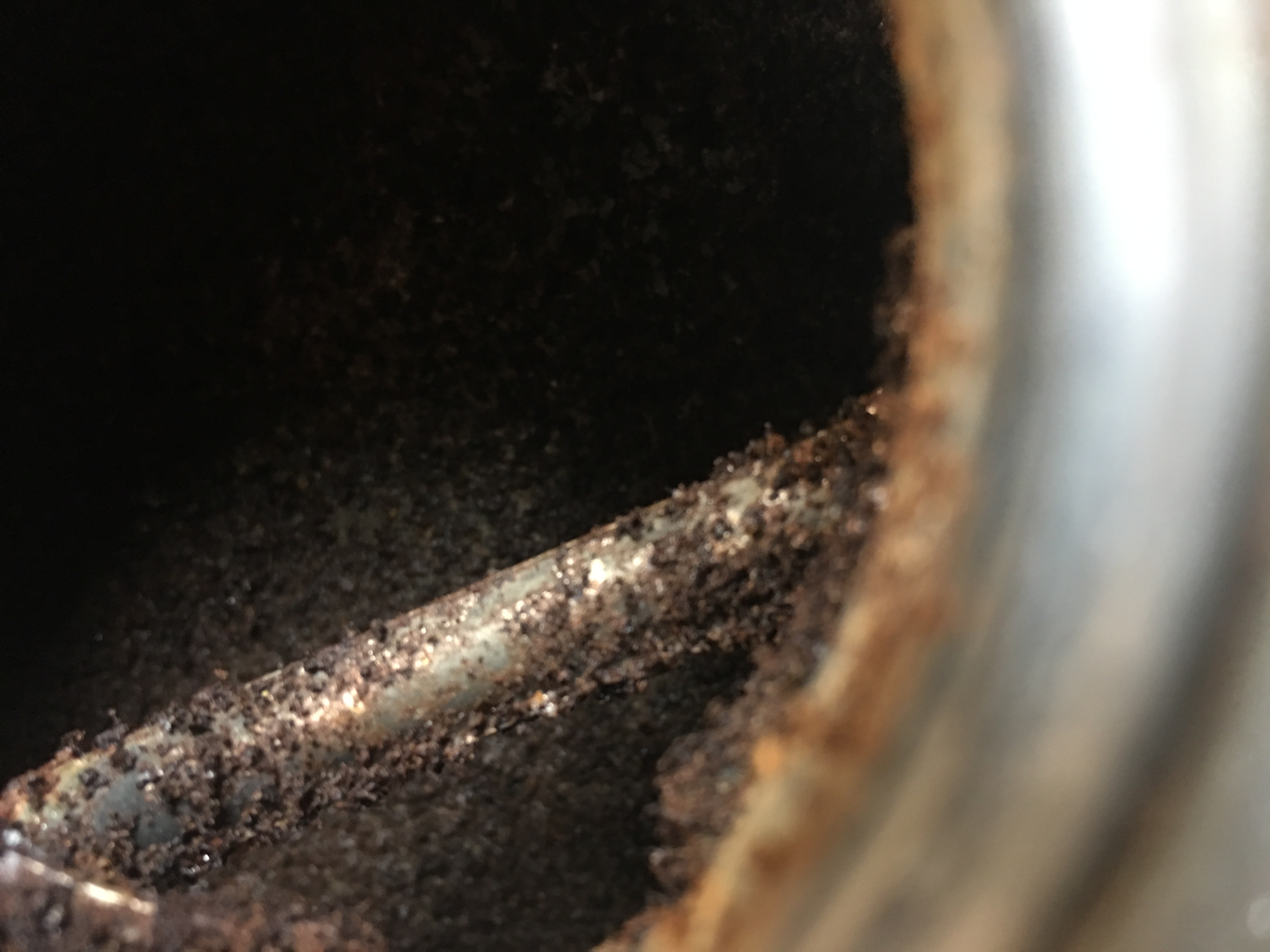

Veefer800Canuck Posted September 26, 2017 Author Share Posted September 26, 2017 Managed to blast the fuel tank innards at the car wash to get most of the loose rusty scale out. Bemoeve it or not, the pic is an improvement over what was before!!! Dried it and now trying to find time to do the tank cleaning and coating kit. Hurt my right arm a bit loading furniture, so it might be a bit before I can tackle the tank. Quote Link to comment Share on other sites More sharing options...
