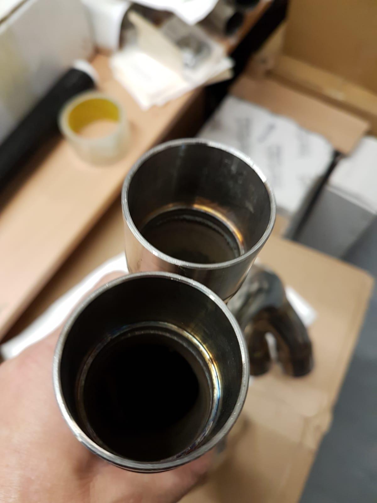

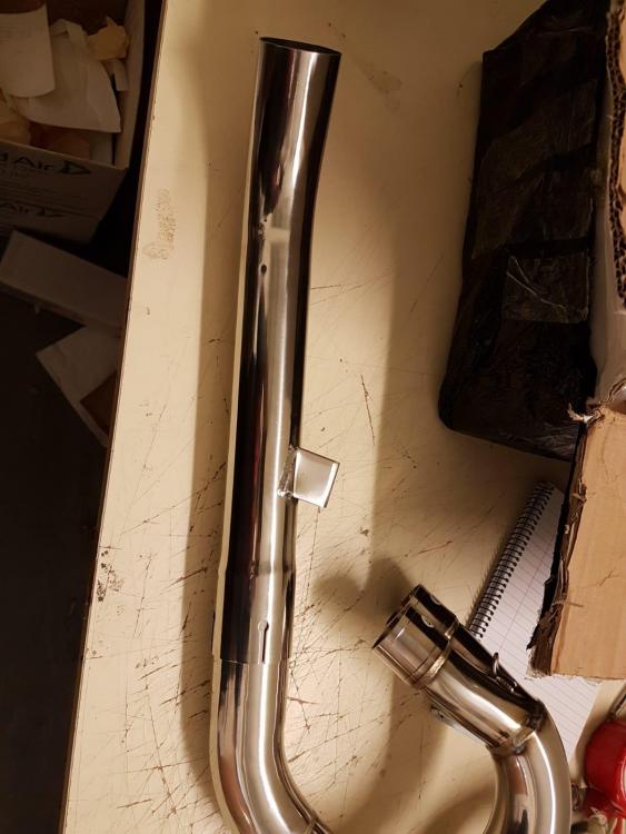

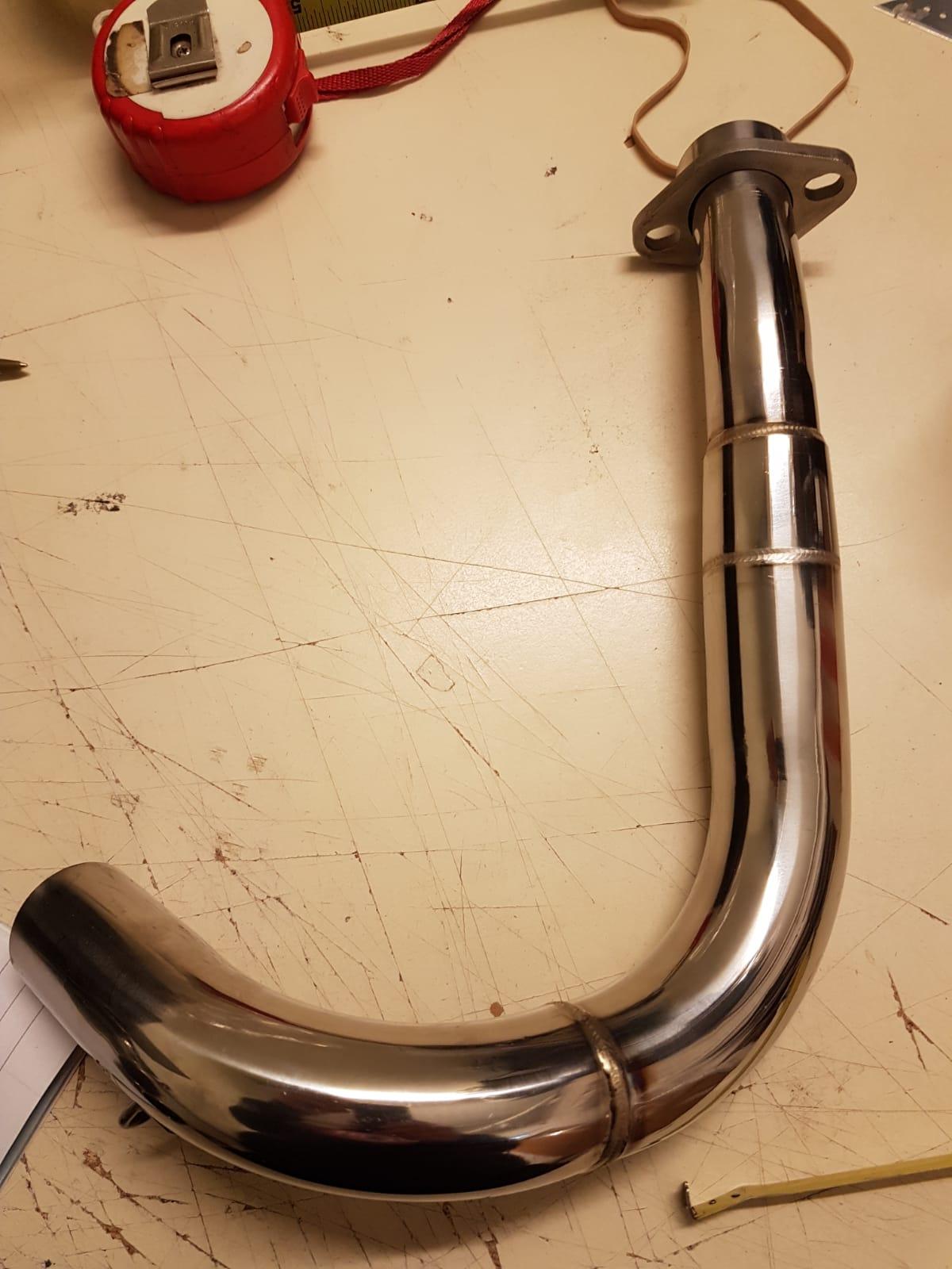

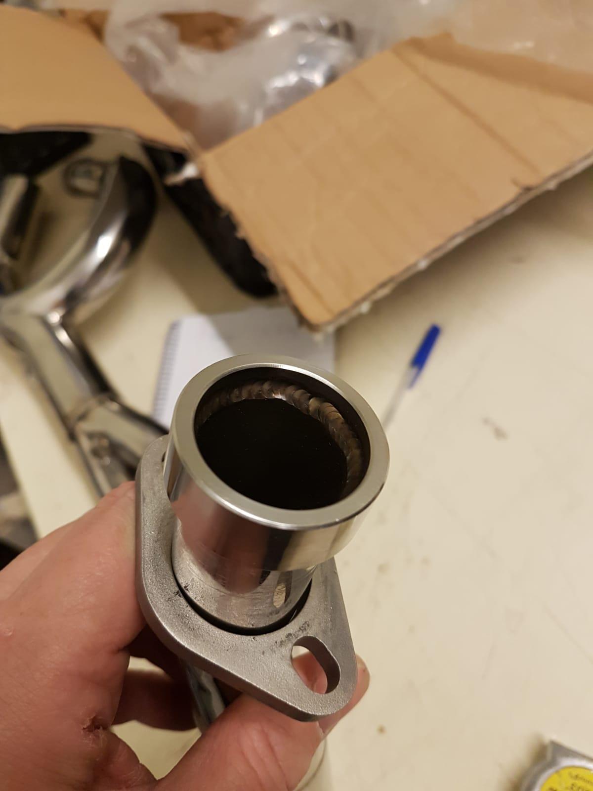

Member Contributer Stray Posted November 9, 2018 Member Contributer Posted November 9, 2018 SURPRISE NEW DEVELOPMENT ON LEXTEK HEADER TEST: Jeff has gone and bought himself a 2000 5th gen!!!! Here is Bike he bought: https://www.facebook.com/marketplace/item/277093886239865/ This means dyno testing will happen imminently - hurray! Jeff was also gracious enough to answer our questions in detail and with photos. System weight is 5.7kg with link pipe (no muffler). Internal weld quality is great - see those nice fillets... Downpipes internal diameter starts at 32mm and goes up to 38mm. Exit tube is 50.8mm - same as standard I believe? He is happy to post overseas: box size is 58cm x 32cm x 15cm for calculating costs. He is happy to ship batches in one go to save costs but you will have to add another 15cm (height) for every extra system. So three systems would measure 58 x 32 x 45cm (3 times 15cm). Box weighs 5.7kg as stated above. Jeff will do a generous discount on first 25 orders. Thereafter the same deal in batches of 5. Please PM for price (Jeff doesn’t want to publish it here). If anyone wants a full system (with brackets, gaskets and muffler) please look on the Lextek website and let Jeff know what you’d like - he will apply this same discount to the entire system. He prefers payment by BACS (direct bank transfer) as margins will be very small on this offer and he doesn’t want to incur PayPal/CC fees. Jeff will also ask Lextek to make adaptations for 8th gen front tubes and (if necessary) 6th gen rear tubes once his initial stockholding is exhausted and they need to produce more. Currently there are 45 systems in stock. Jeff has very graciously agreed to dyno his new bike with both the OE system and Lextek header. He will use a Lextek muffler on both runs. Results should be in by end of next week. Big apology to BiKenG who will miss out on a free header. Sorry it turned out this way for you, mate. On the other hand it means we have a fellow VFR800 owner, who is an excellent exhaust builder, setting up a dyno test and cheap group-buy deal for us. He bought a bike just to service our needs - that’s pretty hard to beat, I think you’ll agree! Jeff may join our forum shortly as Kawaman (long time Kawasaki fan) and answer questions directly himself. Mods, please fast track his application if you see it! Best, Stray Quote
