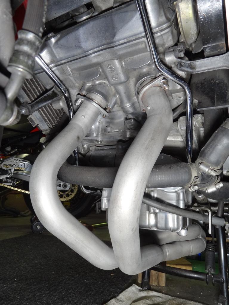

RVFR Posted May 4, 2018 Author Posted May 4, 2018 Just a note in what I know, is the 98-99 header fits 6th gen, and since as noted the Two bros header fits the 6th even though it was made for a 5th. only thing here I ran into as I started all this using my 5th gen, then was lucky enough to land a Two bros, prior it was all speculative. Back to the performance side of things on the 5th gen it's been figured out there is around a 5-8hp gain with a PC3 and a dyno tune involved, Not so sure on what is what with out those, other than my stock base run was 108, with KN air filter and stainetune, it was also 45 degrees in Feb, and used chevron premium, I was heading to get the best no matter what, so it made sense to get it dialed in. But there's a bigger part to this than numbers, the way the VFR now runs is as SF said " Harmonized" pulls smooth from just about any rpm plus pulls to a full 12K plus with no hesitation. It's hard to put in words, but just transformed the VFR totally so there's really not much in question if it's for a 5th gen. Now the 6th gen, that's different you have 02s and a different engine VTEC 😉 then add in the exhaust outlet deal, I don't have a 6th gen to monkey with or this wouldn't be a question, but if it's any where near what the layout of the two bros gives the 5th gen, then yea its good. BUT $1000 Good? Now as far as the header flange goes, IMO since I haven't looked at a GSXR gasket, the tubing used is thin wall 36mm, the port casting on the 5th gen is like 36.5mm The Two bros header just barely slipped in, I had the factory copper donuts, what happen is they are made for 32mm tubes, hence what happen here was they where sucked into the center of the 36mm tube, LOL that won't work, So I made new ones out of soft brass that are a flat washer type, so far with 1500+ miles with this set up, no issues. But thats another process to figure out for the 6th gen. Any who, thought I'd share. Quote
RVFR Posted May 4, 2018 Author Posted May 4, 2018 Photo of said 2 bro header in place just in case folks haven't or would like to see. Quote
Member Contributer Duc2V4 Posted May 4, 2018 Member Contributer Posted May 4, 2018 I can take measurements of an 01 and an 09 this weekend of at least the front headers. Quote
