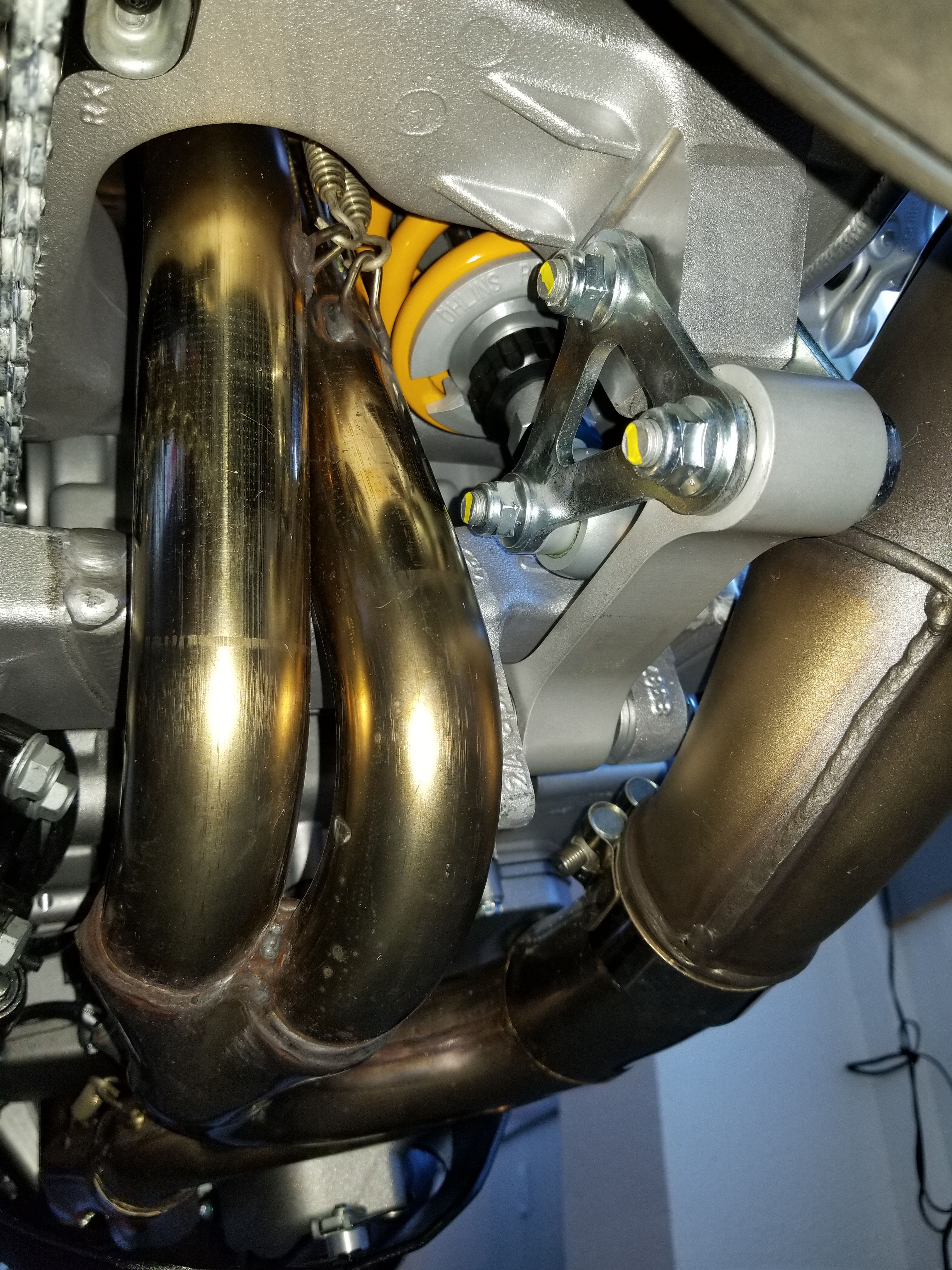

RVFR Posted August 31, 2017 Author Posted August 31, 2017 Ok Moose, you got me there, are you talking with a third 02 ? I'll look into that, thanks.. I think Here's the deal on other use of cans of sorts. I had to make a new mid pipe to hook up thy Staintune, no way I was giving that up. In that process two things, one the center-stand bummer plate. Two, Then the new angle to line up the Stainetune. I had the the 2bros mid pipe that's used on the full system which is used with their end can, which is at the same location as the stock Muffler, so of coarse I used their mid pipe as it also has the spring slip on there as well as the bumper plate. luck had it the Staintune uses the same Diameter tubing, so it was a no hassle to do. That all said, it may come down too what works the best for the masses, vs, may be that piece will need to be made as a special one of coupling of sorts, we'll see. First lets get a header built ;) Quote

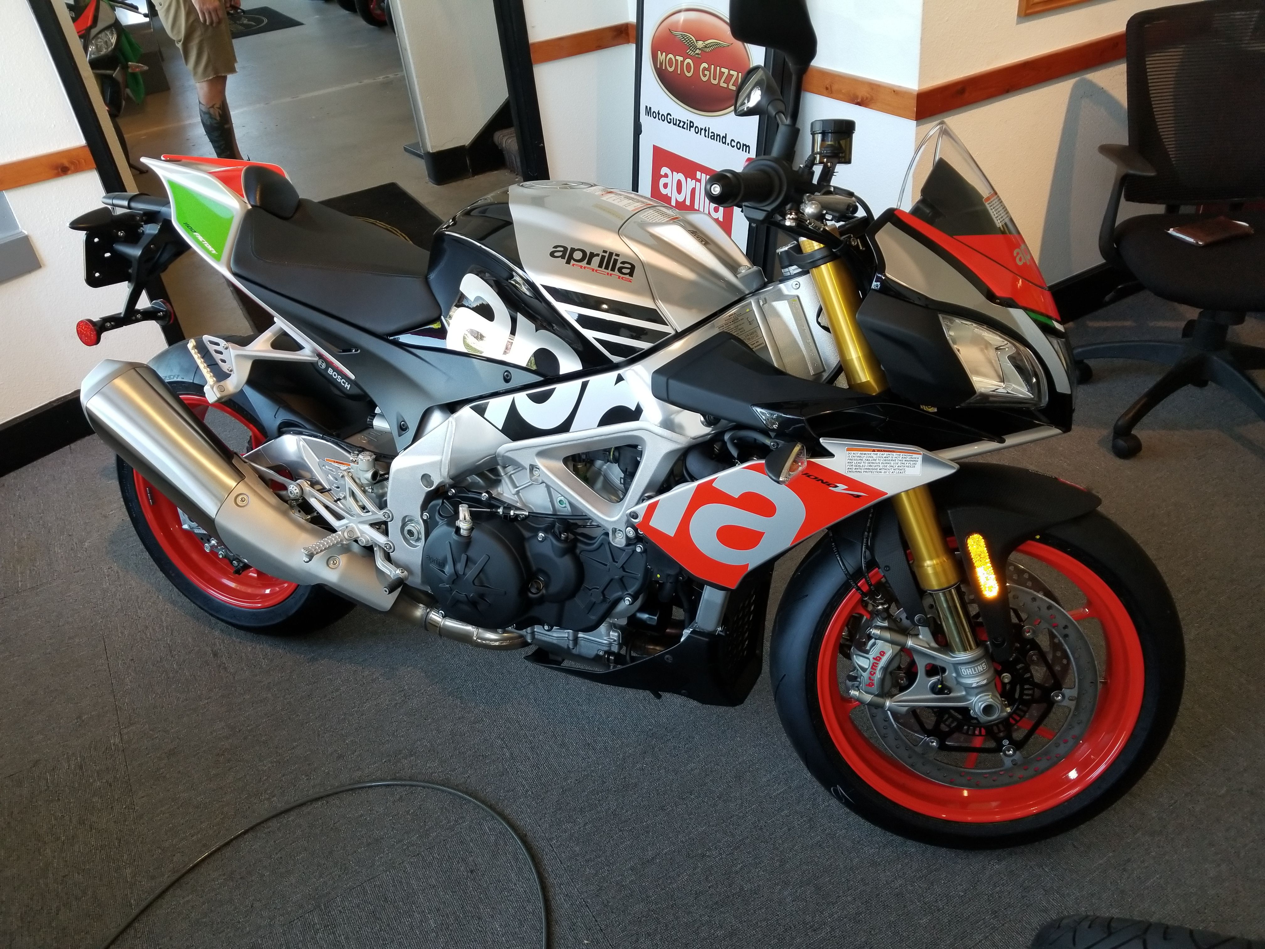

RVFR Posted September 2, 2017 Author Posted September 2, 2017 Yea, the can place fit thing shouldn't be more than just something to put into place. I'm now after seeing first hand yesterday how the dudes at Aprillia lay theirs out on the RSV4, Nice, has me re thinking, but theirs use a standard swing arm giving them more or less hassle in alignment where they come down through the swing arm making a nice transition into the maim collector, they also use 2 02s in the primary collector, talk about nice how they blend there in the middle making a nice 180 out. Wish I had that kind of room for options. Oh man is that RSv4 Touno something else.....Oooooooo Quote
