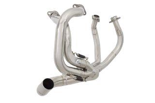

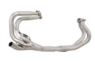

Member Contributer adkfinn Posted December 6, 2018 Member Contributer Posted December 6, 2018 Not to take away momentum from the Lextek/Stray/Jeff header (which sounds great by the way) - but Black Widow just released the pics and pricing and some details on the performance header they've been working on: FB Link - And the order page on their website with pricing and some details (shows as OOS at present): https://www.blackwidowexhausts.co.uk/vfr800f-vfr-800-1998-2003-rc46-exhaust-collector-down-pipes-228-p.asp I don't see where they list diatmeters for the primaries or secondaries, just that they are 304 stainless, 1.5mm wall tube. It is clear that the primaries step up in diameter and appear to use a very factory looking mount/flange. I will email them and ask for tubing specs. Thoughts? Edit - After a bit more looking, these things look very similar to the Lextek headers to me Quote
BiKenG Posted December 6, 2018 Posted December 6, 2018 52 minutes ago, adkfinn said: Not to take away momentum from the Lextek/Stray/Jeff header (which sounds great by the way) - but Black Widow just released the pics and pricing and some details on the performance header they've been working on: ... Edit - After a bit more looking, these things look very similar to the Lextek headers to me Yes, remarkably similar. Coincidence? 🤨 Interesting that they exclude the 6th and 8th Gen. Hmm, they claim suitable for both Carburettor and Injected models. That's a bit worrying. Quote

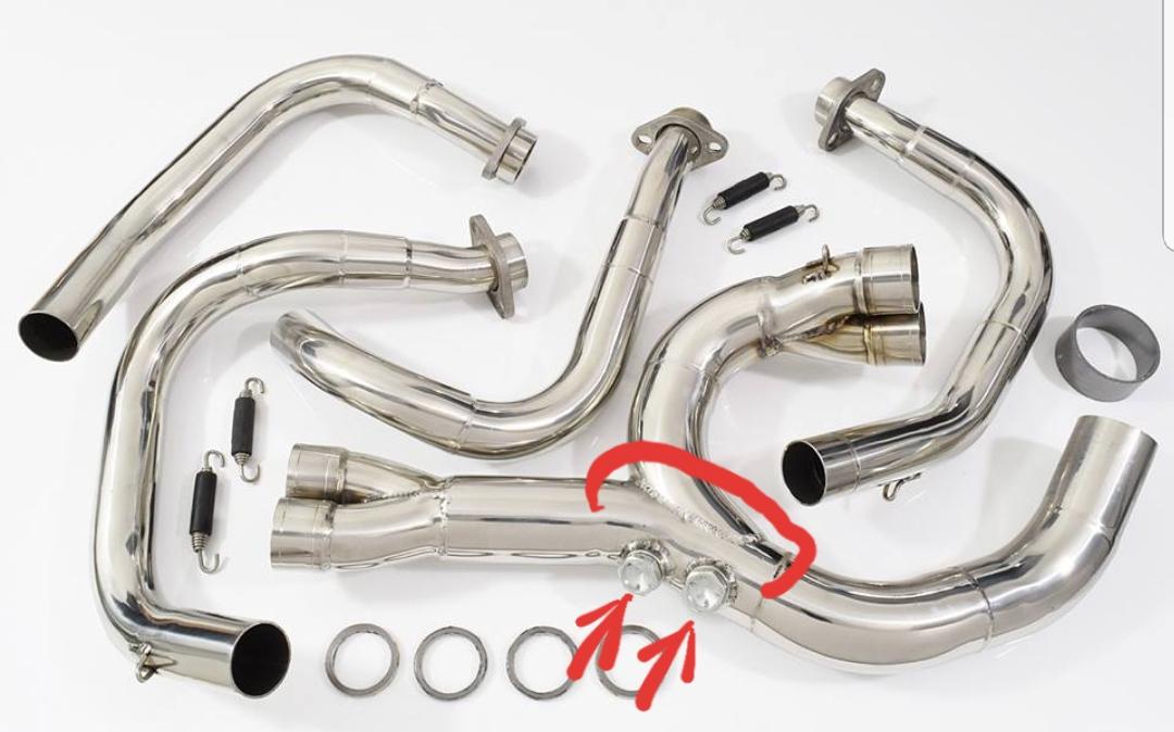

EX-XX Posted December 7, 2018 Posted December 7, 2018 To my untrained (jaundiced) eye, they look press-bent. Probably won't make a huge difference (assuming everything else stacks up). just an observation... Quote
SEBSPEED Posted December 7, 2018 Posted December 7, 2018 I would not buy this system before receiving visual evidence of the fab work on the joint indicated here. At the price point I can't see these being fitted very well, and it wasn't that long ago that the Sandy Bike Spares headers were found to have a huge issue in this area. It appears removal of the O2 sensor block offs would allow inspection of the workmanship in the joint. Quote

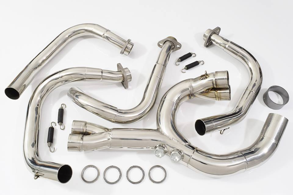

Member Contributer boOZZIE Posted December 7, 2018 Member Contributer Posted December 7, 2018 More pics of the same system Quote
Member Contributer boOZZIE Posted December 7, 2018 Member Contributer Posted December 7, 2018 14 hours ago, adkfinn said: Not to take away momentum from the Lextek/Stray/Jeff header (which sounds great by the way) - but Black Widow just released the pics and pricing and some details on the performance header they've been working on: FB Link - And the order page on their website with pricing and some details (shows as OOS at present): https://www.blackwidowexhausts.co.uk/vfr800f-vfr-800-1998-2003-rc46-exhaust-collector-down-pipes-228-p.asp I don't see where they list diatmeters for the primaries or secondaries, just that they are 304 stainless, 1.5mm wall tube. It is clear that the primaries step up in diameter and appear to use a very factory looking mount/flange. I will email them and ask for tubing specs. Thoughts? Edit - After a bit more looking, these things look very similar to the Lextek headers to me With regards to what Seb said, see if they can get a clear picture through the o2 holes and at the flange so we can see what those welds are like Quote
Member Contributer VFROZ Posted December 7, 2018 Member Contributer Posted December 7, 2018 And where 1/3 and 2/4 join as well. The original Sandy Spares was atrocious, with a tiny hole where the joints were that looked like was cut with an oxy torch. Quote
