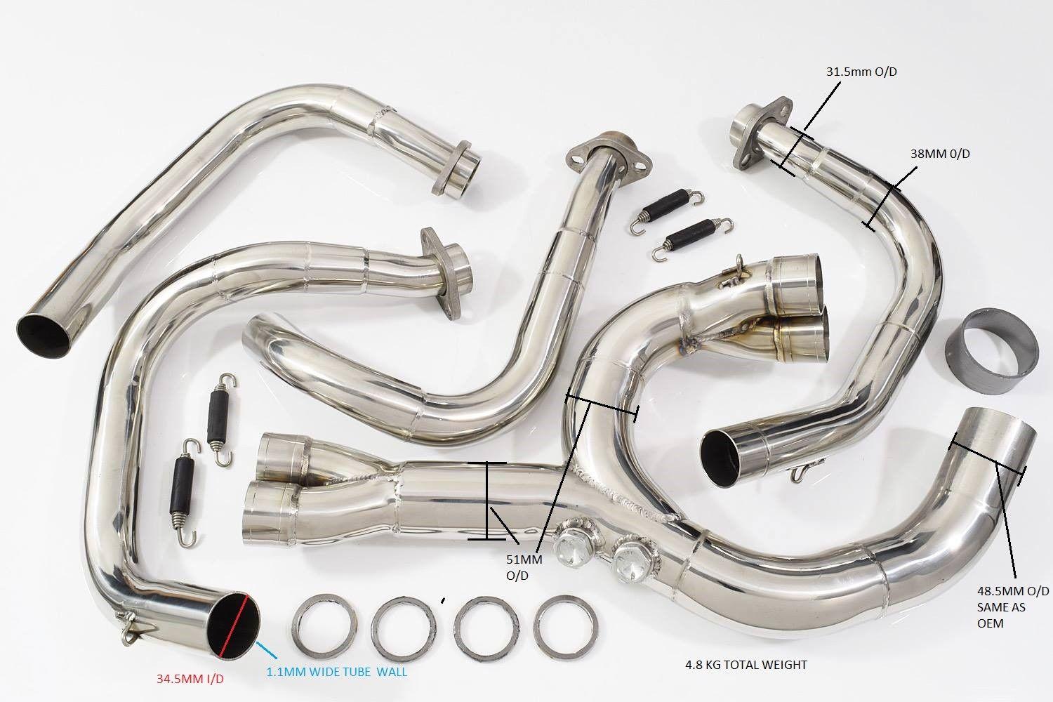

Voided76 Posted December 17, 2018 Posted December 17, 2018 *cracks knuckles* Here. we. go.https://www.blackwidowexhausts.co.uk/vfr800f-vfr-800-1998-2003-rc46-exhaust-collector-down-pipes-228-p.asp "An all new design concept from the Black Widow Performance Department." Meanwhile after a BW rep send me the specs as measured...... that's a 29mm ID primary at the port boys. 1 Quote
Voided76 Posted December 17, 2018 Posted December 17, 2018 while I believe that it does neck up to 36mm, is 29mm a match for the cyl head or is someone smoking crack at BW causing exhaust gas to rapidly slow down after it exits the cyl head? Quote
Member Contributer boOZZIE Posted December 18, 2018 Member Contributer Posted December 18, 2018 3 hours ago, Voided76 said: while I believe that it does neck up to 36mm, is 29mm a match for the cyl head or is someone smoking crack at BW causing exhaust gas to rapidly slow down after it exits the cyl head? it makes no sense, why wouldn't they just use the same 38od for the primary, we know 38 fits at the cylinder head. But I guess we'll just have to wait to see what those dyno figures say Quote

Member Contributer boOZZIE Posted December 19, 2018 Member Contributer Posted December 19, 2018 1 hour ago, sfdownhill said: i.d. of the 5th gen exhaust port where it exits the head is 32.45mm id of the sleeve on the outside of the 5th gen head is 41.10mm [Measured closest to the exhaust port] This id represents any header primary's maximum possible od where it meets the 5th gen head. This sleeve is part of the head casting. It is narrowest at the exhaust port and widens to maximum id at the end of the sleeve, away from the port. id of the same sleeve at its widest point is 42.43mm [Measured furthest from exhaust port] It's a guess about the widening of the Lextek/BW primaries a few inches away from the head, but in theory, the velocity of a gas moving in a tube decreases when it encounters an increase in tubing diameter. It appears the Lextek/BW header keeps the primary diameter smaller from the port several inches down the primary, probably to keep gas velocity higher before widening the primary diameter. Higher velocity through and past the exhaust port increases scavenging of exhaust gases from the cylinder. So that's a step at the exhaust port 32.45 down to 29.3 to the exhausts? Quote

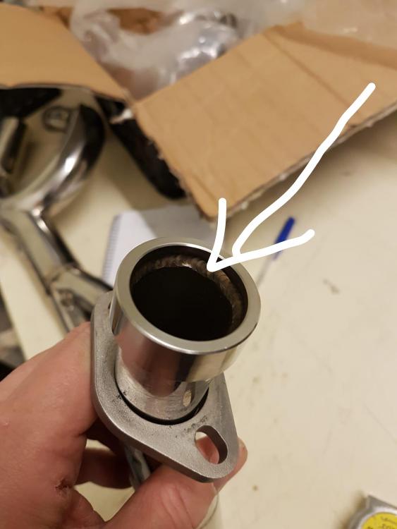

Member Contributer sfdownhill Posted December 19, 2018 Member Contributer Posted December 19, 2018 On 11/9/2018 at 5:51 AM, Stray said: Downpipes internal diameter starts at 32mm and goes up to 38mm. Exit tube is 50.8mm - same as standard I believe? In the post above, with photos forwarded to Stray from Jeff of Simmi Performance - distributors of Lextek - it appears someone is holding an actual header in an actual hand upon an actual desk. It's a stretch, but because two different measuring tapes can be glimpsed in these photos, my subjective response is to give Jeff the benefit of the doubt: he has derived a 32mm id at primary inlet point of the Lextek headers. On the other hand, I lean toward directing skepticism in the direction of BW - the company who has put a self-proclaimed 18 months into excruciating R&D on a proprietary header, posted a video of a bike on a dyno, declined to publish any resulting performance data, and sent a photo with a specific measurement of the header's primary inlet od as 31.5mm...somewhere in the neighborhood of 0.95mm smaller than the id of the exhaust port. And let's not forget the other recent hat thrown into the ring - the alibaba supplier. We are simply receiving data from multiple sources about multiple products that appear quite similar. Quote
Member Contributer boOZZIE Posted December 19, 2018 Member Contributer Posted December 19, 2018 "Downpipes id of 32mm at the inlet point" that would then step to 29.3mm at the weld? Is that correct? Quote
Voided76 Posted December 19, 2018 Posted December 19, 2018 honestly though, I was mad, but they're close. chop them at the first weld, and put some 35.5mm ID tubing in there, which is cheap and cheerful, and you're golden. at some point, it's all custom. I am more than likely going to have to contact someone to bend and weld similar front primaries to get it to work on my RC79 (Oh yes I will.) so there's that. at some point there's going to be some silly dyno after I've gotten all the factory power out of the '14 VFR Quote
