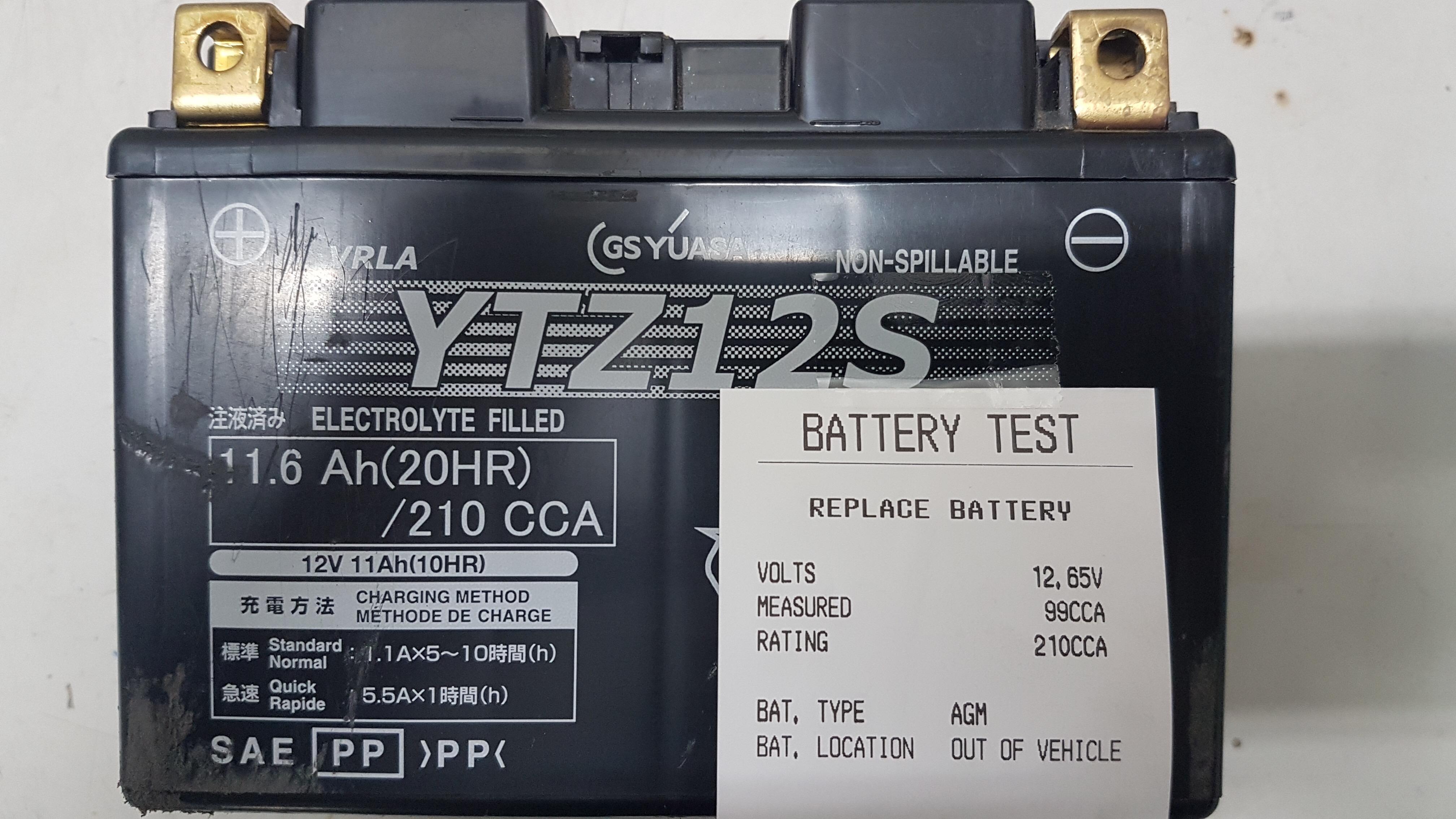

14thumper Posted August 3, 2020 Posted August 3, 2020 Looks like my OEM battery bit the dust. Strange, my tender says it’s ok (I can’t find my meter to verify) but I hit the crank button and everything just shuts off after a loud click and no more electricity. I did try to jump start the bike and it worked but it ran horribly and I think was misfiring so I turned it off after a few min. Anyway, the OEM battery is $140 but I see batteries like Mighty Max brand with similar CCA for about $35, much less. Has anyone tried those? If I need to go with Yuasa or OEM fine, but if these cheaper batteries work decent then I prefer to save a little $. Thanks Quote

Member Contributer ducnut Posted August 3, 2020 Member Contributer Posted August 3, 2020 A battery can make voltage, which triggers a maintenance charger to indicate the battery is fully charged. However, the battery won’t make amperage, which is indicated by the starter motor’s inability to spin the engine. The battery is shot. Anytime a battery is discharging, it is sulfating. Sulfation ruins batteries, which is why one that’s left unused goes bad. It’s imperative a battery is regularly used and/or on a maintenance charger. I’ve managed to get 12yrs out of Yuasa in my SV, via diligent use of a maintenance charger. I know they work and usually have five of them going at all times. It’s crucial to properly prep a battery, before putting it into service. If one pulls it out of the box, squeezes the acid pack into it, slams the cap on, installs it, and sets about using it, the battery’s life can be measured in months. The best way to prep a battery is to insert the acid pack into the top of the battery and leave it sit for several hours (overnight is best—this applies to wet-acid batteries, too). This allows the matting/plates to fully absorb the acid and disperse any air bubbles. Then, put the battery on a maintenance charger, until fully charged. This slow-rate of charge allows for the most complete prep charging of the battery (slower is always better). Anytime the vehicle is parked, put it on a maintenance charger. If one follows these steps, they will get the longest possible life from their new battery. Talking to people in the battery industry, they say all the world’s batteries come from only a handful of suppliers. I’ve noticed batteries that used to be “proudly made in the USA” are produced offshore, now. Anymore, I’m not so sure it’s worth it to buy Yuasa, Interstate, or other premium brands. If one can control the prep process by doing it as described above, the easiest warranty and replacement avenue is going to be from a box store or chain auto parts store, because they’re everywhere. *I’ve been through a factory-provided, Yuasa training course on battery prep and maintenance.* 4 Quote

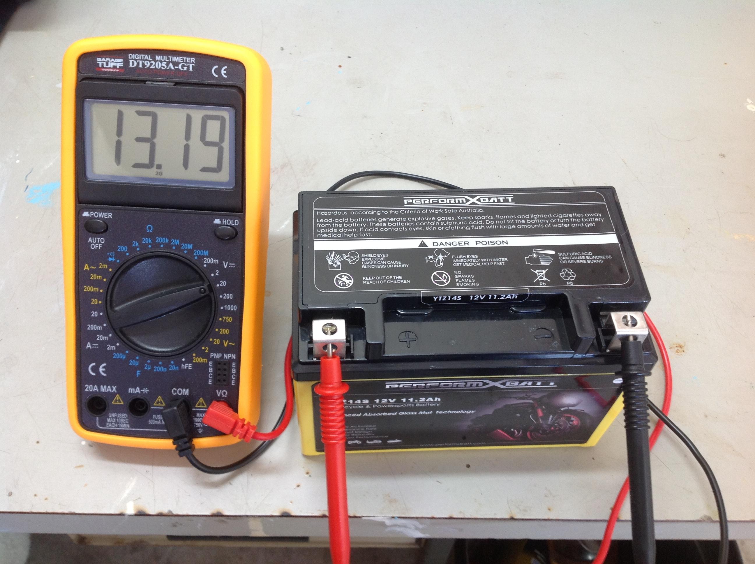

squirrelman Posted August 3, 2020 Posted August 3, 2020 doesn't make sense to replace a battery without checking the charging system output at the same time. a weak charging system may have killed the battery and will do the same to a new one. i always scratch the installation date somewhere on any new battery. Quote
Member Contributer Grum Posted August 4, 2020 Member Contributer Posted August 4, 2020 Agree with squirrelman, you really should verify your charging voltage, before assuming your battery is at fault. However the 8gen has a very good R/R and puts out a fairly constant 14.5 odd volts. A 2sec check with a multimeter can confirm this. A recent failure of my OEM Yuasa YTZ12S after 6 years showed a battery that appeared to charge well, however, when it's capacity CCA was checked it was only 99CCA when it's rated at 210CCA. Battery Voltage is not a good indicator of battery capacity - it's ability to deliver plenty of cranking amps. Replaced it with a cheapy YTZ14S equivalent which so far is working fine, See attached, the new battery prior to install, and the Failure report on the OEM. Cheers. 2 Quote
