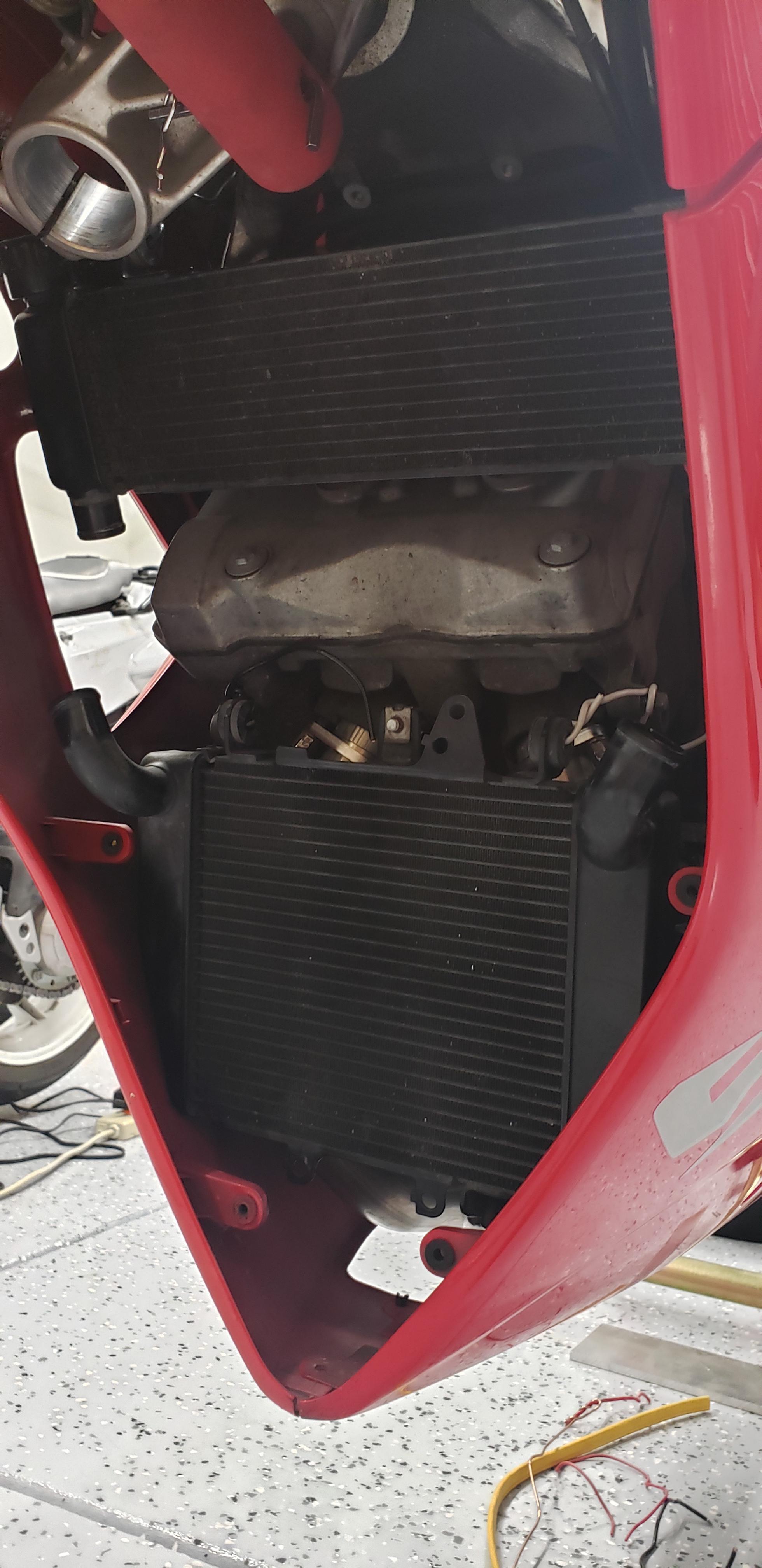

Member Contributer HighSideNZ Posted June 21, 2020 Member Contributer Posted June 21, 2020 On 6/6/2020 at 4:53 PM, vfrcapn said: Looks like the 8th gen rads and fan will just fit with the 8g header and 5g fairings, may need to keep the 5g oil cooler though. That's exactly what I found with my 6th gen and the 8th gen rads. 2 Quote
Member Contributer vfrcapn Posted June 21, 2020 Member Contributer Posted June 21, 2020 2 minutes ago, HighSideNZ said: That's exactly what I found with my 6th gen and the 8th gen rads. What do you think of a side mounted oil cooler? Could there be enough air flow? Or maybe a thermo controlled fan behind it? Quote
Member Contributer HighSideNZ Posted June 23, 2020 Member Contributer Posted June 23, 2020 Seeing that the 5th Gen only has a 2 row oil cooler I doubt that side mounting one would have any real detriment. I'd be looking at using a higher row count cooler myself and wouldn't worry about a fan. You may need to shroud the cooler to stop the air bypassing it. Quote
