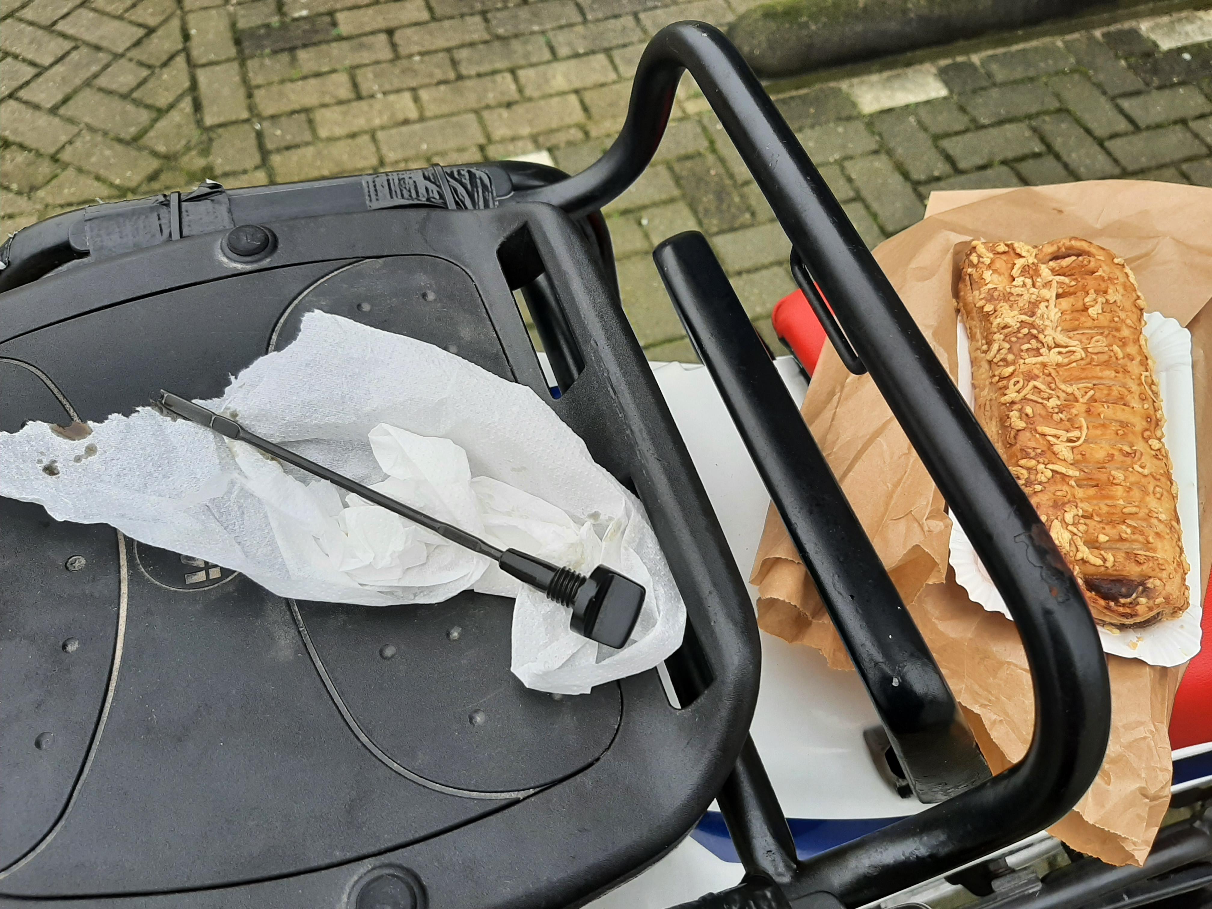

Member Contributer Dutchy Posted January 14, 2022 Member Contributer Posted January 14, 2022 Checked the oil level... 1 Quote
Member Contributer Philois1984 Posted January 14, 2022 Member Contributer Posted January 14, 2022 Here in Oz we rate jobs by how many six packs (beer) you need to complete the task, looks like in the Netherlands they use the sausage roll rating 😂 2 3 Quote

Member Contributer Dutchy Posted January 15, 2022 Member Contributer Posted January 15, 2022 13 hours ago, Philois1984 said: Here in Oz we rate jobs by how many six packs (beer) you need to complete the task, looks like in the Netherlands they use the sausage roll rating 😂 Oil checking is measured in cheese rolls....... 🙂 Cycling on saturday morning between 6-8AM is measured in sausage rolls... T'was kinda kinda foggy this morning.. 3 Quote
