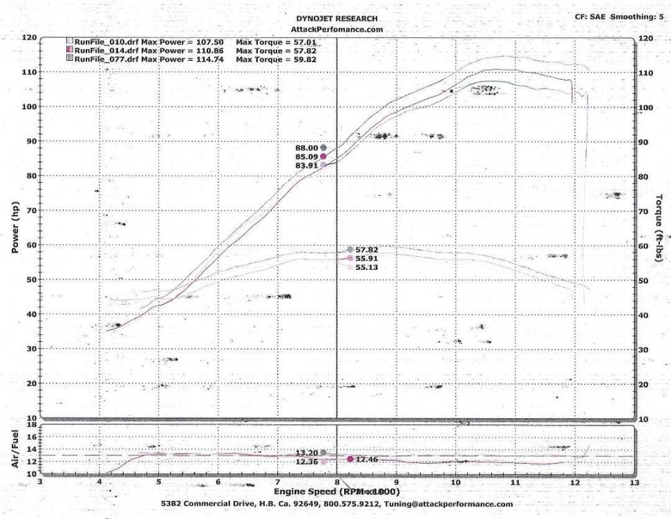

Voided76 Posted February 12, 2019 Posted February 12, 2019 Case in point. This is the '14 VFR with a Delk header. Stock muffler. picks up great in the midrange, and then the complete shit merges and collector design causes it to LOSE high rpm horsepower to even the stock header and it's T junction merges, if that tells you anything. I'd have no issues recommending a delk header except: it causes the VFR to completely fall on it's face after 9 grand. it's why I roll my eyes at delk headers, it's why I'm actually very very angry about the BW/Ali/Lextek headers. they're so close to nailing every aspect that it would've been likely cheaper, to run the 36-38mm ID primary the whole way. and make more power. but they didn't. It comes out of the header with the same squashed down ID as the stock '14 VFR, which you see here get LEFT in the midrange by even 98 spec primaries. Because that's what delk is running here, 32mm ID vs 30-29mm for the vtec era. They left (lots of) horsepower on the table. for what, so you could use the stock exhaust gaskets? So they could save 10-20 dollars a header instead of doing a decent set of merges and slip joints? lmfao goddamn these companies. Quote

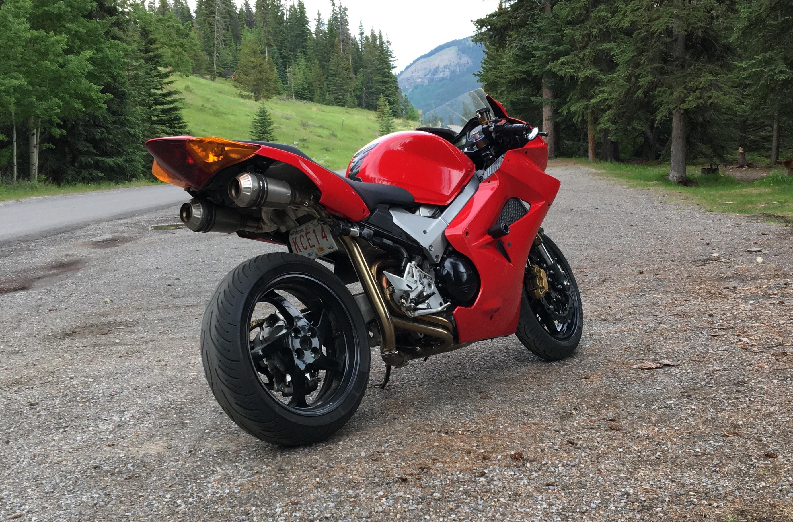

PetoRC Posted September 20, 2019 Posted September 20, 2019 Tyga yes !!! Right side dump that will work with undertail exhaust for 6gen please and perhaps a true dual under-tail exhaust with proper splitter or dual piping 🤤. Here is a picture of my Make shift Panigali undertail exhaust. Quote
