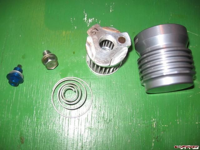

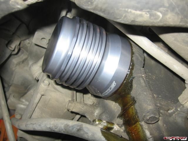

Auspanglish Posted July 19, 2017 Posted July 19, 2017 I have been using my reusable scotts for a few years now myself, and I get a jug of oil at wally world - mobile one 10w40. My buddy Mark did a lot of research on viscosity ratings and such and he spends the 8 bucks a quart on mobile one mtx 4stroke motorcycle oil - me I think its wasting money however I change my oil every 3k unless I am on a 5k trip or somthing where changing oil is unfeasable. I used one identical to HS's by PC FLO. Someone else on here also uses it as does a colleague of mine in Spain. 100s of 1000s of Km with no issues. http://www.vfrdiscussion.com/index.php?/forums/topic/73708-reusable-oil-filter/#comment-871719 Quote
