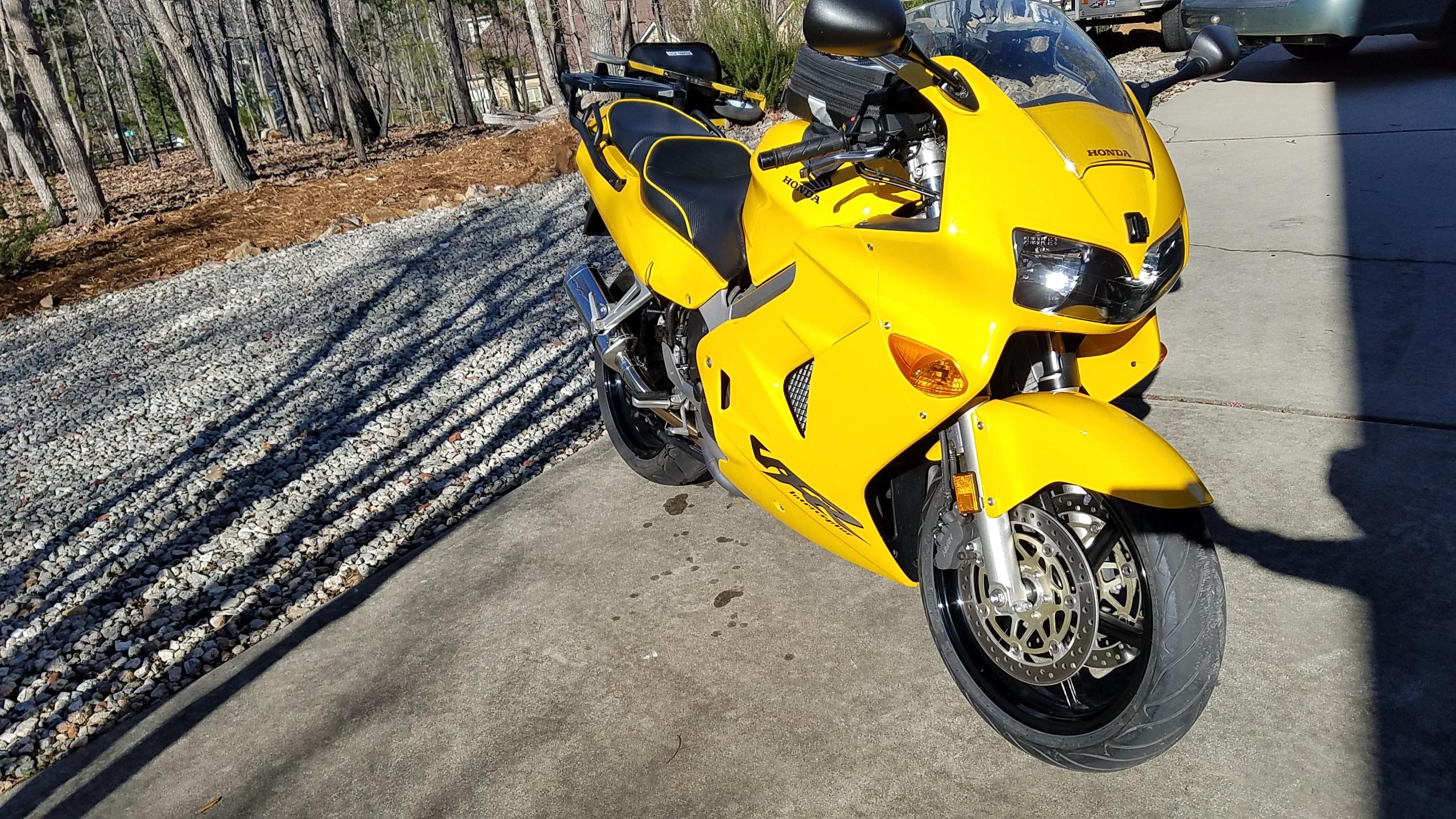

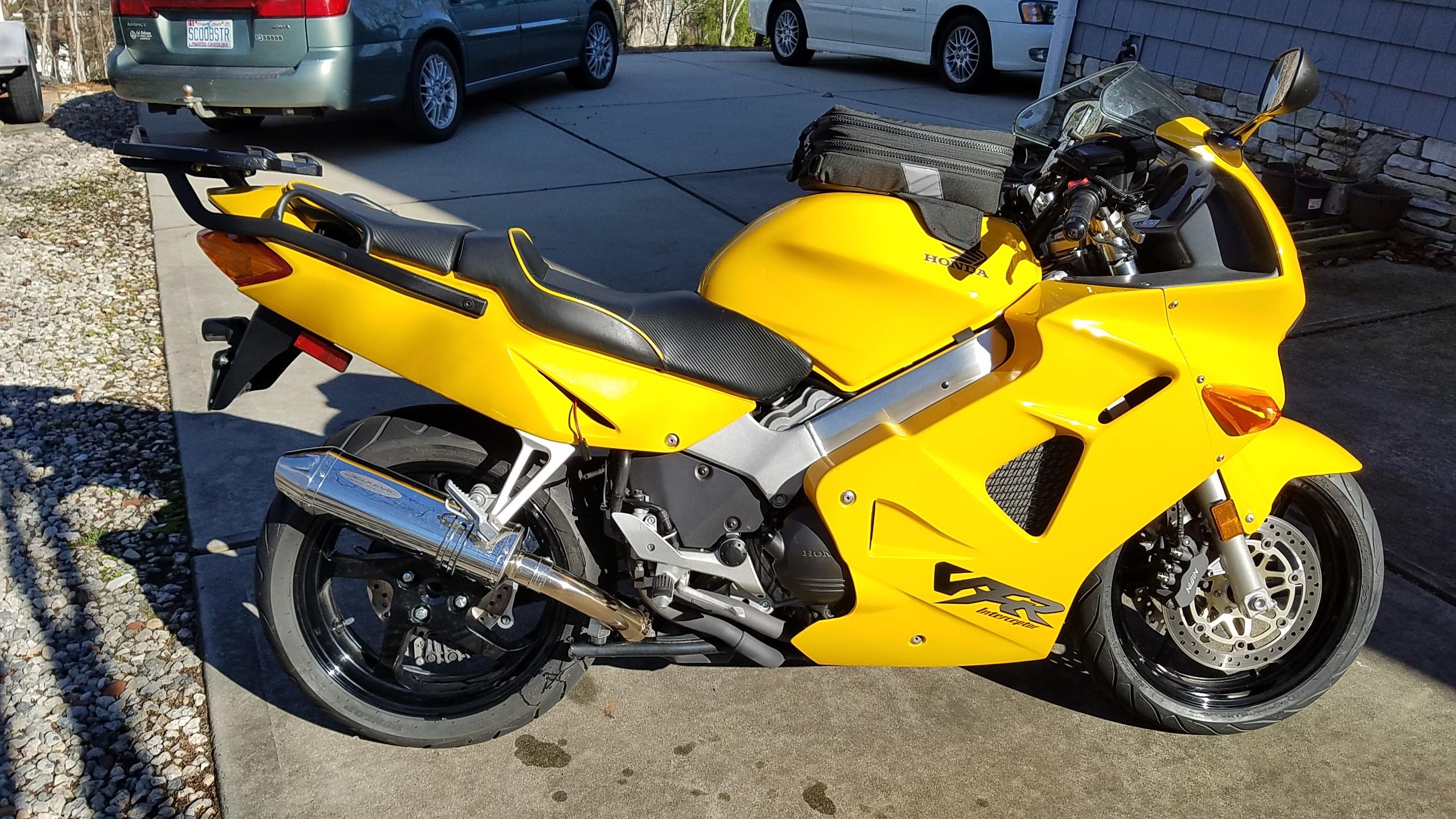

Member Contributer bmart Posted January 7, 2022 Author Member Contributer Posted January 7, 2022 Left Staintune, which I love, on the '98. Added an inexpensive (but very nice) Delkevic slip on to the '00. Both seem to work perfectly. Not too loud. I'd try the swap! Quote

Member Contributer bmart Posted March 21, 2022 Author Member Contributer Posted March 21, 2022 In a rare move...I lightly cleaned it after the brake fluid flush and oil change. 2 Quote
