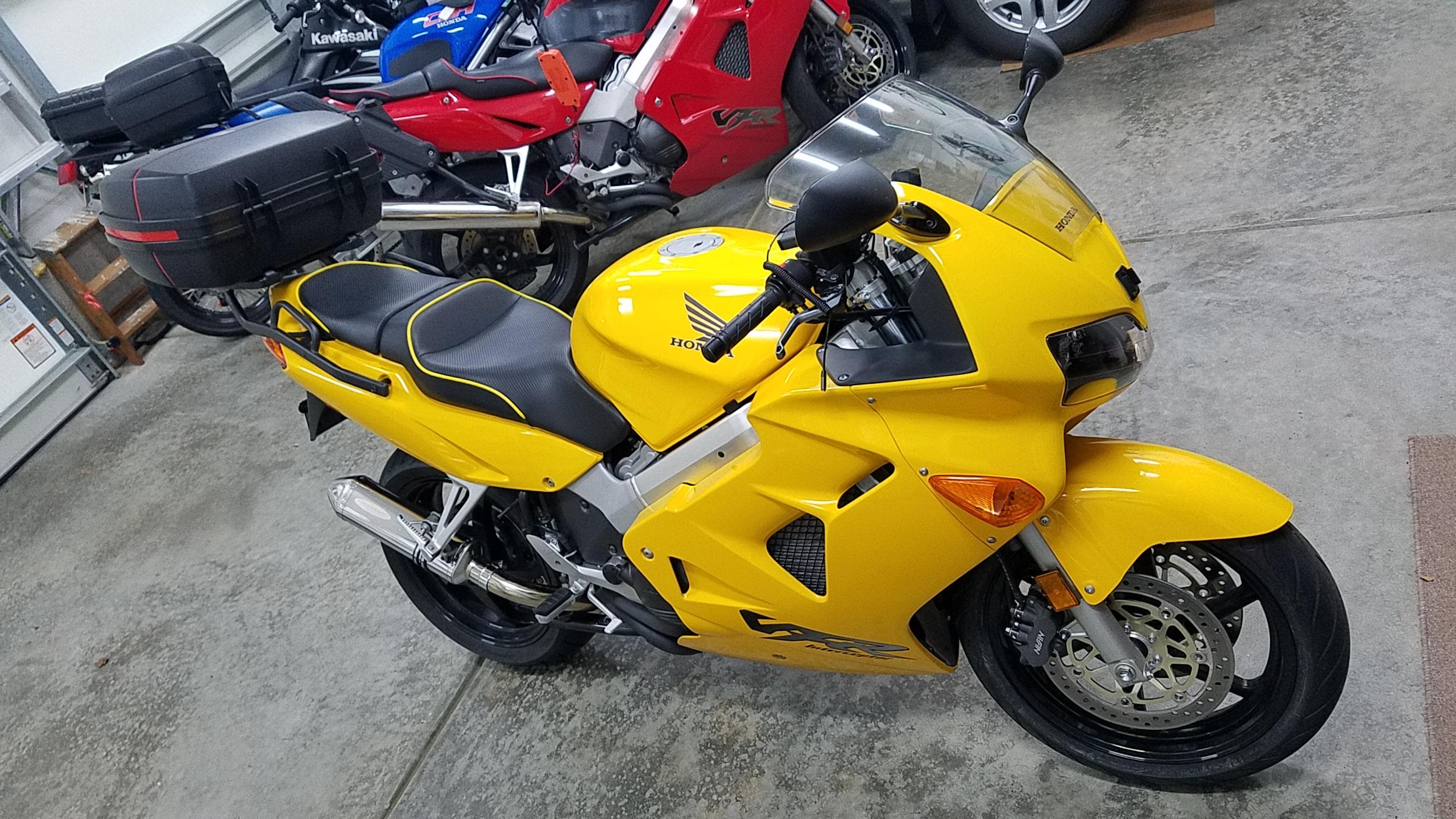

Member Contributer bmart Posted November 21, 2021 Author Member Contributer Posted November 21, 2021 Speaking of Sfdownhill, I think I'll have a seat on the way from him soon. And that's good news as this stock one is pretty terrible. I put the yellow '00 on the road on Friday and went for a spin today against doctor's orders. I just can't wait until March or April! The two teeth larger rear sprocket made a big difference, but I forgot to raise the rear using the eccentric when I installed it. The unusual fork spring feeling was gone after I reinstalled the caps and got a few miles on it. Front sag is a little snug at 31mm, as is the back at 25mm, but I'm going to ride it a bit to see if everything loosens a bit. The adjustments were made with the bike cold and me out of my gear. A few quick shots of Plexus made it look great the other night, adjusting the shifter so it wasn't aimed at the sky was a big improvement in rideability. The Givi rack looks great and UPS covered all of the damage. I repaired it and bought new (inferior) Givi nubbins. I recommend using E6000 on them if you use them, or just get rubber bumpers from the local store. My originals have a giant notch to lock them in but these new ones have been through some cost savings efforts... The intake sound with the snorkles out and the K&N installed sounds just like the '98, but that stock can is way too quiet. Ordering the fix on Friday It is getting there and should be ready for regular duty after a few more items are discovered (risers, as I can't get the levers low enough to be comfortable with the stock handlebars) / installed. Quote

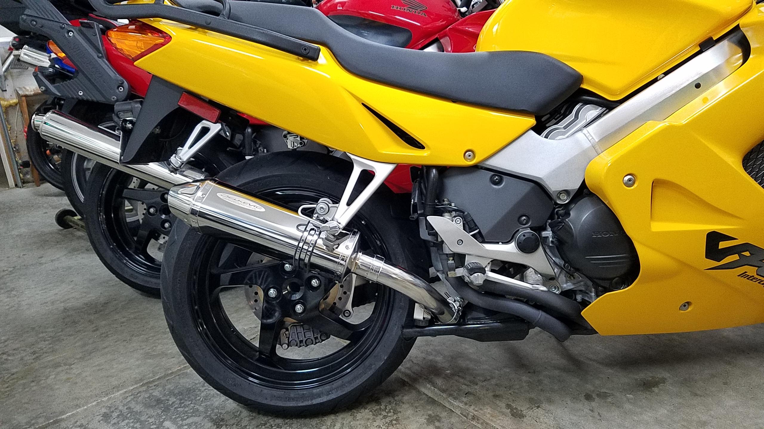

Member Contributer bmart Posted November 26, 2021 Author Member Contributer Posted November 26, 2021 Slip on and SH847 kit ordered. Stay tuned! 1 Quote

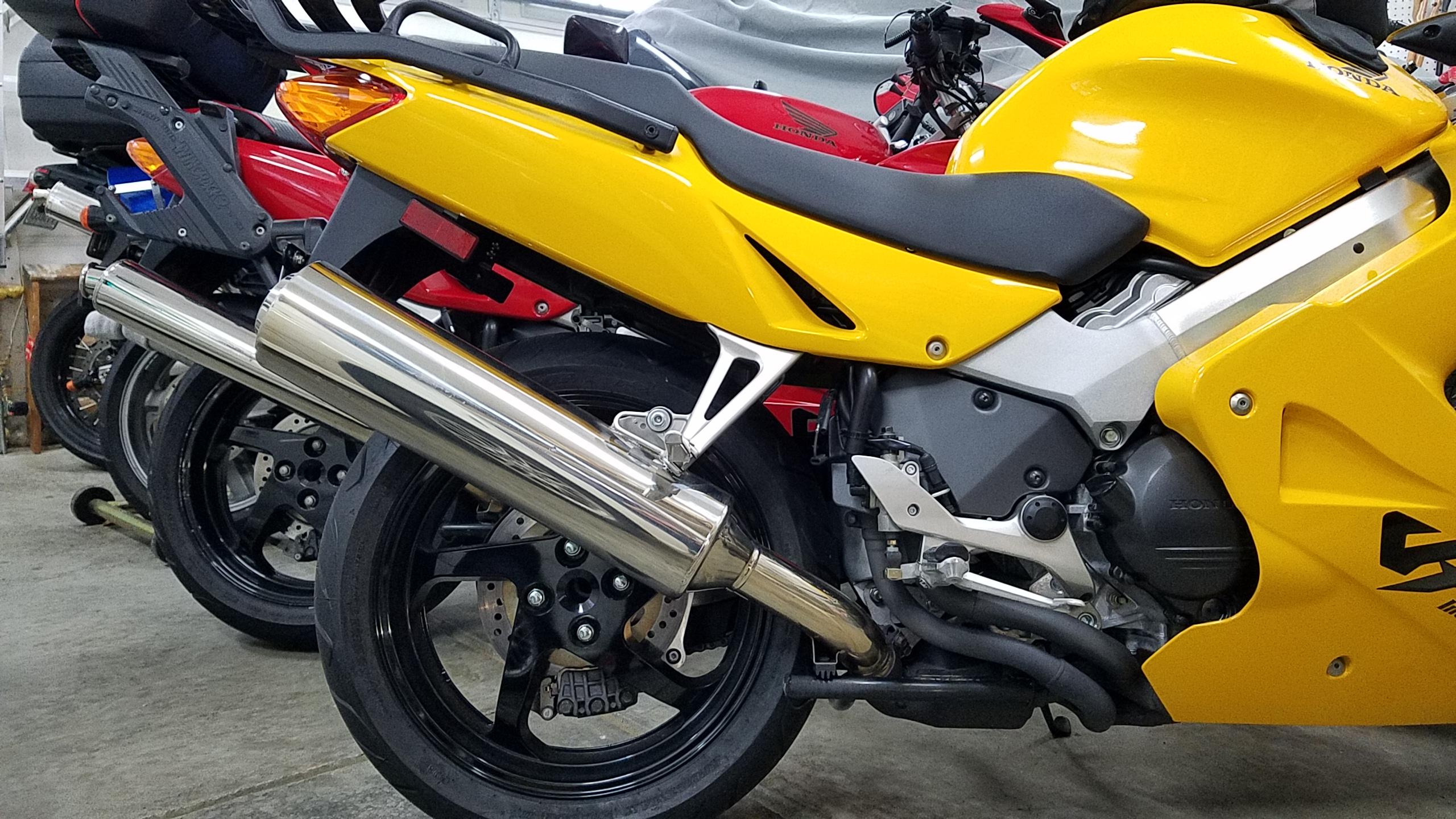

Member Contributer bmart Posted December 1, 2021 Author Member Contributer Posted December 1, 2021 SH847 should be here this week. Delkevic came today. It weighs so much less than the stocker and looks superb on there. Hoping to test it later this week. 2 Quote
Member Contributer Cogswell Posted December 2, 2021 Member Contributer Posted December 2, 2021 I'll bet it sounds even better than it looks!! Quote
Member Contributer bmart Posted December 2, 2021 Author Member Contributer Posted December 2, 2021 You tell me! Seems milder than I expected, which will be fine. Only 13"! Quote
Member Contributer ShipFixer Posted December 3, 2021 Member Contributer Posted December 3, 2021 Ha...I have dual 8" Delkevics, they sound really good. But I had to go with the "quieter" baffles. With the stock baffle and catless VFRD header it was waaaaay too loud. I was really looking at whether I could take two 13" Delkevics and have them cut down to 10" or something 😕 Quote

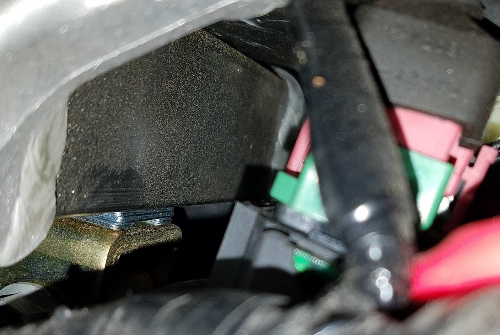

Member Contributer bmart Posted December 9, 2021 Author Member Contributer Posted December 9, 2021 Still no luck finding Helibars or Genmar risers for VFR00. Genmar would be better financially, but the Helibars would let me tilt the levers down a bit more, which is preferred. Picked up a bag of 1/16" u-shaped washers/spacers for auto body spacing, as another post suggested. I'll use those on the stock shock mount. Planning to use 3 shims to get close enough. 0.188"=3/16"=4.78 mm 0.250”=4/16”=6.35 mm If I ever bump into a smoking deal on a quality aftermarket shock, I'll replace it. Not long ago they were ~$600, now they're $1200+. I'll do that job when I wire the double USB power source for the phone/GPS w/voltmeter, on the way from eBay. RAM mounts came in this week and will get done then also. I have the parts for the Passport and will wire/mount that on the front master just like VFR98. And the SH847 kit will go on then once I figure out the plug sourcing, which is so far, confusing. I noticed that this bike has the stock windscreen and VFR98 has a double bubble looking one. I haven't spend enough time to notice any big difference yet, other than it isn't compeltely transparent/clear like the aftermarket one. Looking forward to more miles before track season starts back up! Quote

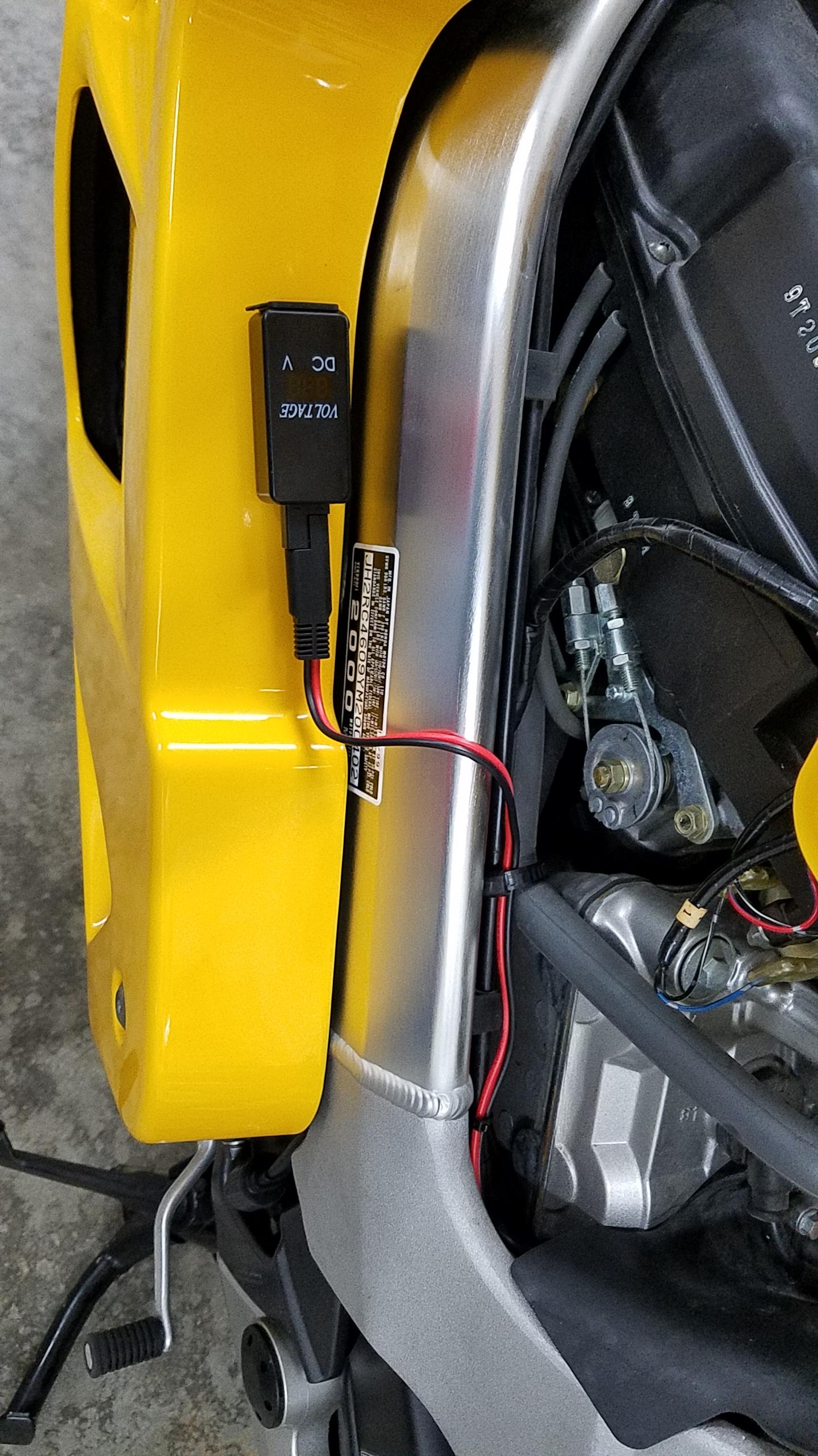

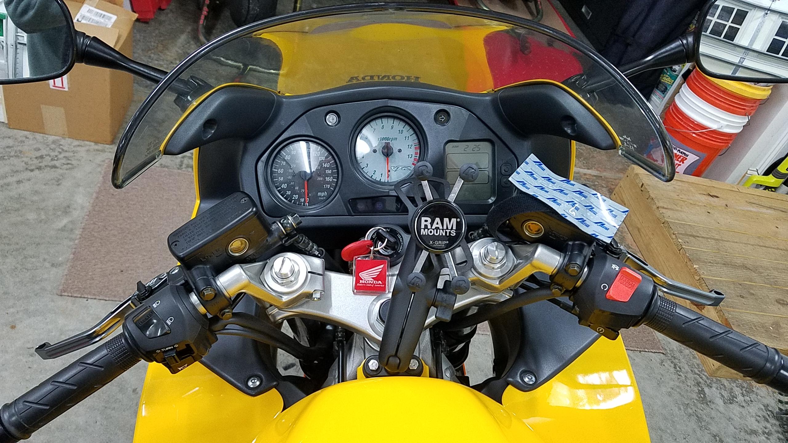

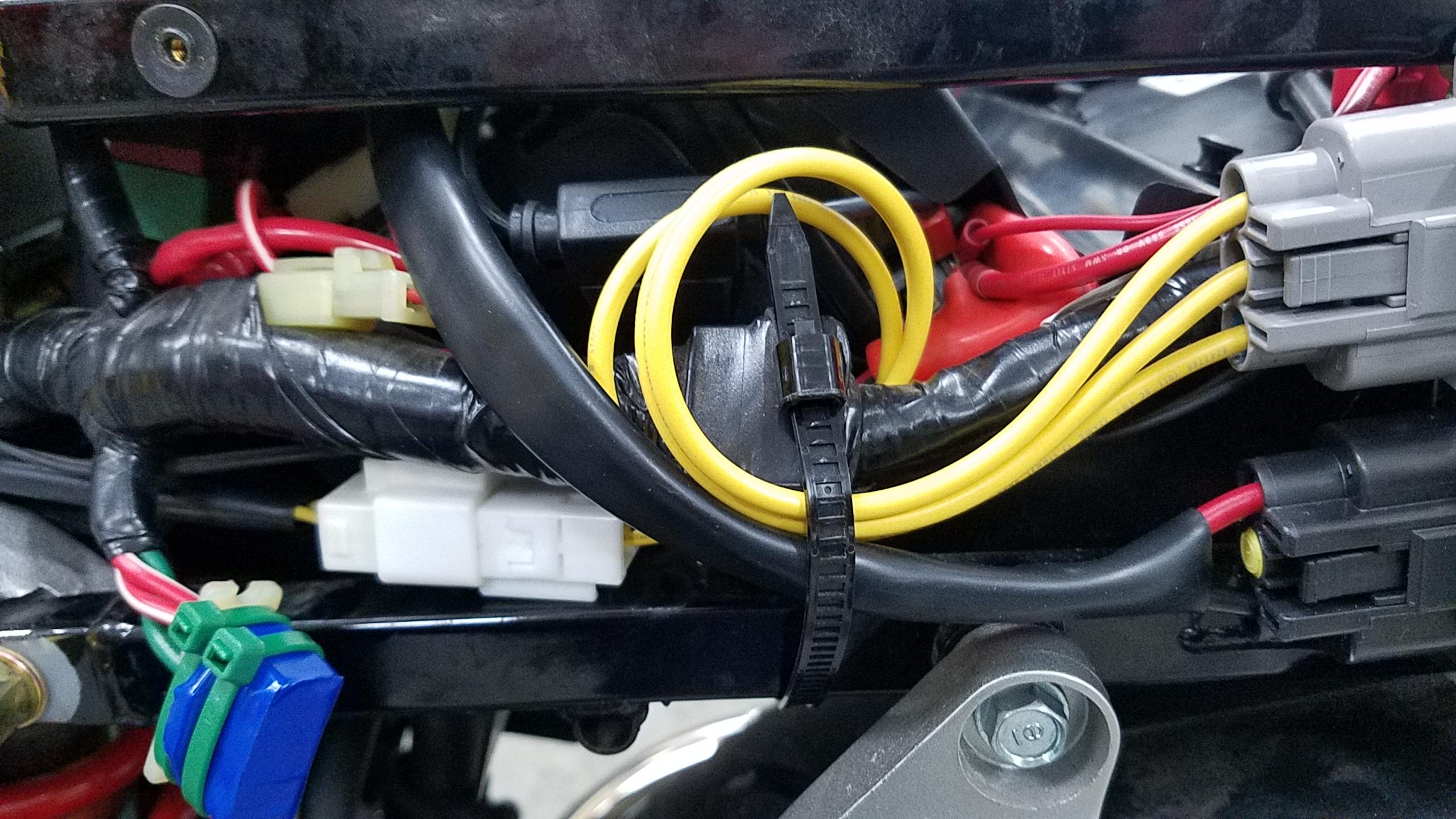

Member Contributer bmart Posted December 20, 2021 Author Member Contributer Posted December 20, 2021 Still waiting for a few things, but it is coming together. Wired voltmeter w/2 USB ports. This will let me power the phone/GPS just like on the other bikes. Also added the RAM mount just like the other VFR. Wired the radar detector, but waiting for a cheap used unit and solderable 1/8" jack to arrive from fleabay later this week. Wired and (hillbilly) mounted the SH847. I'm not sure I want to drill two large holes in teh sides of the subframe yet. I'll probably just make a cheap plate. Cable ties for placement and one safety wire...for safety. lol Waiting on yellow striped used seat (yay!). Rode UGLYRED the other day. Gods, that bike is nice to ride! The money I paid to have Thermosman do the forks was so worth it. Hoping to get out on the yellow bike on Christmas while it is still warm here. Can't wait to see how the shimmed shock feels. Quote
Member Contributer bmart Posted December 27, 2021 Author Member Contributer Posted December 27, 2021 Done (for now)! Thanks all for the great info and to SF for the matching seat. You're like Lance(r) the not completely forgotten reindeer. 🙂 Quote
Member Contributer bmart Posted December 28, 2021 Author Member Contributer Posted December 28, 2021 Winner winner, chicken dinner...so far (~260 miles). All of the mods have worked out well. The forks aren't too bad with just the spring change and no valving mod. The shimmed rear shock is adequate with preload on 3 (stock is 2) and rebound damping 1 1/8" turn out. Compressions damping is too stiff, but there's no adjustment, so it stays as is! Regulator rectifier update is 14.3-14.4 at RPM and 12.6-12.7 at idle. Radar and GPS rockin'. 1 Quote
