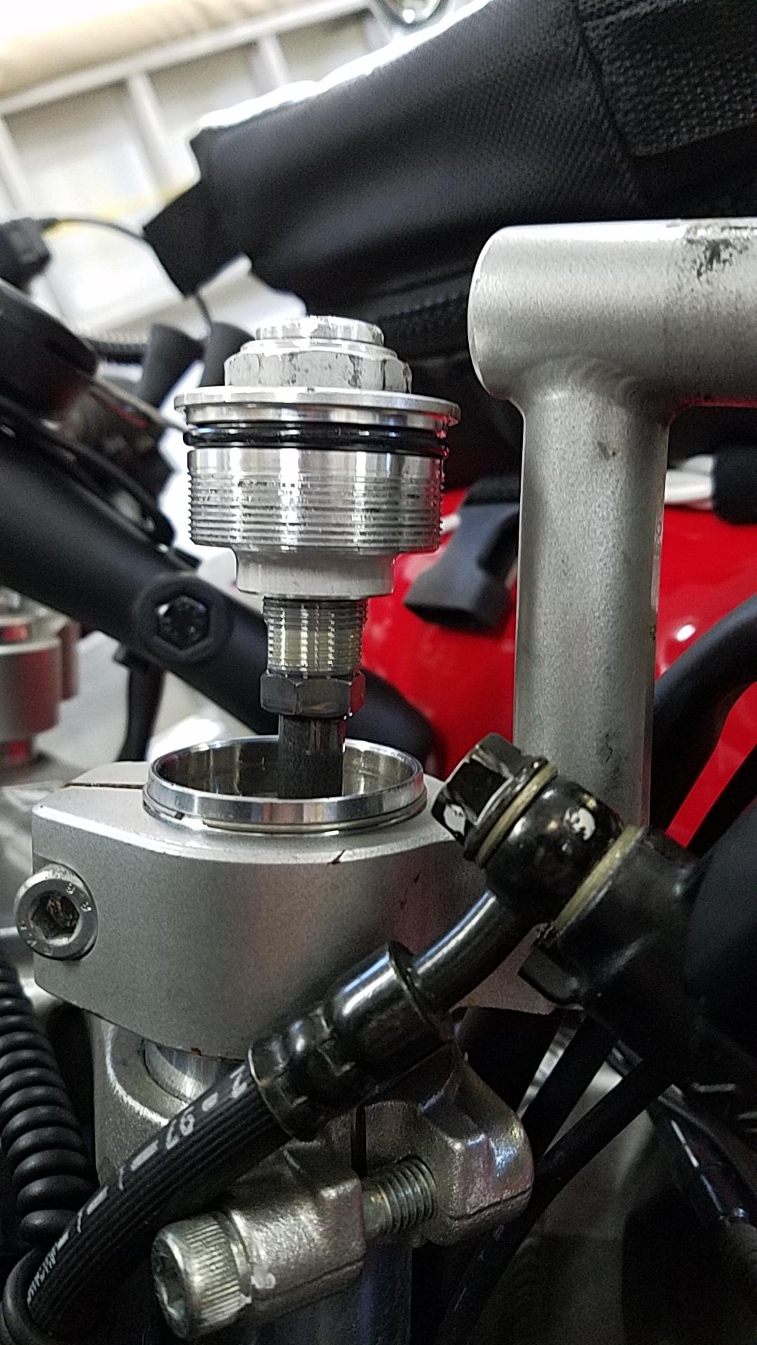

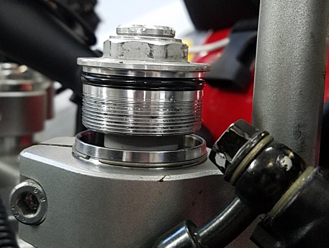

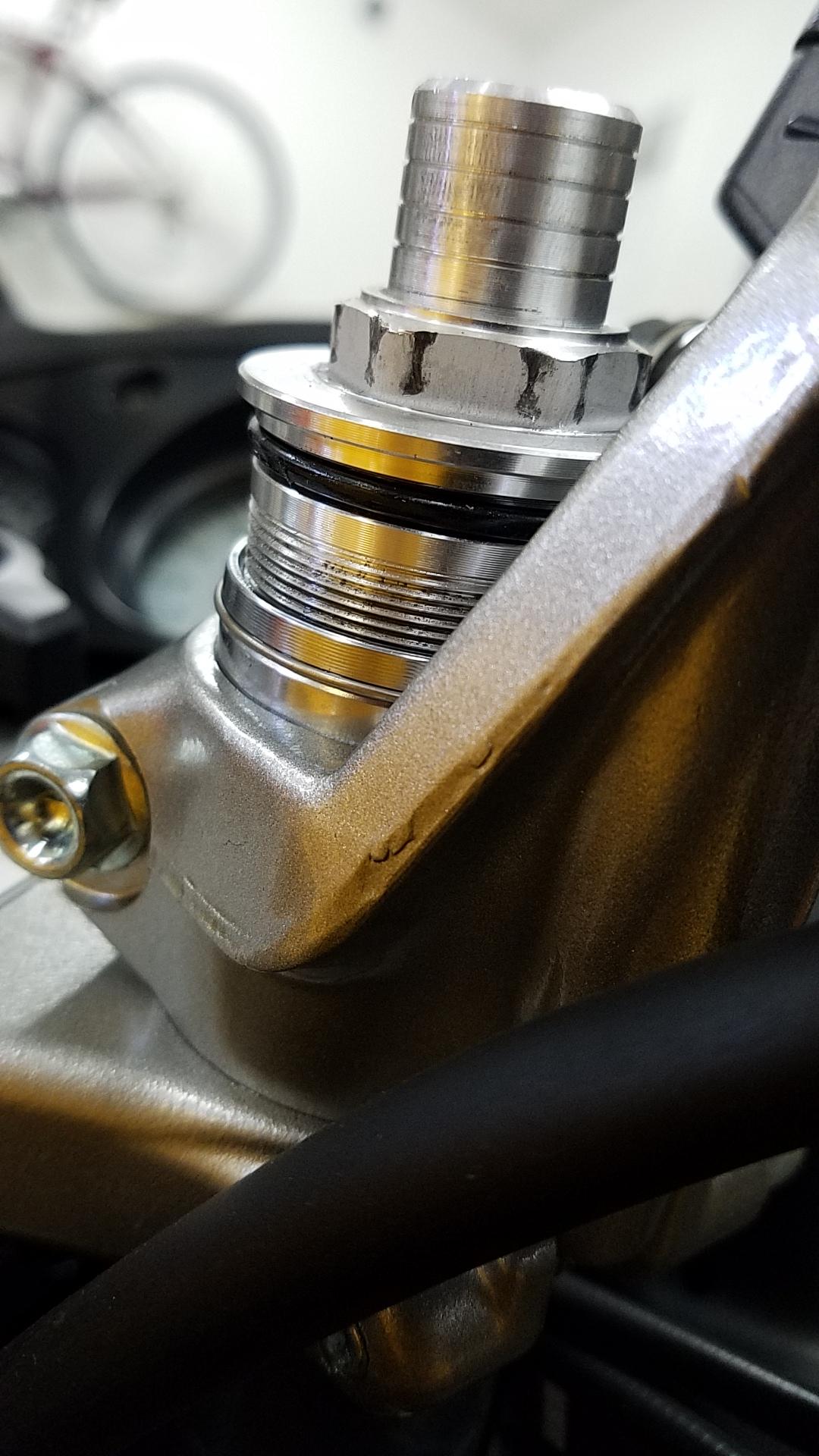

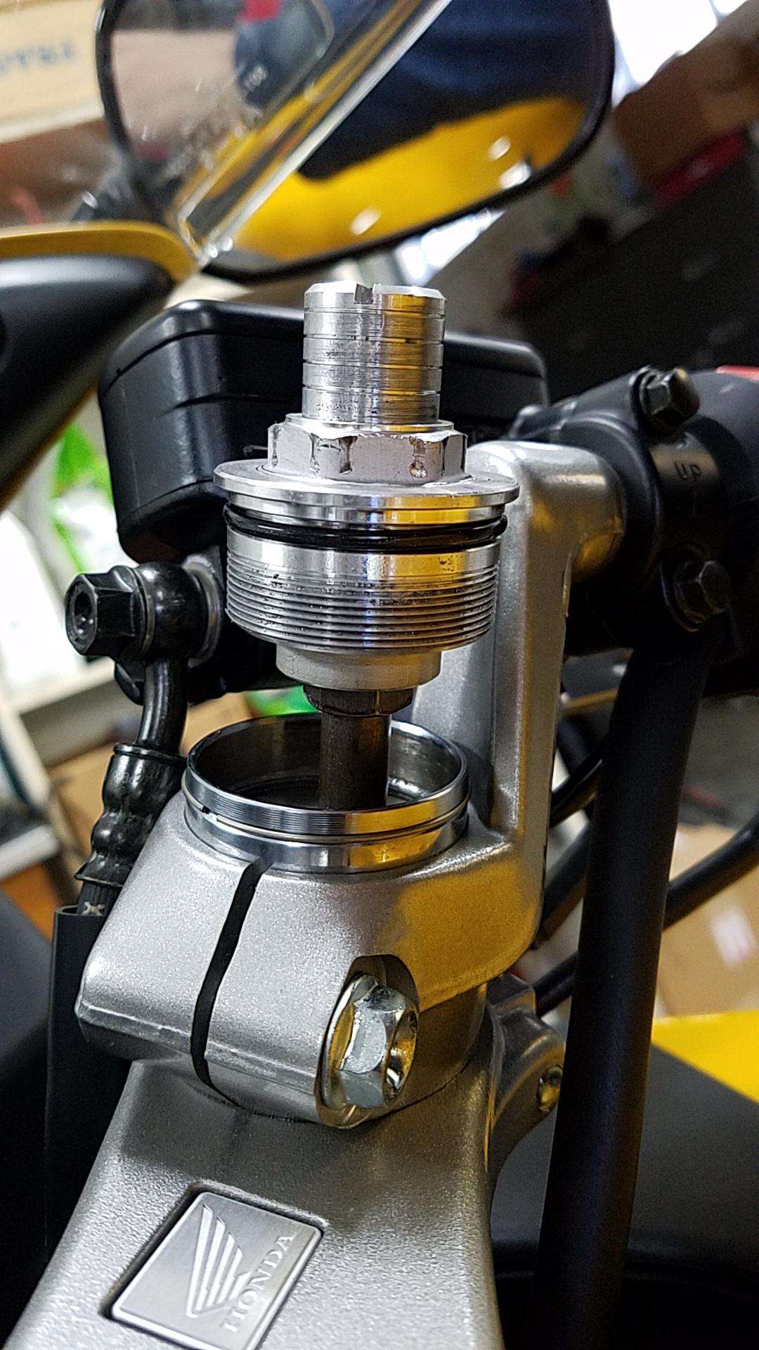

Member Contributer bmart Posted November 8, 2021 Author Member Contributer Posted November 8, 2021 Quick question. I swapped the stock front fork springs (.740 kg/mm) for .900 kg/mm but the front is very rigid after. I used shorter spacers to match the combined length of the stock parts. Before I go swapping spacer lengths, can you guys think of anything that could have gone wrong? This was really simple and I've installed many fork springs over the years without issue. Quote
Member Contributer Captain 80s Posted November 8, 2021 Member Contributer Posted November 8, 2021 Did you verify your new oil level after installing the new springs? They could have taken up more volume and raised the oil level, reducing the air space. Quote
Member Contributer bmart Posted November 8, 2021 Author Member Contributer Posted November 8, 2021 It was a few weeks and dozens of projects ago...but I can pull them and look/measure again. I've always measured with teh springs out, as all of my manuals suggest. Do you have another method? Quote
Member Contributer Captain 80s Posted November 8, 2021 Member Contributer Posted November 8, 2021 No, of course that's the way. Not sure what my point was now. ; - ) I guess you need to reduce your oil level now with the new stiffer springs. Quote
Member Contributer Terry Posted November 8, 2021 Member Contributer Posted November 8, 2021 I don't recall exactly but my gut feel is that there quite a bit more preload on the stock springs than you would want with 0.9kg/mm items. Racetech's standard advice is to set the spacer length so you get 10mm of preload with the preload adjusters backed out fully. To work that out put the springs and washers in place and extend the fork fully, then measure down from the fork top to the top of the washer. Back the preload adjuster in the cap fully out and then measure the distance from the point of contact with the fork top to the underside of the cupped washer. Subtract one from the other and that is the no preload spacer length, and add 10mm to that. Then check the sag when you sit on the bike which should be around 1/4- to 1/3 total travel, adjust with the preload adjuster or change the spacer if needed. Changing the oil level won't make much difference to the fork feel excepting bottoming resistance. With decent springs you should also at least consider replacing the compression valves with a set of Gold Valves or their equivalent. That will make the biggest difference to the ride comfort and take the edginess off the bump absorption. Quote
Member Contributer Captain 80s Posted November 8, 2021 Member Contributer Posted November 8, 2021 18 minutes ago, Terry said: I don't recall exactly but my gut feel is that there quite a bit more preload on the stock springs than you would want with 0.9kg/mm items. Racetech's standard advice is to set the spacer length so you get 10mm of preload with the preload adjusters backed out fully. To work that out put the springs and washers in place and extend the fork fully, then measure down from the fork top to the top of the washer. Back the preload adjuster in the cap fully out and then measure the distance from the point of contact with the fork top to the underside of the cupped washer. Subtract one from the other and that is the no preload spacer length, and add 10mm to that. Then check the sag when you sit on the bike which should be around 1/4- to 1/3 total travel, adjust with the preload adjuster or change the spacer if needed. Changing the oil level won't make much difference to the fork feel excepting bottoming resistance. With decent springs you should also at least consider replacing the compression valves with a set of Gold Valves or their equivalent. That will make the biggest difference to the ride comfort and take the edginess off the bump absorption. I agree that the preload needs to be reevaluated, but fork oil level can certainly make a big difference to the fork feel if it is too high. There can be not enough air volume to compress before it feels locked. Quote
Member Contributer bmart Posted November 8, 2021 Author Member Contributer Posted November 8, 2021 I'm going to pull the '98 fork cap off this week and compare. I should have thought of that earlier. Those are perfect. Thermosman is a magician. If I keep both bikes, I'll revalve it. Quote
Member Contributer bmart Posted November 8, 2021 Author Member Contributer Posted November 8, 2021 Talked with Jack on the R/R options today. They're a lot easier than his website. 😛 Pulled a cap on the red '98 today. The distances are nearly identical to the troublemaker yellow '00. Quote
