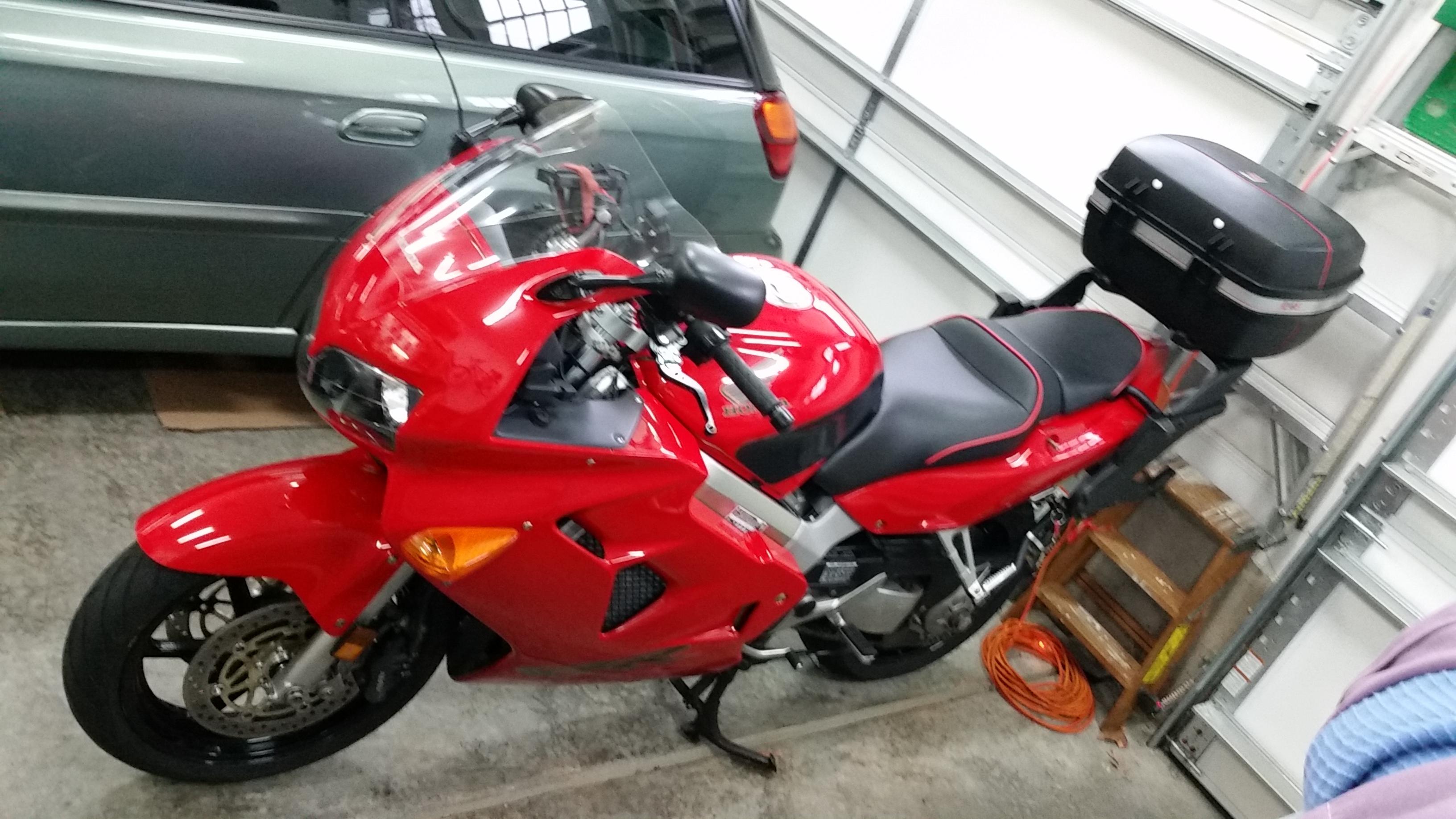

Member Contributer bmart Posted September 15, 2021 Member Contributer Posted September 15, 2021 Hey all, After nearly eight years of ownership, I may be moving all of the goodies on my 1998 to a 2000 model and have a few questions. I believe that everything will be a direct swap, but hope that you guys can guide me if I'm wrong. Thank you! Items: Sprockets/chain Fork internals Shock GIVI rack Staintune slip on (2000 has O2 sensors and cat, right?) Sargent seats Windscreen Air fitler Might I be missing anything? Once I wrap up the swaps, the 1998 will be for sale here in Charlotte, NC in nearly all stock form w/~25k miles and excellent. Anything else I should know about the swap to 2000, including the wax (?) fuel enrichment unit? Thanks, all! 1 Quote
Member Contributer adkfinn Posted September 15, 2021 Member Contributer Posted September 15, 2021 2000 picks up the wax unit/enrichment circuit, a cat and 02 sensors in the exhaust, a slightly less desirable header (marginally smaller diameter from what I've read).... A '98 at 25k mi is just getting past break-in! Surely you must have a good reason, but based on the bikes alone, I can't see it. Either way, I think all the parts you've listed should swap right over (maybe double check the part #'s for the forks & associated small parts to ensure compatibility. Good luck Quote
Member Contributer ducnut Posted September 15, 2021 Member Contributer Posted September 15, 2021 Everything listed interchanges. 1 Quote
Member Contributer Captain 80s Posted September 15, 2021 Member Contributer Posted September 15, 2021 I would rather have an excellent 98-99 with 30k than a 00-01 with 3K. 5 Quote

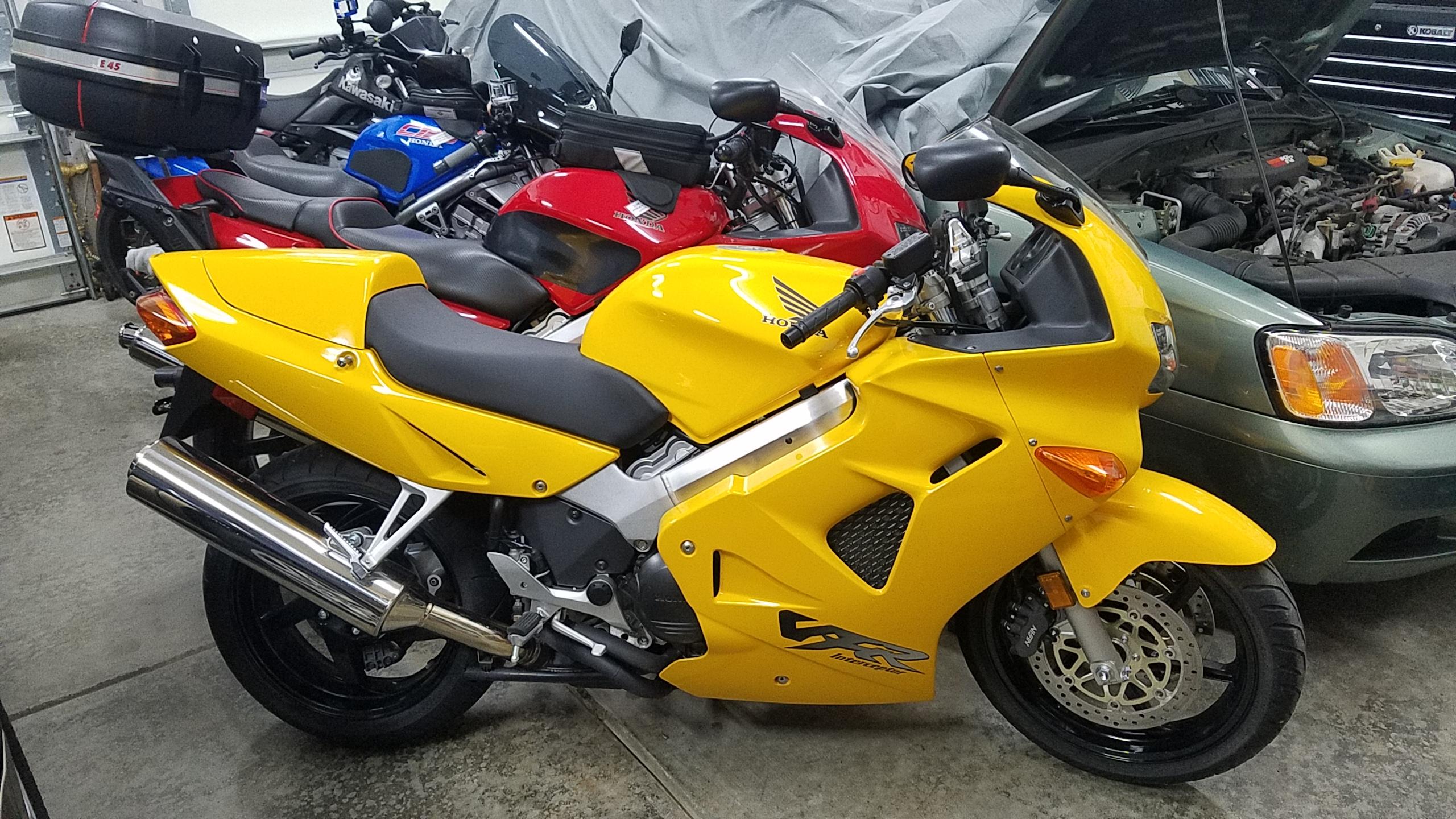

Member Contributer bmart Posted September 15, 2021 Author Member Contributer Posted September 15, 2021 You'll laugh...red. I absolutely hate red and have owned a 1999 and 1998 for a total of nearly 12 years and ~30k miles. I've even thought of just swapping the bodywork and selling the low mile 2000 as red! Quote
Member Contributer Captain 80s Posted September 15, 2021 Member Contributer Posted September 15, 2021 2 minutes ago, bmart said: You'll laugh...red. I absolutely hate red and have owned a 1999 and 1998 for a total of nearly 12 years and ~30k miles. I've even thought of just swapping the bodywork and selling the low mile 2000 as red! Ok.... there ya go. Fuck, I'd swap the body work ALL DAY LONG. And any other doo-dad that is nicer. Cheapest OEM paint job EVER. 5 Quote
Member Contributer Cogswell Posted September 15, 2021 Member Contributer Posted September 15, 2021 22 minutes ago, bmart said: You'll laugh...red. I absolutely hate red and have owned a 1999 and 1998 for a total of nearly 12 years and ~30k miles. I've even thought of just swapping the bodywork and selling the low mile 2000 as red! If you went with Chinese bodywork in yellow and got a tank sprayed to match, you could have the best of both - a yellow '98. And, you would have zero trouble selling your fairings - they'd be gone in 60 seconds. My 6G wax unit has failed - I'd swap over a 98/99 lever housing and cable if it were more practical (it would take a lot of fiddling / fabbing to get it done), so I'm not fan of that. There are varying opinions on the brakes - personally I like 'em, probably saved my ass a time or two, but I do understand personal opinions about them may differ from mine. Either way, if you want OEM and plug and play yellow bike, then buying a 2000 is probably the easiest way to go. 2 Quote
Member Contributer Captain 80s Posted September 15, 2021 Member Contributer Posted September 15, 2021 Chinese bodywork is not part of the best of any world. He has a chance to buy the color he wants, swap over OEM bodywork onto the better (imo) year, and sell the now red one. And be WAY ahead money wise. Might even make money. 4 Quote

Member Contributer bmart Posted September 17, 2021 Author Member Contributer Posted September 17, 2021 Got it. Thanks! Also found this which mentions a frame change, but it looks non-U.S. HESS was non U.S., I believe, but also see modified clutch. Thoughts? (Sorry...I like to track things!.) "2000: Honda VFR800i gets minor update; slight frame changes, modified clutch, refined fuel injection, more durable electrics, improved mirrors, HISS security system." It isn't all bad...3k miles. Quote
