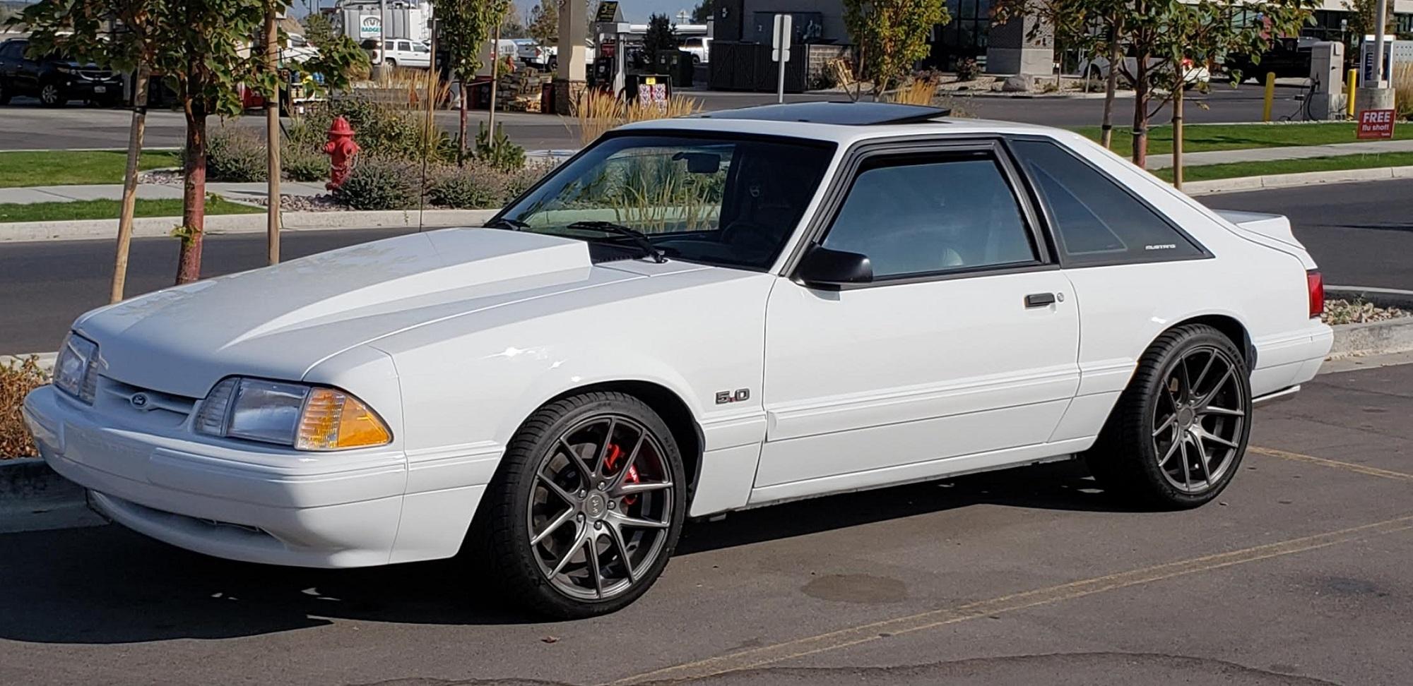

jroberts427 Posted January 7, 2022 Author Posted January 7, 2022 1 minute ago, vfrcapn said: Great looking bike, looks like new, like mine 20 years ago. I had the same 'stang back in the day too, although not to the state of tune that one looks to be. Thanks, good eye! The 5.0 has it's own story. I bought it the first time in 2002, sold it in 2007 then found it again (my actual car!) and bought it back in Dec 2018. It was a total basket case and had 350k miles on it. My family and I spent 14 months doing our version of a full resto-mod. Body, paint, brakes, suspension, interior, fully rebuilt drivetrain, all in my garage. It runs well and dynoed 263hp/302tq at the wheels which is a nice improvement over stock. Thinking I might go single turbo at some point in the future. Our local news station even did an article on it: https://www.ksl.com/article/46782464/after-more-than-a-decade-saratoga-springs-family-finds-their-mustang-that-got-away Cheers, Justin Quote

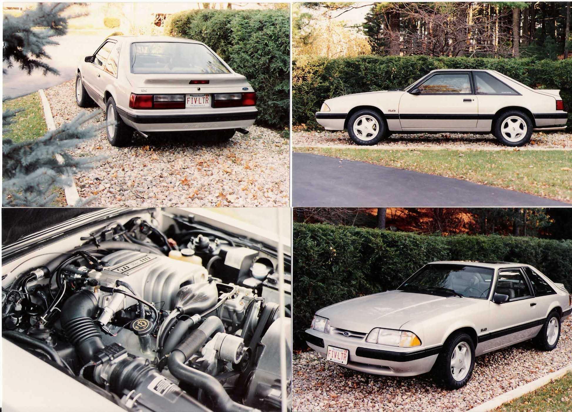

Member Contributer vfrcapn Posted January 7, 2022 Member Contributer Posted January 7, 2022 5 minutes ago, jroberts427 said: Thanks, good eye! The 5.0 has it's own story. I bought it the first time in 2002, sold it in 2007 then found it again (my actual car!) and bought it back in Dec 2018. It was a total basket case and had 350k miles on it. My family and I spent 14 months doing our version of a full resto-mod. Body, paint, brakes, suspension, interior, fully rebuilt drivetrain, all in my garage. It runs well and dynoed 263hp/302tq at the wheels which is a nice improvement over stock. Thinking I might go single turbo at some point in the future. Our local news station even did an article on it: https://www.ksl.com/article/46782464/after-more-than-a-decade-saratoga-springs-family-finds-their-mustang-that-got-away Cheers, Justin Nice work, that looks as clean as the VFR. I put 200K on a '79 Capri 5.0, then a few more years on a '86 Mustang LX 5.0. Fun cars. 2 Quote

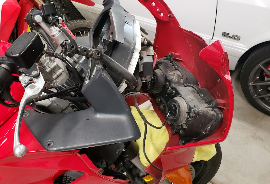

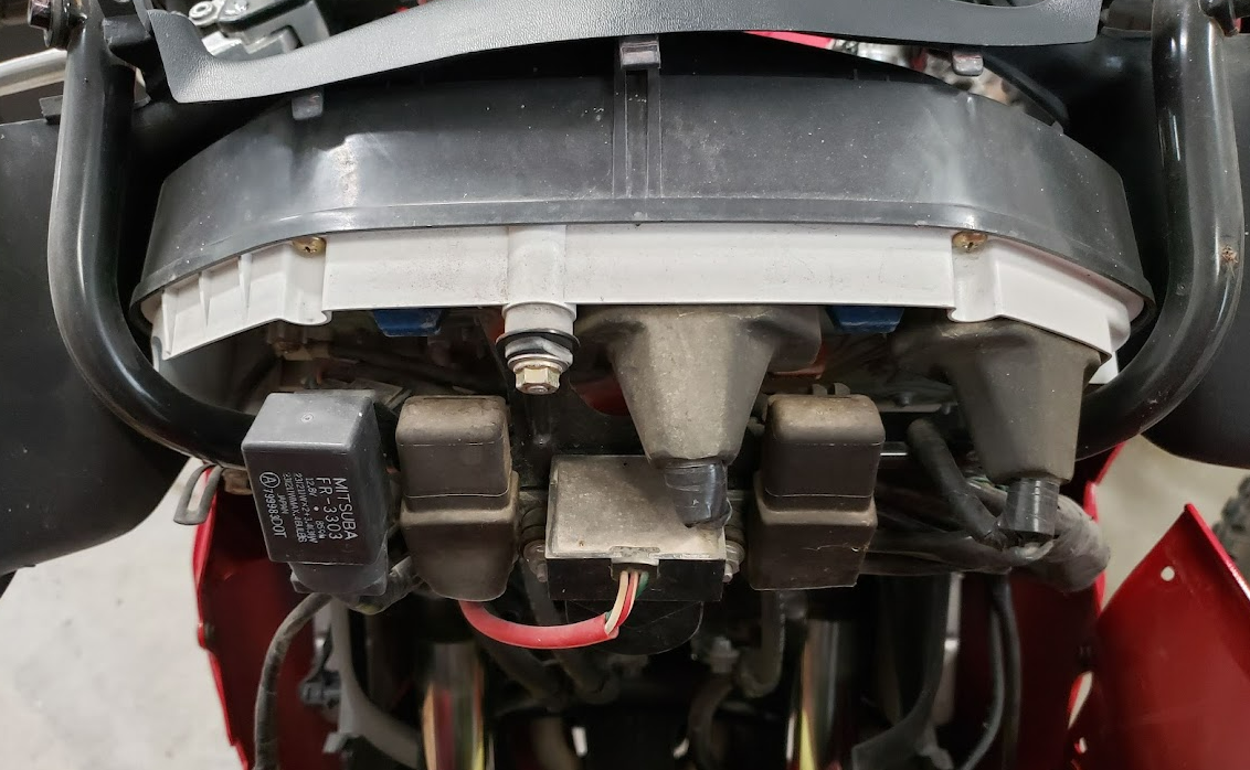

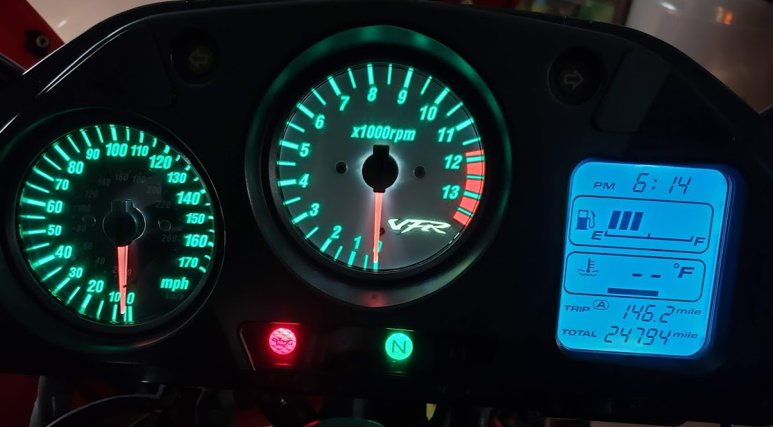

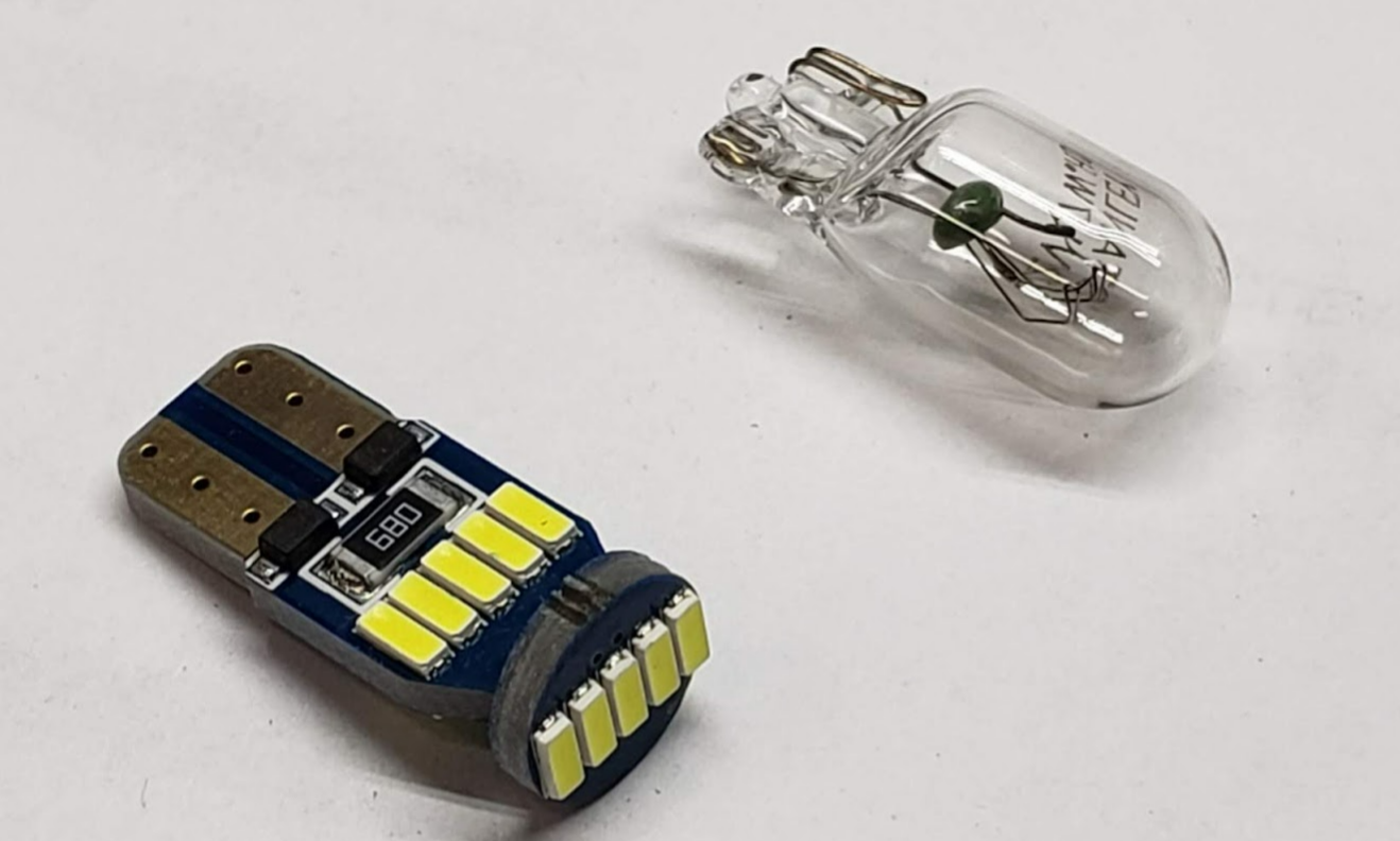

jroberts427 Posted April 16, 2022 Author Posted April 16, 2022 Went for a ride the other night and noticed one of the dash lights had burned out. Great time to upgrade to LEDs! I read some forum posts on the topic and found some suitable LEDs on Amazon. They were priced well and are slightly lower wattage than the stockers: https://www.amazon.com/dp/B08229N2Y5?psc=1&ref=ppx_yo2ov_dt_b_product_details The package of 10 gives enough to do the main lights on the VFR and 5 for use on my 1992 Mustang which I'll install soon. Here's the LED compared to the stock bulb: Everything came off easily, just take your time and keep track of the fasteners. I learned as well that you don't have to remove the blinkers, nor do you have to disconnect the blinker plugs or the headlight plugs. I just placed a microfiber on the front fender and let the nose fairing rest on that. From there I removed the 3 10mm nuts securing the gauge cluster. It is then easily pushed forward to access the dash bulbs. The LEDs fit just fine and had no issue with polarity. Everything went without a hitch. With the LEDs installed I turned the key to verify all looked good before reassembly. Took a few minutes to clean things up a bit and put it all back together. I was pleased not to have any left over fasteners, bonus! And now for the before and after: For just a little time and even less money I am very pleased with the result. Still need to go for a night ride to see how they look in the wild. Cheers, Justin 2 Quote

trmoyer Posted April 16, 2022 Posted April 16, 2022 This is interesting and going to follow. If it continues to work without issues I might just have to do this to my 98’. I don’t care for the lack of good illumination and this just might be my answer. 1 Quote
Member Contributer raYzerman Posted April 16, 2022 Member Contributer Posted April 16, 2022 Mine with FI changed to LED..... constantly lit, so not recommended for that one. I'll be swapping the FI bulb back to incandescent. 1 Quote
Member Contributer adkfinn Posted April 16, 2022 Member Contributer Posted April 16, 2022 Skip the dummy lights - I swapped everything but the FI light. They are too bright, IMO. The high beam indicator is annoying and I am swapping it back to incandescent shortly. 1 Quote

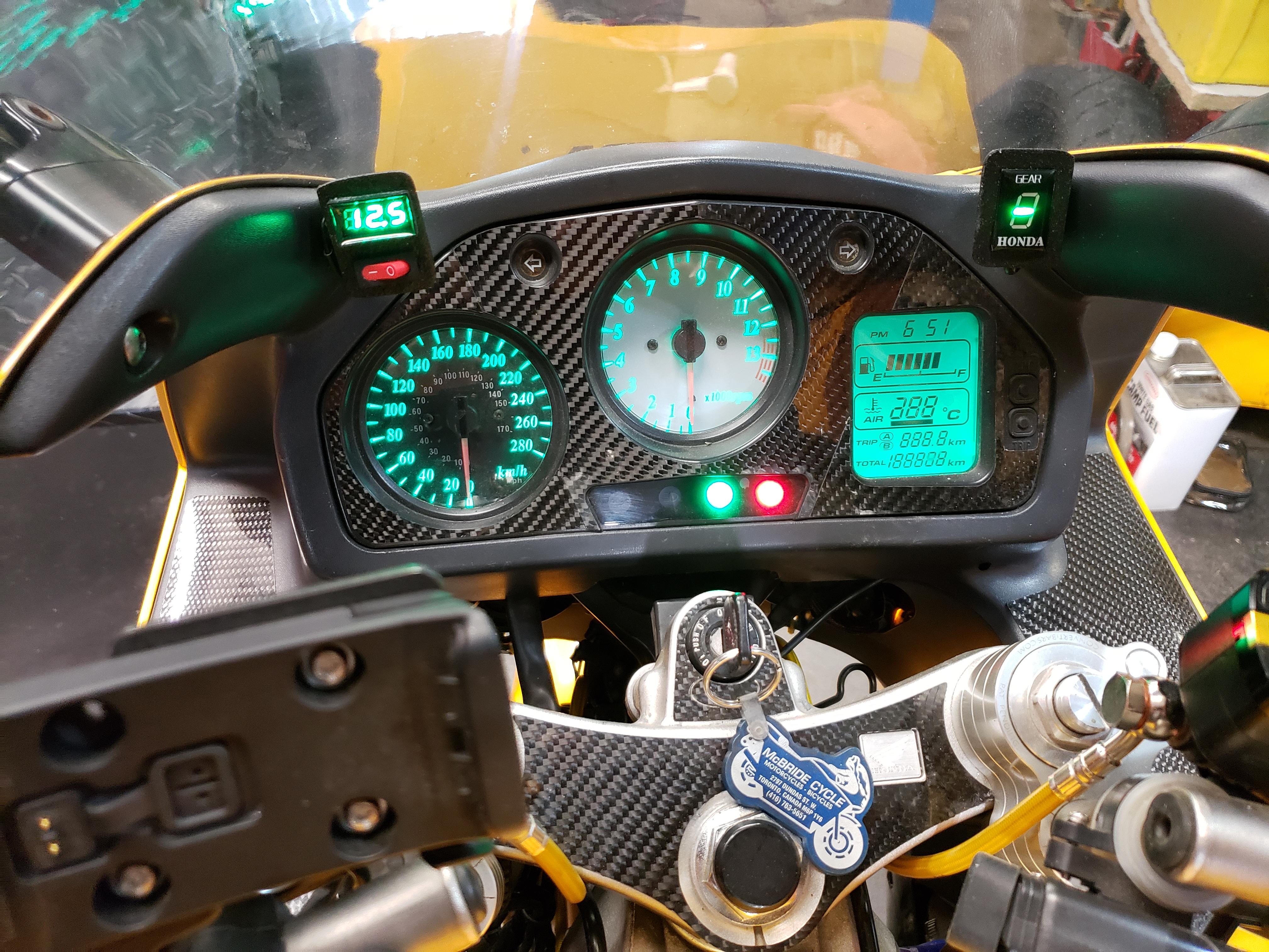

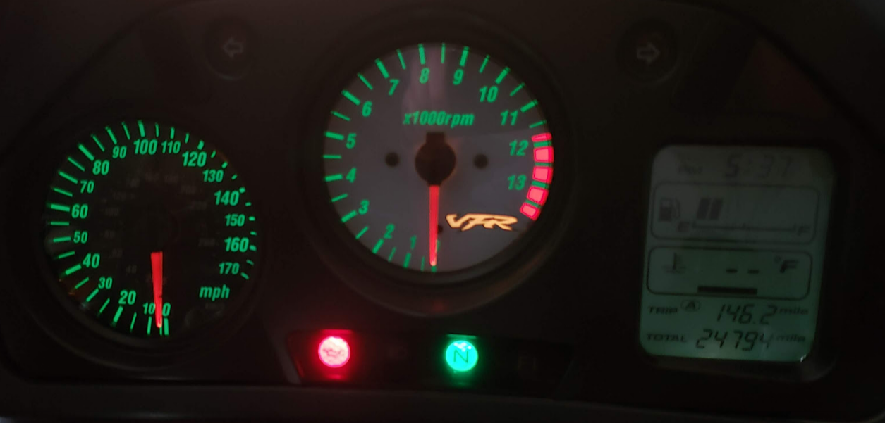

Member Contributer adkfinn Posted April 16, 2022 Member Contributer Posted April 16, 2022 3 hours ago, trmoyer said: This is interesting and going to follow. If it continues to work without issues I might just have to do this to my 98’. I don’t care for the lack of good illumination and this just might be my answer. You have the option of changing the color of the illumination also - although you are limited to blues and greens basically due to the colored filter/foil in the guages. Things like red don't come through bright enough (I tried). I changed mine to blue - NOTE - The neutral light in this photo is with the replacement led installed - very BRIGHT Here it is in a darker setting - and contains a great example of the false/always lit issue using leds in the 'dummy' lights AND - I had sent this to another member years ago, here's the bulb list and source I used: ~~~~~~~~~~~~~ LEDs - I ordered from superbrightleds.com, here's my order (I replaced everything, indicator lights as well) ---> Skip the '74' series bulbs = dummy lights, Ambers are indicators if you want them ( I like that they are bright now, easier to notice in the daytime) 2 194-A4-90: Amber Wide $1.59 2 74-NWHP: Natural White $1.95 1 74-GHP: Green $1.95 1 74-BHP: Blue $1.95 5 194-B-120: Blue 120 Degree $0.99 2 Quote
trmoyer Posted April 16, 2022 Posted April 16, 2022 I’d opt to just do the tach, Speedo and display. But that’s just me 😊 Quote
