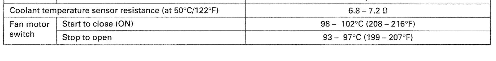

Member Contributer Cogswell Posted April 11, 2021 Member Contributer Posted April 11, 2021 Wow - that first pick reminds me of the day I trailered my 5th gen home new from the dealer. For me it was love at first sight. Fortunately I still have it! The Staintune looks great. There was also a company in Australia that makes (ed) carbon fiber bits for bikes - I think it was Geelong. I looked at their hugger for a while but never pulled he trigger on it. AFAIK they're also OOB. As for the Rad fan, it should come on at 220. Anything under that is nothing to worry about. If not, I'd double check that the coolant is full - the switch in the left rad is at the top and needs to be immersed in coolant to sense the temp. Just curious - what is the sticker on the right frame spar? Maybe a state inspection certificate? It's absent in some of the other photos . . . Keep the pics coming - this is looking good! Quote
jroberts427 Posted April 11, 2021 Author Posted April 11, 2021 Yes Sir that was a good day when I brought the bike home! The coolant level was low so I topped that off while doing the oil change. I'll keep an eye on the temps to make sure the fan is coming on when it should. Thanks! The sticker on the right frame was a college parking pass for the previous owner. I took it off along with the factory stickers that were on the top of the fuel tank. Here's another question: Did all 5th gens come factory with a catalytic converter? My first one was a California bike so it had the cat plus the charcoal canister below the oil filter. This one is a 49 state bike as far as I know. It has the cat converter but no charcoal canister. For some reason I thought 49 state bikes didn't have the cat? Justin Quote

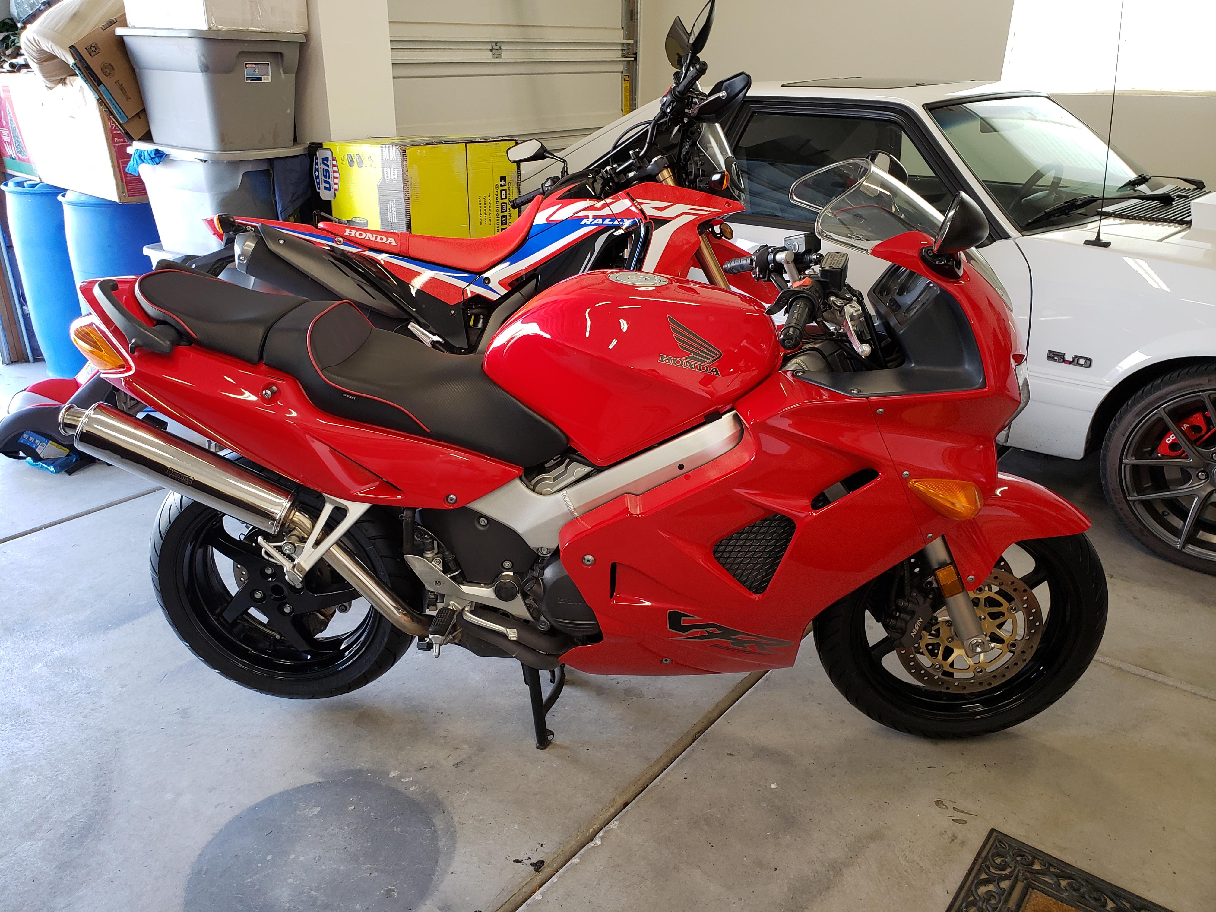

jroberts427 Posted May 3, 2021 Author Posted May 3, 2021 Hello all and hope you are getting some great riding weather where you live! I have been making some progress as parts have been coming in. While I liked the functionality of the tank bag that came with the bike my eyes couldn't handle the plastic mounting ring that was bolted to the fuel filler cap. I ordered a stainless steel bolt kit and the fix was done in minutes. Interesting to note here that 4 of the bolts on the cap ring are simply cosmetic. They bolt into the ring but they don't actually attach anything. Just makes it look more uniform guess. I like the smoother lines on the tank without the mounting ring. I took some time to bleed the clutch line which was easy enough with my brake bleeder tool. I am going to bleed the brakes with the help of another local VFR owner later this week. The clutch fluid was a little dark but not too bad. Also took the time to carefully clean out the clutch MC. Nice to have this task done and documented on my VFR maintenance spreadsheet. There were a few small bits missing from the bike that I wanted to have in place. Franken bolts and some miscellaneous pieces. I love that you can go to the Honda parts fiche and order just about any small OEM part you need. Many of the larger parts are no longer available but most of the smaller bits are. I had previously done some voltage testing and everything was in spec but I didn't know how old the battery was. Upon cleaning off some dust I found a date inscribed into the battery: 4/25/11 (!) If that is accurate all I have to say is wow! That and the battery tender the PO used must be magical. I would have never thought that a battery would last 10 years. Not wanting to risk an issue out on the road I ordered a replacement and put it in with the current date inscribed. The rear brake pads looked low so I ordered a new set from the local Honda dealer. I also ordered EBC HH for the front and they should be delivered this week. Yep, the rears were due: New set installed: Did a full coolant flush using Honda Type 2 50/50. I wasn't expecting it to be blue for some reason but it will work all the same no matter the color of the dye. As the gents from Project Binky would say: Sorted! The chain looked a little old (minor surface rust in some spots) and I wanted to go back to the 17T front so I ordered a DID gold chain (Flava Flav!) and 17/43 sprockets. The front is a lightweight design and seems to emit a slight vibration so I have ordered an OEM rubber insulated front sprocket to use instead. Worth noting here that my cheapie Amazon master link flaring tool self-destructed upon first use. You do indeed get what you pay for in tools I have found. I had enough of a flare to ride but I wanted a little more so I stopped by the local Honda service dept and they flared it a bit more for me free of charge. Great service at Monarch Honda in Orem, Utah. Torqued to spec and looking good. While looking through the service manual I noticed the spark plug replacement interval. Thought I might as well start fresh there and ordered some NGK Iridiums that should easily last longer than the standard interval. I will install them this week. Also bought an OEM windscreen from a forum member. Compared to the DB screen, the stocker is about an inch lower which places the wind below my chin instead of right at it. Took a few minutes to install and we are good to go here. Lastly, I did a bit of initial polishing. I have done some automotive detailing as a side gig in the past and still have all of my stuff. I hit the tank with a dual action polisher just to see how soft the paint was and how it would react. Got some finer scratches out but didn't want to get too aggressive with it. Also hit the Staintune with a cotton buffing wheel and compound. It looks better but needs a big industrial wheel to be done right. No worries though, it looks good enough and sounds amazing. I need to polish the rest of the bike and do a proper detail once all of the maintenance is up to date and I'm no longer removing panels, etc. Cool to see the metal flake in the Honda wing on the tank! On Saturday I took my bride of 18 years on a ride up the canyon. Our very first date was on my original VFR back in 2002. The ride was awesome. Nice flowing sweepers, waterfalls and a some lakes to pass by. Had lunch at a park in Heber, UT and then cruised back down the canyon. Made sure to properly engage tunnel mode through the short tunnel on the way. 😉 I am absolutely loving this bike and riding again. I can't believe I missed out on riding for so long. Just a few more things to address and I think we'll be ready for summer! Ride safe and take care, Justin 5 Quote

Member Contributer Grum Posted August 31, 2021 Member Contributer Posted August 31, 2021 On 4/12/2021 at 3:49 AM, jroberts427 said: **Question** Does anyone know at what temp the radiator fan is supposed to kick on? Here you go, straight from the Service Manual. 1 Quote

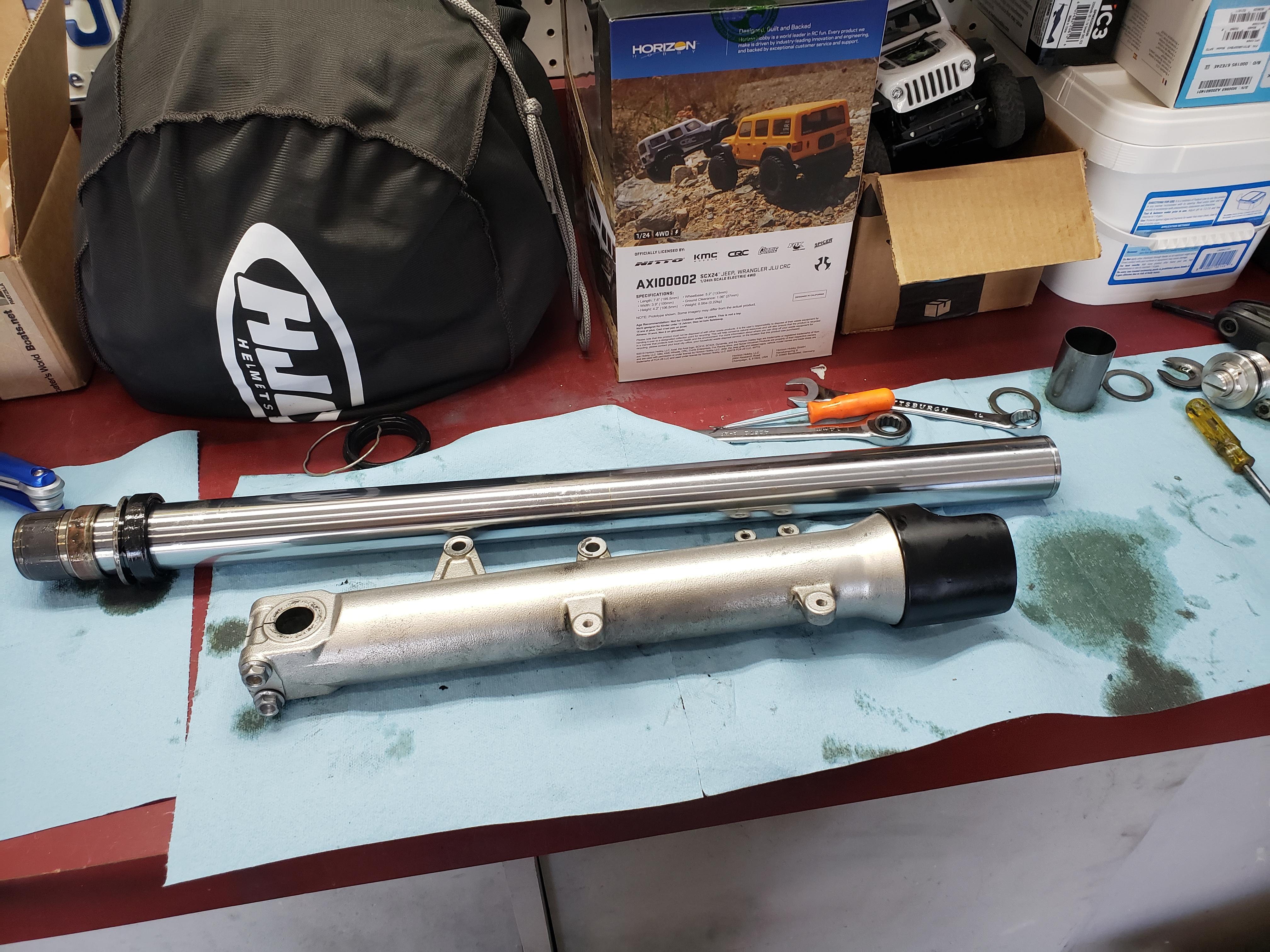

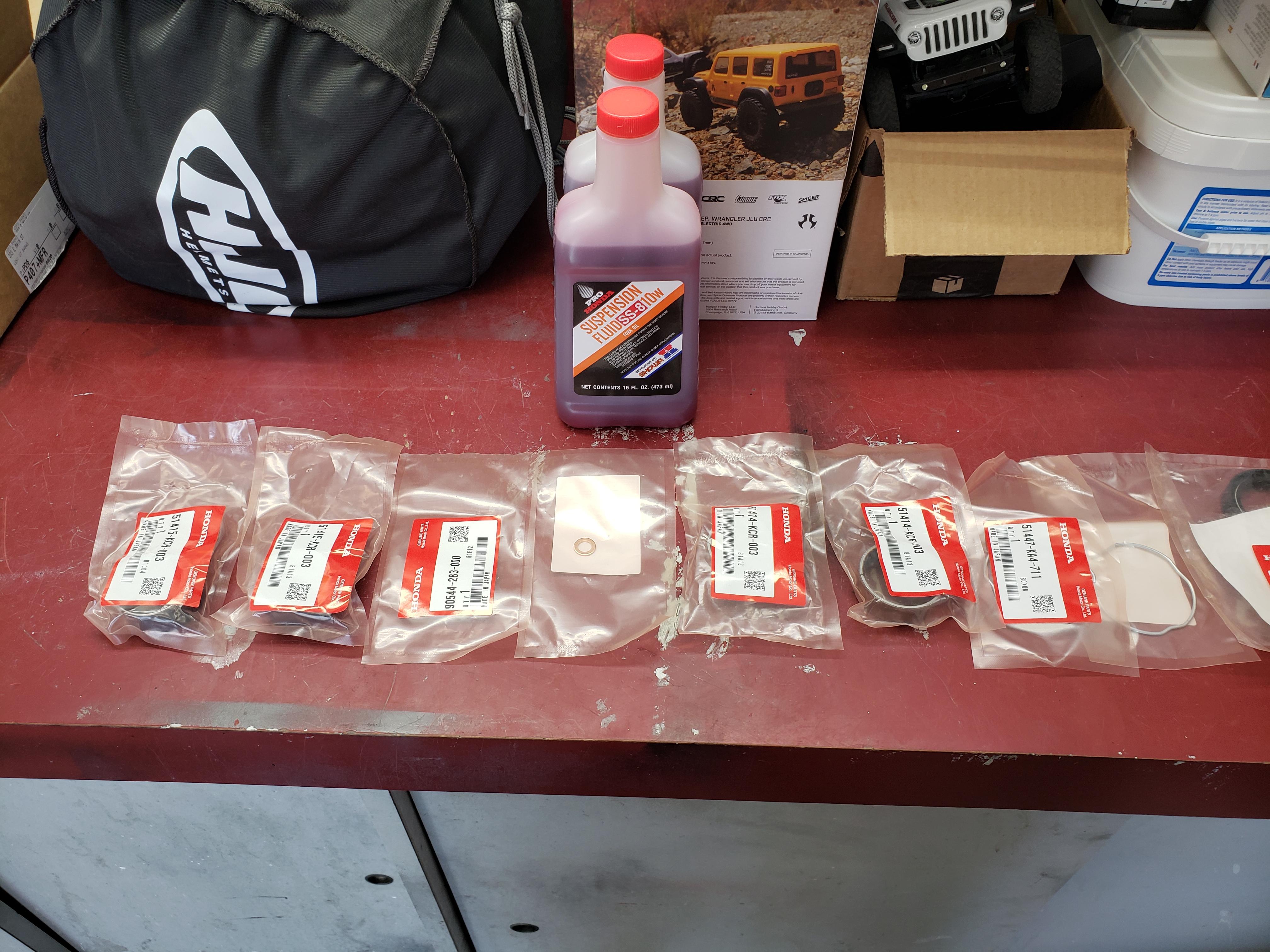

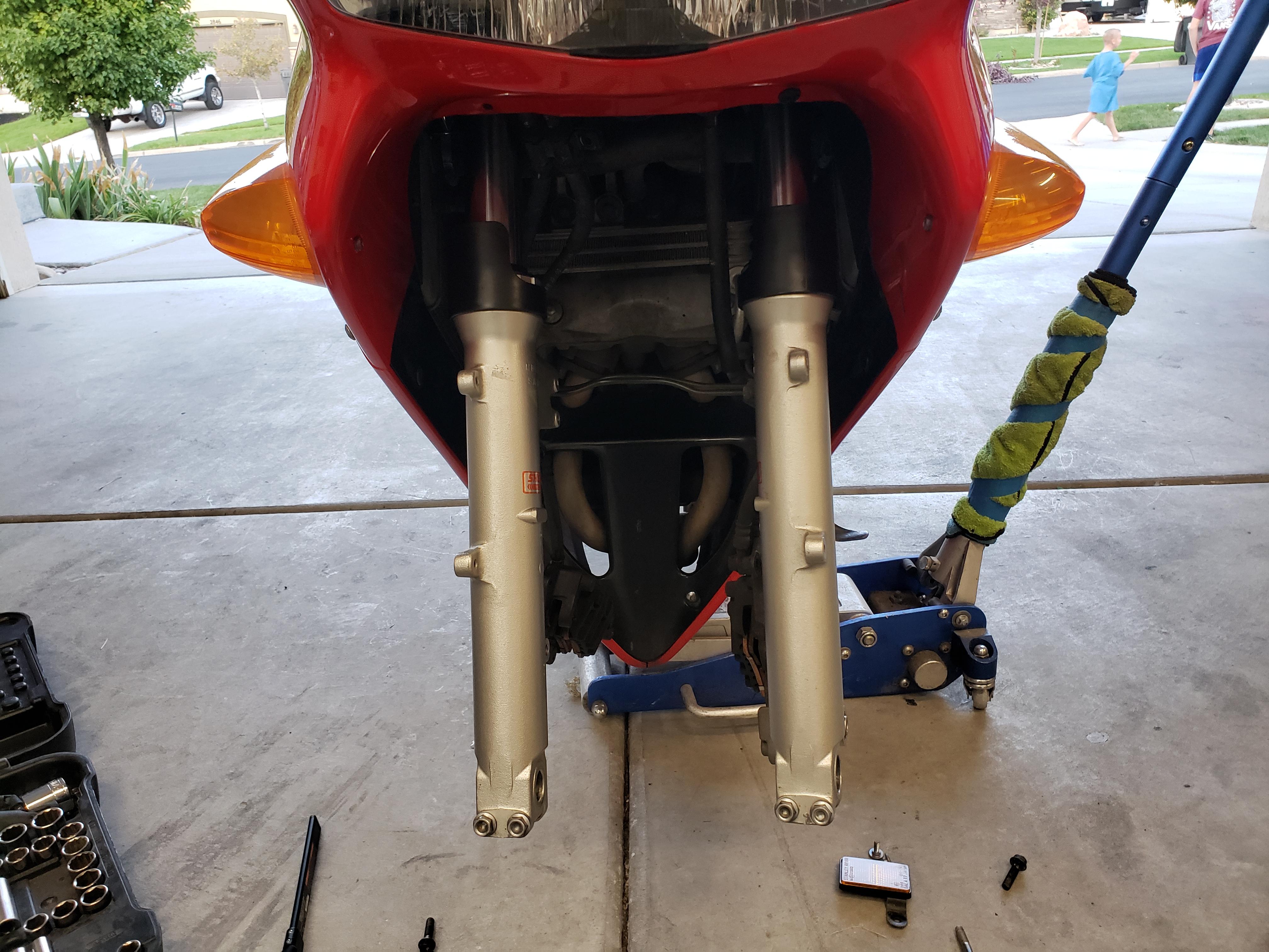

jroberts427 Posted September 24, 2021 Author Posted September 24, 2021 I have had a ton of fun riding this summer. The bike is running awesome but I still had a few things left to address. I noticed there was a leak at the right fork seal so I ordered OEM seals, bushings, and related bits as well as Honda SS-8 fluid. Luckily there is a YT video for the 6th gen forks so I just followed that. One trick for seating the new bushings and seals, if you don't want to buy the tool, is to wrap the fork tube several times with electrical tape or painters tape. That worked well and did the trick. Also took the opportunity to clean up the forks and brake calipers. With the forks done I decided to go for a 600 mile shake down run in Southern Utah. People kept telling me about Hwy 12 being one of the best roads in the state so I scheduled some time off and headed South. Hwy 12 goes from Capitol Reef to Bryce Canyon and it was epic. 78 degrees and only light traffic since it was mid-week, with amazing scenery at every turn. Highly recommended if you are in the area. I didn't get a lot of pics but here are a few. On the way home I noticed a slight vibration in the front at freeway speeds. I knew the tires were a few years old and suspected that might be the culprit. Once home I looked at the date codes on the tires. Sure enough, 2014 front and 2015 rear. Oops. Even with good tread remaining that's still over due in my book and the front was cupping. Time for new meats. Inspired by another thread on the forum I ordered some Michelin PR2s from Amazon. They were priced well and people seem to like them. Went for a short scrub in ride last night and it feels like a new bike. Still looks great at 20 years old. It's a shame we get snow in my area but there's still time for a few more rides while the weather is good. Cheers, Justin 2 Quote
