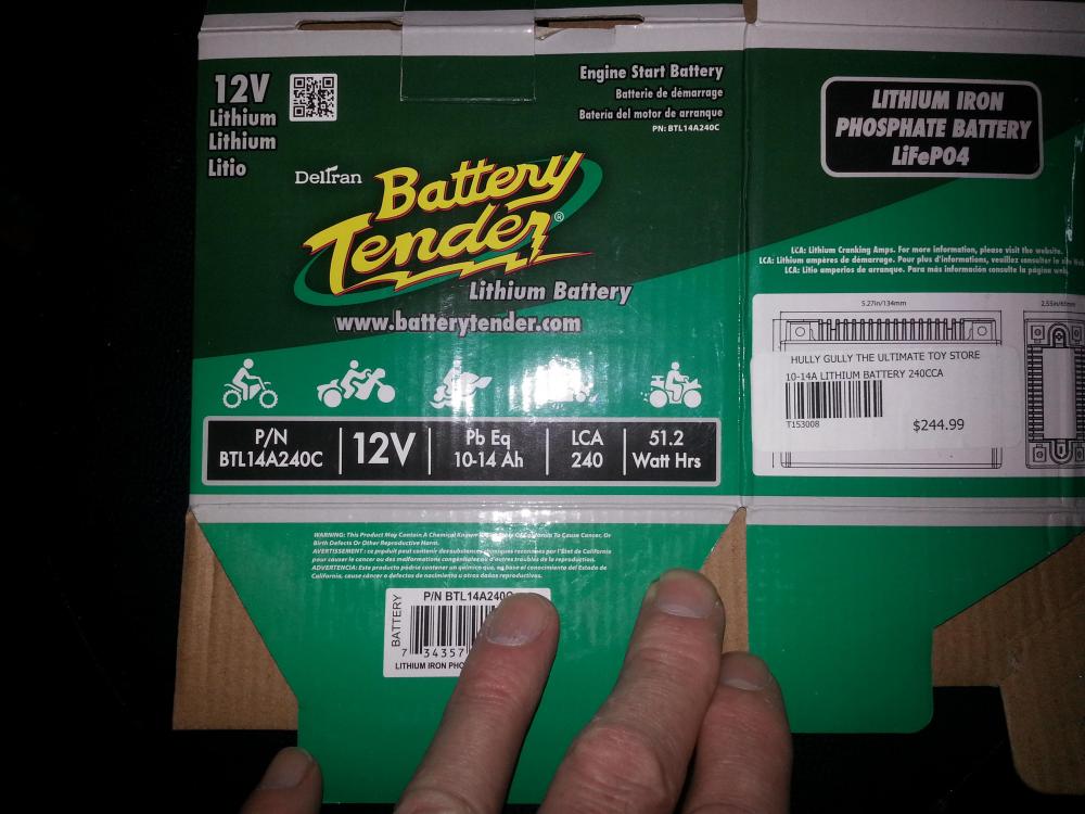

Member Contributer RDMcD Posted October 11, 2019 Member Contributer Posted October 11, 2019 20 hours ago, JZH said: Which ones are LifePo4? Ciao, JZH Been using this one for a year since I rebuilt my charging system. Works great Quote

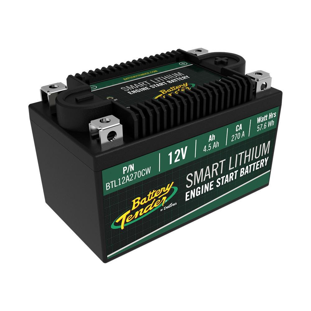

FireWire Posted October 12, 2019 Author Posted October 12, 2019 I decided to buy this Battery Tender from Amazon for $150 along with a dedicated lithium trickle charger. These batteries have four terminals so that the wired connection for the trickle charger can be attached to one side while the other to the bikes electrical system. The battery is smaller than its lead/acid counterpart. Included is a set of small foam blocks take up space so the battery doesn't move around. This battery has a three year warranty. We're fortunate that a battery lives beyond two years in this oppressive Texas heat. Quote
Member Contributer Mohawk Posted October 12, 2019 Member Contributer Posted October 12, 2019 The 4 terminal top is just there to make it universal fitting ! Quote

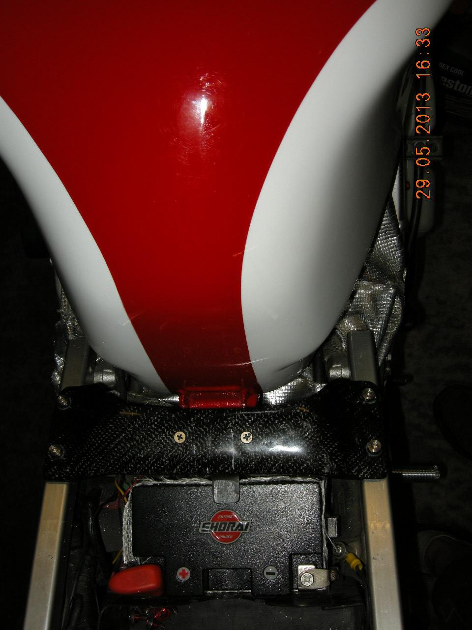

Member Contributer Duc2V4 Posted October 12, 2019 Member Contributer Posted October 12, 2019 3 hours ago, FireWire said: I decided to buy this Battery Tender from Amazon for $150 along with a dedicated lithium trickle charger. These batteries have four terminals so that the wired connection for the trickle charger can be attached to one side while the other to the bikes electrical system. The battery is smaller than its lead/acid counterpart. Included is a set of small foam blocks take up space so the battery doesn't move around. This battery has a three year warranty. We're fortunate that a battery lives beyond two years in this oppressive Texas heat. A few years ago I found a deal on this battery and a dedicated charger for my Duc, having the 4 terminals is handy and does make for adding accessory/charger connections cleaner and as said by Mohawk, a more universal fit. Quote
