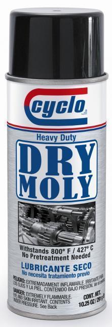

VFRBeast Posted October 14, 2015 Posted October 14, 2015 Hi Dutchy My opinion would be to leave the 750 outside, as per my experience they can take the elements better than the older bikes(my 750 stood outside for a year & 8 months), & all I needed to do was clean out the carbs, charge the battery & put some fresh fuel in her & she started up pretty much first time. As for your plastics, if you have the bike under a cover protecting the bike from direct sun light, there is no reason to take the plastics off, on the hand if it stands in direct sun light rather take them off to prevent them from fading. As for other preparations I would suggest emptying out the carbs as they can get sludgy if they stand with fuel in them for a couple months, & I would only fill the tank half way. The fumes inside the tank prevent it from rusting. As for the metal parts WD40 won’t last all winter, I would suggest you rather use a Dry Moly spray(I work in the oil industry & we use it on a lot of our tools that stand in the weather). I would also try & put old tires on the bike as the rubber can become brittle while standing outside for long periods. What you can also do is spray some WD40 or something similar on all you electrical connections to prevent them from cording over the winter. But the best practice is to start up the girl once every two or three weeks & let the bike get warmed up. Quote
