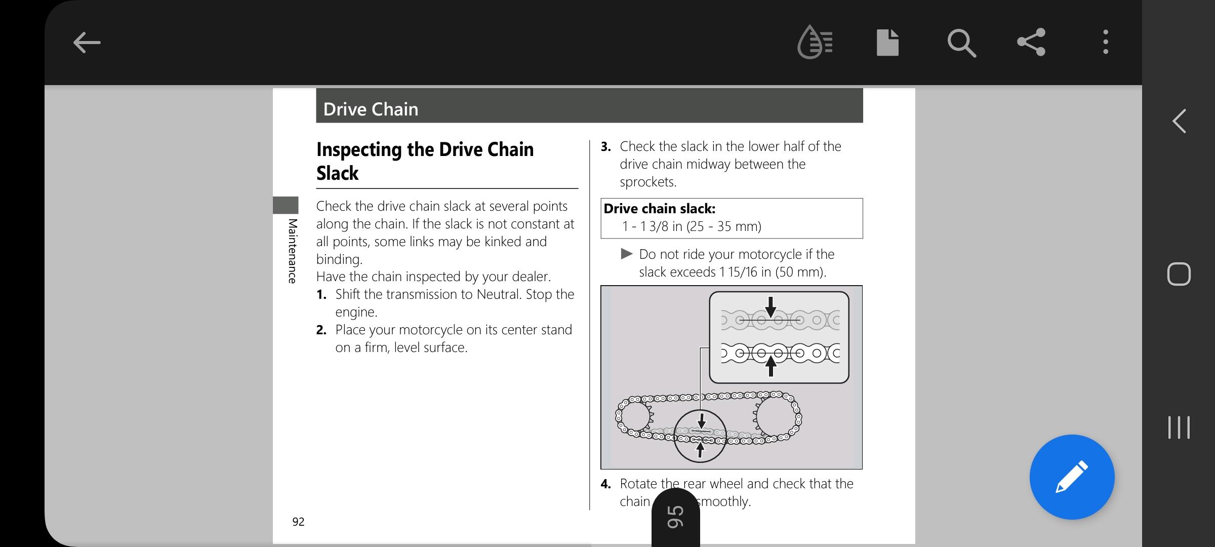

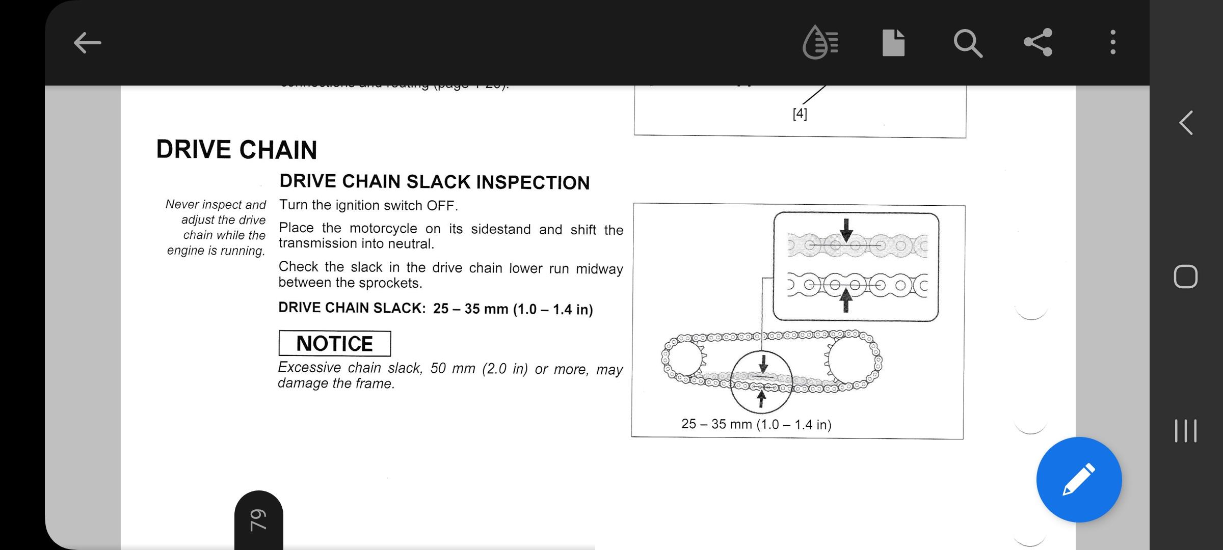

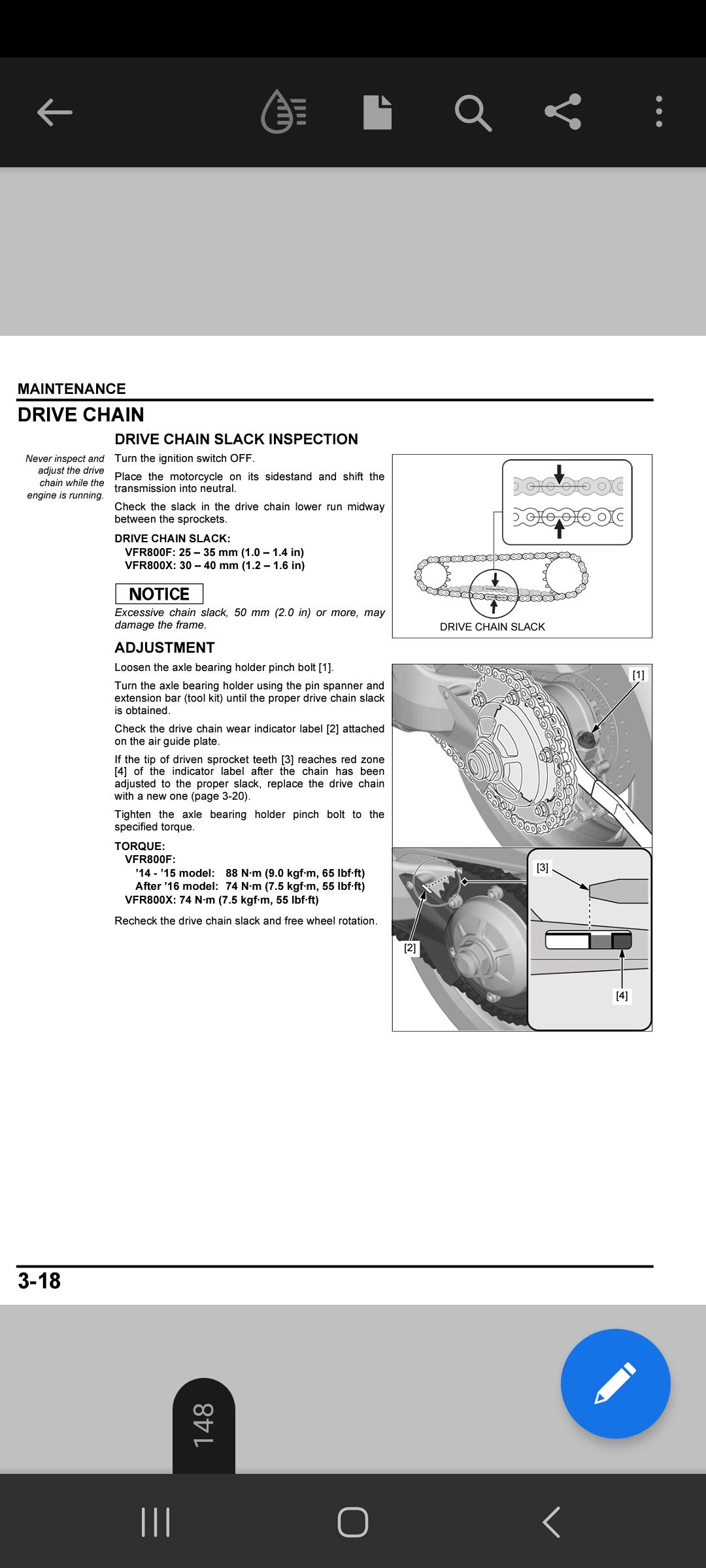

suawek Posted June 12, 2023 Share Posted June 12, 2023 Hi!  I have a question regarding chain slack maintenance. Most of you will probably see this and think that I can't use search - please stand by 😄  So here's the thing:   paper user manuals (in few different languages) that came with bike state that chain slack should be adjusted on center stand (photos of english manual below):  but user manual that is downloadable from honda website (https://cdn.powersports.honda.com/documentum/MWOM/ml.remawmom.2015_31mjm610_vfr800f_interceptor.pdf) and service manual both instruct to adjust it on side stand:      Both variants specify same slack (25-35mm)  For now I opted to set slack according to service manual - I set slack to 25mm in tightest spot (after ride, on warm chain). Seems to be safer option as it's better to have it set a bit too loose rather than too tight.  I also measured difference between slack as measured on side stand and centre stand and difference is about 5-7mm so my question is whether anyone knows which procedure is correct.  Link to comment Share on other sites More sharing options...
Member Contributer WDIV Posted June 12, 2023 Member Contributer Share Posted June 12, 2023 Good question. Weird that there's a discrepancy. I'd follow the service manual too. Link to comment Share on other sites More sharing options...
Member Contributer Skids Posted June 12, 2023 Member Contributer Share Posted June 12, 2023 Interesting indeed! Just checked my 5 different 800F/800X manuals (same drive as 800F).  First is paper Honda Shop Manual (800F & 800X) - sidestand  Second is 800X paper Owners Manual - says both depending on ED or U type  Third is digital 800F/800X Combined Service Manual - sidestand  Next is 2016 digital Owners Manual - centre stand  Finally 2014 digital 800F Owners Manual - sidestand  Somewhat confusing but I always check and adjust on the sidestand. I tried it on the centrestand to their recommended adjustment and as soon as it was back on 2 wheels, the chain was far too tight.  YMMV. Link to comment Share on other sites More sharing options...
Member Contributer bmart Posted June 12, 2023 Member Contributer Share Posted June 12, 2023 Funny! Thanks for sharing that comparison.  Side, for sure. I've done the same and had it all bind up while riding.  Chain slack is a common topic at track days. Our best scenario is to have the rider sitting on the bike to check it. Still, differnet bikes work differently. Little KTMs have almost no slack due to the geometry, but normally I set mine to just barely not touching the chain guide at the tight point when I'm on it. Loose is better than tight. YRMV  You may find the same variation checking coolant and oil levels...including that the bike be hot/cold, etc. Link to comment Share on other sites More sharing options...
suawek Posted June 13, 2023 Author Share Posted June 13, 2023 Thanks all of you for your insights. That confirms exactly what I thought. When adjusted on centre stand chain is just too tight during riding. Gear changes felt really awkward - similarly to like it is when chain is very loose. This issue with gear changes is what actually made me check slack again and find this discrepancy in manuals 😂 Link to comment Share on other sites More sharing options...
SlideRule Posted June 19, 2023 Share Posted June 19, 2023 Some of the discrepancy may be due to the Standard US models not coming equipped with a center stand, while the US Deluxe and all Euro models have them fitted. I prefer to set my chain slack on the center stand since it is more consistent. Remember, too loose is better than too tight!  -SlideRule Link to comment Share on other sites More sharing options...

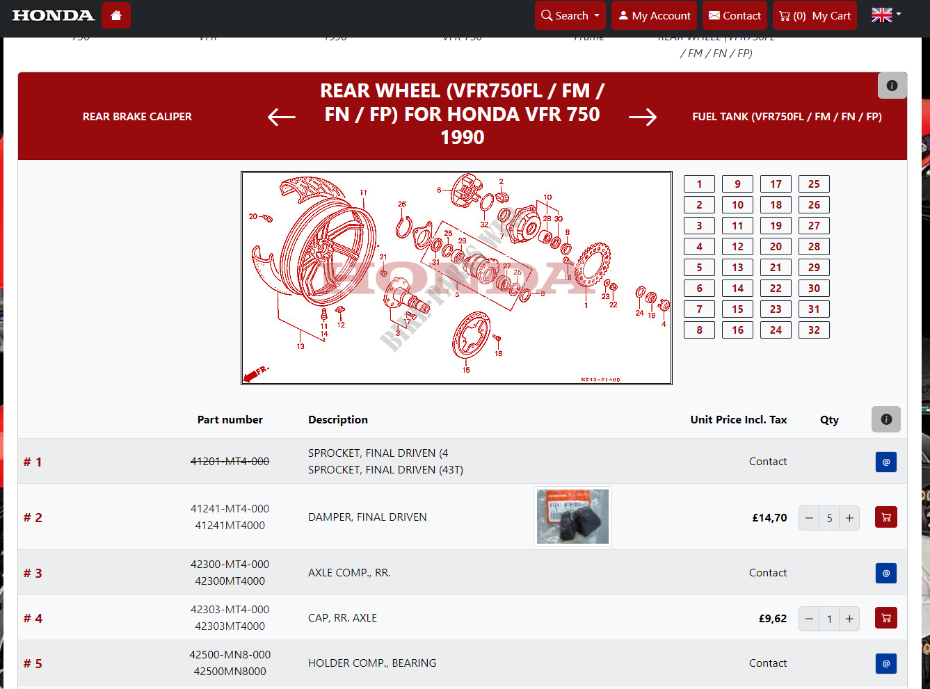

Foolish Posted November 17, 2023 Share Posted November 17, 2023 This probably stupid question but I’m serious what is the part called that the cspanner turns and is it replaceable I recently bought the bike and the teeth are all messed up and chain way to loose Link to comment Share on other sites More sharing options...
Member Contributer Dutchy Posted November 17, 2023 Member Contributer Share Posted November 17, 2023 Â Â Â https://www.bike-parts-honda.com/honda-motorcycle/750-MOTO/VFR/1990/VFR750FL/Frame/REAR-WHEEL-VFR750FL-FM-FN-FP-/13MT4L41/F__1400/2/10196 Â Â Link to comment Share on other sites More sharing options...
Member Contributer bmart Posted November 17, 2023 Member Contributer Share Posted November 17, 2023 This made me curious. Here's the one for the 5th gen.  Link to comment Share on other sites More sharing options...
Member Contributer VFR78 Posted November 18, 2023 Member Contributer Share Posted November 18, 2023 21 hours ago, Foolish said: This probably stupid question but I’m serious what is the part called that the cspanner turns and is it replaceable I recently bought the bike and the teeth are all messed up and chain way to loose It’s an expensive bit of kit, new. If you search fleabay, you might get a reasonable second hand one. If the bearings are still good, it might be worthwhile taking the bearing holder out and trying to clean up the teeth. My Viffer has just topped 100,000km and the carrier is still in top nick, they shouldn’t get damaged unless a gorilla has tried to adjust the chain. Link to comment Share on other sites More sharing options...
Member Contributer bmart Posted November 18, 2023 Member Contributer Share Posted November 18, 2023 Looks like assm #5, no?  So many people lost the tool and use a screwdriver and hammer...or the wrong spanner. Humans...the worst.  At least Starship was a big success this morning. That's not nothing. Link to comment Share on other sites More sharing options...
V4 Rosso Posted November 20, 2023 Share Posted November 20, 2023 I agree with VFR78: remove the bearing holder and clean up the teeth. Also a great opportunity to repack the bearings with new grease. Link to comment Share on other sites More sharing options...
