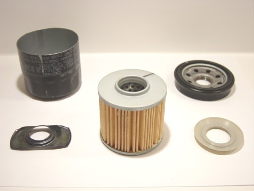

Member Contributer DannoXYZ Posted January 30, 2021 Member Contributer Posted January 30, 2021 I've read numerous oil-filter studies over the years and have cut a few filters to verify. I agree with them mostly. Avoid paper filter elements and cardboard end-caps. A seal on anti-drainback and bypass valve is nice to have. I've used following: Honda OEM filter (20 different part#) PurePro PH7028 Mobil MO4612 Mahle OC575 Quote
Member Contributer RC1237V Posted January 30, 2021 Member Contributer Posted January 30, 2021 Purolator One for Honda cars are what I use on the 90, and 93 VFR750, the VFR1200, and the RC51 - they make a long and a short. Some bikes will only fit the short... https://www.calsci.com/motorcycleinfo/FilterStudy.html Pure One PL14610 $6 50*.39*2.36 92 Silicon Silicon A A This is how an oil filter should be made. The anti-drainback valve is double the thickness of any other here, and obviously seals very well. The media is the best available, and there's a lot of it. The bypass valve is made from a laser-cut piece of stainless steel, and just can't bind or jam. 1 Quote

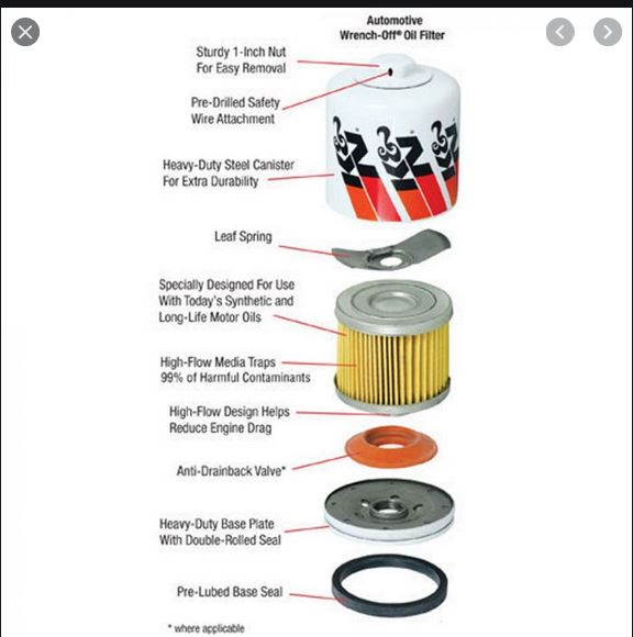

Member Contributer BusyLittleShop Posted January 30, 2021 Member Contributer Posted January 30, 2021 40 minutes ago, Cogswell said: Maybe more important than the choice of filter other than staying away from K&N. Mercy Cogs... there is no good reason to warn against K&N... Quote
Member Contributer Grum Posted January 30, 2021 Member Contributer Posted January 30, 2021 39 minutes ago, BusyLittleShop said: Mercy Cogs... there is no good reason to warn against K&N... BLS.. PLEASE, lets not confuse people. We DON'T want people to be using the K&N with the spot welded hex nut. AND.......If K&N continue to produce this dangerous rubbish why bother to support them at all when there are so many other good alternatives! Couldn't care if K&N were Gold Plated, I'd never buy one, hex nut or not. 1 Quote
Member Contributer DannoXYZ Posted January 30, 2021 Member Contributer Posted January 30, 2021 There's reason K&N filters are banned by most racing orgs and many TDPs (and more soon ). I was at trackday at Thunderhill where K&N blew going into T14. Crash collected 5 other bikes. Totaled very nice Aprilia RSV4. One guy broke both wrists. It used to be thought it was user-error that was causing filter to fail. K&N was blaming end-user. But they were just accelerating the failure sooner by using nut to tighten filter. Real issue is welding on such thin disposable weak metal causes precipitation of carbide particles in HAZ. This causes embrittlement and lowers ductility of metal. It's is more fragile and crack-prone. What happens with each ride is you have heat cycles along with low/high pressure cycling. This initiates cracks in HAZ which eventually meet and filter blows. Obviously each filter moves along SN curve (strain/stress cycles) at different rates. Bikes with higher daily and track usage obviously will have quicker failures. 1 Quote
Member Contributer RC1237V Posted January 30, 2021 Member Contributer Posted January 30, 2021 Probably a very low failure rate, but when you sell half a million filters a year... I used to buy them, but when I started going to the track, and found out about the failures I switched. It only takes an extra second or two to grab my fitted oil filter socket along with my drain bolt socket, so not much savings just for the nut - but some inherent risk.... Quote

Member Contributer Cogswell Posted January 31, 2021 Member Contributer Posted January 31, 2021 3 hours ago, BusyLittleShop said: Mercy Cogs... there is no good reason to warn against K&N... I unfortunately personally know two people who had one fail, both cracking around the nut and soaking their rear tire going down the road (one was on a 5th gen). Both were extremely lucky. There was also the travel thread on here by Olive some years ago (no longer active here) where it failed at the nut and did the same thing. I can recall a couple of others but don't recall the members that posted. For the record I do not know how they were installed or if they were damaged prior to install. If using one I would suggest not using the nut to tighten it - hand tighten only. I don't ever recall any anecdotal reports about filters without nuts experiencing that kind of failure. I'm not saying they all fail, however the risks do seem elevated relative to non-nut filters. 1 Quote
Member Contributer Grum Posted January 31, 2021 Member Contributer Posted January 31, 2021 17 minutes ago, Cogswell said: If using one I would suggest not using the nut to tighten it - hand tighten only. Hi Cogs. Wouldn't even suggest using a K&N with the nut, they have failed with people who haven't used the nut to tighten. As DannoXYZ rightfully mentions, the welding process to such thin metal causes the weakness, its just never worth the risk, avoid these filters like the plague or Covid! Quote
