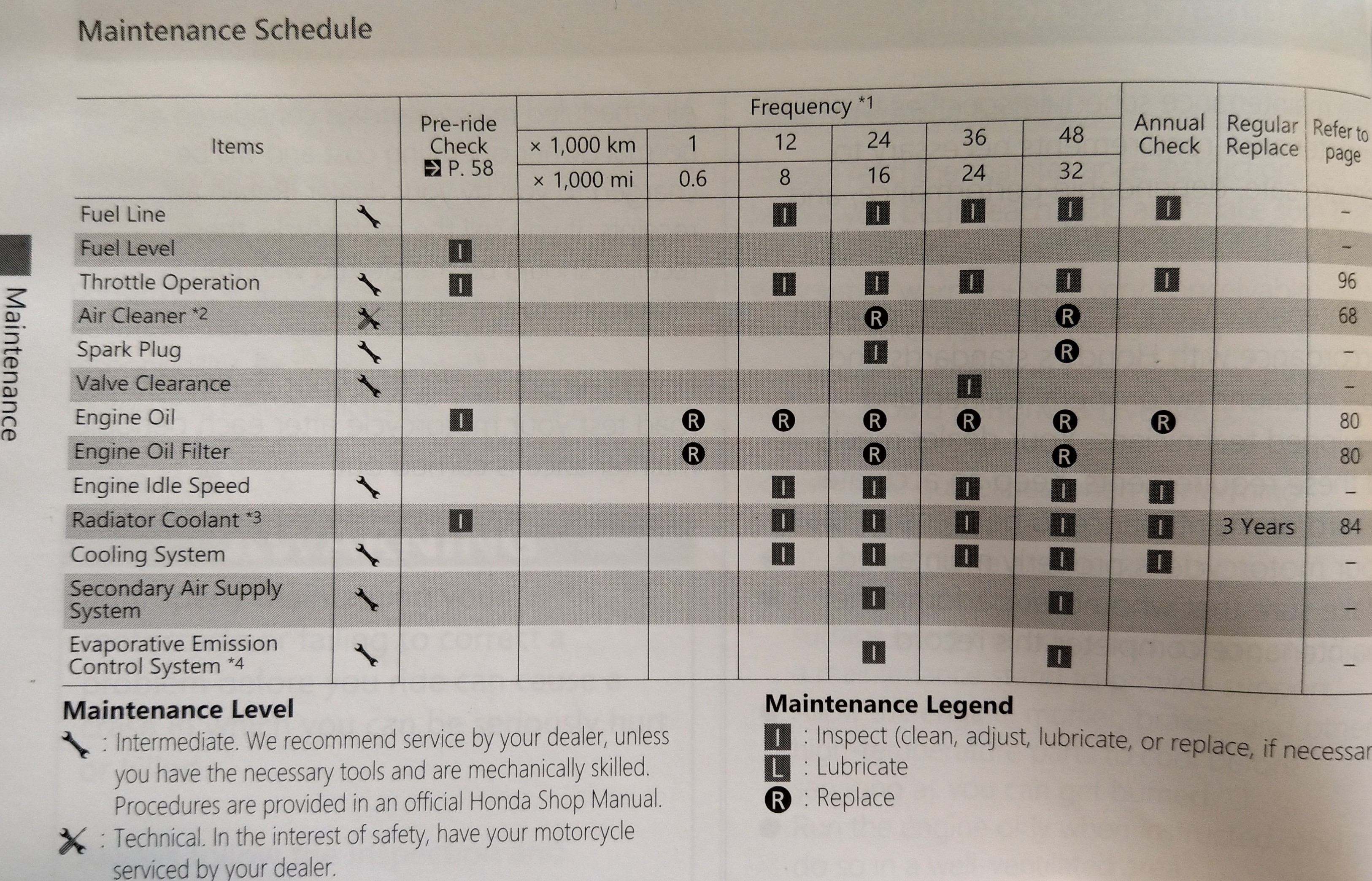

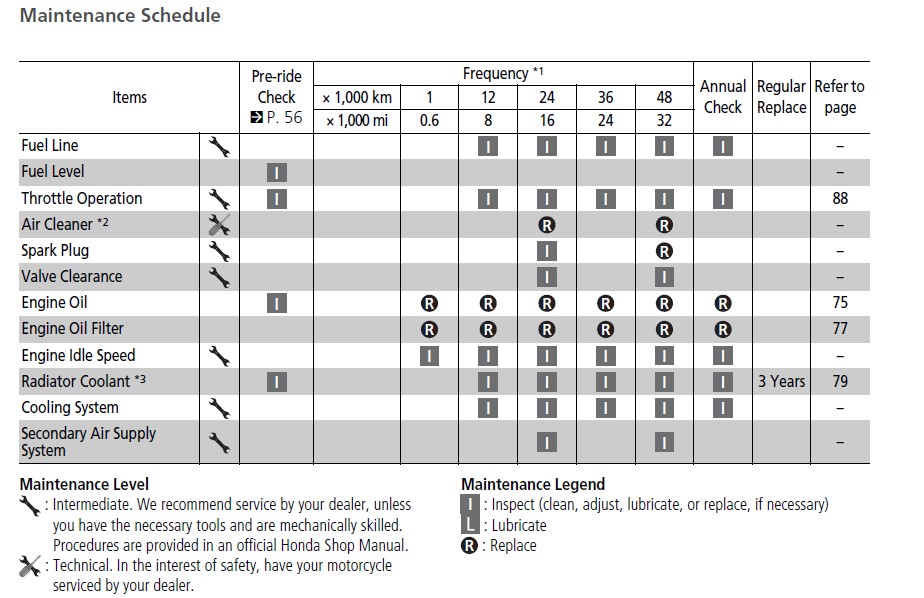

Member Contributer Skids Posted January 3, 2021 Member Contributer Posted January 3, 2021 Trying to narrow down when the VFR800 went from a 16k mile valve inspection interval to 24k miles. My 2018 VFR800X shows it to be 24k miles, but the Owners Manual from a 2015 model shows it to be 16k miles - pics below. As the engine is the same as the VFR800F (8th Gen), I was wondering if anyone knew when they changed or we could get a few Owners Manuals from the various years 15-18 and see which year it changed. 1 Quote
Member Contributer flya750 Posted January 3, 2021 Member Contributer Posted January 3, 2021 My 2015 VFR800FD manual says 16K. Clearly, Honda has updated the recommendation. 16K MILES seems way too low... Case Closed! 😉 Quote

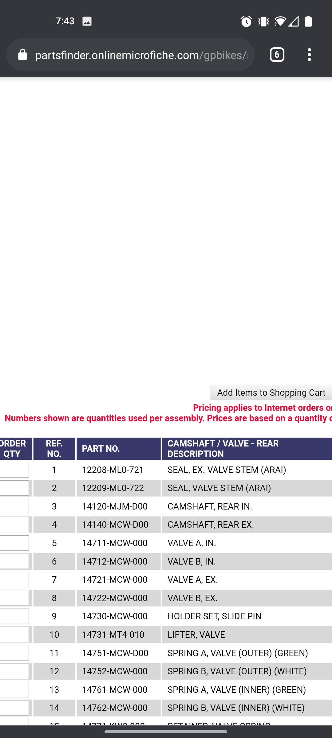

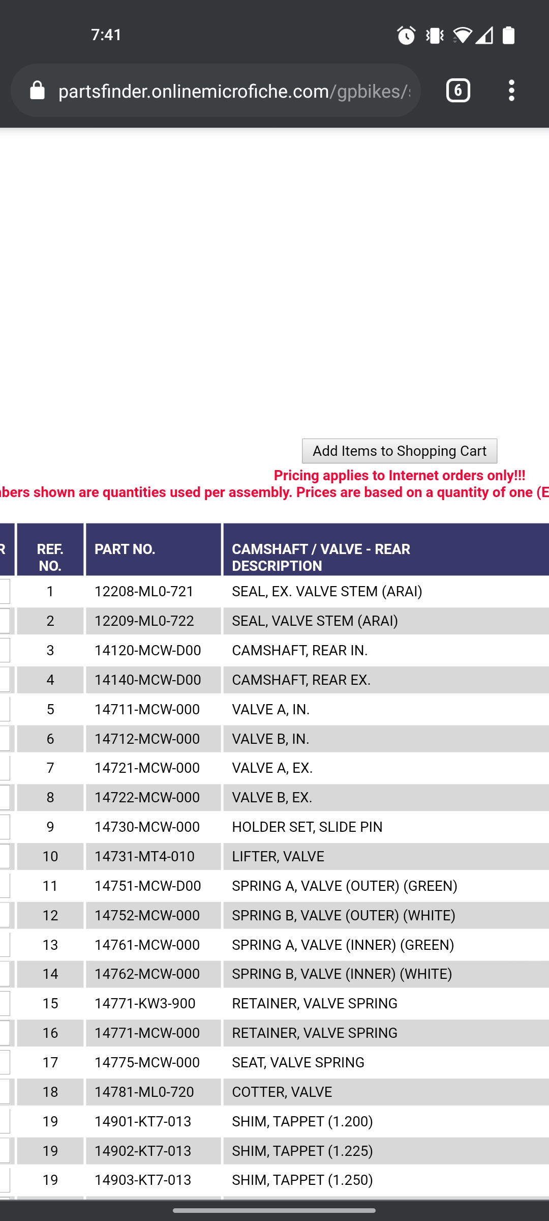

Member Contributer TriumphTraitor Posted February 27, 2021 Member Contributer Posted February 27, 2021 It would appear that between the 6th and 8th Gen, honda has updated their cam shaft part numbers. This could partially be a reason why Quote
Magneto Posted February 27, 2021 Posted February 27, 2021 Can’t see how? Isn’t lash taken at unloaded part of the cam? Quote
Member Contributer TriumphTraitor Posted February 27, 2021 Member Contributer Posted February 27, 2021 Yes, however, just shows that they have made updates to the internals. What those updates exactly are I don't know and I'm sure it's more than just the cams. But, it is possible that those updates helped with the keeping the clearance within spec longer Quote
