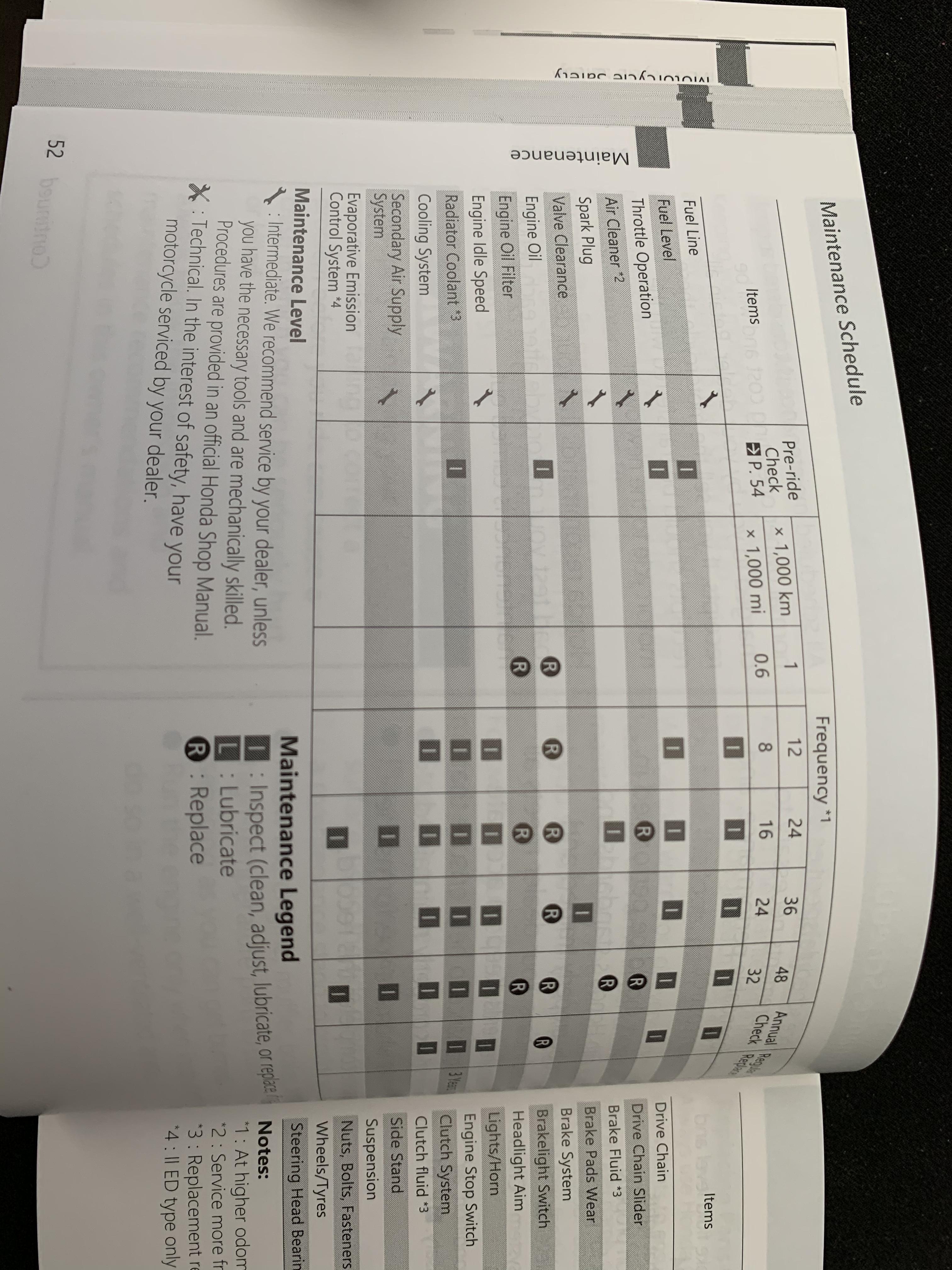

Sliveredge88 Posted March 29, 2021 Posted March 29, 2021 My 2019 manual clearly shows 24k miles or 36k km hope this helps some 1 Quote

Member Contributer Presson Posted March 29, 2021 Member Contributer Posted March 29, 2021 Just got an email from Honda UK: HONDA UK Info <info.UK.car@honda-eu.com> Dear Mr. H, Thank you for contacting Honda UK. Please find a PDF copy of your Honda VRF800F's Owner's Manual, where it is stated that the bike's Valve Clearance should be inspected at 24000 miles. Thank you for contacting Honda. If we can be of any further assistance, please don't hesitate to contact us. Kind Regards, Rositsa Ruseva Honda Customer Service _____________________ Honda Motor Europe Ltd. Honda UK I've added the PDF here and I'll put a copy in the downloads section. I note the Honda copyright date inside is 2016. Presumably it applies to VFR800F models from 2016 on. It seems the local dealer hasn't got the message as a number of us have been told 16K rather than the wallet friendlier 24K miles specified. VFR800.pdf 1 Quote

Member Contributer VFR78 Posted March 30, 2021 Member Contributer Posted March 30, 2021 Bloody hell, very confusing. I have been sticking to the 24,000 kilometre version of the manual and at 60,000 kms have had the clearance checked twice. No adjustment required either time. So on that basis, 24,000miles seems adequate. I have to say though, Honda is doing a pretty piss poor job of managing their records and technical advice. 1 Quote

Member Contributer VFR78 Posted March 31, 2021 Member Contributer Posted March 31, 2021 None of this proves that 24,000 miles is correct, or that 24,000 kms is correct. Local Honda dealers or distributors regurgitating handbooks means Jack Shit. It’s obvious that the handbook proof readers don’t even know what Mr Honda recommends. It’s clearly also so “important” that no one at Honda really cares. So now I don’t care and vote that we all adopt a 100,000km check interval. 2 Quote
