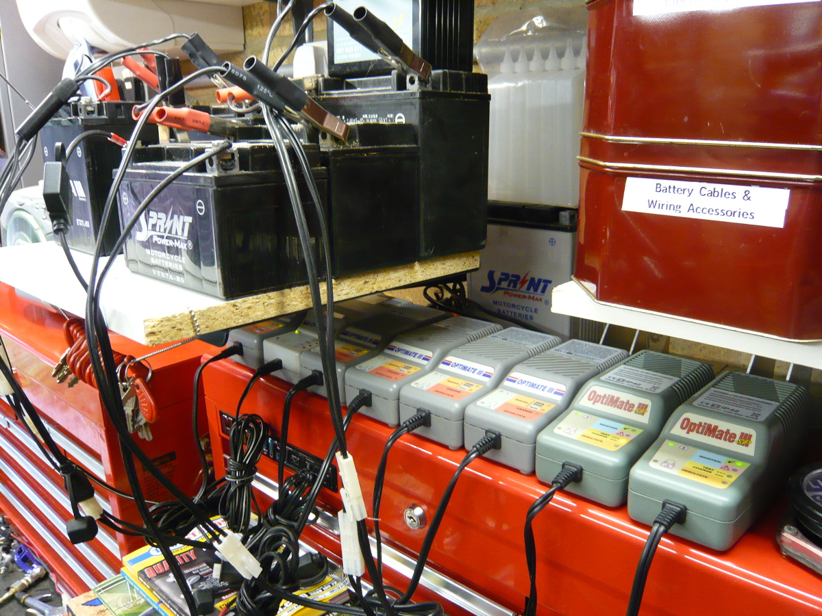

Member Contributer ducnut Posted October 20, 2020 Member Contributer Posted October 20, 2020 There’s a difference between trickle and maintenance chargers. You need to determine exactly what you have. A maintenance charger can be left connected forever. Quote
Member Contributer JZH Posted October 22, 2020 Member Contributer Posted October 22, 2020 On 10/20/2020 at 6:29 PM, ducnut said: There’s a difference between trickle and maintenance chargers. You need to determine exactly what you have. A maintenance charger can be left connected forever. There was a time I would have agreed with you... The only one of the batteries in that photo (taken in 2008) which did not eventually die--sitting on a smart charger--is the one in the back with the acid pack sitting on top of it. And that's only because I never activated it! As I've mentioned elsewhere, my AGM battery killing days are over. My next battery will be an Aliant YLP14 (14AhPbEq, 245 CCA), which measures just 114mm x 69mm x 90mm (and thus fits every bike I own). I was LiPo-skeptical until Honda started fitting them as OEM equipment. Good enough for me! Ciao, JZH 1 Quote
mello dude Posted October 22, 2020 Posted October 22, 2020 ^^^Things that make you go hmmmm.... 1 Quote
