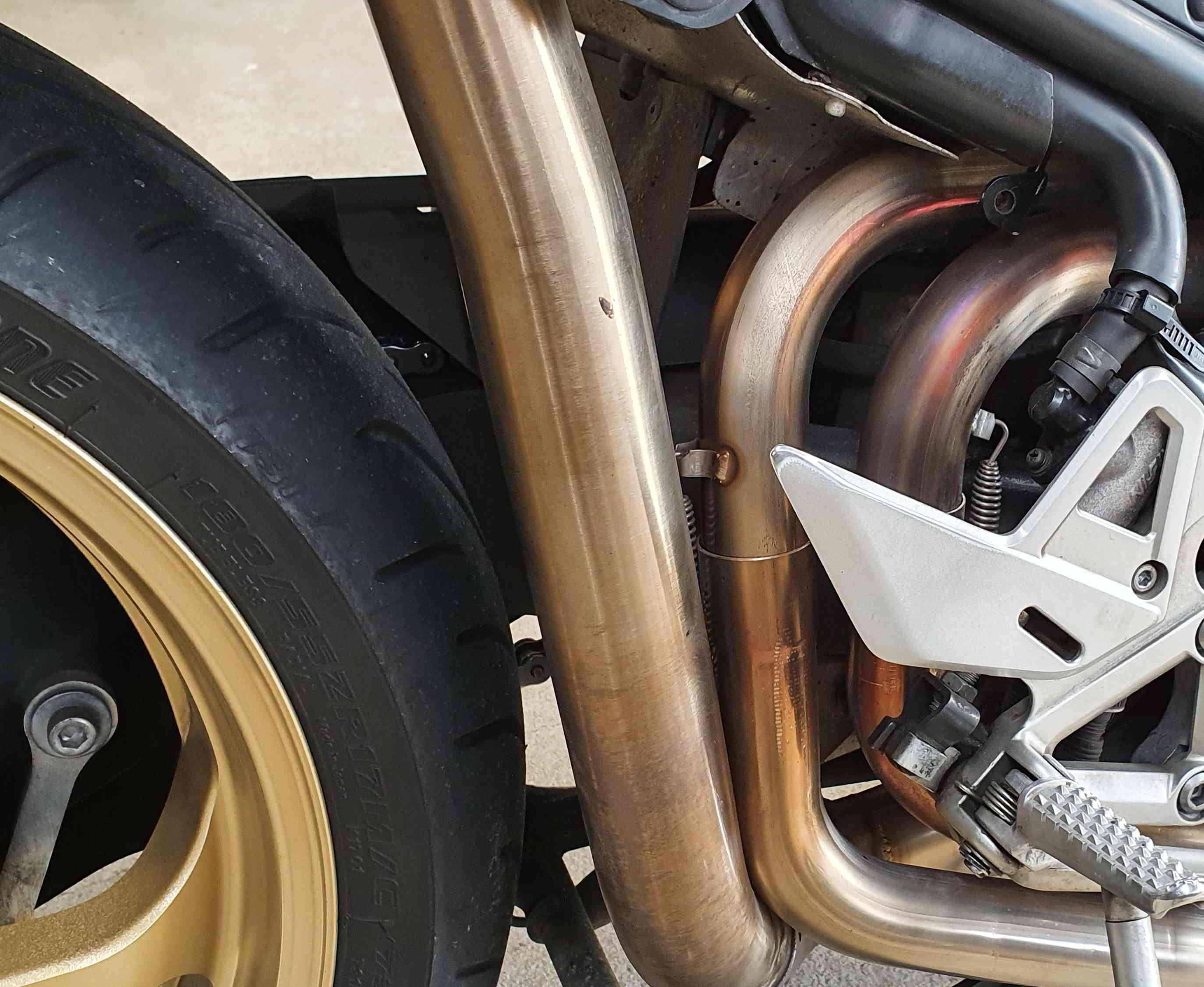

On 12/29/2018 at 8:39 PM, sfdownhill said:
A pre-production prototype header assembly with specifications nearly identical to the Two Brothers Racing [TBR] 5th gen VFR 800 header is now being constructed in southern California.
This is a new thread duplicating a post on the VFRD '5th & 6th VFR 800 Header build' thread. The objective of this new thread is to give the project described below an opportunity to stand on its own four cylinders. There is a metric ton of valuable data and opinion on the old thread, so if you're new to VFR headers and curious about the gestation of this project, don't deny yourself the pleasure of reviewing it.
Here is photographic evidence of the work in progress. This photo shows the jig that has been fabricated in order to get the proper layout of the performance headers. Photos taken 12/26/2018:
654277571_small20181226_150915.jpg.46ce3b5f1a5cd9868140a442032da039.jpg283617769_small20181226_150833.jpg.8f21a61f958e2e50f1aaa45ae2537f36.jpg

[1] The production version of the performance header assembly described here will be hand built in southern California and cost $790.00 plus shipping from the manufacturer. California residents need to add 7.75% state sales tax.
[2] The header will fit 5th and 6th gen VFR800s. [8th gen owners, see Note 'a' below]
[3] The header will go into production when orders for 15 units are received with a $200 deposit per unit.
[4] The prototype header is scheduled to be completed by 1/11/2019.

*Some dimensions, features, and specifications of the header will be taken from the TBR.
The new header will incorporate the following specifications from the original TBR header design:
-header construction will be from 18 gauge 304 stainless steel tubing, [0.049"/1.24mm wall thickness]
-header will have 38mm od primary tubes [1.5" od]
-header will have 41.5mm od secondary tubes [1 5/8" od]
-header will have 51mm od collector tubing [2" od]
-header's rear primary tube junctions will be fastened by spring tension fittings
-header's left front and left rear primary tubes will merge
-header's right front and right rear primary tubes will merge
-header will have no crossover of front or rear primary tubes
-header's collector exit tube will have a 51mm od [See Note c below]

Since this thread has become the all-things-custom-headers-thread I'm posting here.......
I was in on the first batch of custom headers and after install it was immediately clear that the bike would benefit from a dyno tune. Surge at small, constant throttle openings, a general lack of crisp response to inputs, etc. This wasn't a surprise, I was actually pleased - the motor needing more fuel because its moving more air is a good thing
Here's my experience -
  1. I wanted to try the Rapid Bike system based on my web research but ultimately went with a Power Commander. Not my decision really, any reputable shop within a reasonable distance was far more experienced with the PC. One was willing to try the RB but my bike would have been patient #1.
  2. My header has 3 O2 ports, one for each pair of cylinders and one downstream of the merge. Unfortunately, the header pairs the left & right cylinders (iow a front and rear). The technician highly preferred front-front & rear-rear cylinders for tuning purposes. As he said, the temp difference between front and rear cylinders is large enough to make a difference. We ended up using the single O2 port past the merge to tune
  3. We didn't go for ultimate power but rather smooth throttle response. Even so everyone wants to see the numbers so Max HP = 106.0 Max T = 55.2. Dynoplot down below
  4. Mods are WiLD headers, flow balanced injectors, Pipercross air filter, Micron exhaust cans
  5. Results - throttle response is much, much better now. Crisp, linear, no surging, no stumbling - puts a smile on my face each time I open it up. Sadly riding season is almost over around here 😞
