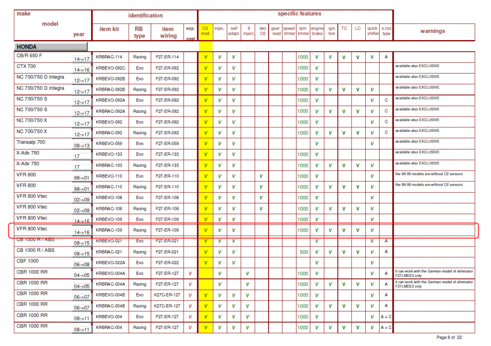

Member Contributer HighSideNZ Posted January 21, 2020 Member Contributer Posted January 21, 2020 Hey guys Back on the RapidBike Racing and the Gen 8 VFR. Here is the RB Application table showing the Gen 8 does use the single 12mm narrow band O2 as long as you buy the correct kit and wiring loom. I've highlighted the parts in question. Cheers Phil PS. The new Gen 8 headers on my modded Gen6/5 are working really well after I added 2 18mm bungs to support the factory narrow bands. The RB MyTuningBike unit is working really well and the power is much more spread compared to my home built system, based on the Shark RC45 system, I've been running for the past years. Good investment all rounds. Phil 3 Quote
