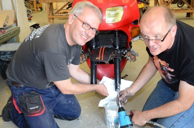

Member Contributer Dutchy Posted September 29, 2013 Member Contributer Posted September 29, 2013 The oil that came out was as dark as a cup of ristretto...... The new (Motul 7.5W) as light as a chardonnay. Wilbers' specs are for a 170mm air pocket, went for 160mm. Pure speculation! Quote

LexEssers Posted June 16, 2015 Posted June 16, 2015 DSC_3628.jpg The oil that came out was as dark as a cup of ristretto...... The new (Motul 7.5W) as light as a chardonnay. Wilbers' specs are for a 170mm air pocket, went for 160mm. Pure speculation! Hahaha Leon and Bert on the tubes. Quote

Member Contributer Dutchy Posted April 15, 2016 Member Contributer Posted April 15, 2016 yes scroll up in the post for a picture of Bert and myself removing the bolt after having taken out the front axle Quote
